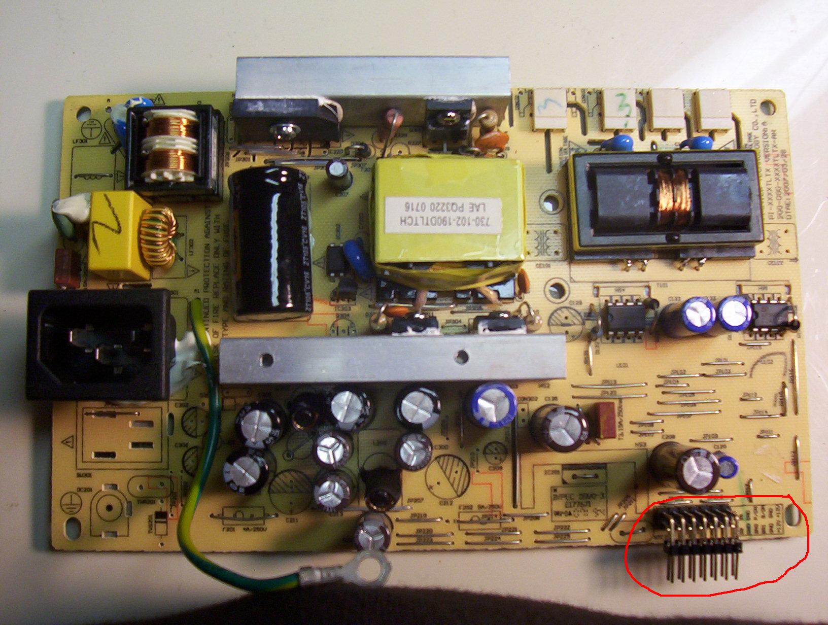

        I have attached a marked up version of the power supply / inverter board. I would like to see the label next to connector I circled. Could you either take a clear picture, or transcribe it.
        One thing to try would be driving the CCFLs using a different inverter - such as the one supplied with a case mod light kit. This might give us a clue if the problem is the CCFLs.
        The intermittent nature suggests a bad solder joint. Something else to try is to resolder any suspicious joints on the inverter board, in particular the transformer pins.

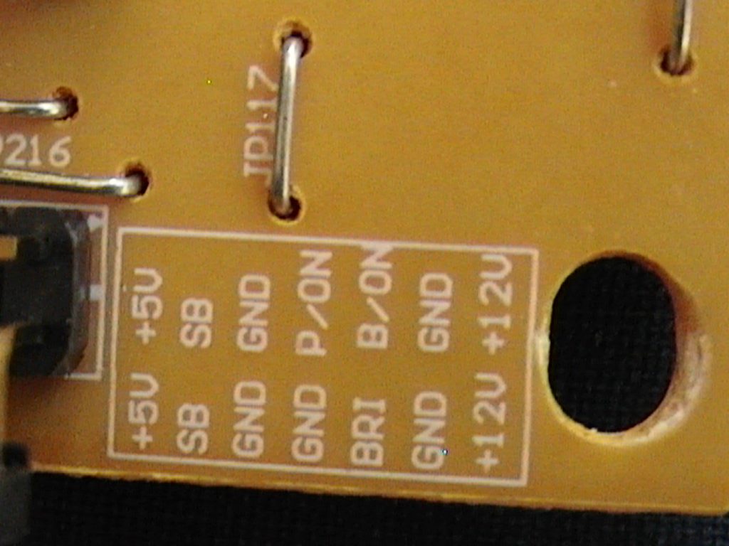

          I had some notes as to the logic levels for P/on B/on and BRI when in standby, On and on and the ccfls shut down. I can't find the notes but I seem to recall there was no difference in the operating and shut down states.
          [/IMG]

            Excellent picture. I'd suggest verifying the voltages at the P on, B On, and Bri pins. If as you remember there is no difference, this is definitely an inverter / CCFL issue.

              Ok I verified that the P on, B on and Bri logic levels are the same when the tv is ON as when the tv is On but the lamps are shut down.
