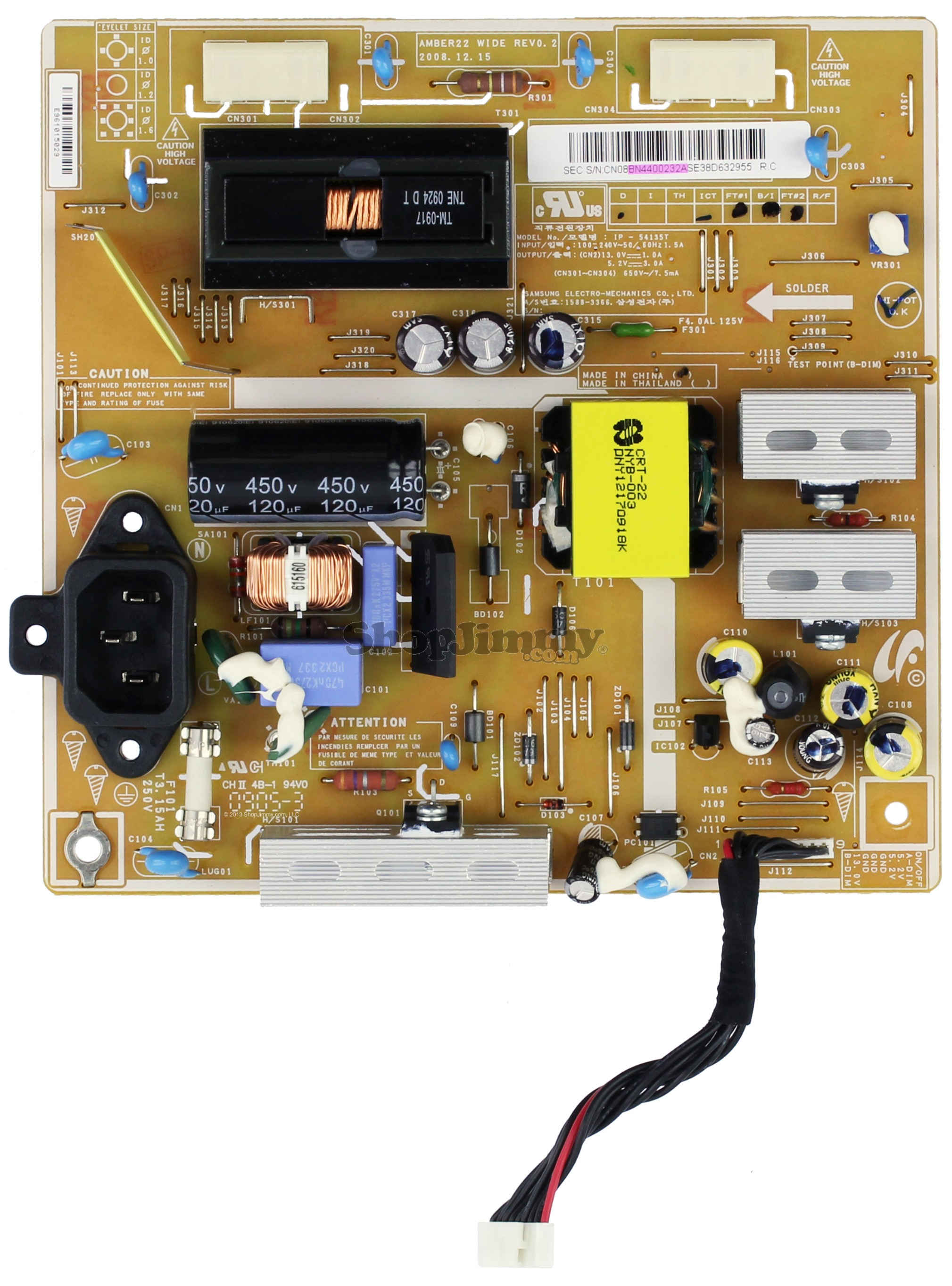

I have a Samsung ln22b360c5d that came in dead and I found the fuse blown and also a bad mosfet (arrow in the pic) so after replacing both I still have nothing. It does not blow the fuse now and I have 175v at the big cap but NO voltage on any wire coming out of the connector that goes to the main. I checked all the diodes and the caps "look" ok. Not sure where to go next.

Do you have a picture of the underside of the board. It looks like you have no boost voltage on the cap.Willing to help but I'm no expert. -

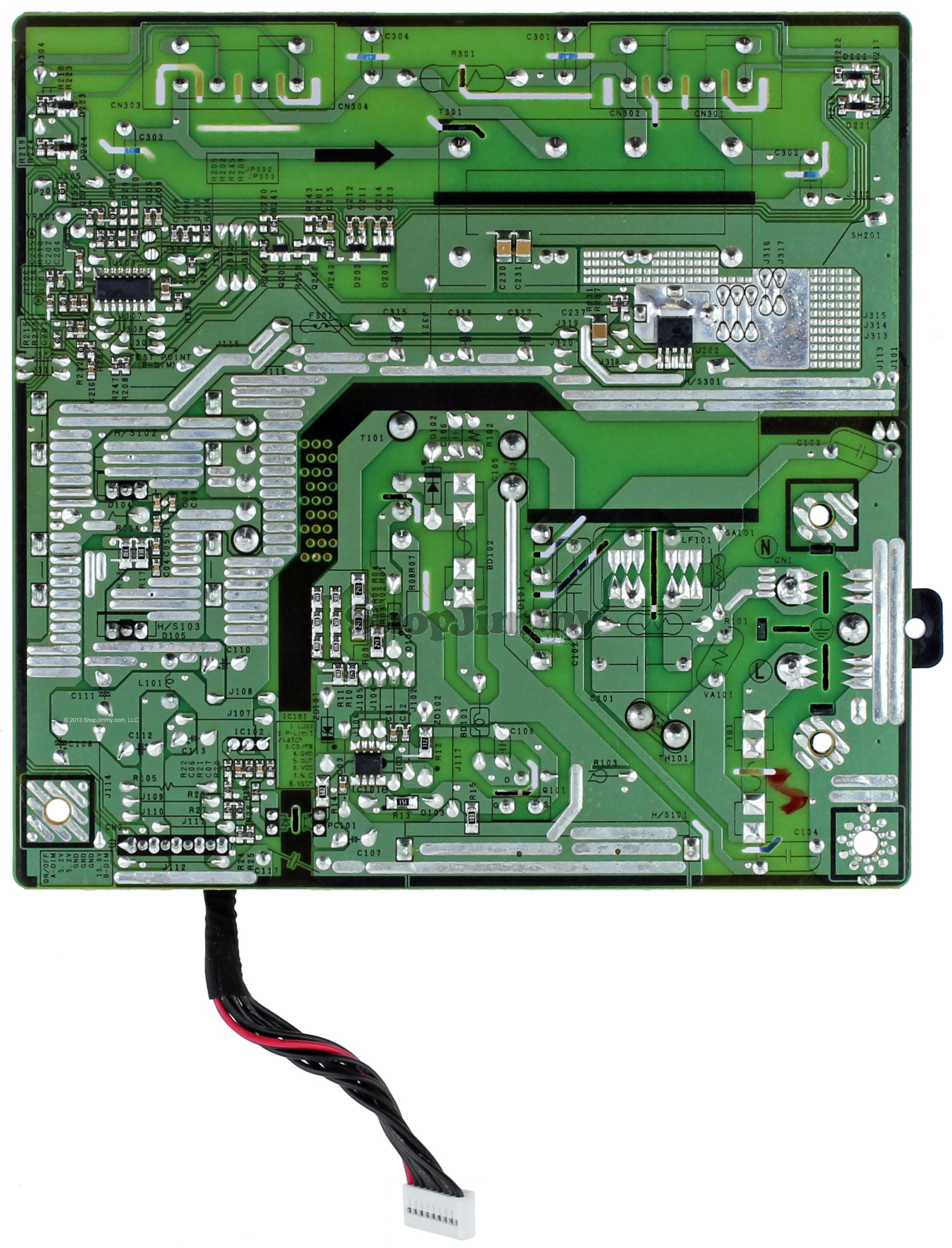

Samsung BN44-00232A (IP-54135T) Power Supply for LN22B360C5DXZA
http://www.shopjimmy.com/samsung-bn4...er-supply.htm#
No PFC Voltage booster on this power supply-inverter board.
Pictures provided by shopjimmy.
SMD SMPS IC1018 (or 'B'?) that drive the blown MOSFET is probably damaged when the MOSFET went out.
Resistor R103 for the SOURCE pin of the MOSFET may have blown open circuit also when the MOSFET shorted out.Attached Filesif you find these attachements useful please consider making a small donation to the site

if the tv back was still of could you look on your repalacement psu and tell us the details from IC1008 (part you could not read on old psu) thanks as this may help others too with the same issue.Comment
