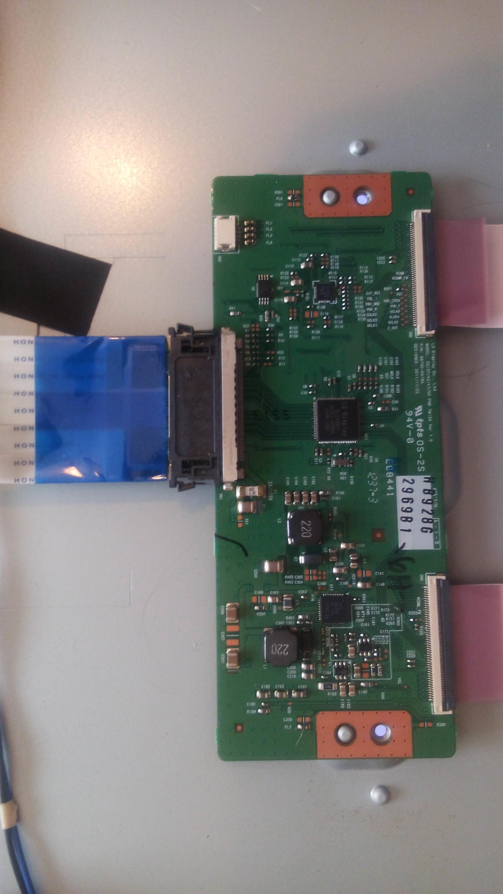

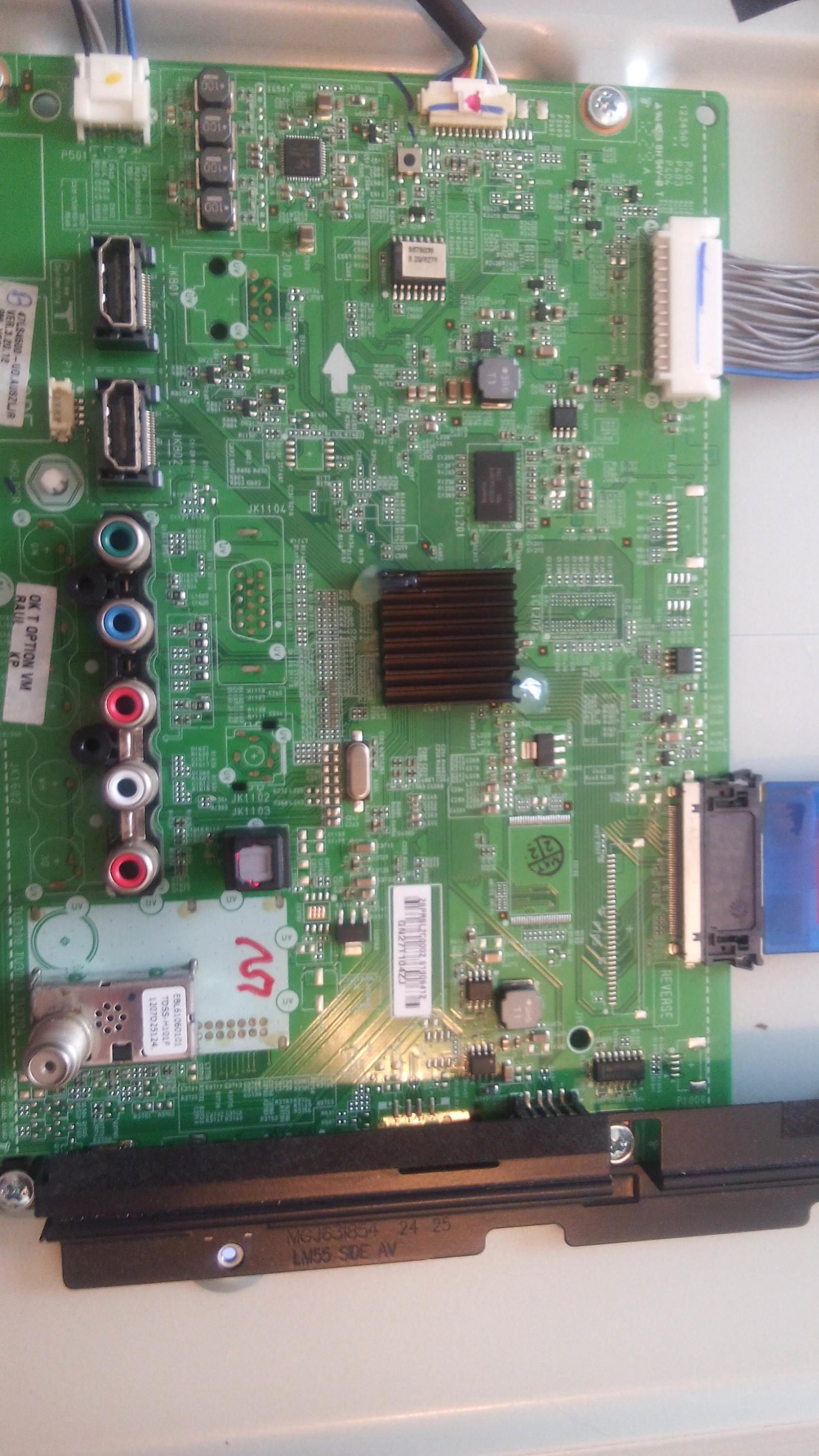

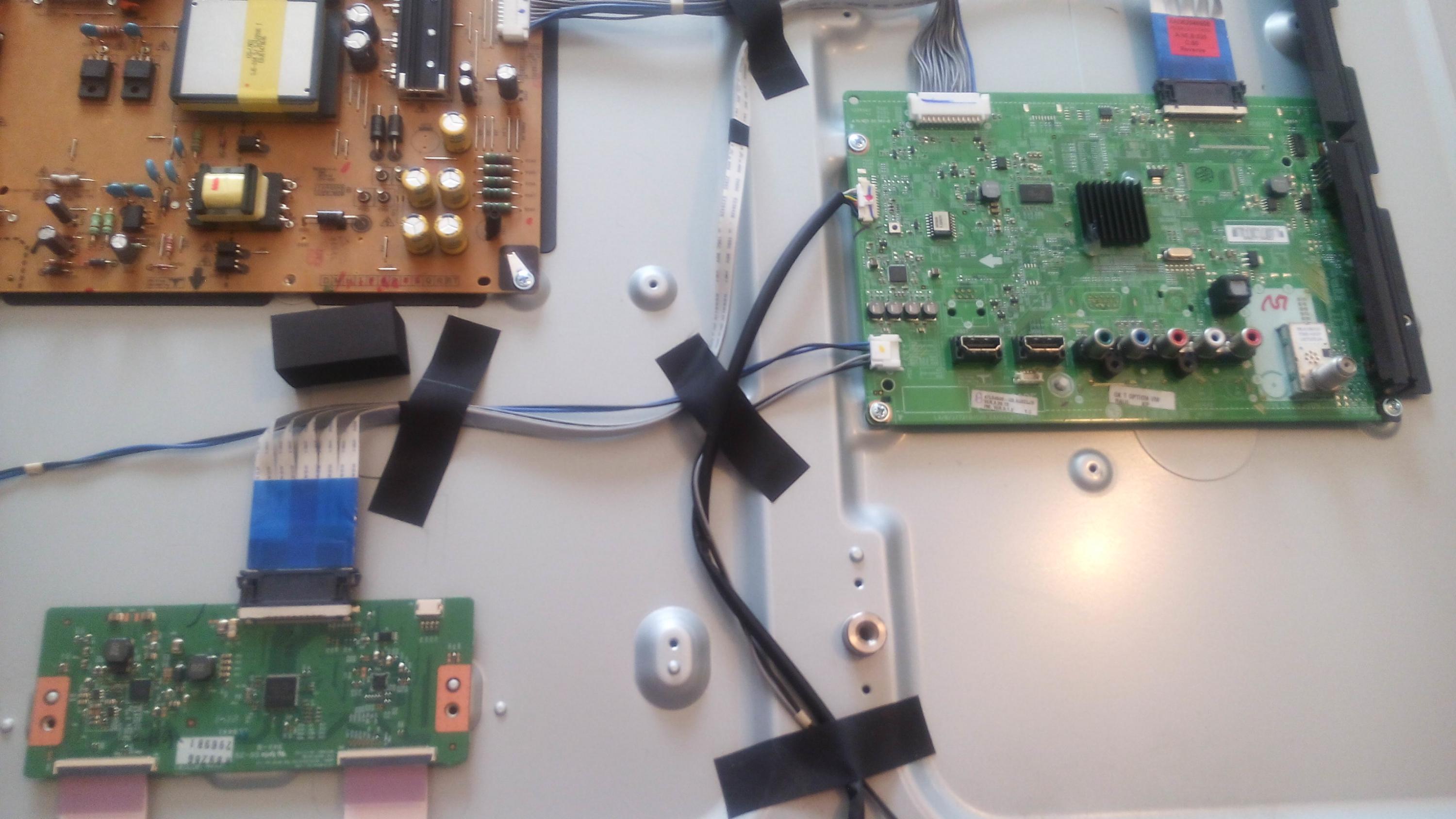

    LG 47LS4500 No picture, has backlight & sound
    I've tested the t-con's smd fuse, got 11.85 v on each lead. (using dmm set to 200 and with grounding to chassis). The out voltage ribbon from psb to main has all 3 12-volts present. I am assuming these would include the power supplied eventually to the t-con. I've also disconnected each of the panel ribbons, one at a time, and found that when the right ribbon is disconnected, I get half-screen of black with colored lines dispersed unevenly. When I disconnected the other side, the entire screen was back to as it is when BOTH ribbons are connected.(glow/backlit).

    Re: LG 47LS4500 No picture, has backlight & sound
    I'd guess a screen/panel fault. Not repairable.
