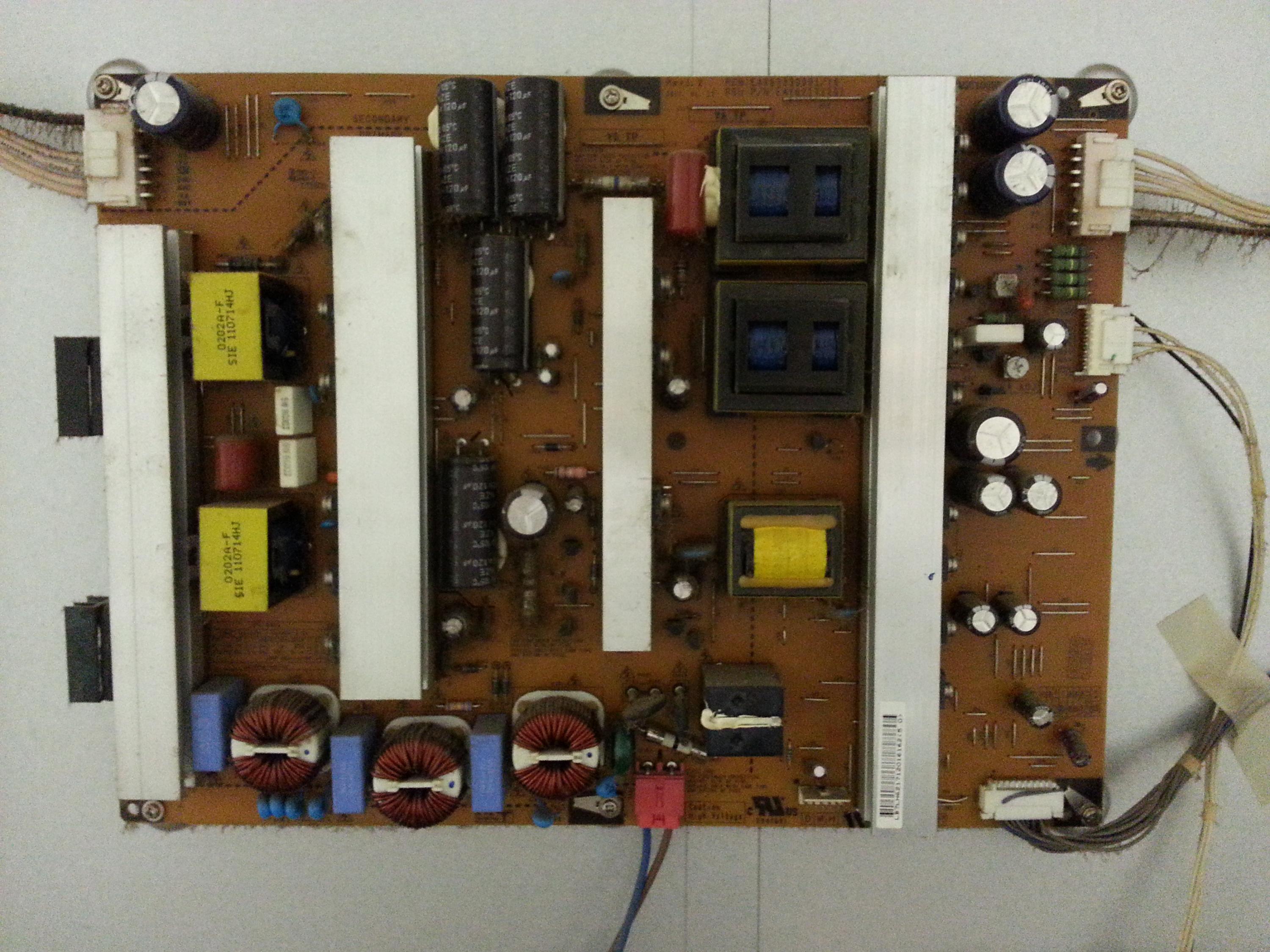

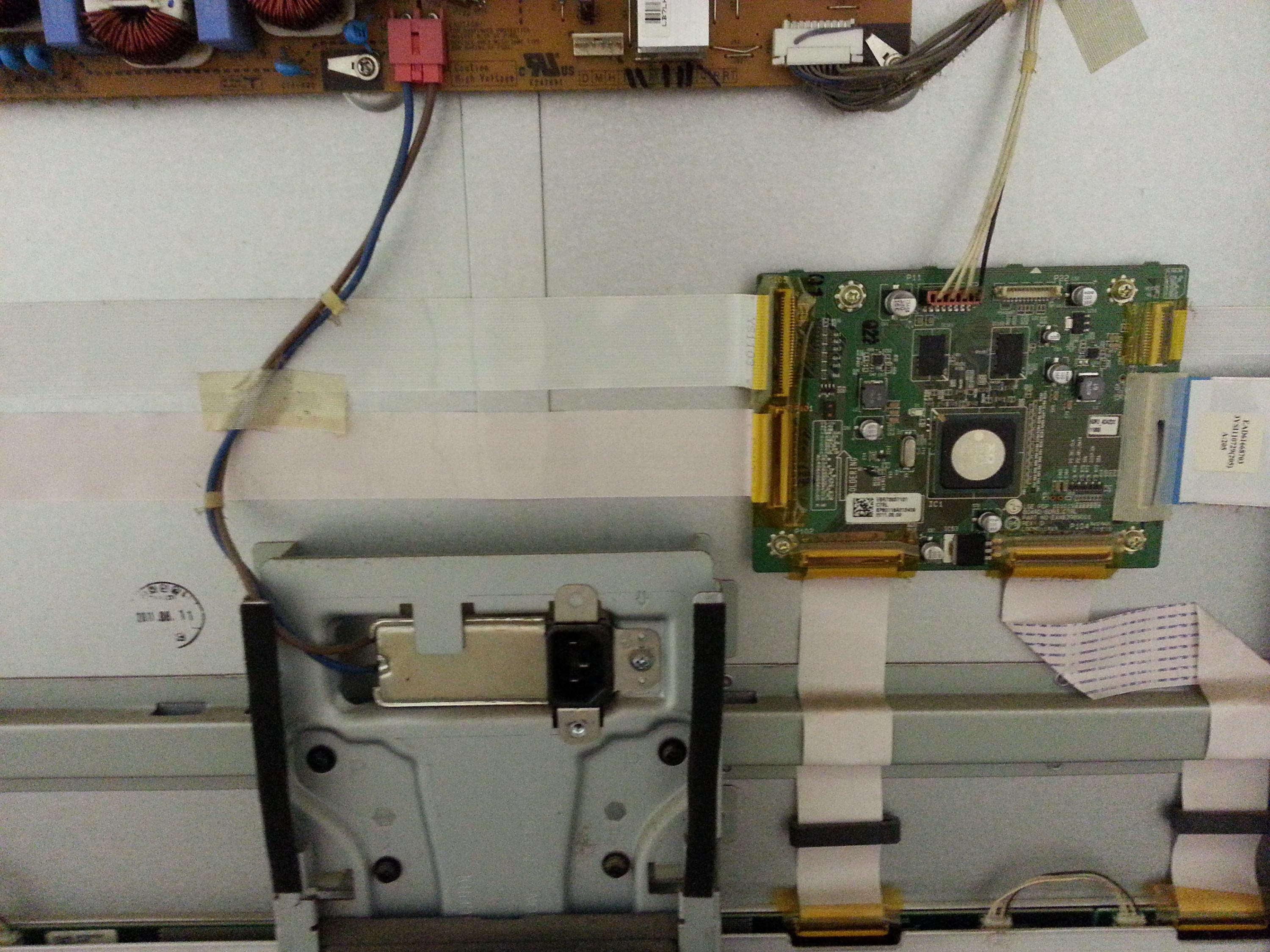

    I'm working on this newer (circa 2011) 60" LG Plasma and it's got me stumped. It doesn't respond to pressing the power button and I don't have the remote available to me. There are no power lights or anything lighting up on the front either.
    I removed the back cover and checked all the fuses I could see; everything checked out. Capacitors all look okay. And I already ruled out that metal box that the power cord plugs into because we've got line voltage on the red connector plugging into the power supply. Any ideas on where to go from here?

    What voltages do you have on the power supply?

      Fixed!
      Good call. I didn't have time to troubleshoot the power supply piecewise, but I was able to replace the whole board for a reasonable price, so I will likely just sell the old one on eBay for somebody else to fix up .
      Case closed; Plasma fixed!

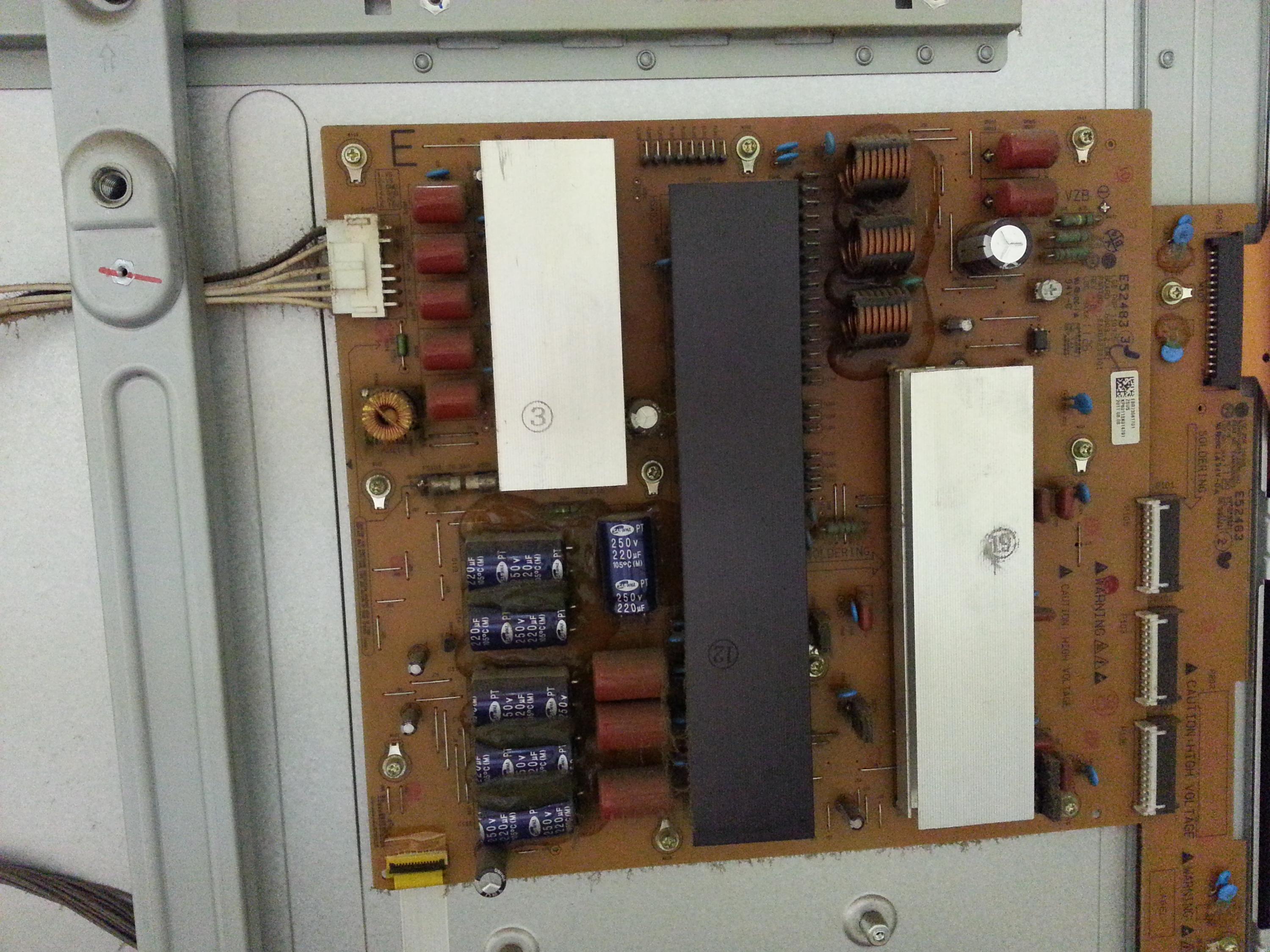

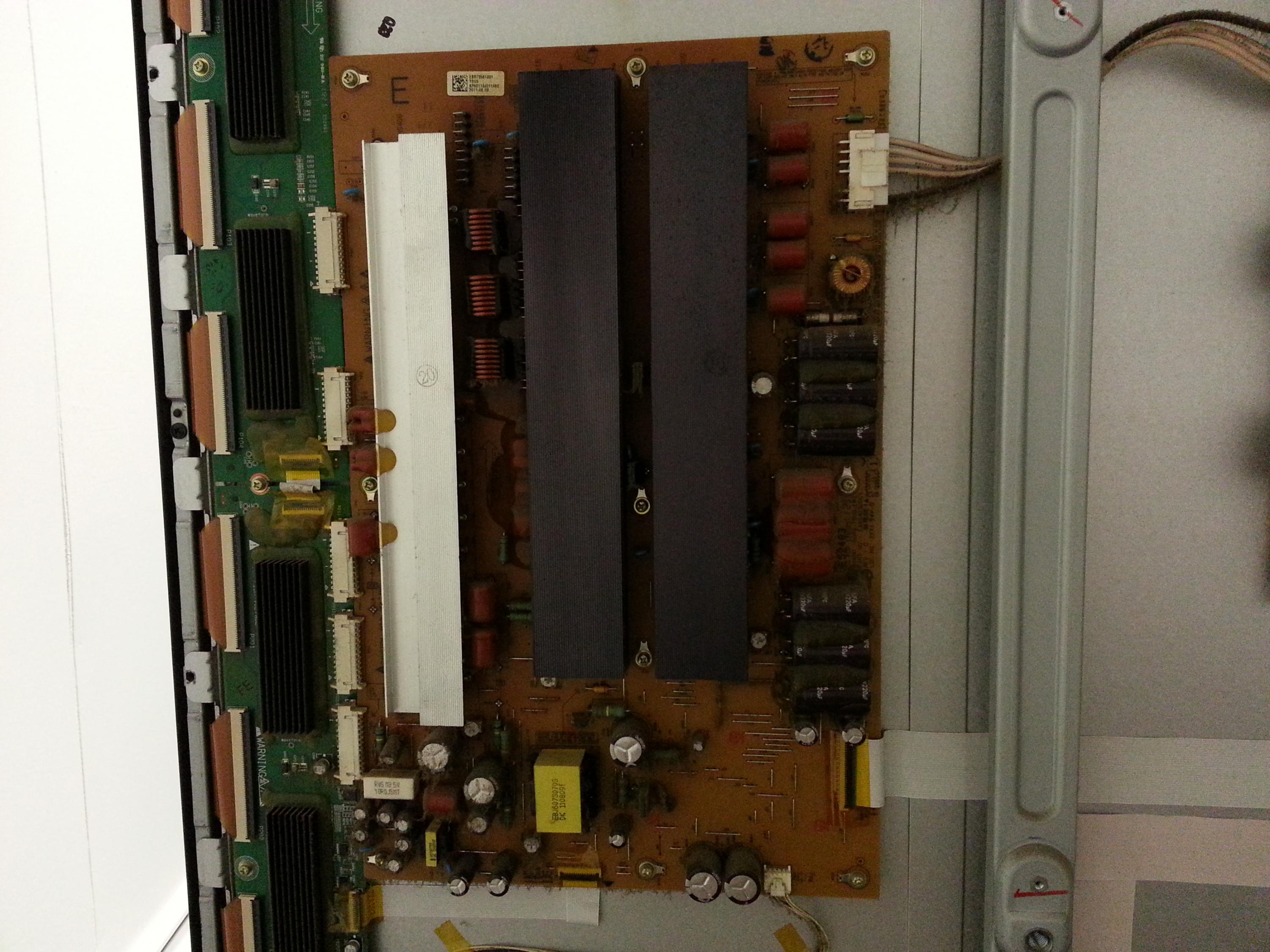

        Good work, I also strongly advise you resolder all the coils on the Xsus and Ysus help it last longer.

          Definitely get those inductors some new solder! highest cause of these sets failing!
