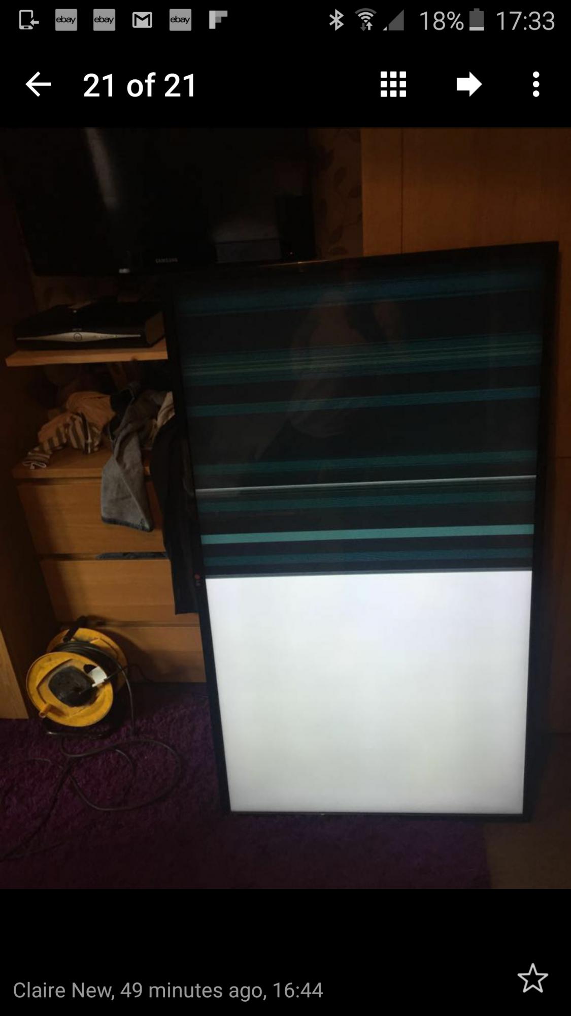

    LG55LN575V bad panel?
    I'm new here, found this forum whilst looking for answers to my latest tv trouble shoot and I'm looking for advice/help with a LG led tv.
    I'm hoping it's not the panel at fault but let me know your thoughts?
    When turned on the screen lights up and a band of vertical thick lines appears and the slowly makes its way across the screen from one side to the other.
    Pressing volume up/down on the remote brings up coloured vertical thick lines down the panel in the area in which the volume is usually shown, same thing for channel up/down ect.
    I have no normal picture.

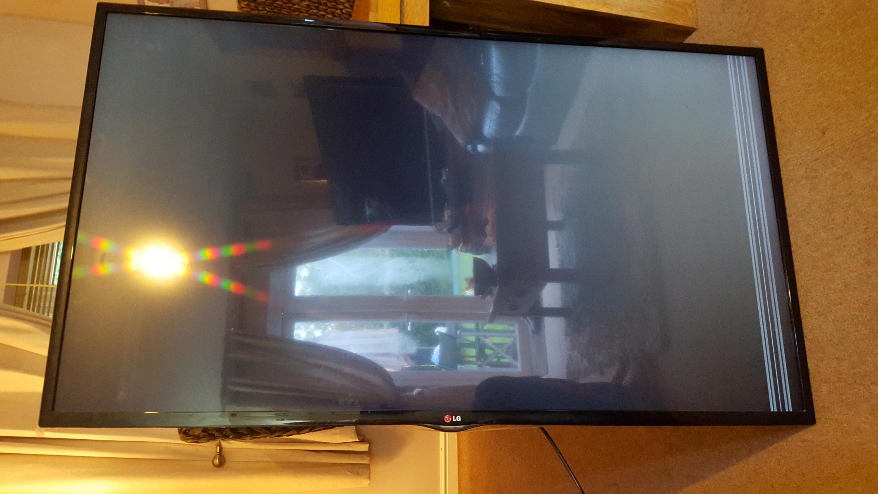

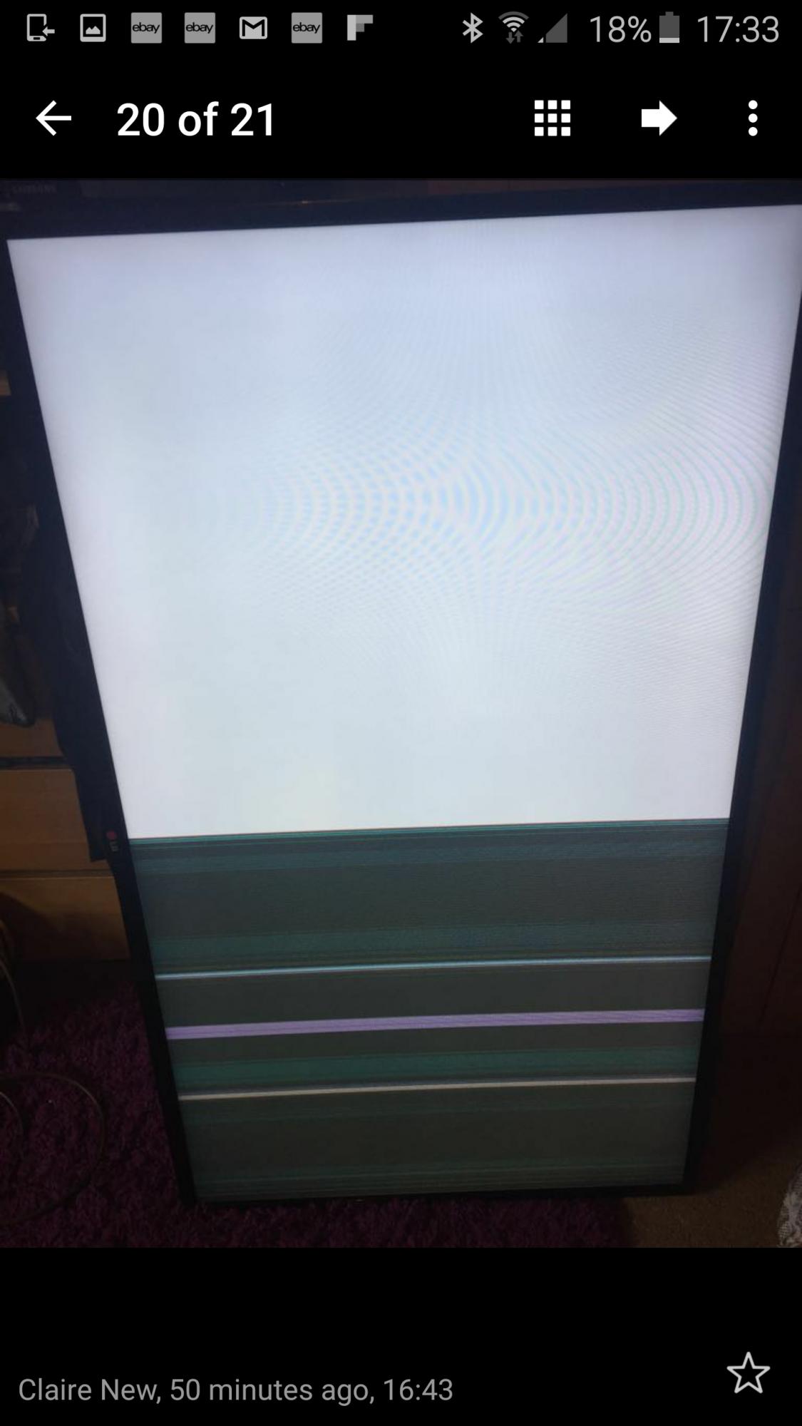

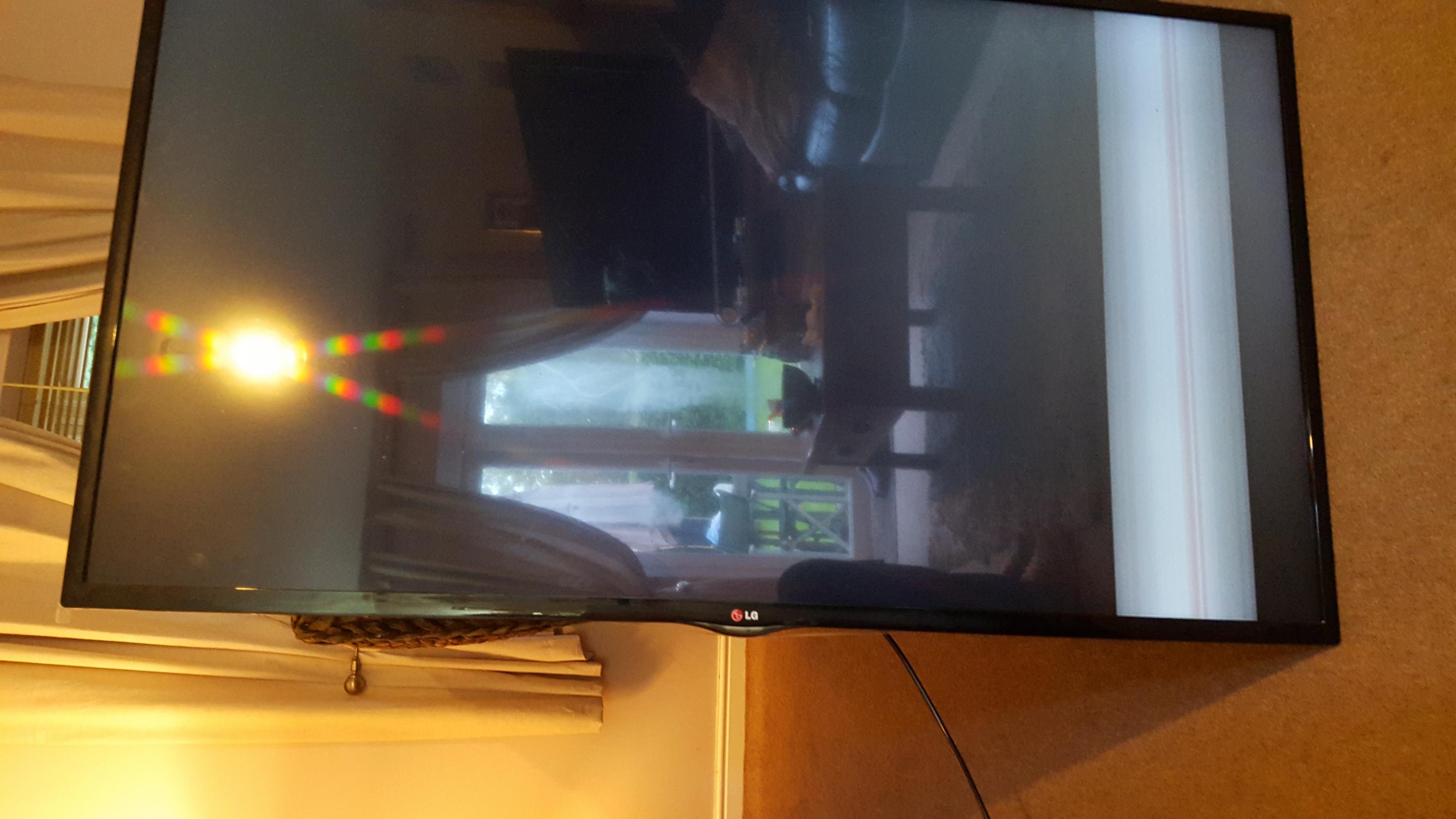

          Re: LG55LN575V bad panel?
          Here are some photos,
          The first one is pressing the volume buttons on the remote, the seccond is when I pressed the channel buttons on the remote.
          The third and forth are what I see creeping across the screen.
          I will do some further tests after work.
          Thanks for the advice so far.

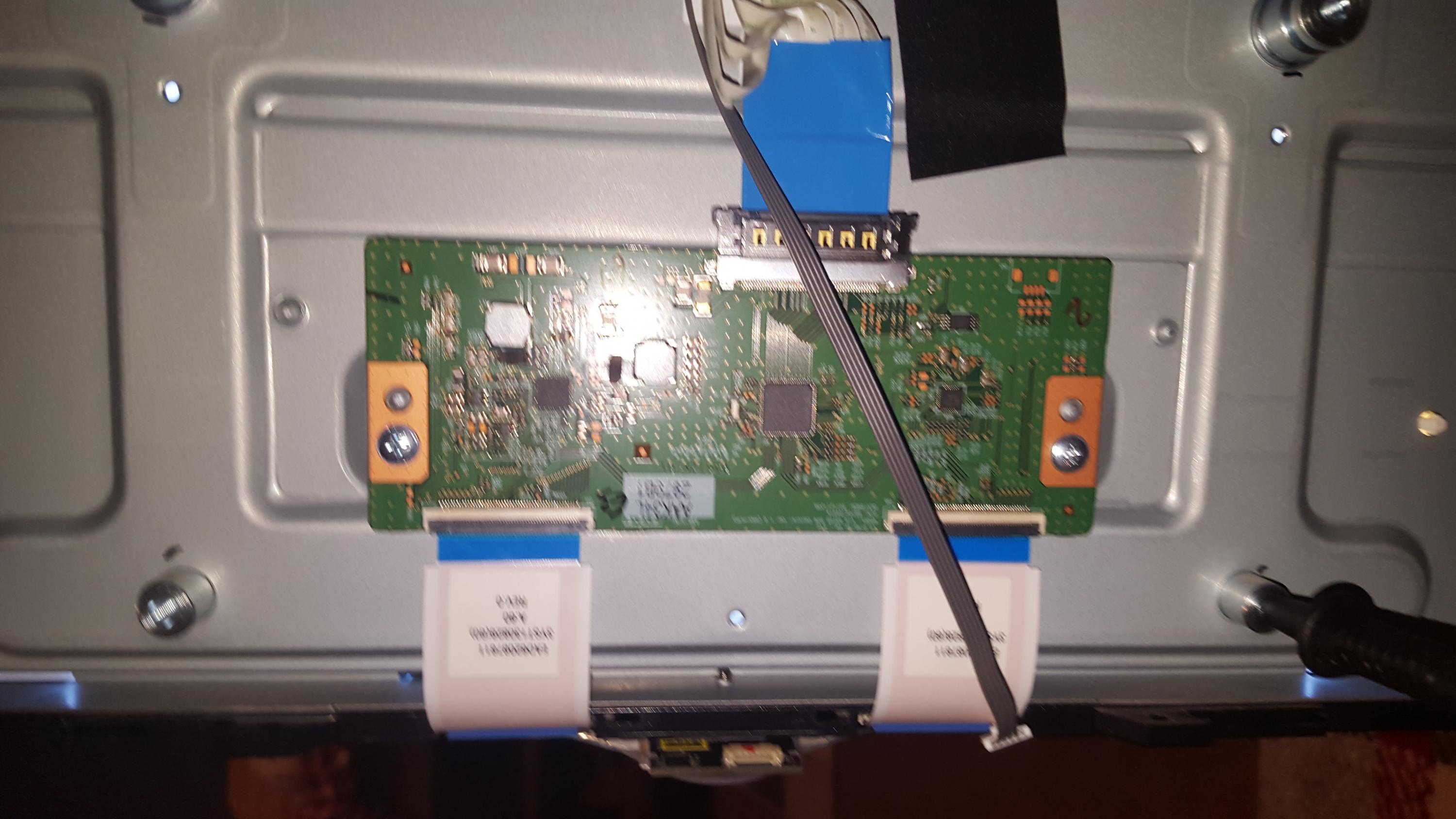

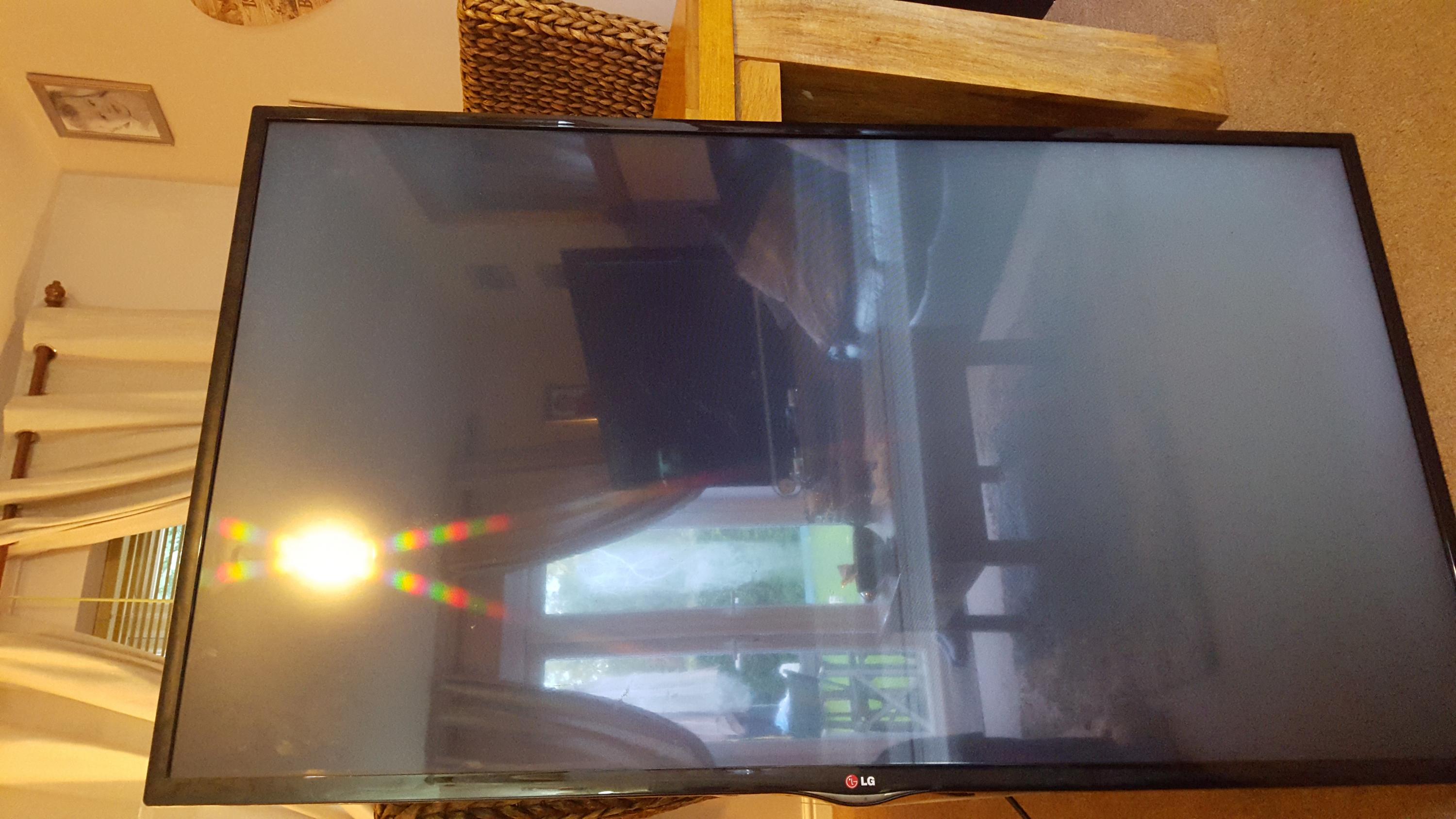

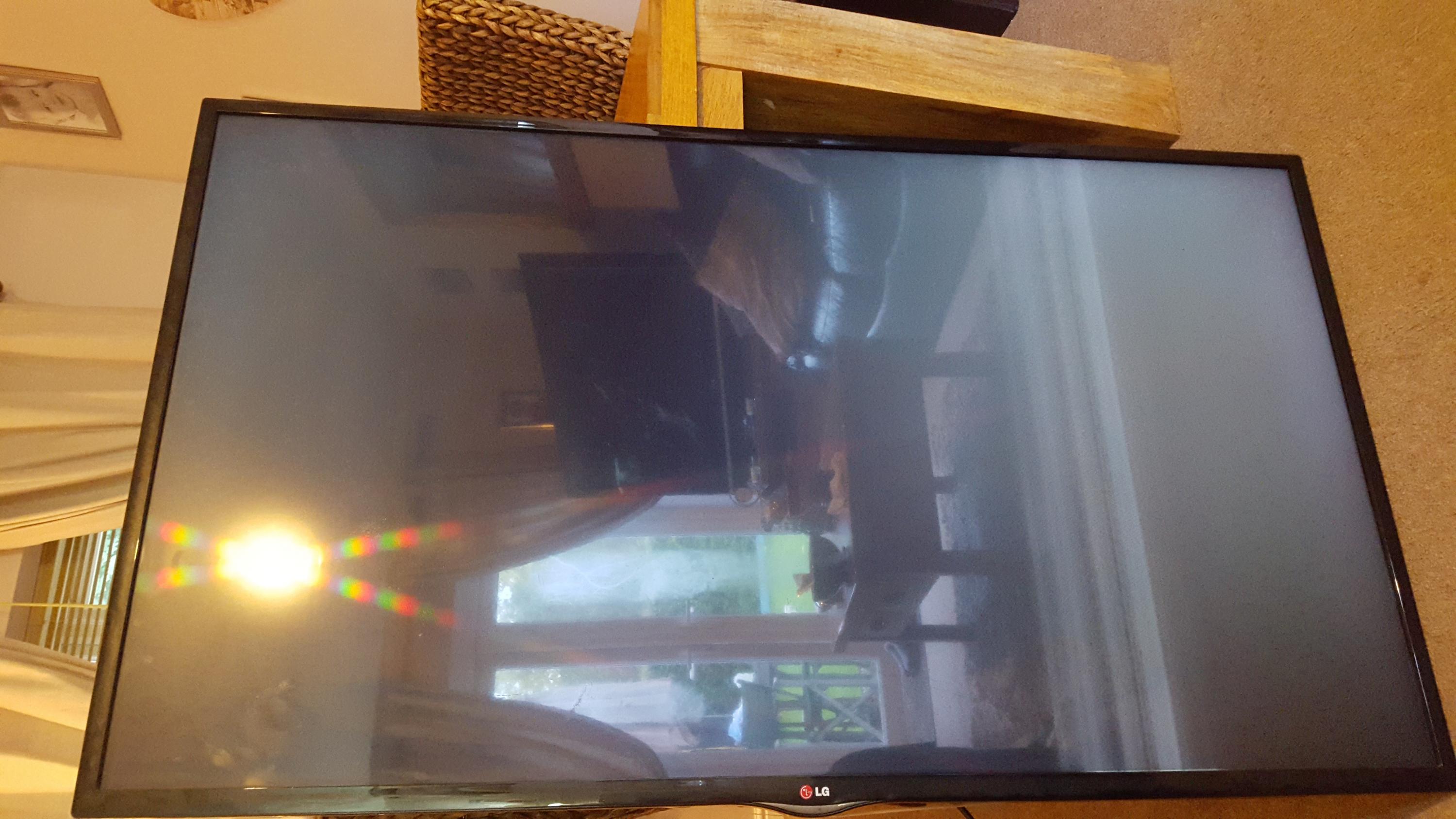

            I disconnected the tcon board a ribbon cable at a time and these are my photos. Screen still had no images but was more stable, and oddly I have sound after unplugging and really plugging in various connections.

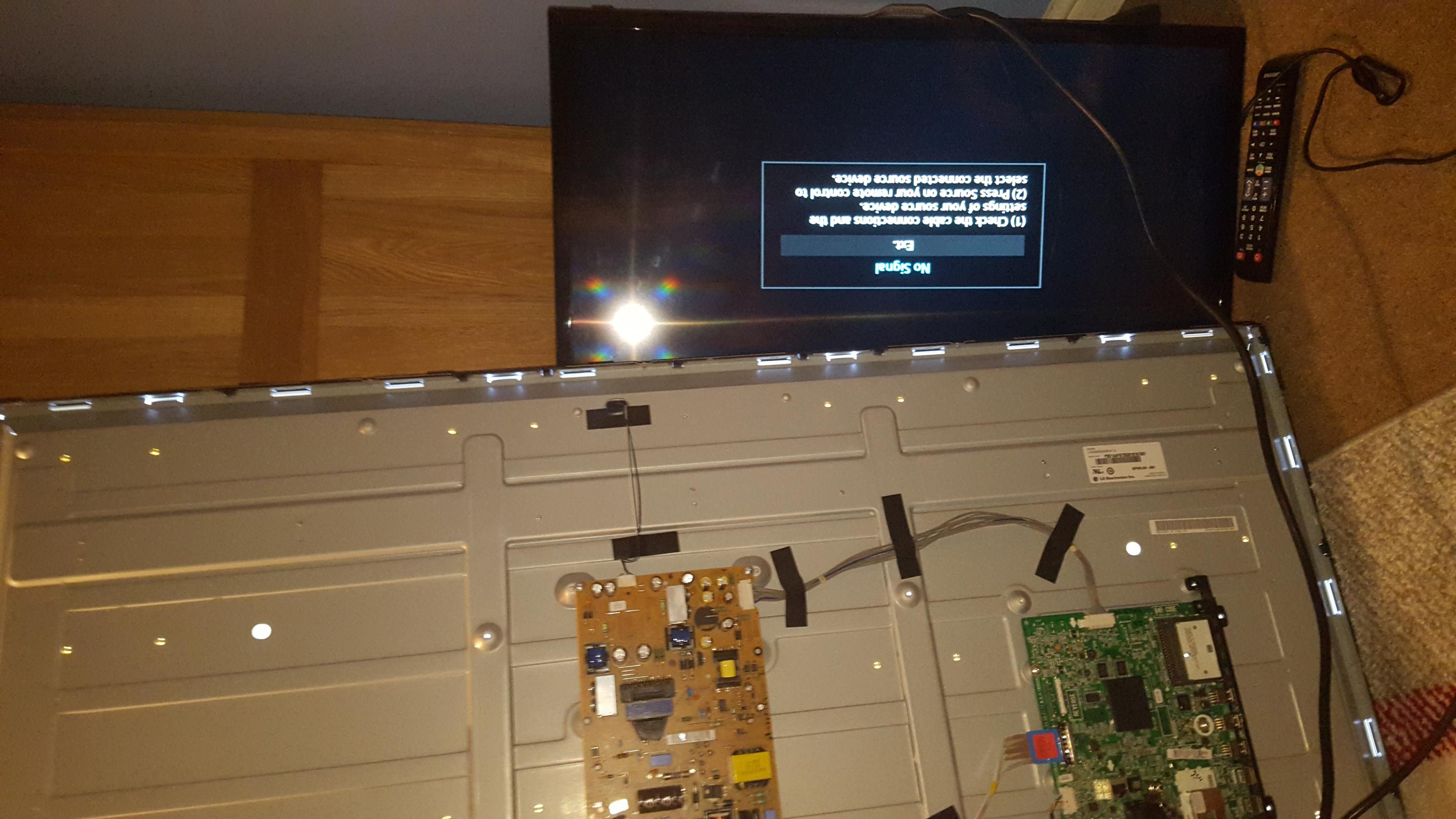

                        Fitted another main board and the problem is the same, had another look and press and check of the bonded ribbon cables to the panel and these are all really good and make no difference to the display when pressed. Could the panel still be bad?
                        Is it worth me trying a tcon board?
                        Cheers Aaron

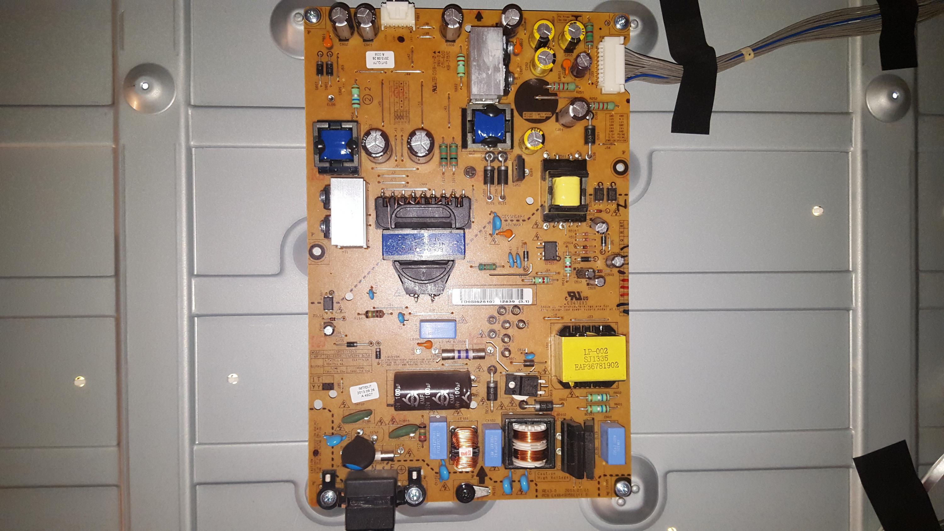

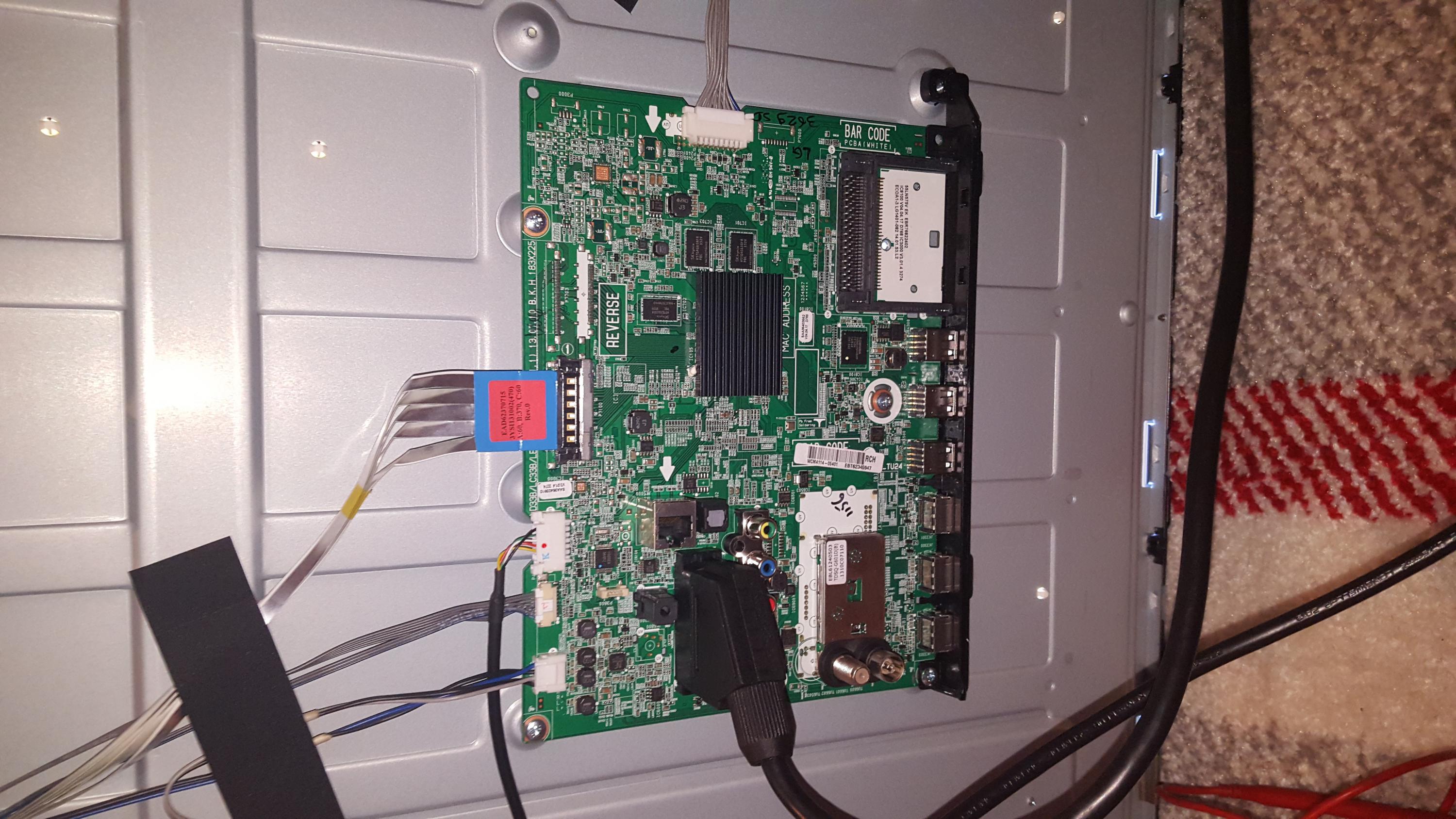

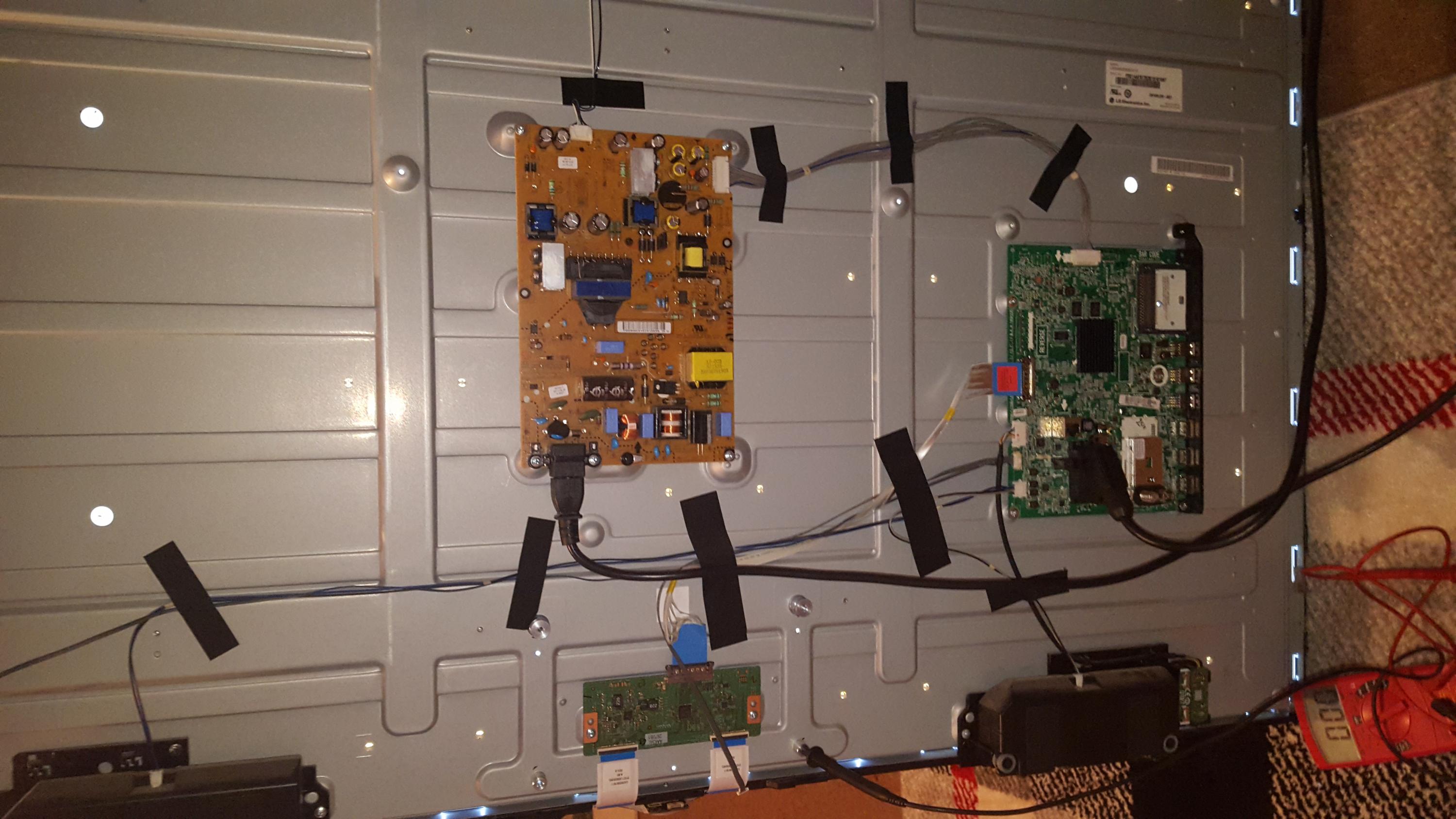

                          • Diah
                            • Feb 2013
                            • 6593
                            BTW can you post photo to whole Boards on this TV ?
                            also check the T-CON Fuse ( F1 2A/125V ) read the voltage of it from both side by black probe of yours DMM to GND and the red on F1 pins

                              • Azza111111
                                • Sep 2016
                                • 43
                                • England
                                Here we go..

                                  you need to put RF signal in LG and it should have sound.. then plug the scart to other TV as scart input... it show you the content of the signal.
                                      Sorry I've been a twat, I will connect an aerial and check again later. My bad!
