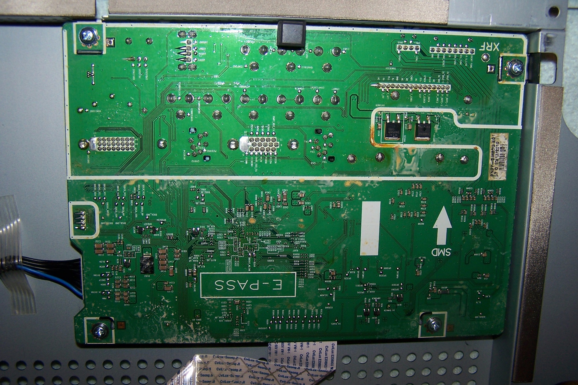

    Main board looks like it may have gotten wet on one side of the board (no clue how or when, it's one owner, well treated) due to orangish rust on some traces, and whitish residue. Otherwise, same as power board, no obvious signs of physical damage.

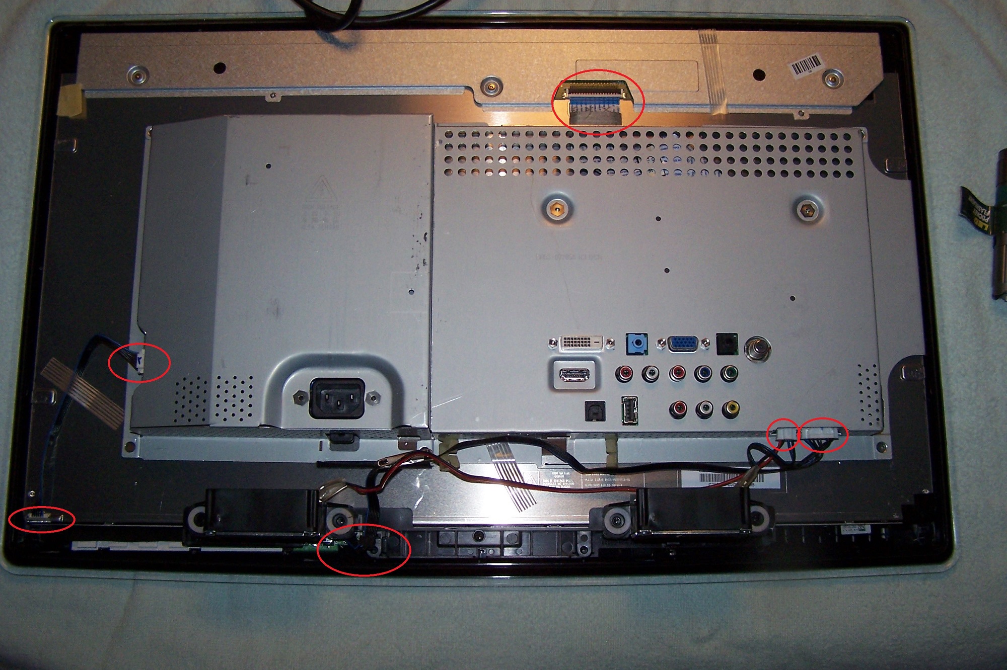

    We need good clear pictures of the screen shot to see what the pictures look like, then we need the pictures of the whole backside of the TV so we can see all the boards and how they are connected together, and the pictures of the 'orangish rust on some traces, and whitish residue.'

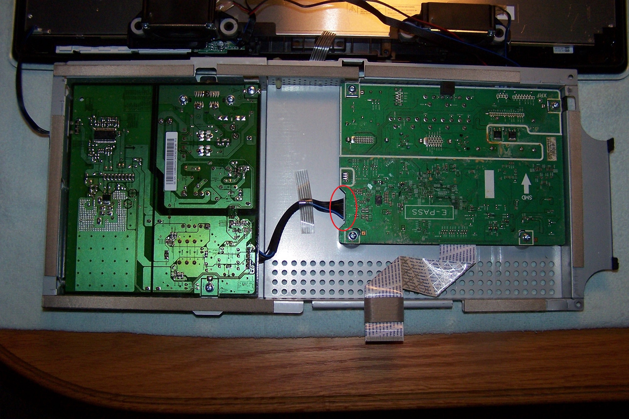

      Photos attached. I circled connectors.

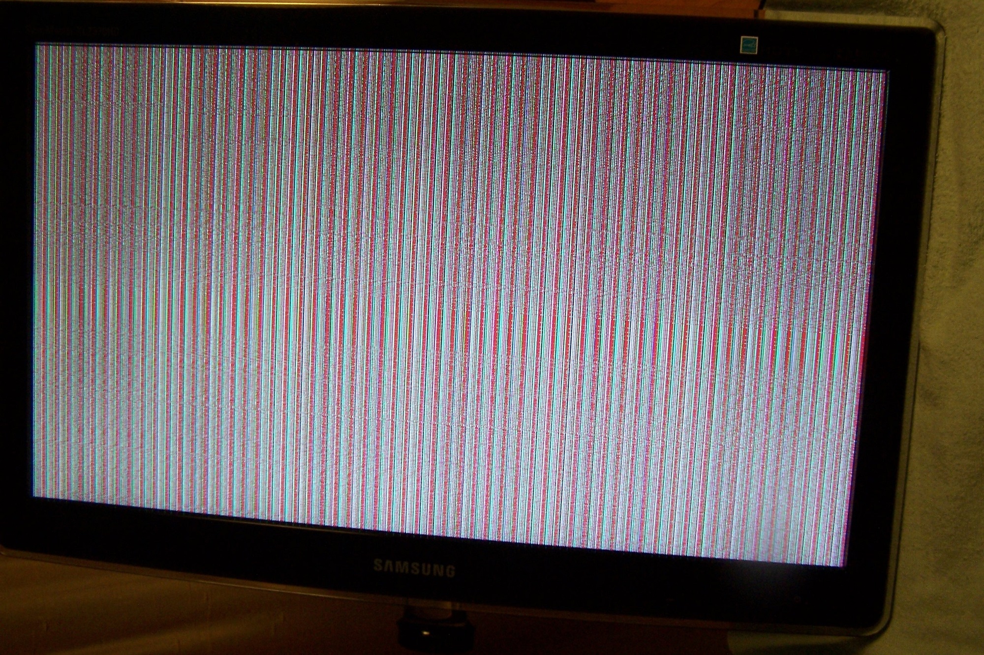

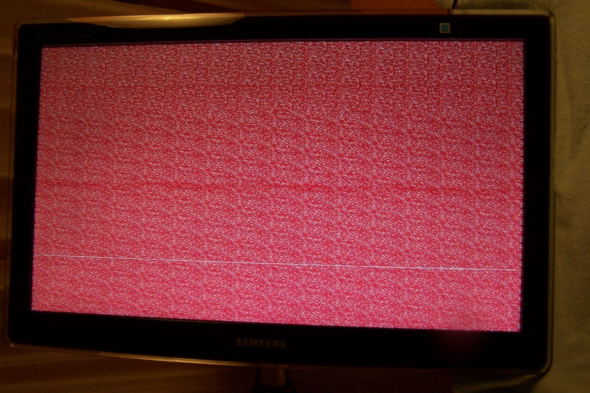

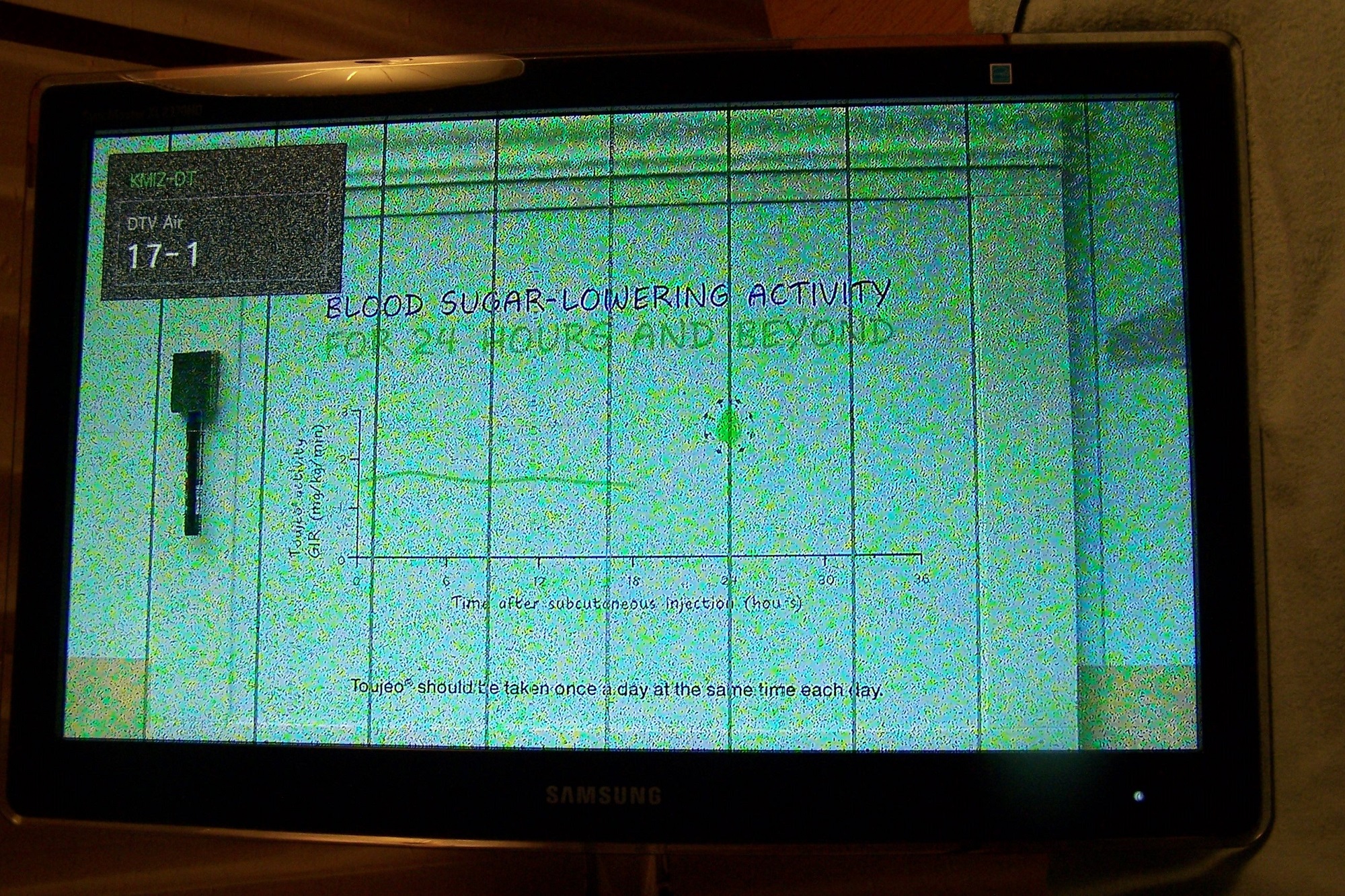

      Failure mode has changed slightly. Now the tv will work ok, then show 1 - 3 of the video freeze styles shown, go black, then turn back on and repeat the cycle. After half a dozen cycles it went black and stayed off.
      All freeze photos are of static images, nothing is moving. The color of the freezes varies with what was on screen when it froze. These three were not in succession, not from the same failure cycle. It goes in order freeze1, freeze2, freeze3, black, but any 1 or 2 of the steps may be omitted before it goes black.
      I have a phillips #2 to swap boards.
      I have a 40W iron, solder, solder sucker, solder wick, various small tools, basic multimeter (V, A, Ohm.) Have experience with desoldering and soldering larger components (resistors, caps, etc) but don't try on the tiny surface mounted stuff.

        I would have to say it is n=main board problem.
        I cannot tell if those stains are flux or not. You can use 90% (or higher) isopropyl alcohol for cleaning the residue.
        Also make sure all the boards mounting screws are tight.

          Is it likely heat related, since it takes a shorter length of time on each consecutive restart, before it stays off? Can I spot blast main board components, and see if any improve duration?
          I've seen flux residue and am pretty sure this is not.
          I'll try a cleaning and check the screws.
