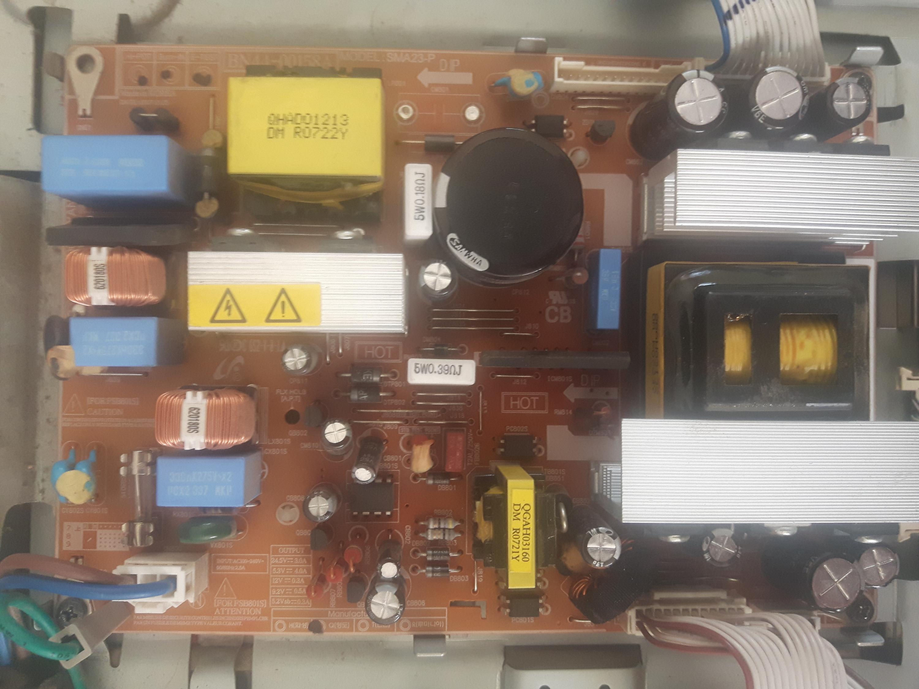

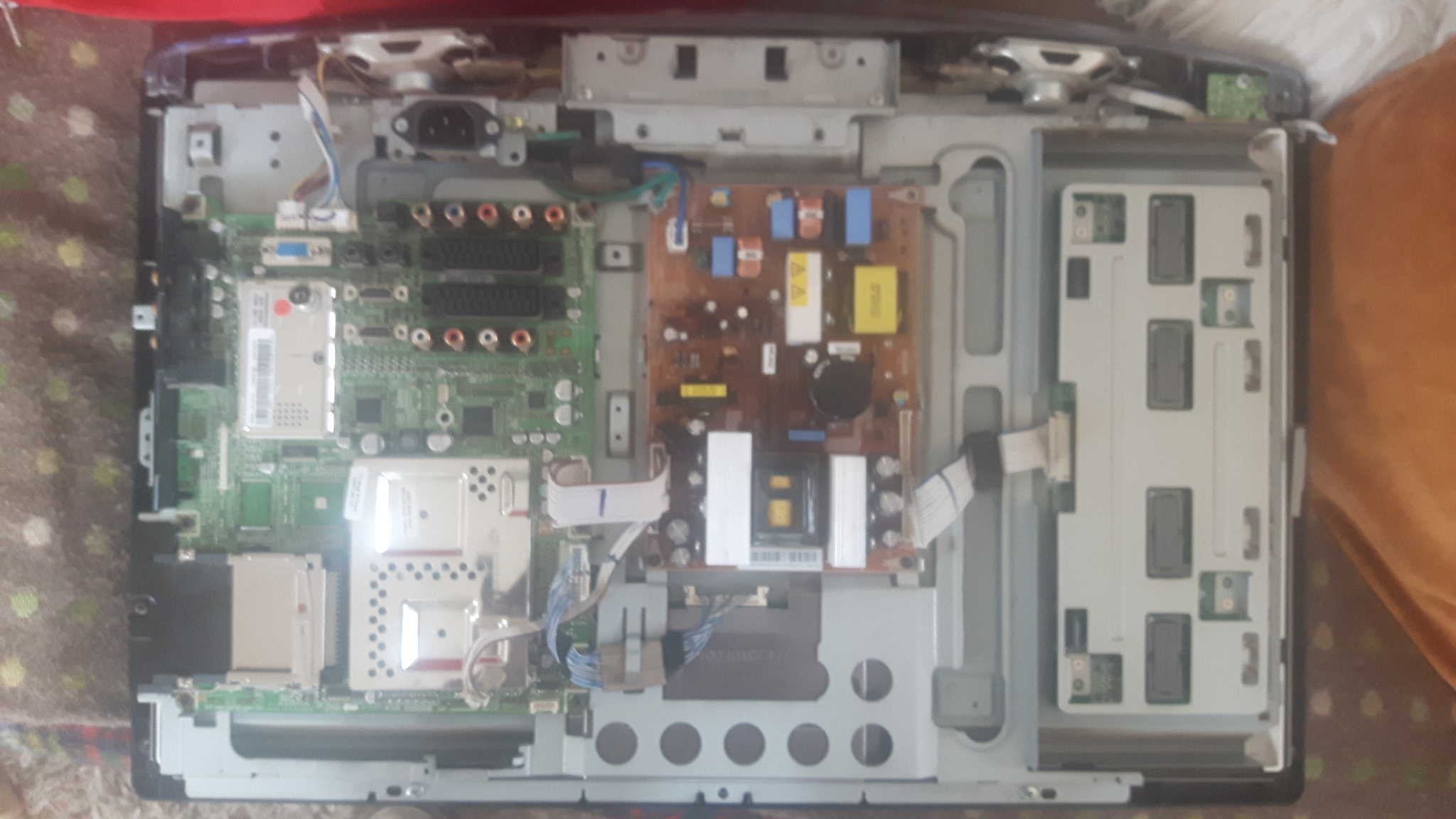

          Right guys, I've taken the back off, no obvious signs of damage or domed caps. The voltage on the standby pin is all over.. goes all the way up to 9v and back to 1v when it says it should be 5.2v.. unplugged main board and it still does it. Assuming this means the PSU is at fault? Apologies for the poor quality pic. Hope it's ok.
          Thanks.

            The inverter connector is only unplugged from when I removed the board to check the underneath. It wasn't run like that.

              We need high resolution, sharp, straight shot picture of the PSU, so we can read the details of the PSU.
              Is the PSU a BN44-00158a?

                Hope that's a bit better CapLeaker.

                  Yes it is 👍

                    Bottom right corner, there are 3 caps. Is one of them for the 5VSB? CB852?
                    Anyway... those 2 caps in the corner look like they got hot, as the plastic around it shrunk.

                      One of them is a CB852 yes. I'll take it out and check the capacitance and let you know. Thank you again.

                        I am pretty sure you have to replace those 2 caps. I think the one in the very corner is the one for the 5VSB. Replace both of them and retest.

                          Thank you so much CapLeaker. Swapped out that 10v 1000uf CB852 and the diode as well as it measured very low. TV works perfect. Fired up instantly and I've turned it on and off a few times just to check. First time I've come across a bad cap that wasn't visually deformed. Thanks once again and for your time. Such a great forum.
