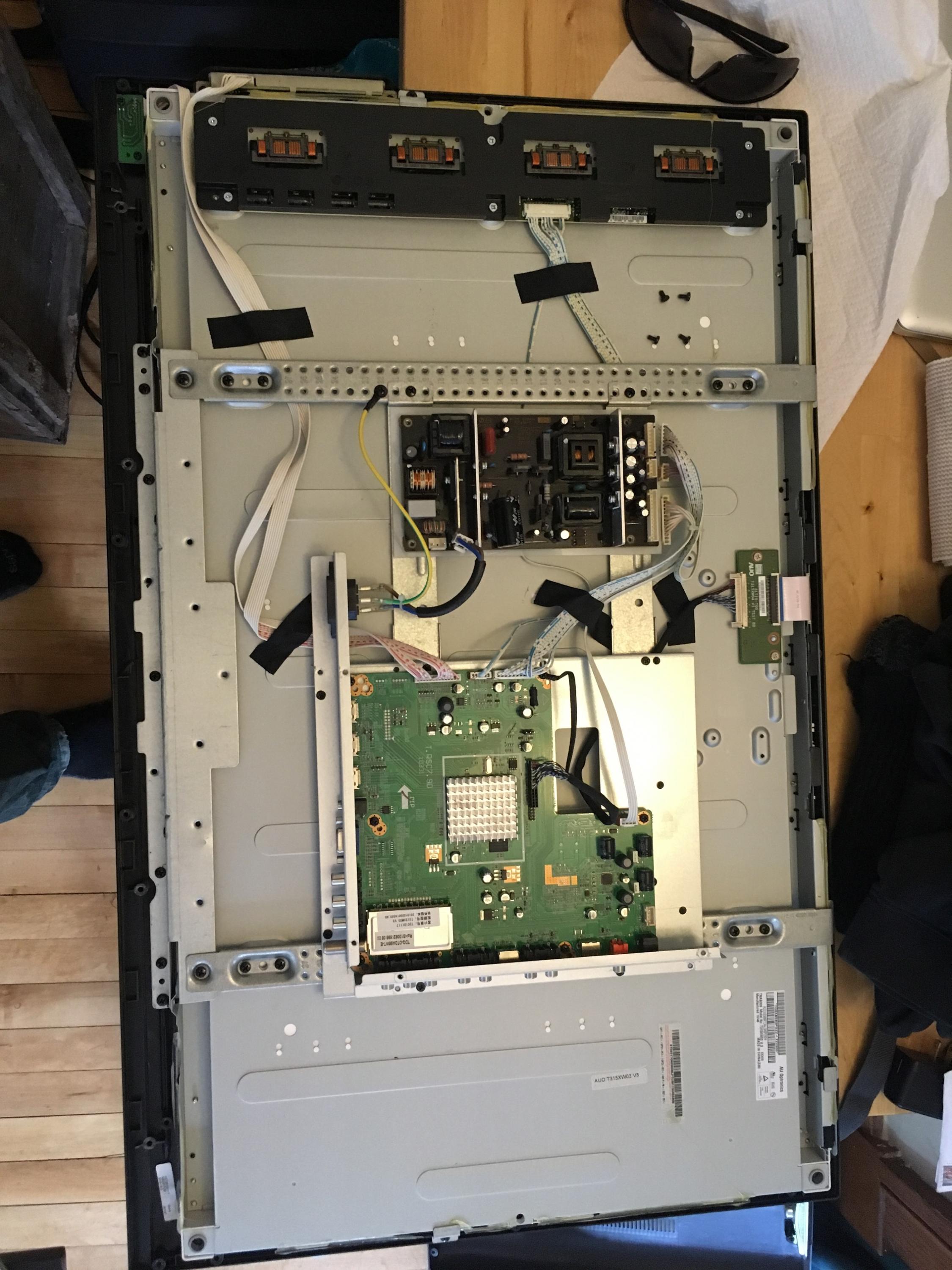

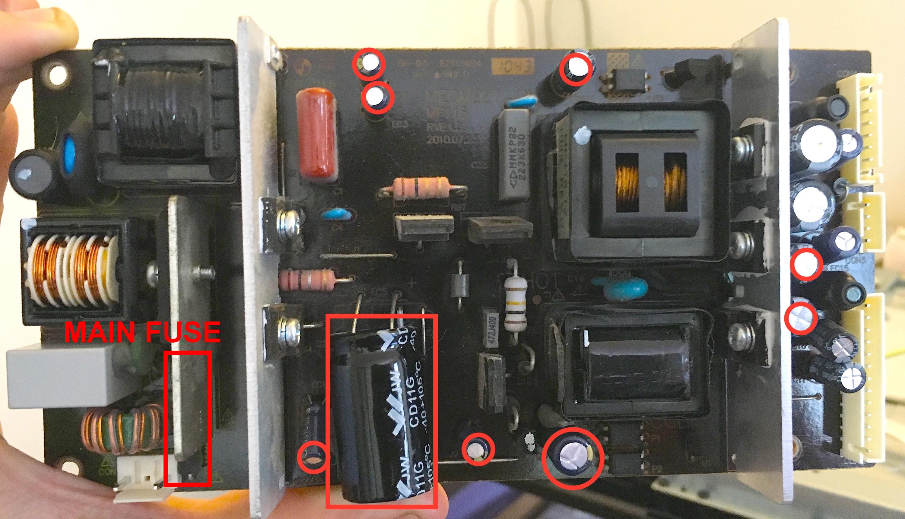

    A co-worker found this TV on the curb by his house and pulled it for me. I inspected it and the panel looked undamaged. I plugged it in and it had no signs of power at all. I opened it up and found the classic bulging capacitor issue. I ordered replacements for the bulging caps and replaced them. I plugged it in and, again, no power signs whatsoever (no LED, no "click").
    I searched on this forum and found someone with a similar model who had a similar issue, so I extrapolated mine from theirs and ordered/replaced some more capacitors on the PSU. Tried it again and no dice.
    I'm not getting a click/LED at all, so it must be the 5VDC, but I'm unsure how to proceed in testing it. I have a multimeter (but no car lights), and I looked through the basic troubleshooting guides, but I was unable to discern how to use the DMM to test.

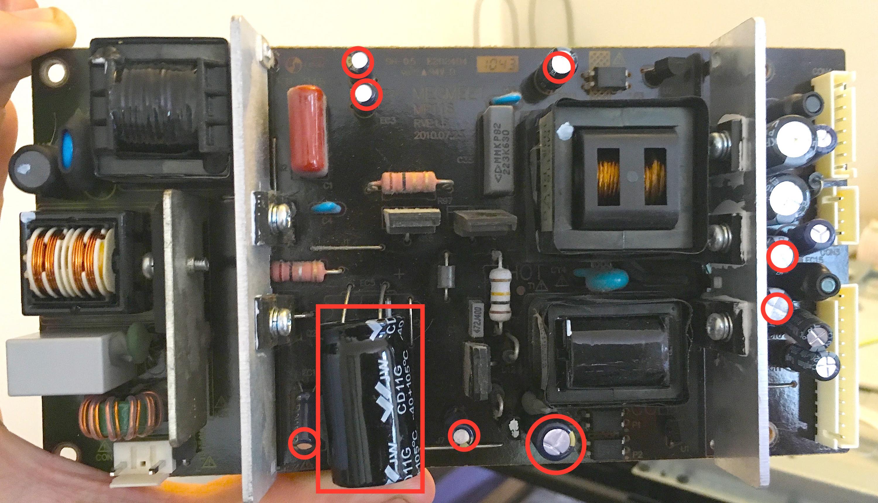

    I've attached a picture of the PSU with all the capacitors I've replaced highlighted. The huge capacitor in the middle and the two at the far side were the only obviously bulging ones. I replaced the others in the middle section after finding the other post about this set (which admittedly had a different symptom).
    How should I best proceed when my persistent issue is no power whatsoever?
    (Note that I can see nothing else obvious inside the TV: no blown fuses, no blackened areas, nothing obvious. I have repaired a few sets in the past and typically replacing the bulging capacitors is enough.)

    So you do not even have 5VSB between 5VSB pin and the GND pin when running the power supply by itself? If that is the case then you need to find out if you have 160VDC between the two legs of the main filter cap or not first.

      Re: Sceptre X322BV-HD - No Power
      So I mounted the PSU and plugged the main power harness into it, but none of the smaller connectors. I put the DMM on the +5 and 5VSB and the GND pins and it read 0. I tried all the pins and they all read 0.
      Which cap is the main filter cap? I tried going across both legs of the huge cap and got 0 there as well.
        The biggest one laying on its side.
          I put the DMM across both legs and it reads 0. So does this likely mean there is an open circuit somewhere before it?
            Cap on the lower right wasn't bulging... It's just the factory stamping...
            As a rule, look for bulging in the center of the top...
              is it just me as i cant see a mains fuse on that psu?
                The image I attached with the highlighted caps is 100% post replacement. I looked through my photos and the only one I have pre-replacement is one of the big boy which was definitely bulging.
                  I don't see one either.
                  Are there LCD TV manufacturers who omit them?
                    But you said no blown fuses in post 1.
                    The fuse is shrink wrapped inside the black shrink tube right next to the AC input connector.
                    If the fuse is blown then you need to check the Bridge rectifier, the PFC MOSFET, the STBY power supply MOSFET, the 12V/24V power supply MOSFETs.
                      Looks like, through ignorance, I've made a liar of myself. I get no continuity through the fuse, and, pulling back the shrinkwrap, it looks blackened inside.
                      Thanks for your patience and persistence. I'll order a new one and replace it and go from there. Pretty foolish of me to replace so many capacitors without doing a thorough troubleshooting first.
                        When the fuse is blackened like that you have really bad shorted out parts on the board that you must check.

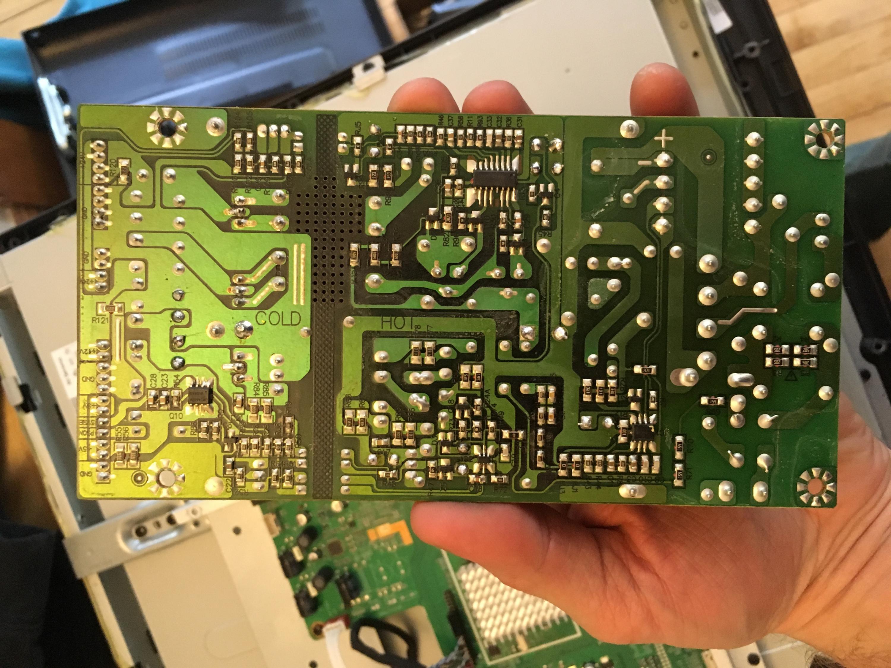

                          Any advice on how to check other parts? Nothing else looks damaged, and the underside of the board isn't blackened either. Could the failing caps have caused a short big enough to blow the fuse?
                            Do you know how to test bridge rectifier, and MOSFETs?
                            Get the P/N as printed on any one of the Power MOSFET, look up the spec sheet to get the pin out, you need to check the RESISTANCE between S (Source) pin and D (Drain) pin to see if it shows <10 Ohms or so, that will be bad MOSFET.
                            Look up the spec sheet of the Bridge rectifier to get the pin out to test the resistance of all 4 Diodes inside the bridge rectifier package for low resistance reading which will indicate bad bridge.
                                I rigged a new fuse and it blew instantly when I connected power, so I'll have to try and do the bridge rectifier/MOSFET testing you mention.
