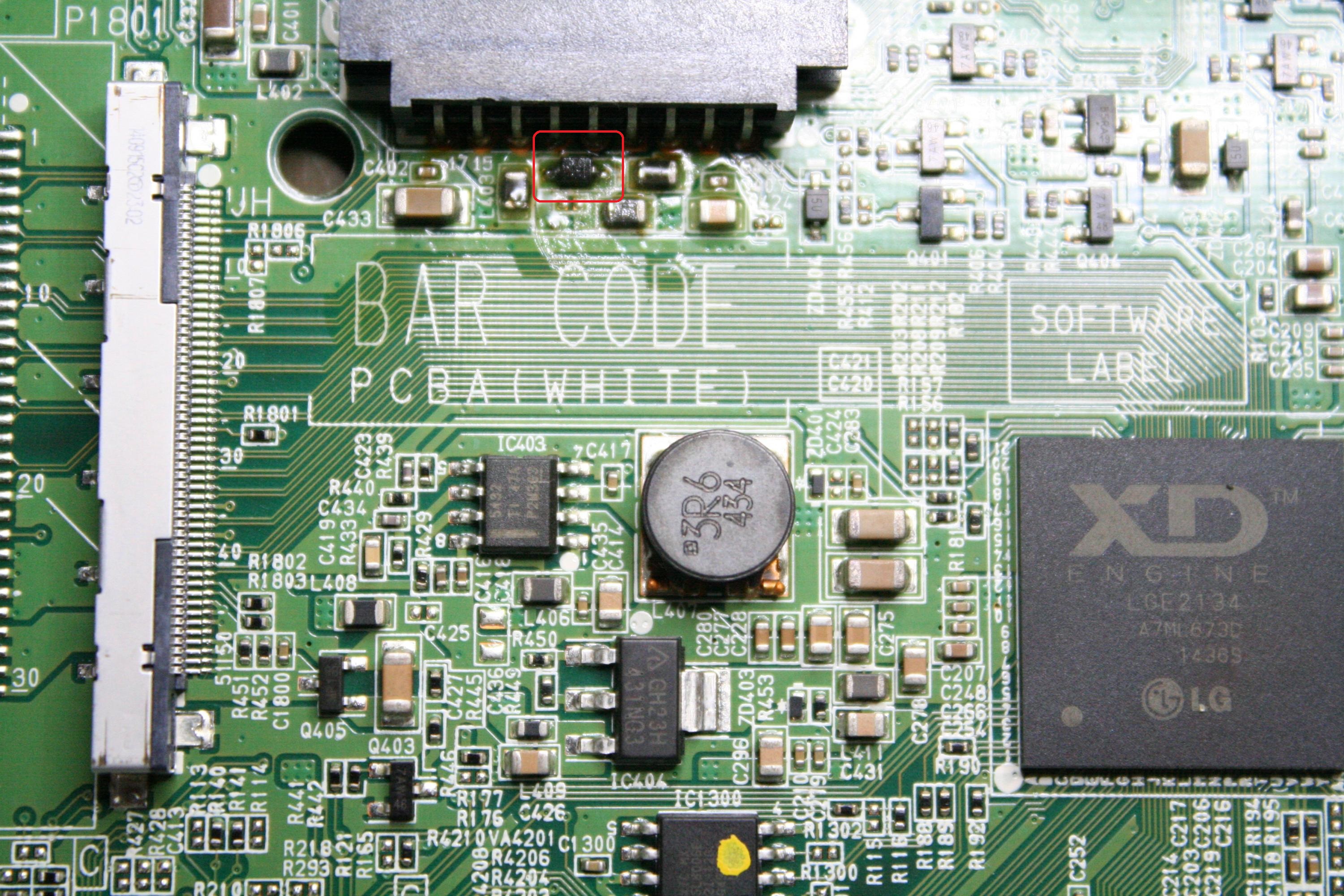

      Re: LG 42LB5600 TV with faulty EAX65361505 main board
      Here are the pics of the area of the main board where I THINK the fault lies. At the top, you can see the power connector. The 5VSB pins are the second and third ones from the right of that connector. I also tried a close-up of that IC if it's of any help....turned out pretty sh!t, so I apologize for that.

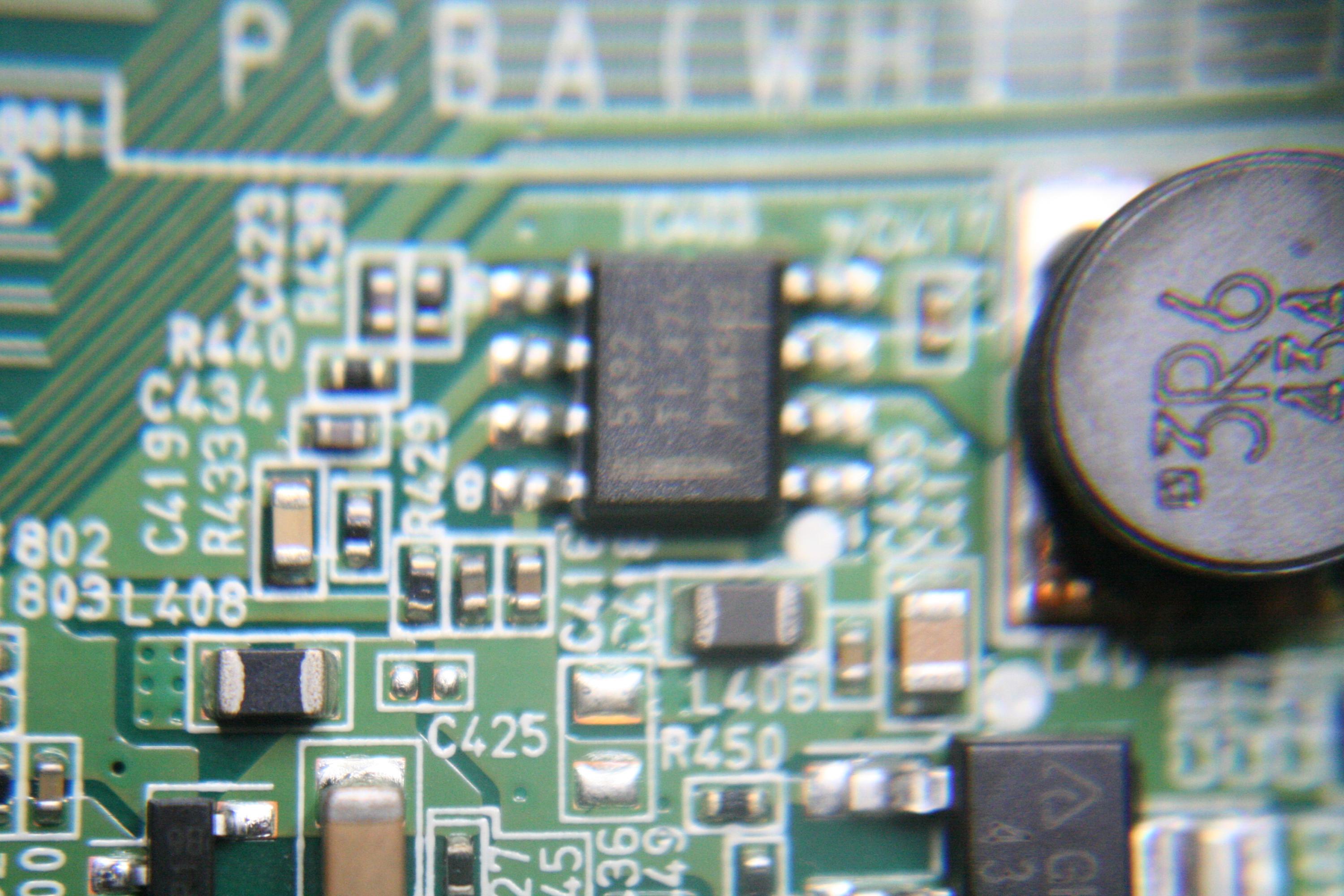

            can you try using a low voltage and freeze spray and see what part heats up?
            Pulled out that IC and the short's still there. I don't have a can of spray on me right now sadly...will try it soon. In the meantime, I'll keep looking around.

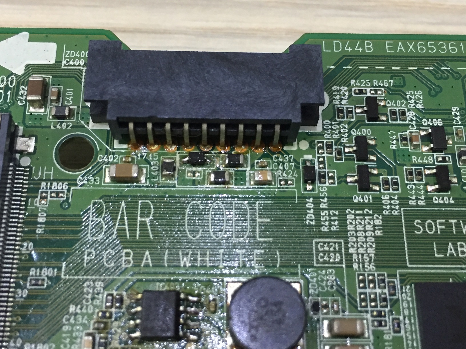

              Re: LG 42LB5600 TV with faulty EAX65423701 PSU
              The smd in the red box does not look healthy but it could be flux on top of it. Can you measure it's resistance using your meter probes across it.
                That's a zener diode which I initially removed and put back after measuring and reading ok. The short's still there even with that diode, EEPROM chip (the one with the yellow dot at the bottom) and that mystery IC removed, so I'm starting to think there's a short in the CPU itself...just a hunch :|

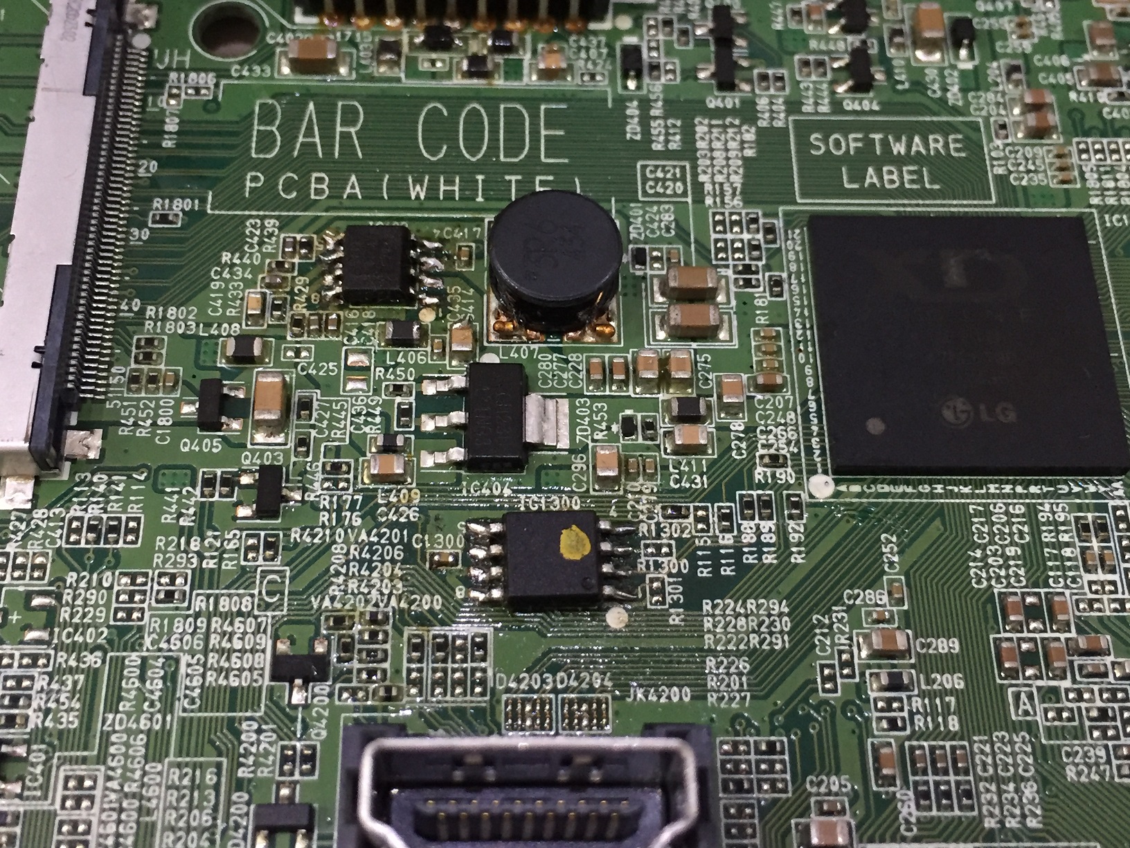

                            I notice that this tv from this post arrive in my service with supposed PSU problem , but after check the tv the problem is with mainboard ( logic board ) , seems like the XD Engine LGE 2134 fault.
                            But Ic403 and IC1300 was removed . Only think to do , replace digital board.
                                That's exactly the same issue I had - pulled out the two ICs (the EEPROM and the buck regulator) and short was still there. Tell me: did your power LED also flicker like mine did ?
