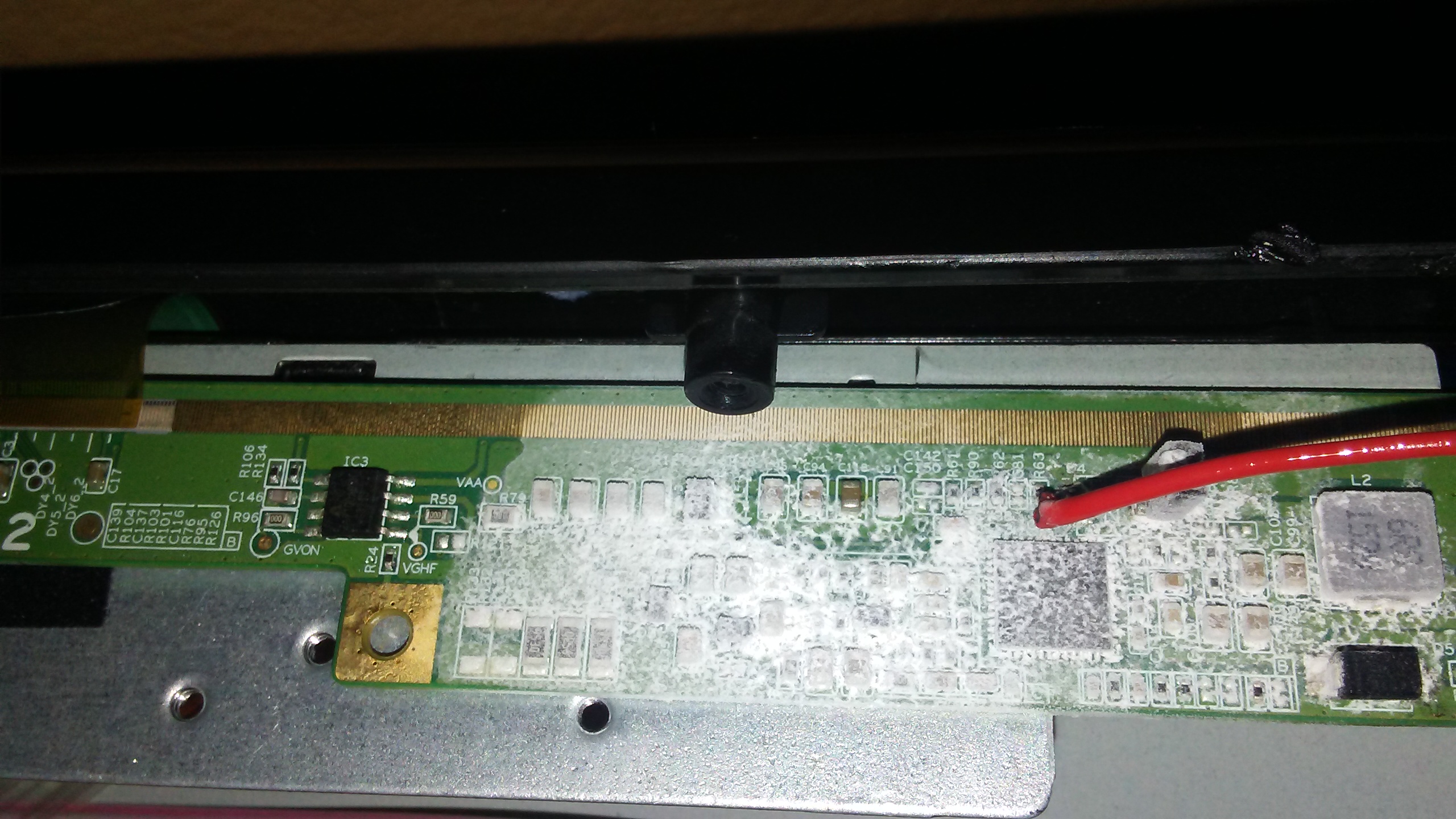

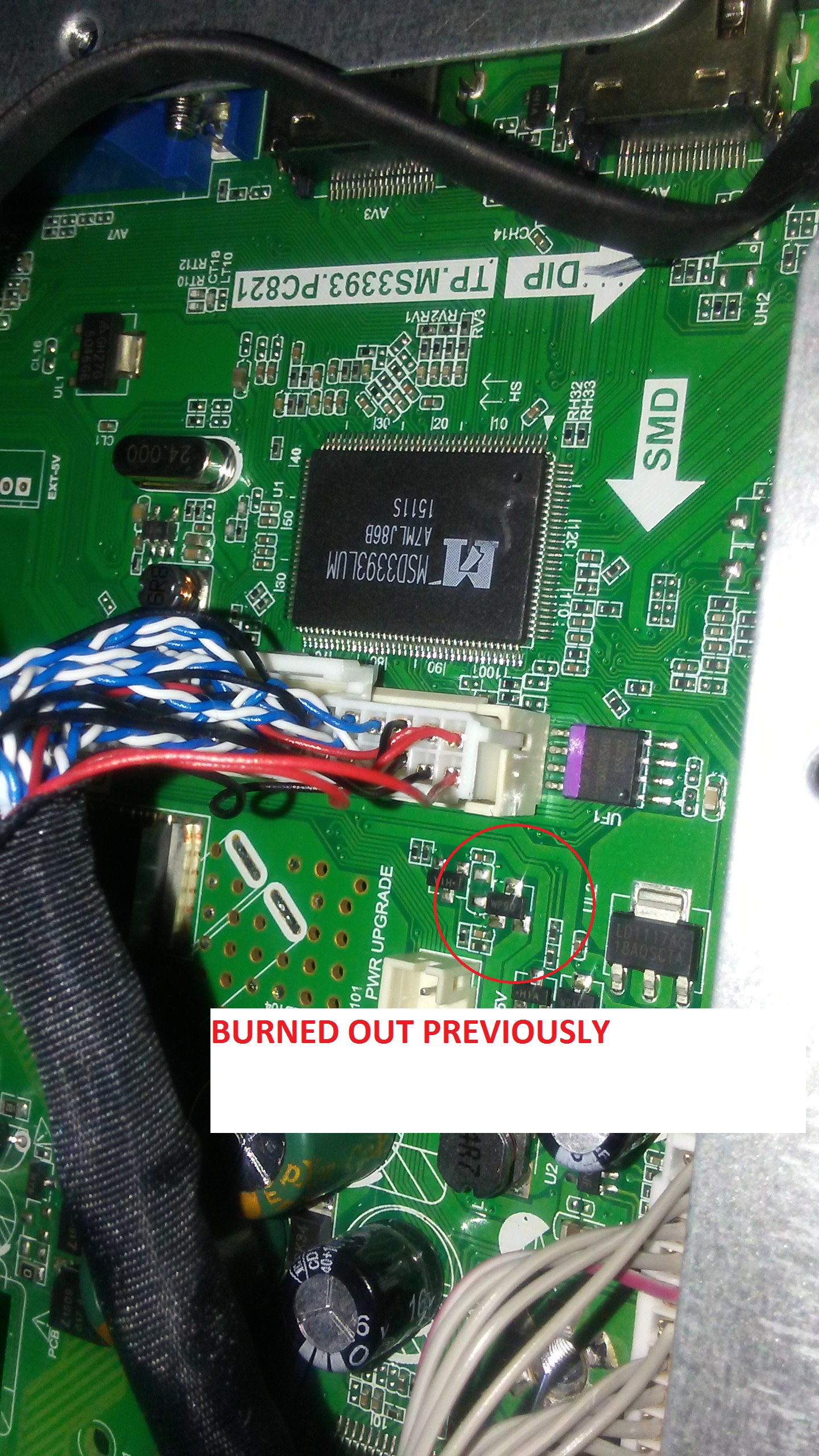

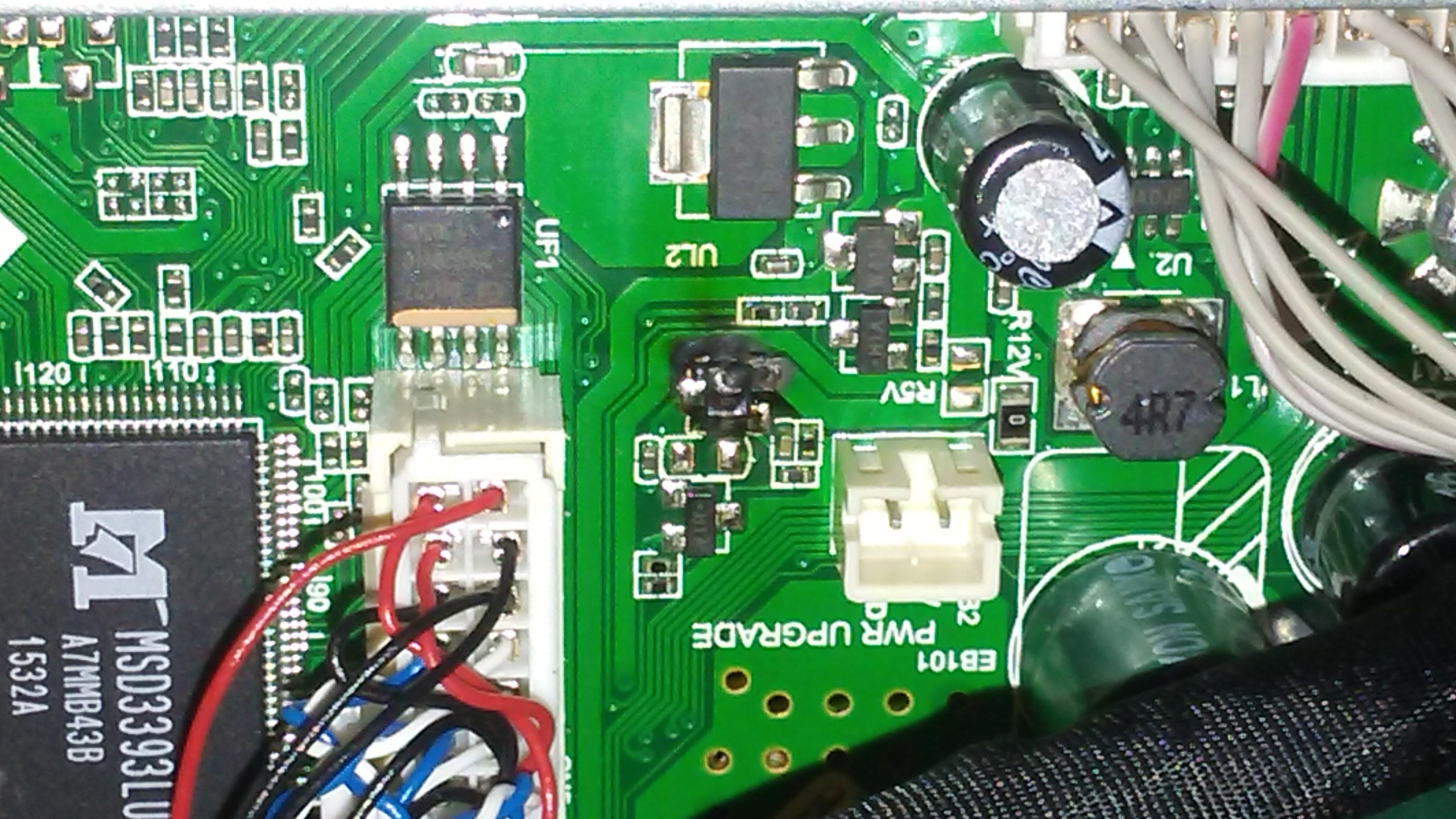

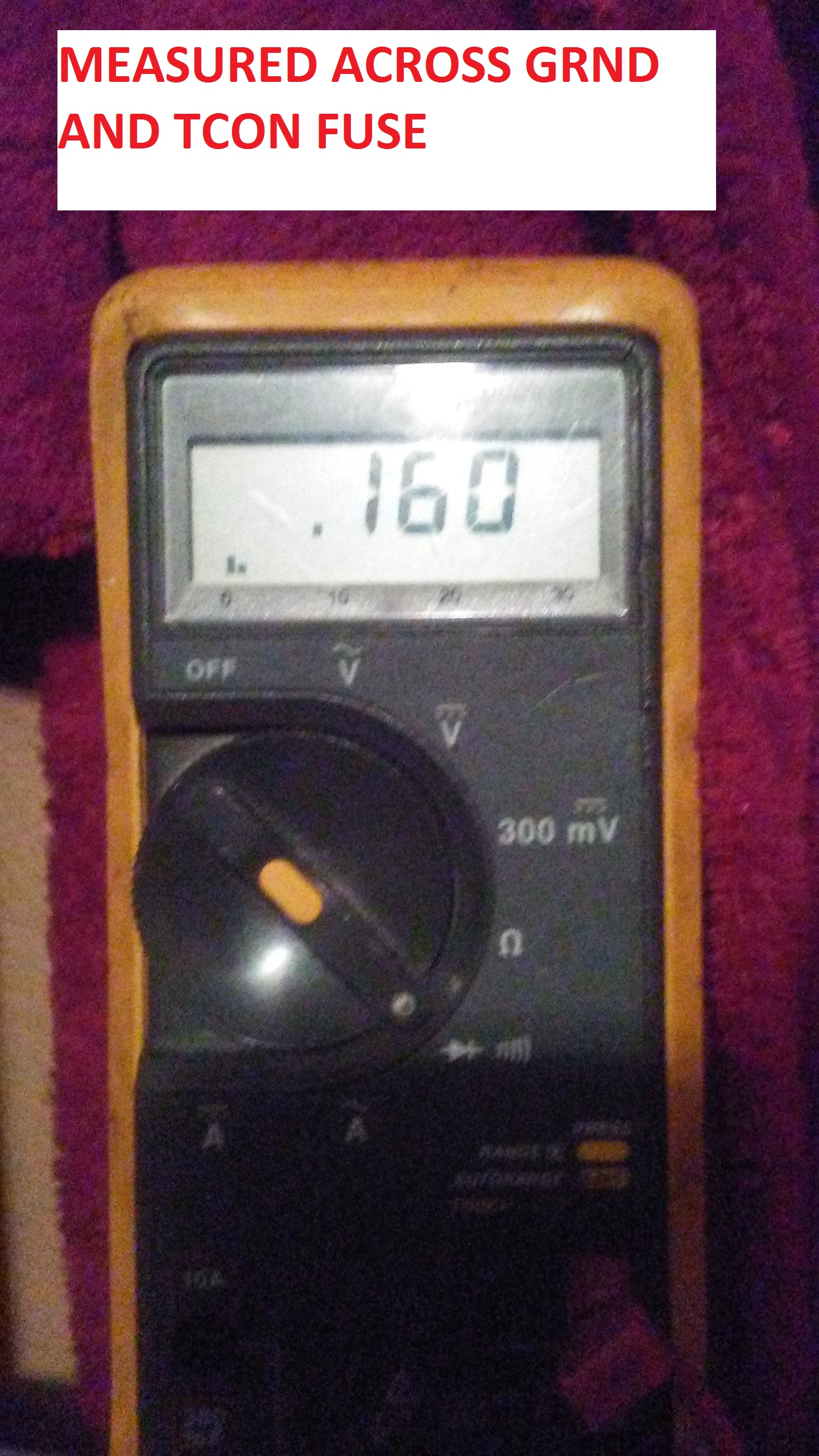

    Hello Everyone, I been reader here for quite a wwhile and managed to fix several tvs with suggestions from here. This time I am stumped. I am working on Westinghouse DWM55F1G1 that has sound and backlight but blank screen. Upon taking it apart I measured voltage going into tcon and 12V was missing. I looked down tcon cable toward main/power supply board and noticed that little three legged small part(diode???) is burned and bubbled right next to tcon cable connector. I barely touched and it all crumbled. I had similar case where same thing happened with same tv brand and after jumping 12V onto tcon fuse picture came on and tv worked. Replacement main solved that previous problem.

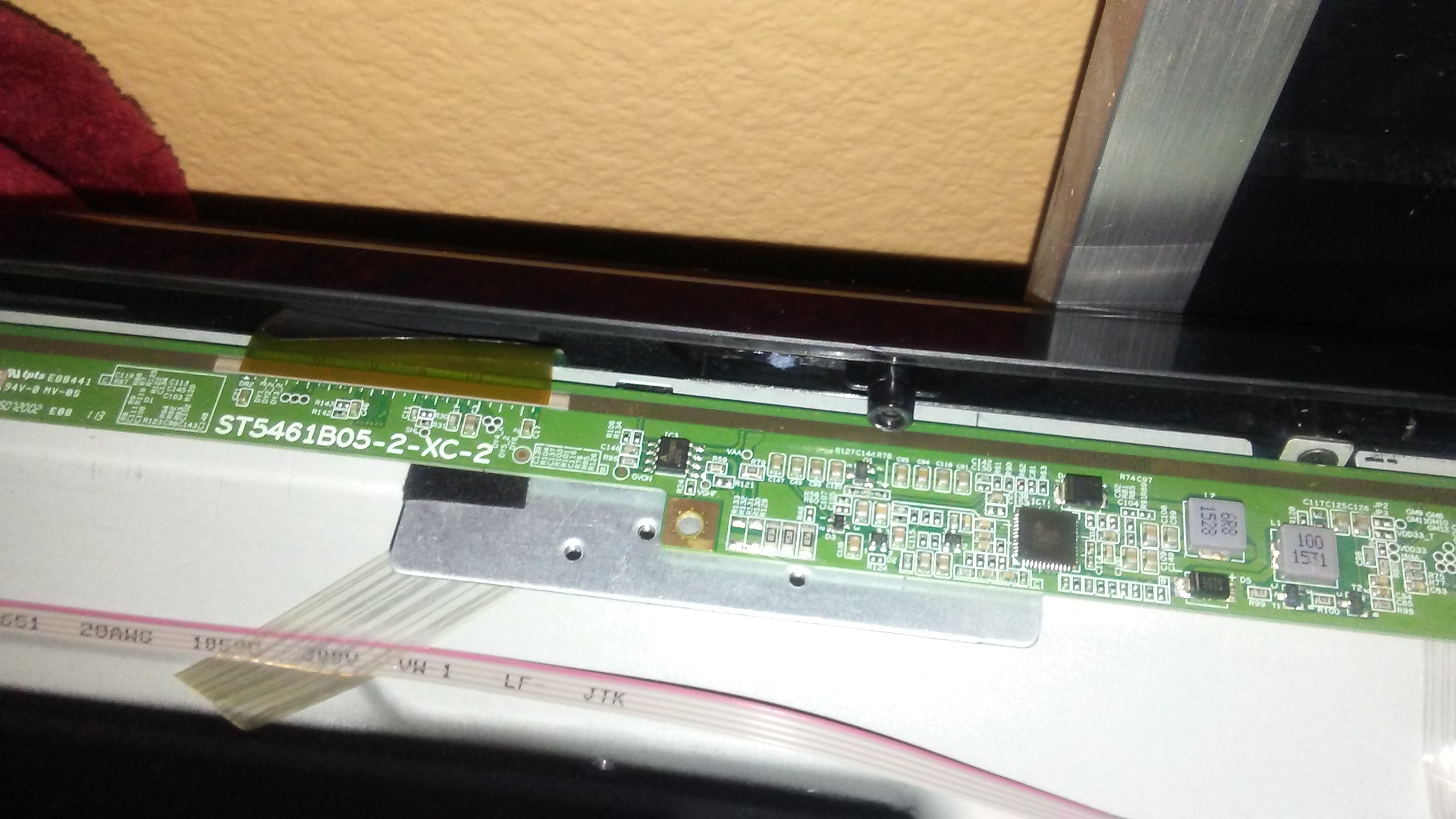

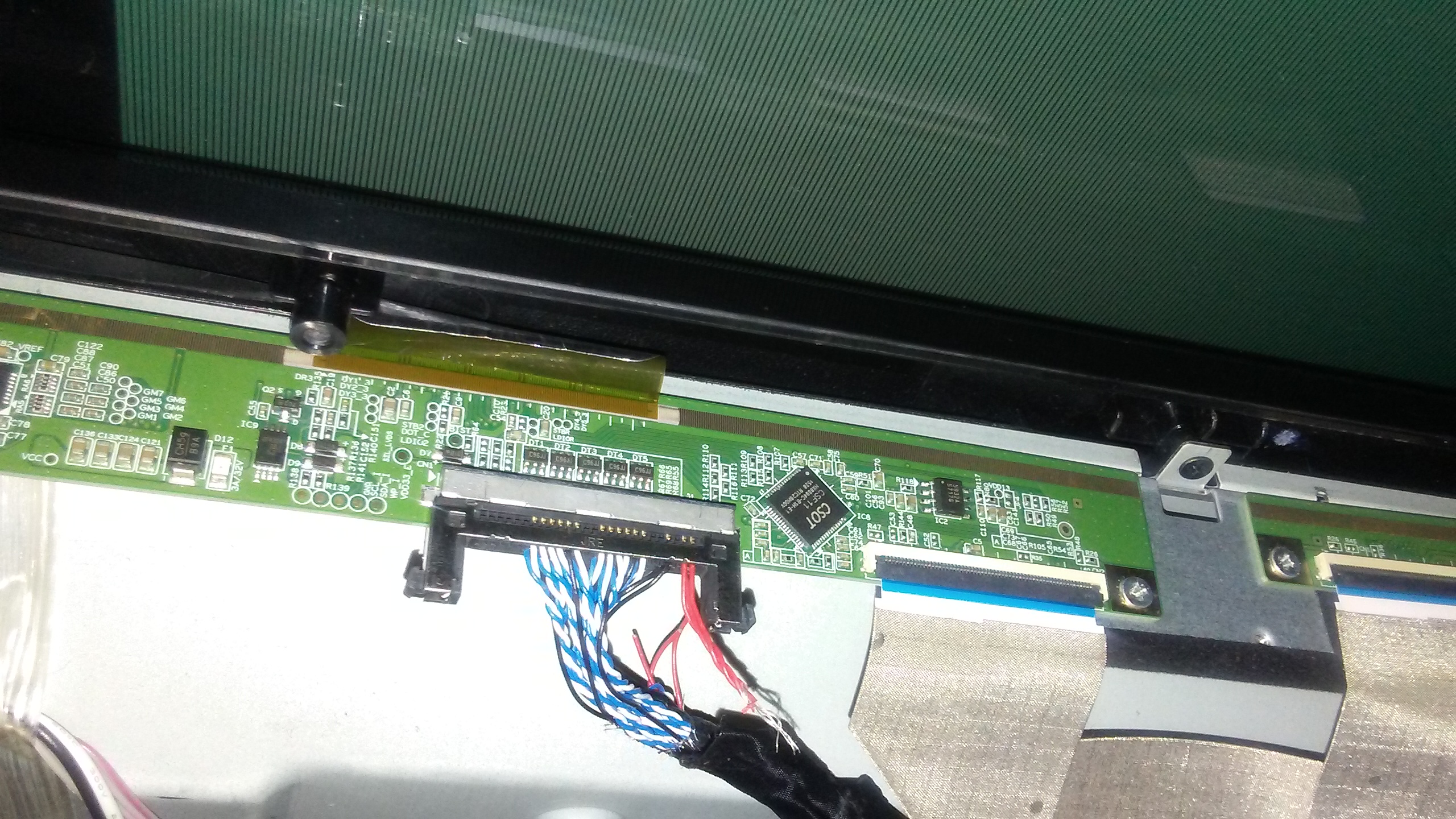

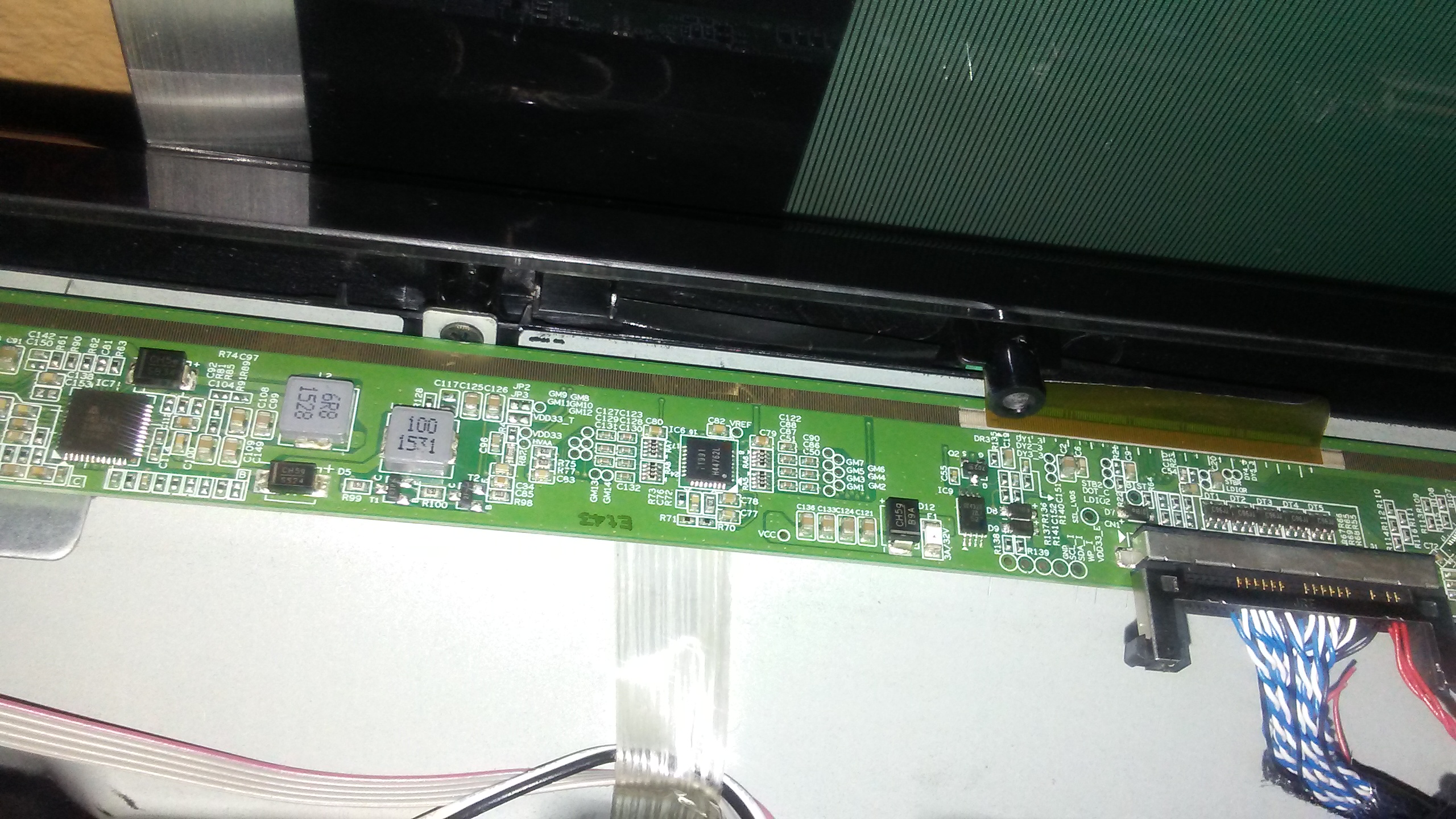

    This time I ordered replacement main/power supply and after everything was in place tv would only cycle and not come up. If I unplug tcon cable tv would start up and stay ON. This tv model does not have tcon board that is removable, it is integrated into screen strip and something there is shorted and shuts main board down. Short is on main strip where all big ICs are because when I disconnect ribbon going into other half of screen it still shorts out. I read about possibly tiny capacitor being shorted but there is quite a lot of them. I tested all little caps brown and black for shorts like this, with multimeter in diode mode and found none that are dead shorted across. They all beep same in diode mode- for millisecond and stop beeping. I would like you guys to direct me into which of them I would take off and see if it resolves short. I have capacitor tester also but i only tested tiny caps for dead shorts across in diode mode without removing. When in diode mode between tv chassis(grnd) and tcon fuse I get .160 . See last picture.

      Thanks for suggestion, I did try connecting external 12v , ground to tv chassis and 12v+ to tcons fuse and fuse blew immediately, if i put 12+after fuse my external power supply shorts out- red led on it starts winking at me, telling me to stop it. i did try to feed 12v for few seconds and touch big IC chips but did not feel any that are getting warm or hot. I did watch youtube video where guy found shorted capacitor on one of these built in tcons but he never said if he got it by luck or somehow tested it while it was still on the board. he said it tested shorted but did not say how he did it. these capacitors are soo small that I am sure that i will mess up if I start taking them off one by one.

            I did testing with freezing the board with spray and one part capacitor did unfreeze little faster than rest of frozen board. i tried it several times and it it did it every time. i took it off and short is now gone in built-in tcon but no picture because this little part is out of the board and i am not sure what value this little value is. My ESR meter dont read it at all. multimeter diode mode gives me constant been either way. i would like to know how to figure out what capacitor to put into its place, maybe i should unsloder one next to it and measure it if i can?

                Thanks for your quick reply. I did remove little cap right next to it and I did see that they are connected in parallel and voltage across measured at 12V. I measured good cap at 10uF and replaced it with regular small 10uF 50v cap but no joy, no image displayed. I officially just gave up on this tv because I spent way too many hours on it and probably this built-in tcon is toasted because of initial damage to it where main board burned up because of this shorted capacitor on built-in tcon -where tcon fuse did not blow open before damage was done to main board. Main board had severely burned spot (where it feeds power to tcon cable) where it actually burned the green board but tiny tcon fuse did not blow.
