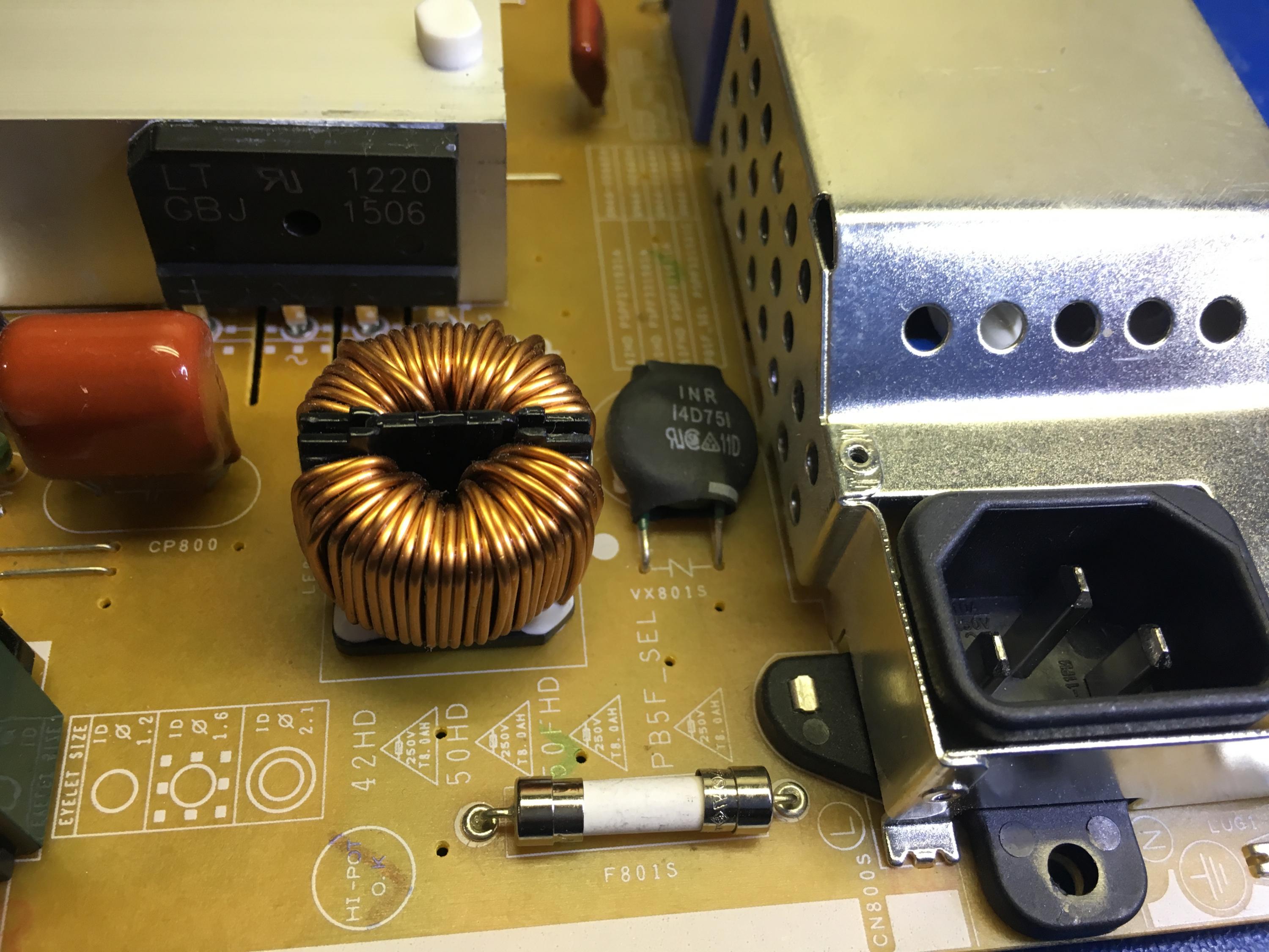

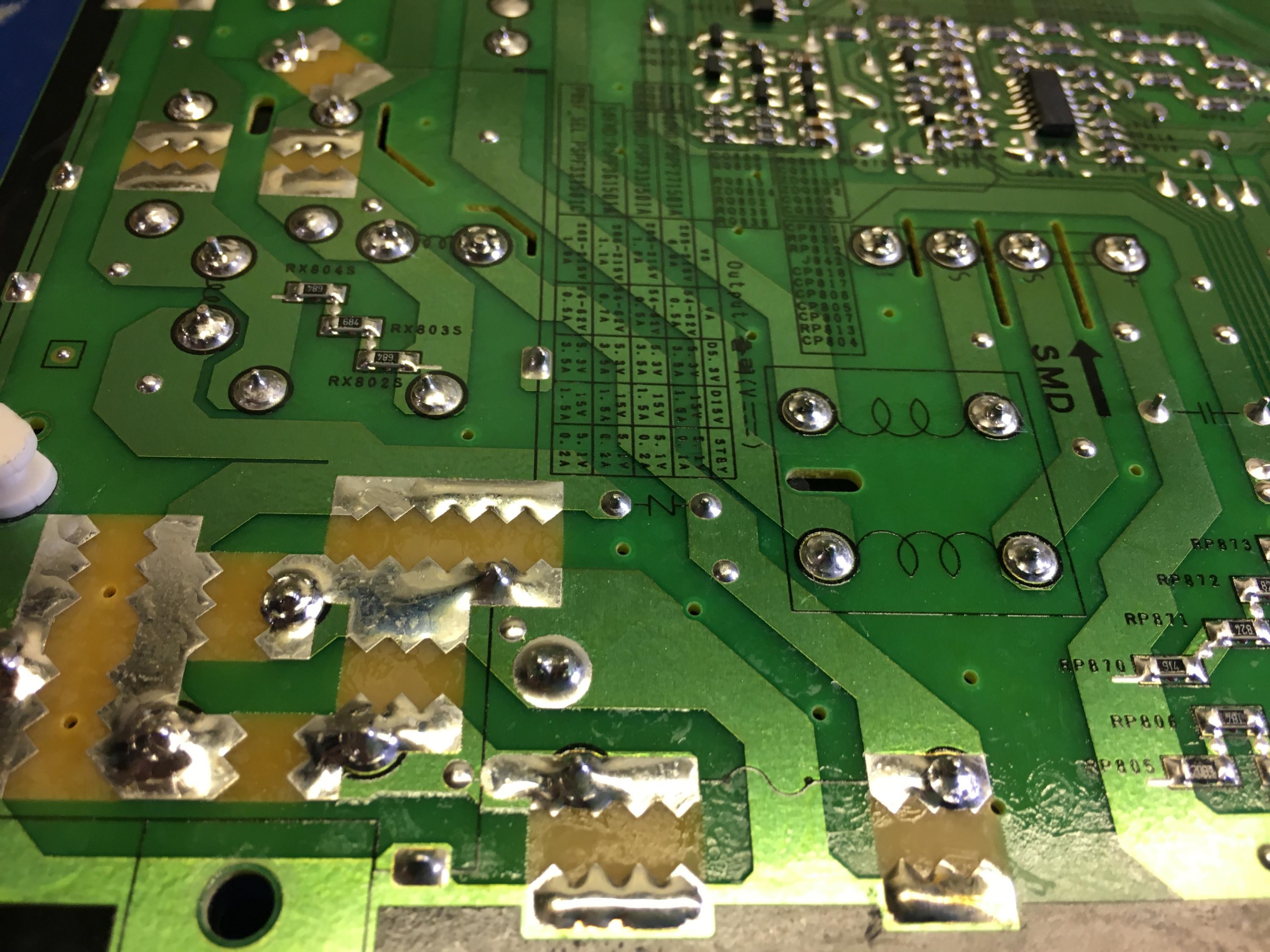

      I got 0V when measuring the two middle pins on the bridge rectifier. I checked the rectifier on diode test and it measured ok. I am also trying to draw a schematic for the AC side just to help.
      Here are pics of the top and bottom of the board, the AC side.

        Can we see the straight shot pictures of the whole Top and Bottom side of the board? The AC to the ~ of the bridge may being fed through the relay but I cannot tell until I see the pictures of the whole board.
        What is the make and model of this board?
        I assume you already test the fuses.

          did you check that fuse? Everything in front of the bridge rectifier is AC.
          We need straight shot, high resolution pictures, front and back of the board.

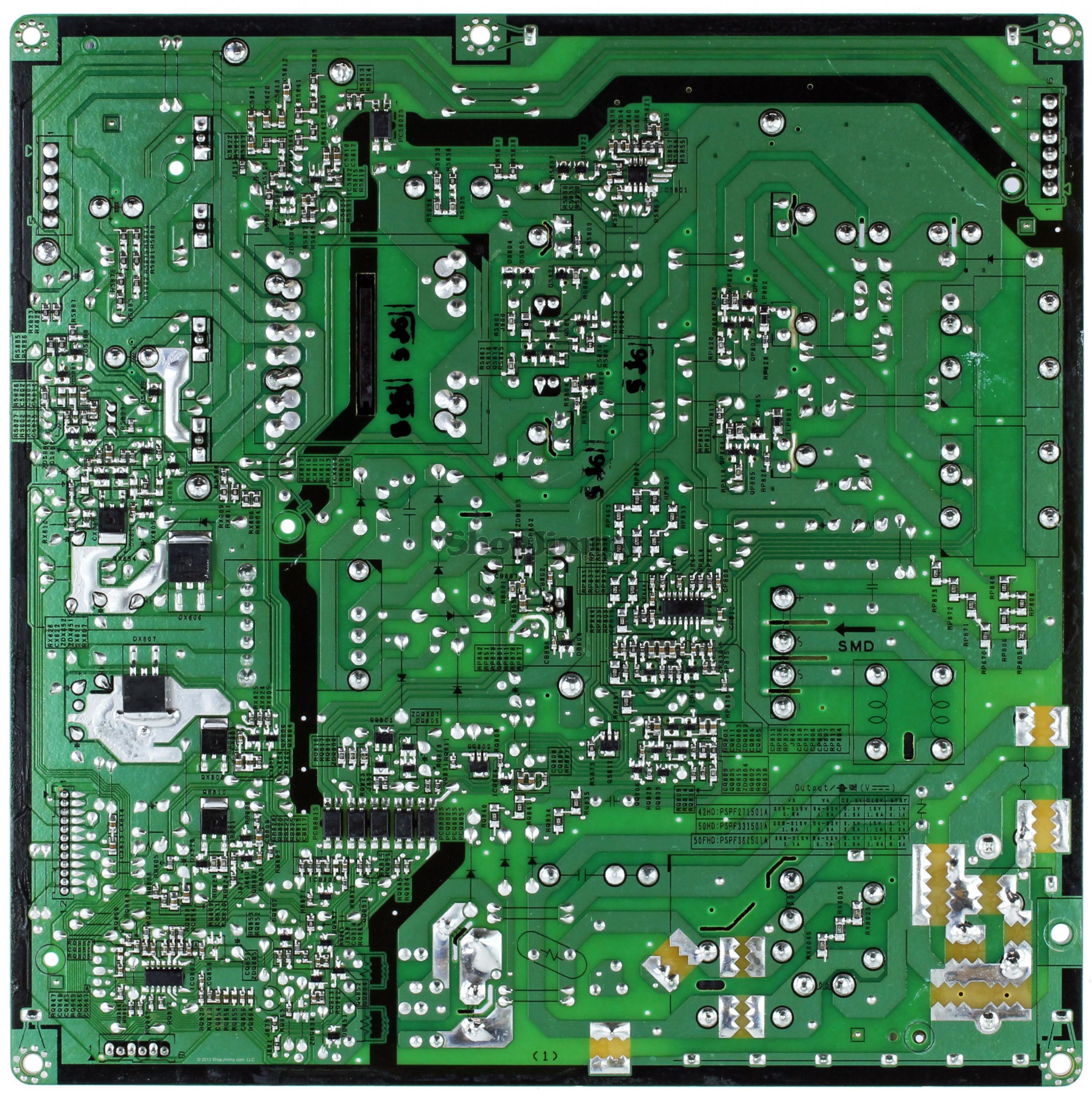

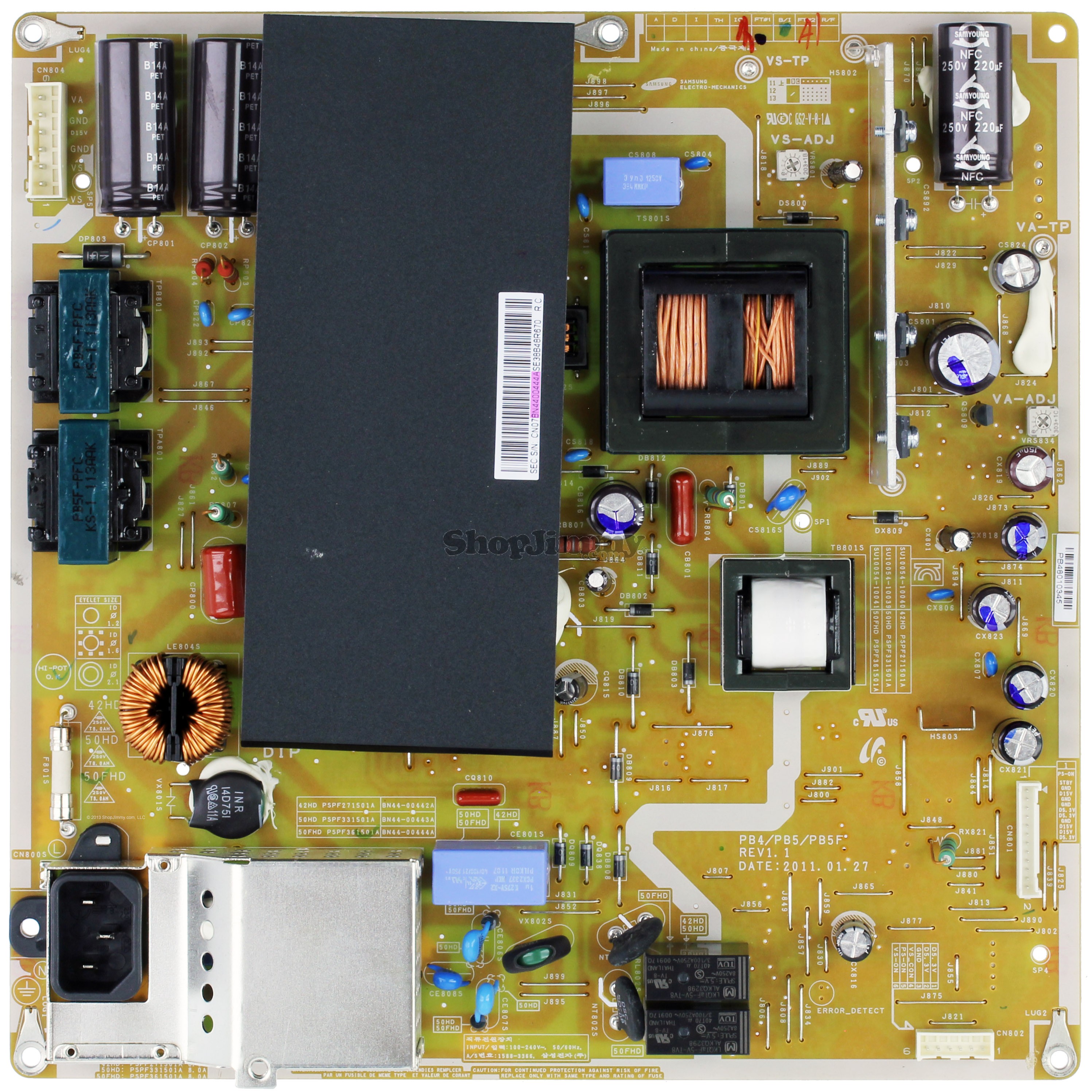

            yup I tested the fuse. The TV model is Samsung PN51D550C1FXZC. I can't take decent pics with my camera so SJ link below.
            Board part number is bn44-00444A.---

              As you can see from the trace on the bottom side of the board, the AC goes through the power relay contacts to the ~ of the bridge, so if the power relay is not on then you will not get AC at the ~ pins of the bridge.
              Pictures provided by shopjimmy.
