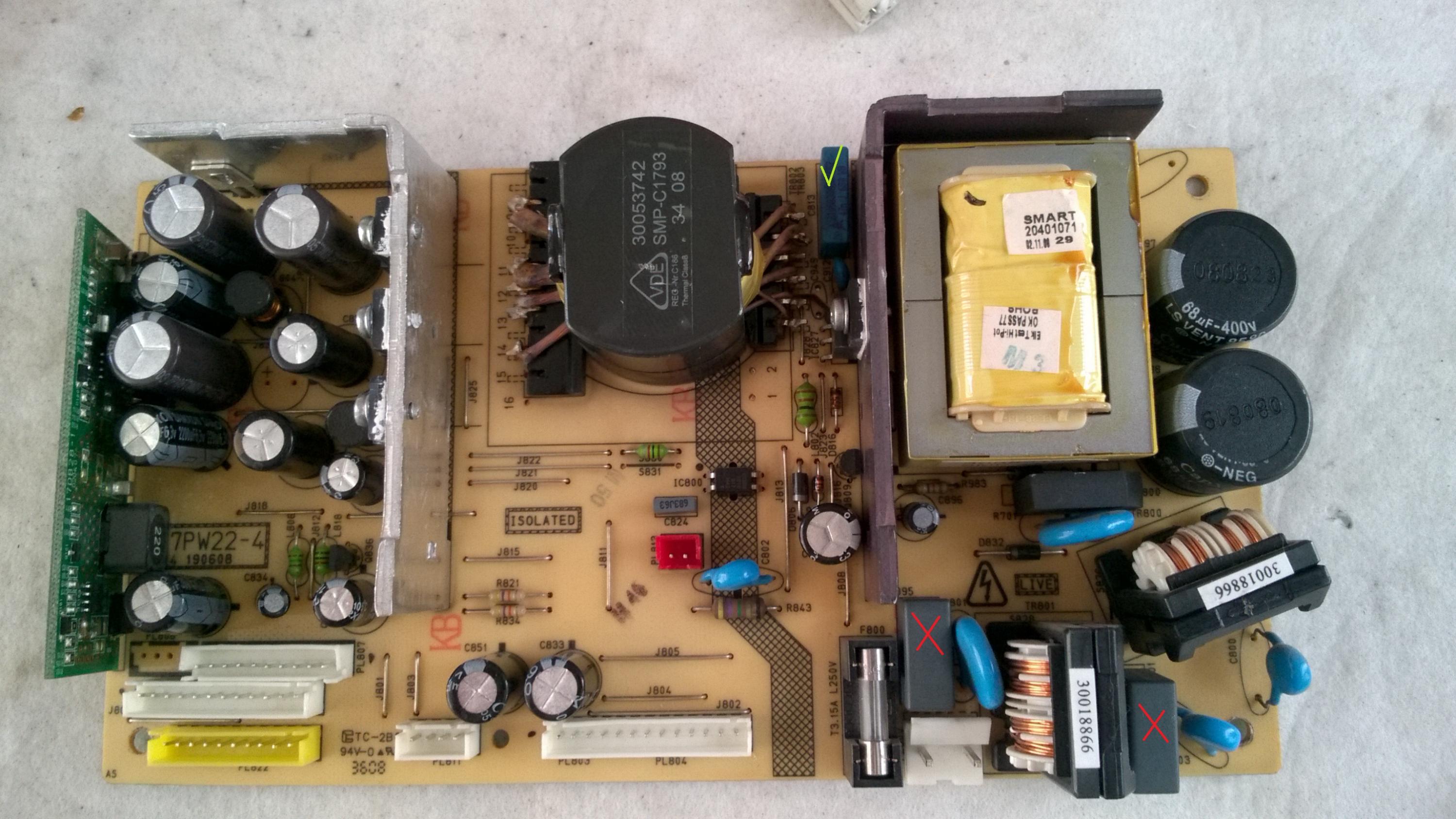

      I've checked the capacitors marked in the picture, the two ones with the red cross were far out of specification (22uF caps, one 163 nF, other one 194nF), so I'm replacing both and trying to see if I can make the TV fail again.

        Those caps are not going to be in the uF's. They are mains filter caps X1 or X2 cannot remember which ones but they are normally several hundrend nanofarads in value. What is printed on their sides.

          You are right sir, I miss the dot and I feel stupid. It says .22uF. Now the real values aren't that far although I'd still tell they are bad.

              Replace the 47nf 630v cap should sort it. My bad just seen they are the Ac input likely wont be causing the issue, keep us updated.

                  if you mean the blue 47nF cap in the picture with a green tick, I checked it and measured perfectly fine.

                  I replaced the polyester capacitors I mentioned in my previous post because they measured bad and since that it hasn't failed. Although being aware of how tricky this fault is, I'll never be confident, not even having tested it for 3 days.
