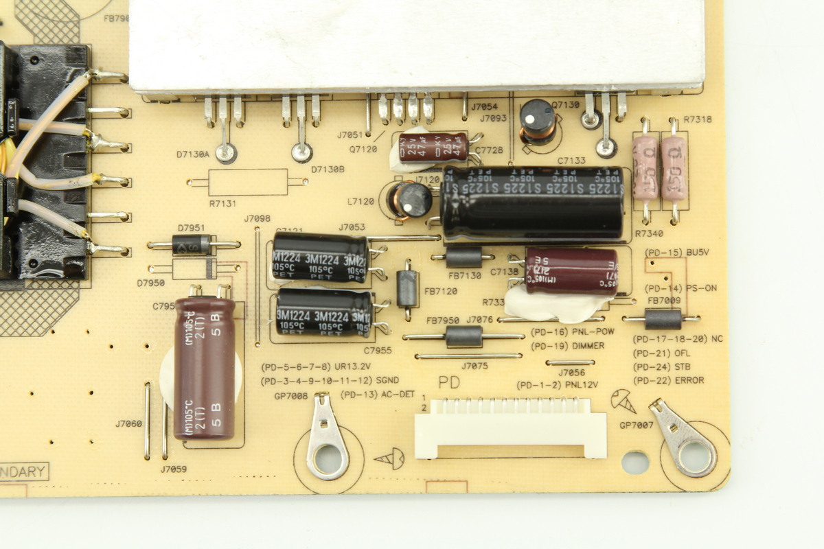

    The power supply (DPS-222BP-1 A) has all voltages present on PD connector:
    Code:
    PIN	LABEL		VOLTAGE
    1	PNL 12v		+12.04v
    2	PNL 12v		+12.04v
    3	SGND
    4	SGND
    5	UR 13.2v	+13.15v
    6	UR 13.2v	+13.15v
    7	UR 13.2v	+13.15v
    8	UR 13.2v	+13.15v
    9	SGND
    10	SGND
    11	SGND
    12	SGND
    13	AC-DET		+3.28v
    14	PS ON		+4.93v
    15	BU 5v		+4.97v
    16	PNL-POW		+4.96v
    17	nc
    18	nc
    19	DIMMER		+2.64v
    20	nc
    21	OFL		+4.17v
    22	ERROR		+4.92v
    23	nc
    24	STB		+4.96v

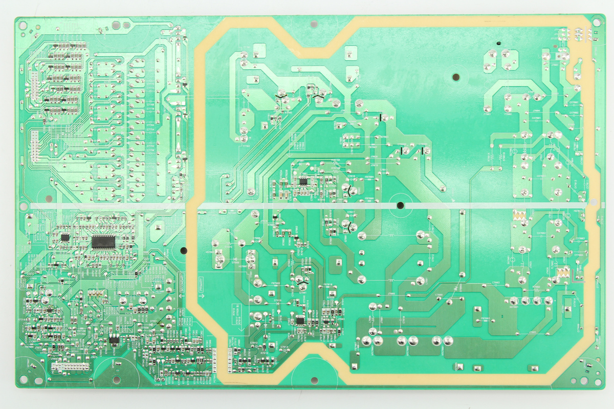

    I did not test any of the IC's on the back side - don't know how.

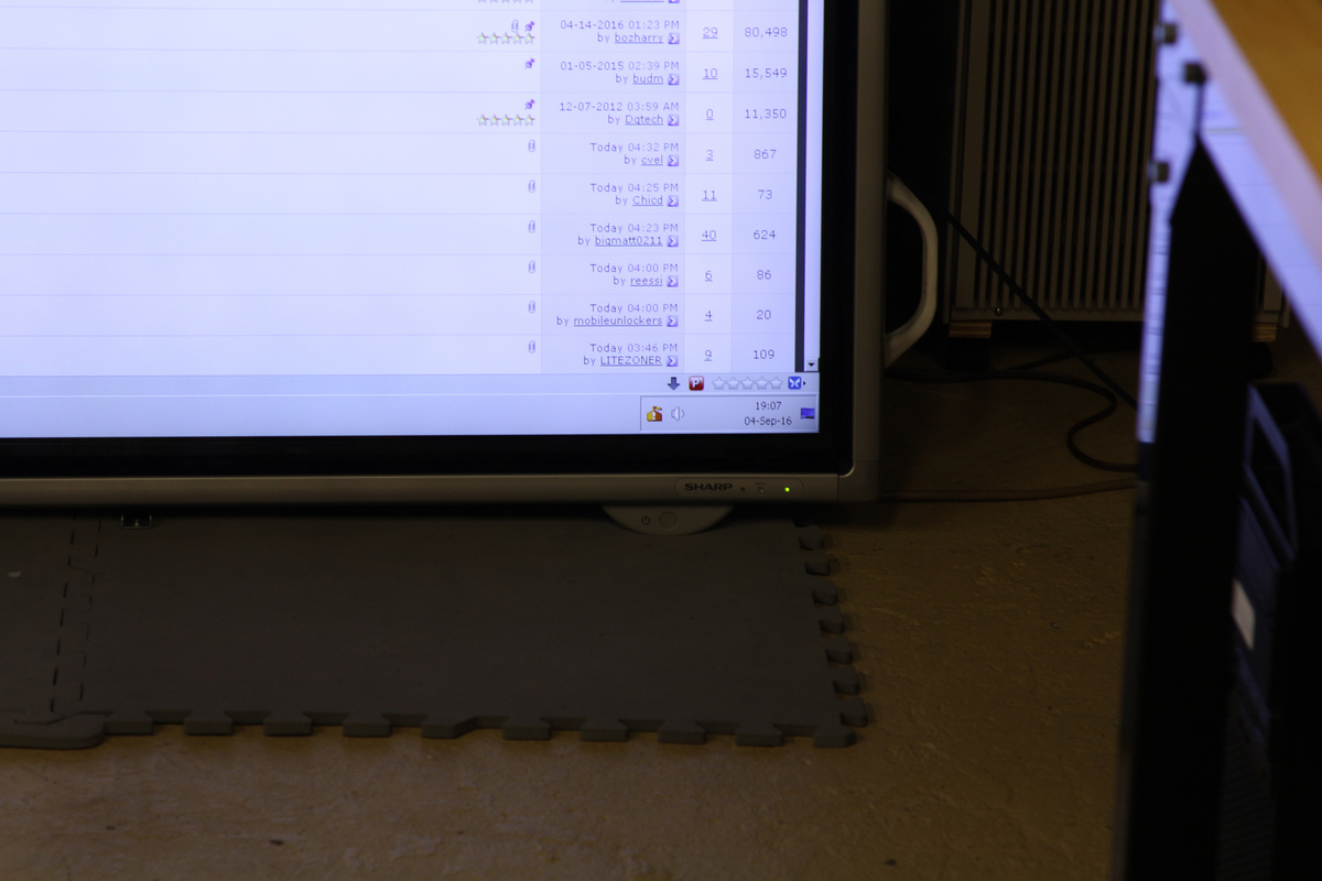

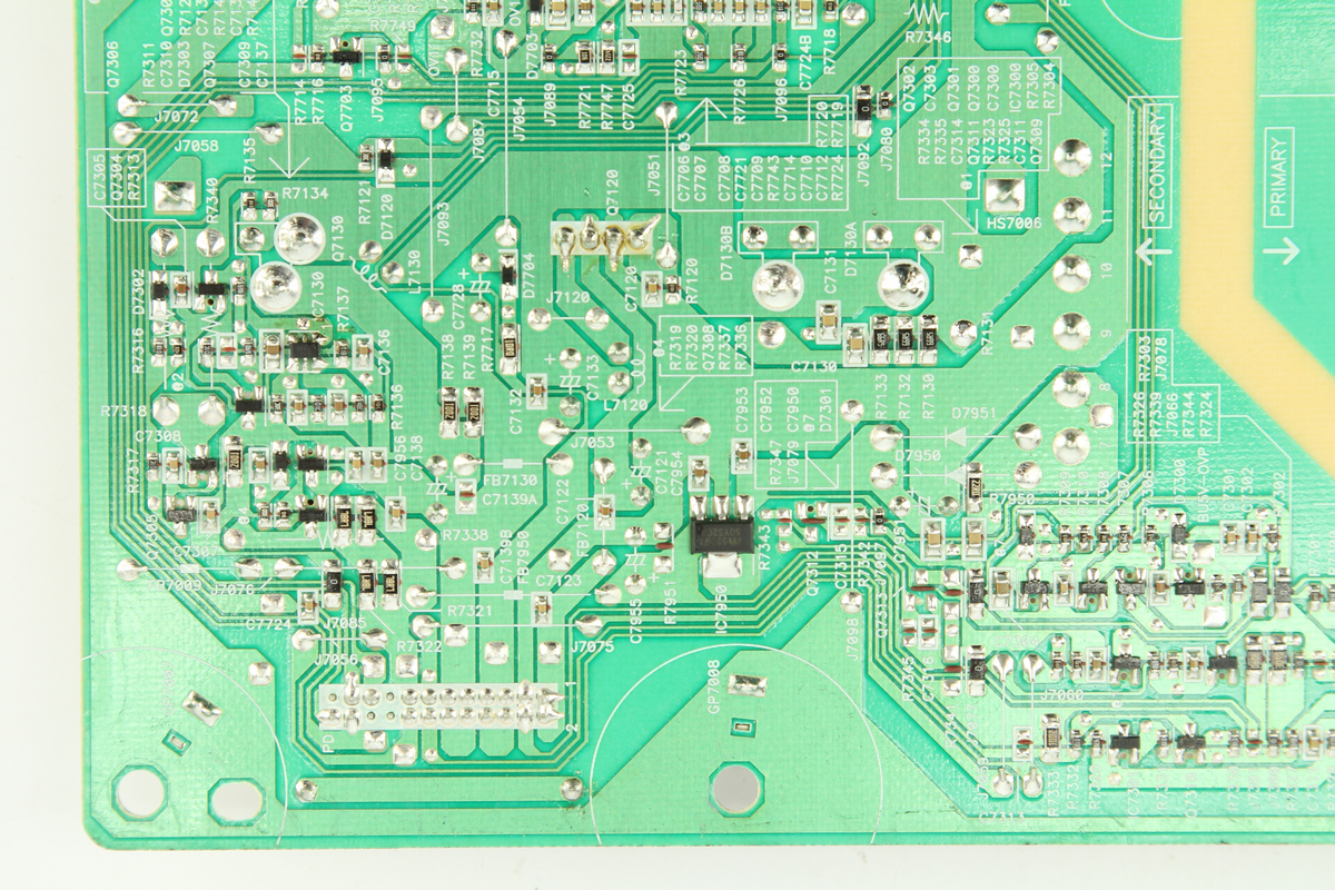

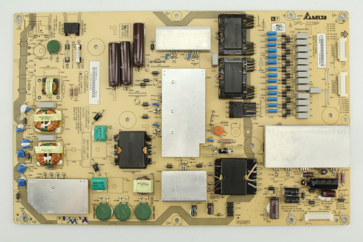

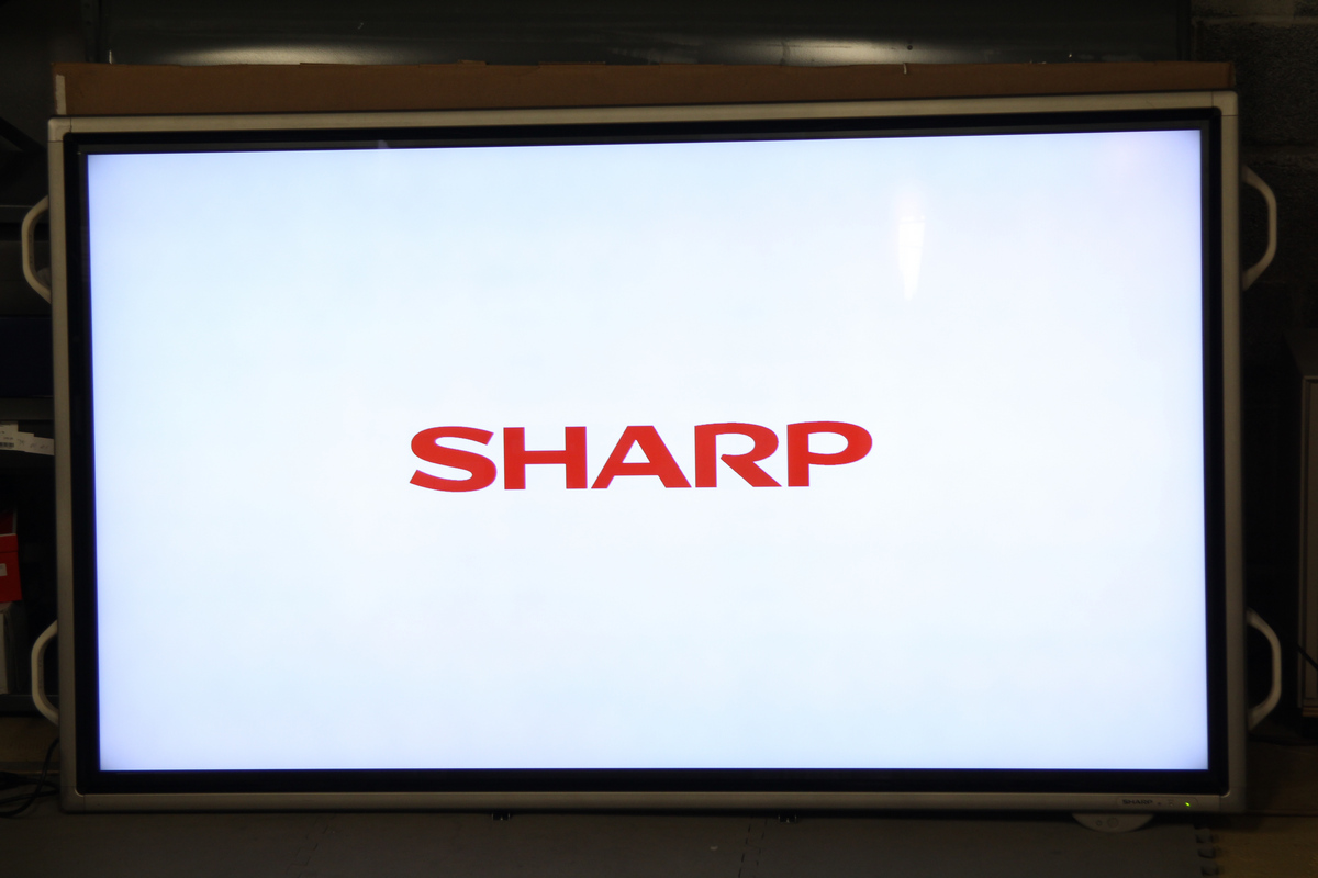

    Scored a "DPS-222BP A" (RUNTKA857WJQZ) power supply board at a great price. Although this PCB is technically from another model, the display none the less is working fine. Here's the conclusion for the archives.
    1. "DPS-222BP A" (RUNTKA857WJQZ) looks 1:1 identical to OE "PS-222BP-1 A" (RDENC1023MPPZ) and works in the PN-L702B just as well. I'd hazard a guess that the 3rd incarnation of the same PSU, the DPS-222BP-2 A (RDENC1023MPPZ), is probably also the same as the other two but has the ~240v portion populated instead of the ~120v and should work just as well.
    2. In the absence of the input signal the PN-L702B will click the relay off and turn the backlight OFF on the 32nd second. This is normal.
    3. In both the bad and the good PCBs the voltage on the three big capacitors C7800A/B/C was +346v. However on the bad OE "PCB PS-222BP-1 A" this voltage did not propagate further to the high voltage transformers etc. Something failed to send the command to pass this high voltage further. See the attached document.
    Any ideas what could be causing this?

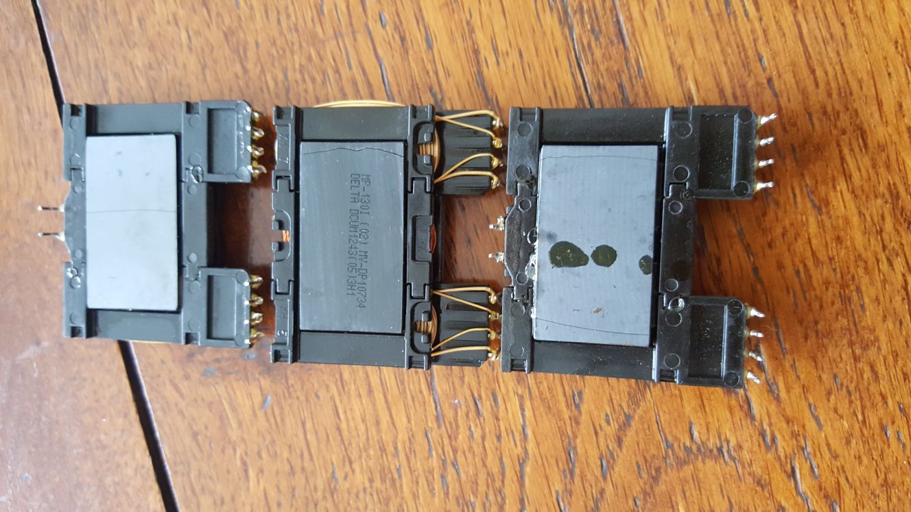

            • yegor
              • Aug 2018
              • AUSTRALIA
              Re: Strange Delta DPS-222BP power supply behavior
              Guys! It is common problem of DPS-222BP. Usually faulty components of PSU are T7701 or T7702. To identify faulty module you need to start DPS-222BP in standalone mode. To make it start in standalone mode you need to pull up these pins of PD socket to 5V with 1K resistor to each pin.
              1. STB
              2. PS_ON
              3. PNL_POW
              4. OFL
              5. DIMMER
              Having this done backlight of panel supposed to work continuously as soon as you power up PSU. If it doesn't start or works only few seconds in 99% it means you have problem at backlight converter.
              First signs of faulty transformers are cracks at ferrite core because of overheating.

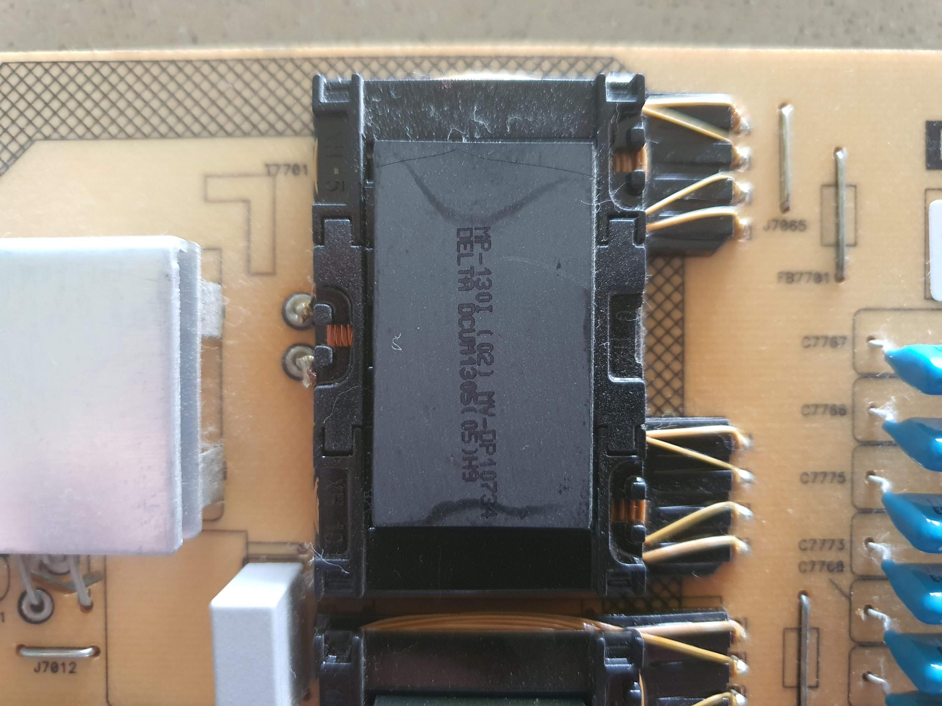

                      This is exactly what I found after searching all over the board:
                      • dick_barton
                        • Aug 2015
                        • 6643
                        • Wales
                        Great hint. Cheers

                            Looking closely at the first photo, enlarging it, you can see the fine crack in the ferrite core, just like the ones I found on my transformers.

                                In addition, is it possible to fix these cracks? attached are the images from my board.
