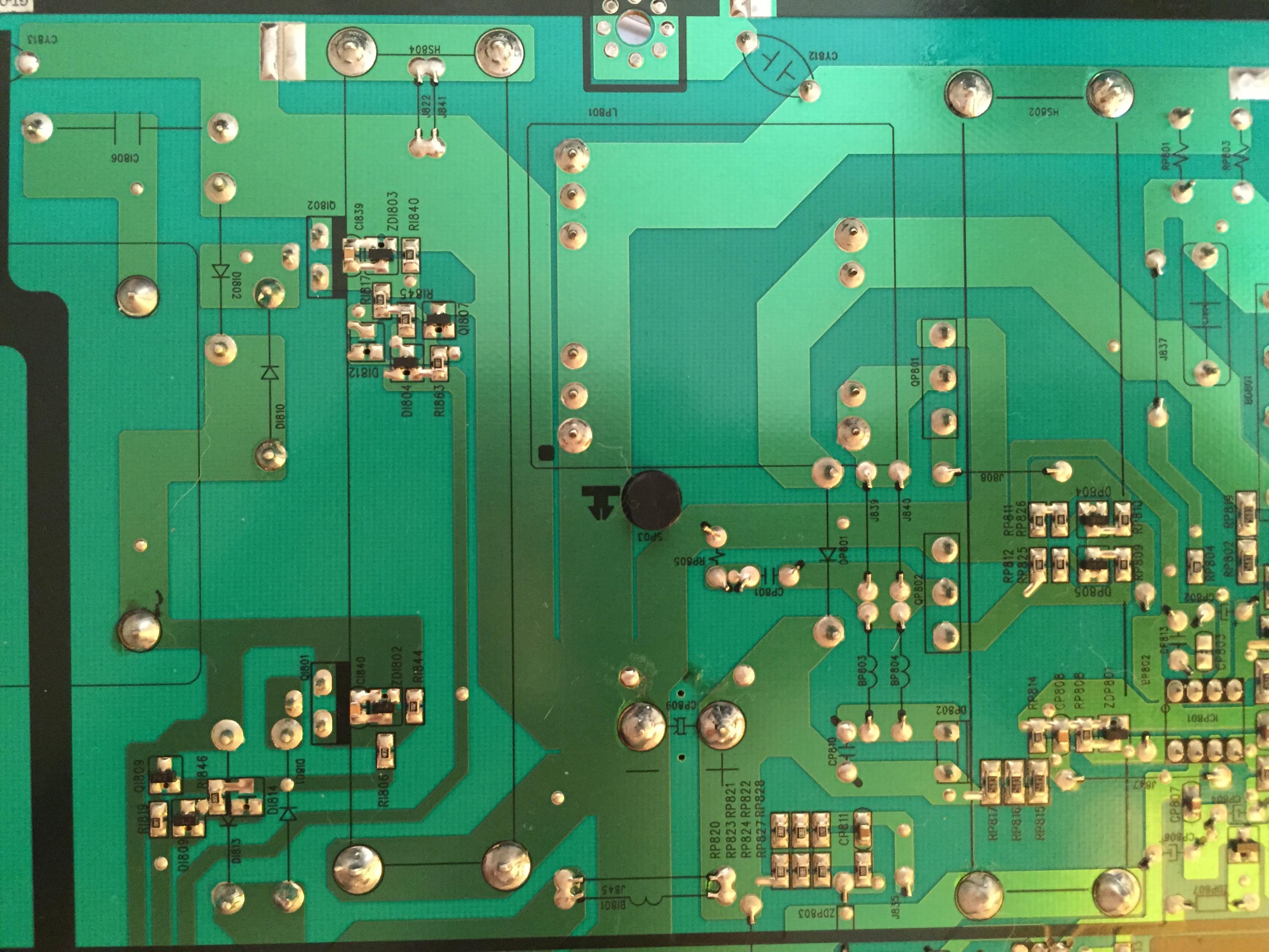

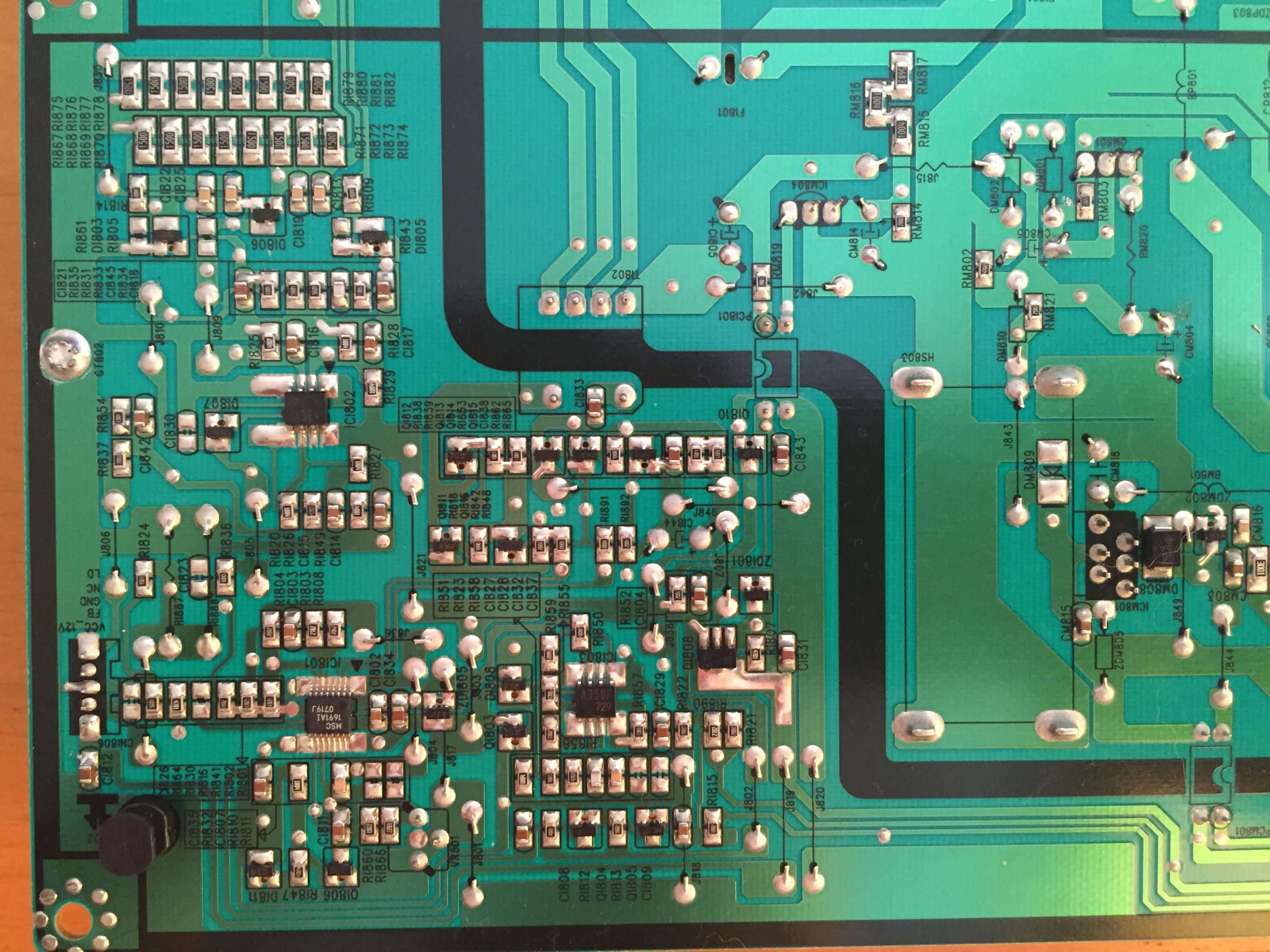

    Can you post sharp clear pictures of your boards and the interconnections which will help. Add them as attachments.

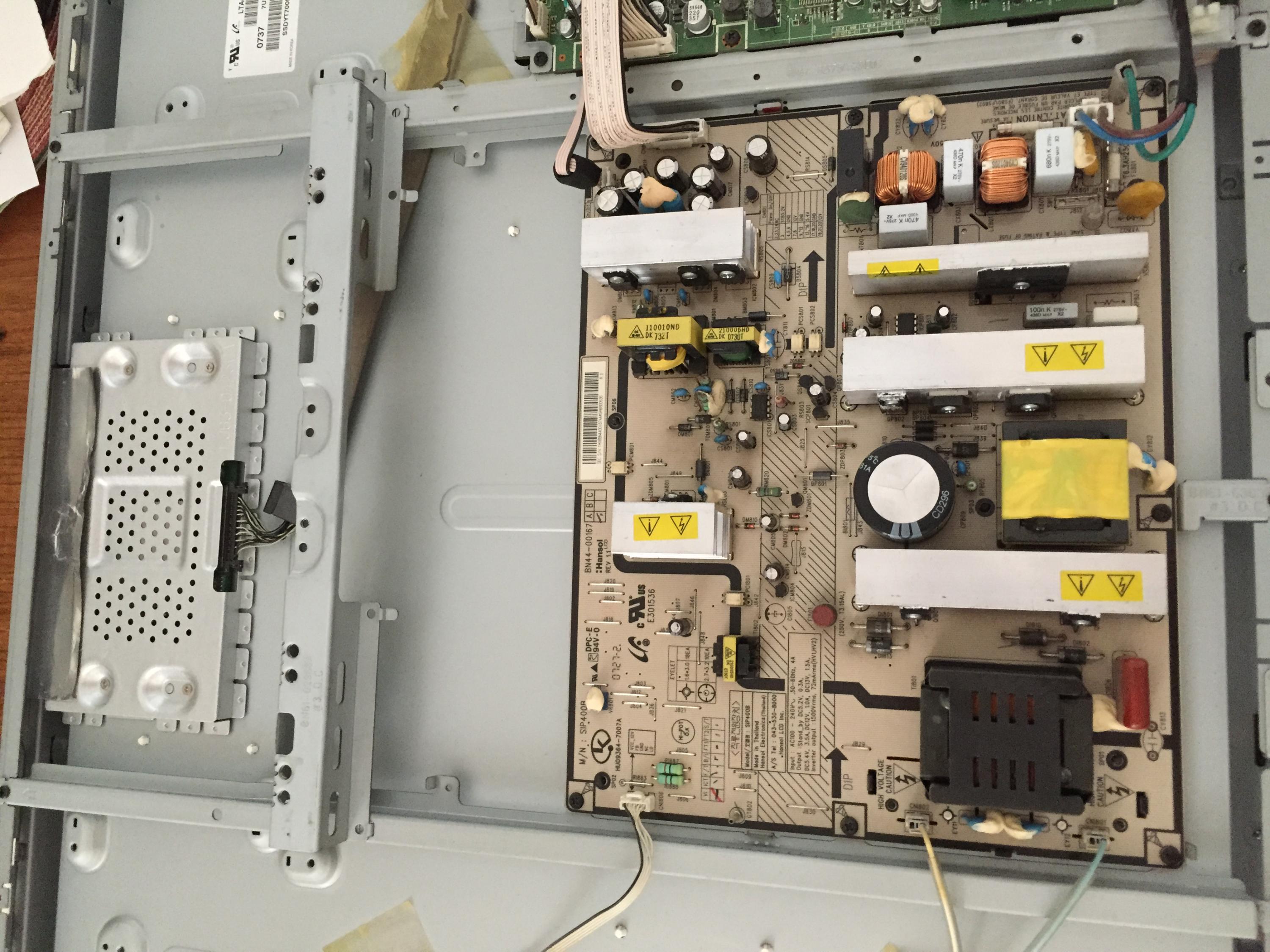

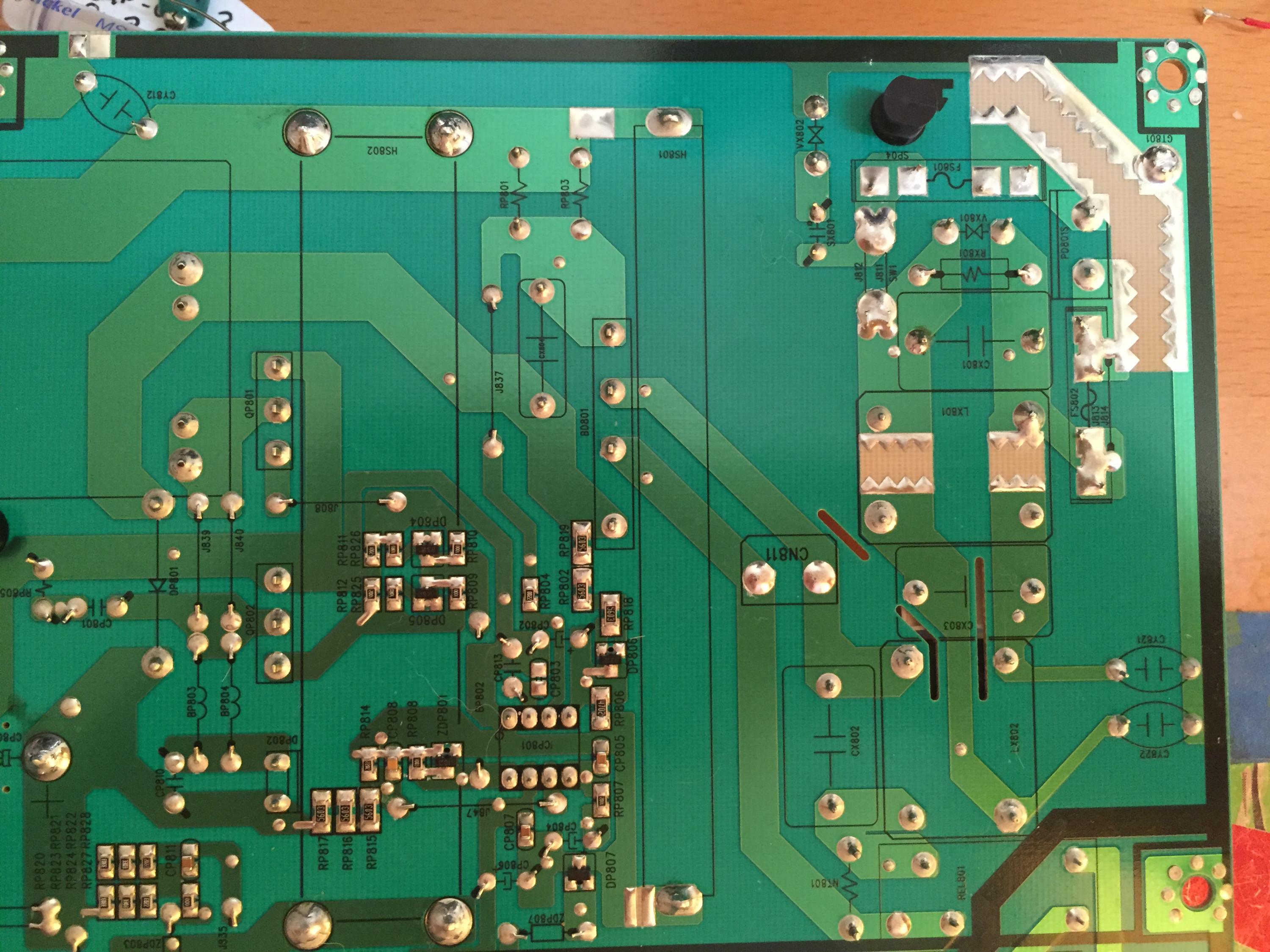

          Remove the psu and get us images of the bottom side please, common issue with these supplies is cold solder joints on the inverter side of things.

            Indeed I will and thank yo for your input. Will clean and reflow and examine under microscope I use for iPhone logic board repair. Don't have scope camera but can get close enough with magnifying lamp to get some informative pictures.

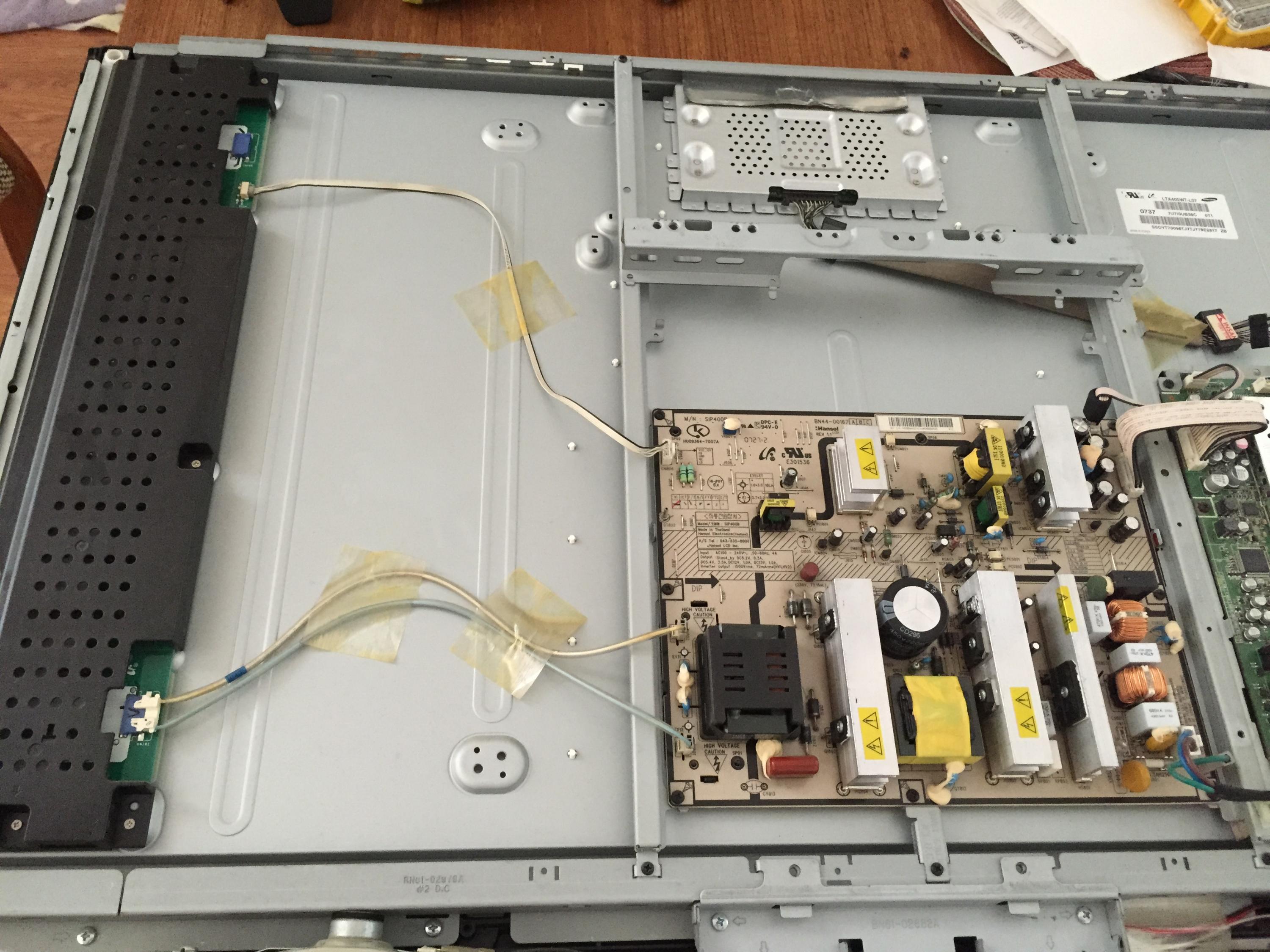

              I will get the picture of the board, but I did remove and examine it. It appears that perhaps silver bearning solder was used in manufacturing. Took longer than normal at 480c to get to reflow even with flux. I did not find any suspicious cold or poor solder connections but reflowed the caps in the inverter part of the power board. That did not produce any change in the BL issue. When I powered it up I noticed the BL came on for about 1 second then immediately off again. I believe this was what it was doing originally but because I was looking at the Rea of the screen in a dark room. The BL was easily noticed for the brief moment it was on. I remember seeing the same thing from the front of the screen but it was much easier to see this from the rear.
              It's beginning to appear to me that something is breaking down or flashing over which kills the BL rail. Again have sound and power cycle on is normal with exception of BL.
              Thanks, and I welcome any additional input.

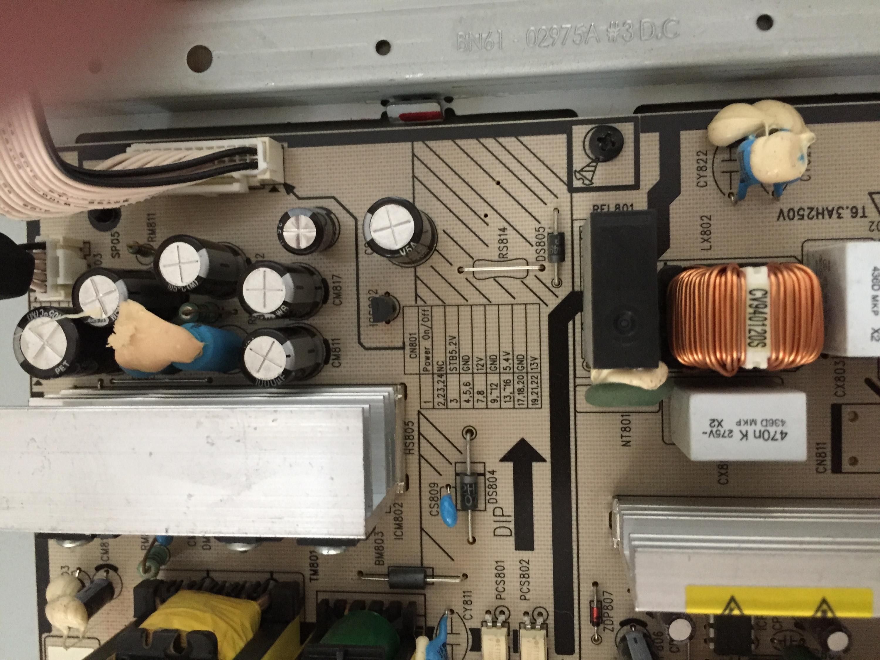

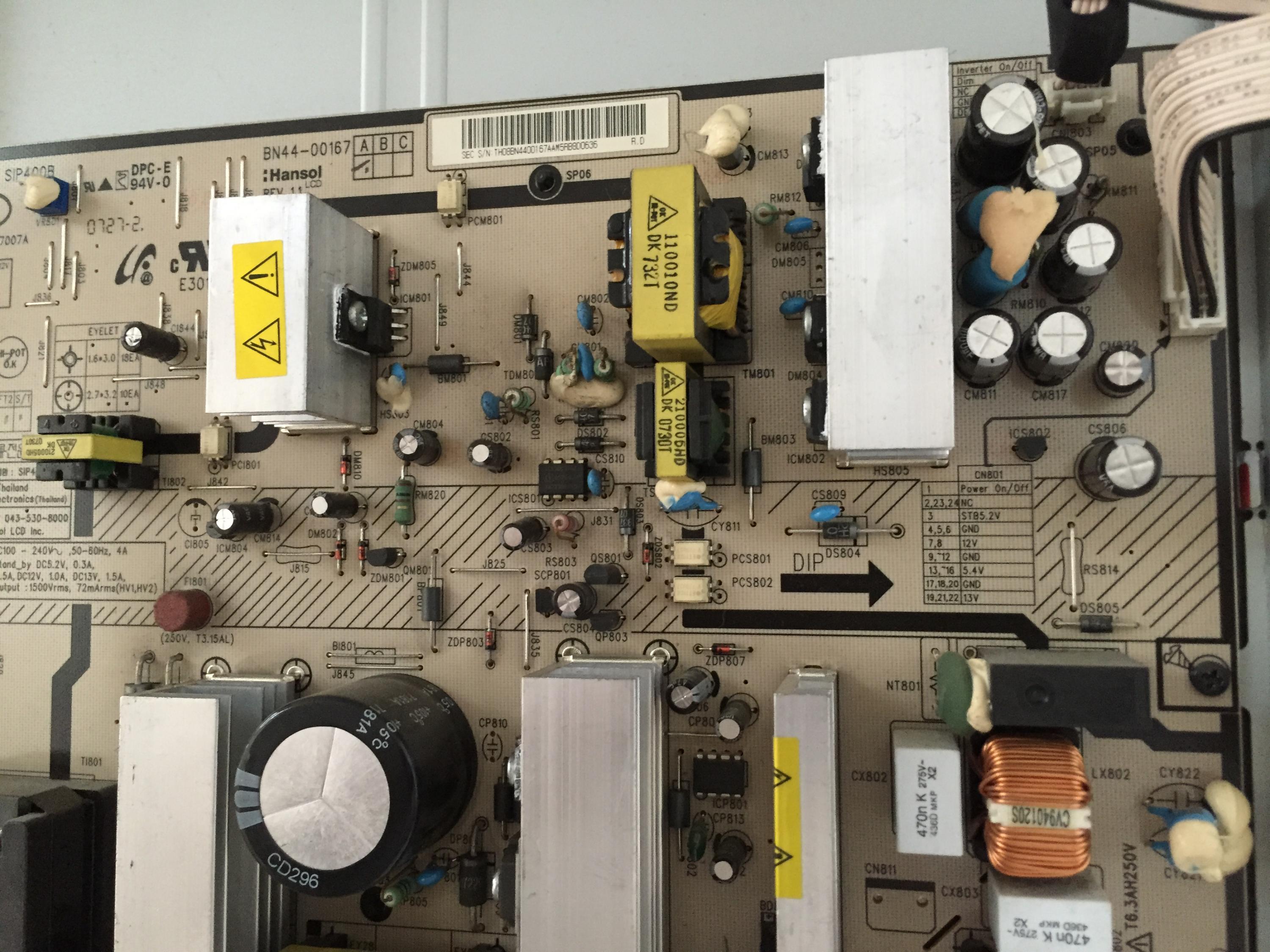

                Re: Samsung LNT4053H BL ISSUR
                What is the P/N of that power supply/invreter board? BN44-?????
                  The power/inverter board number is BN4400167.
                  Thanks very much for your reply and additional information to follow.

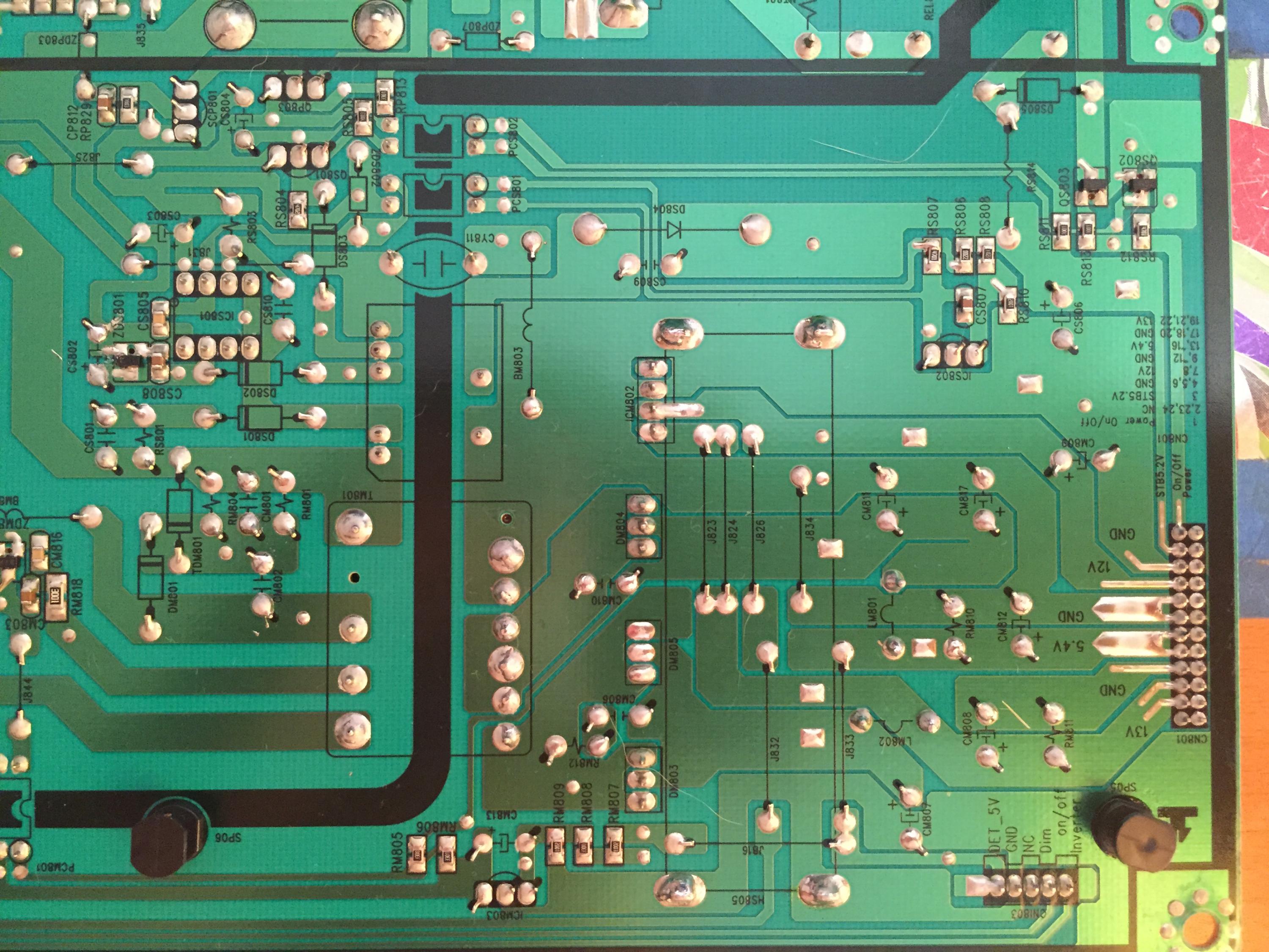

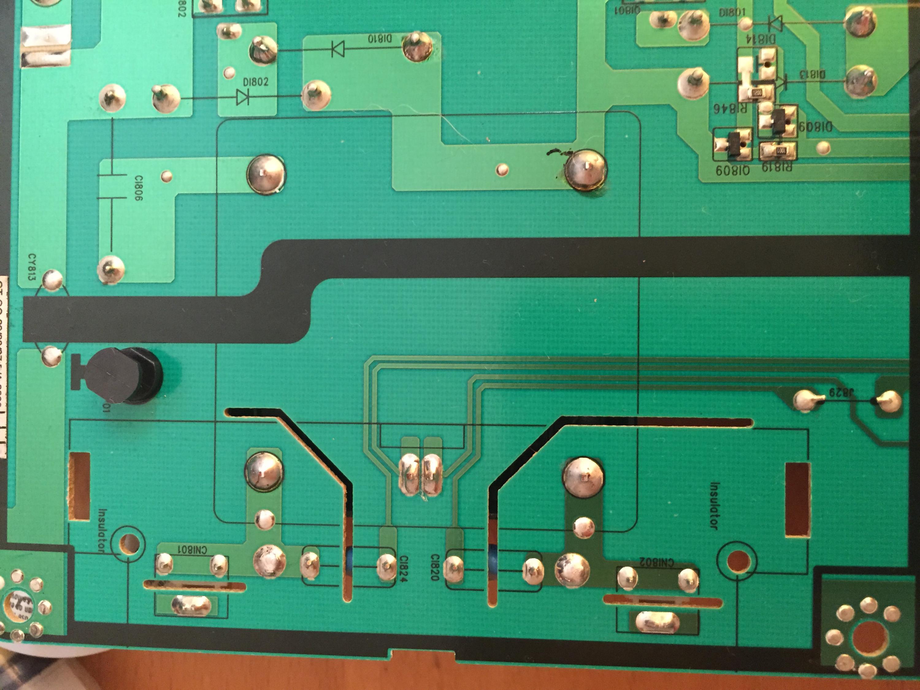

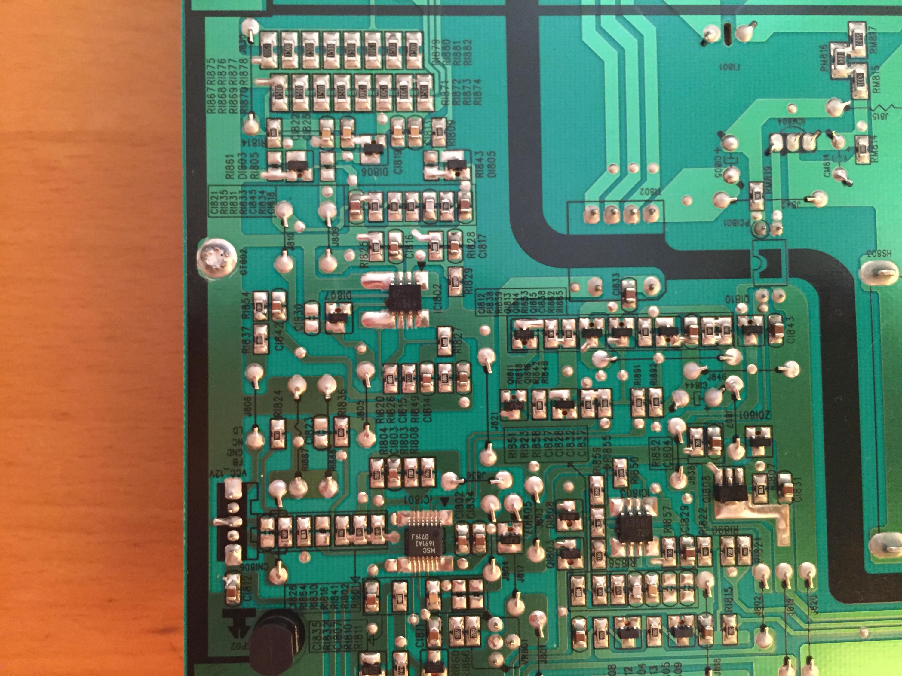

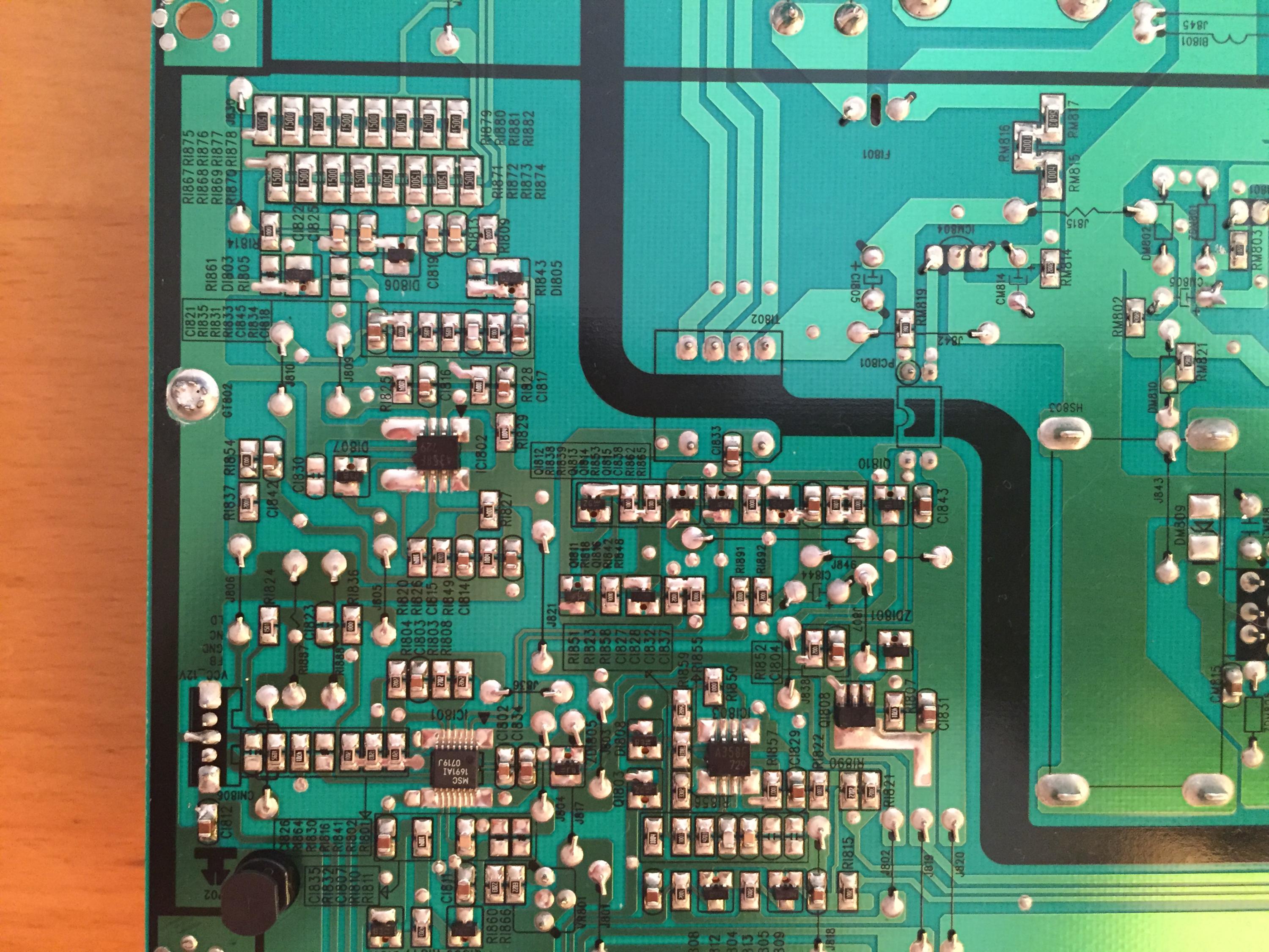

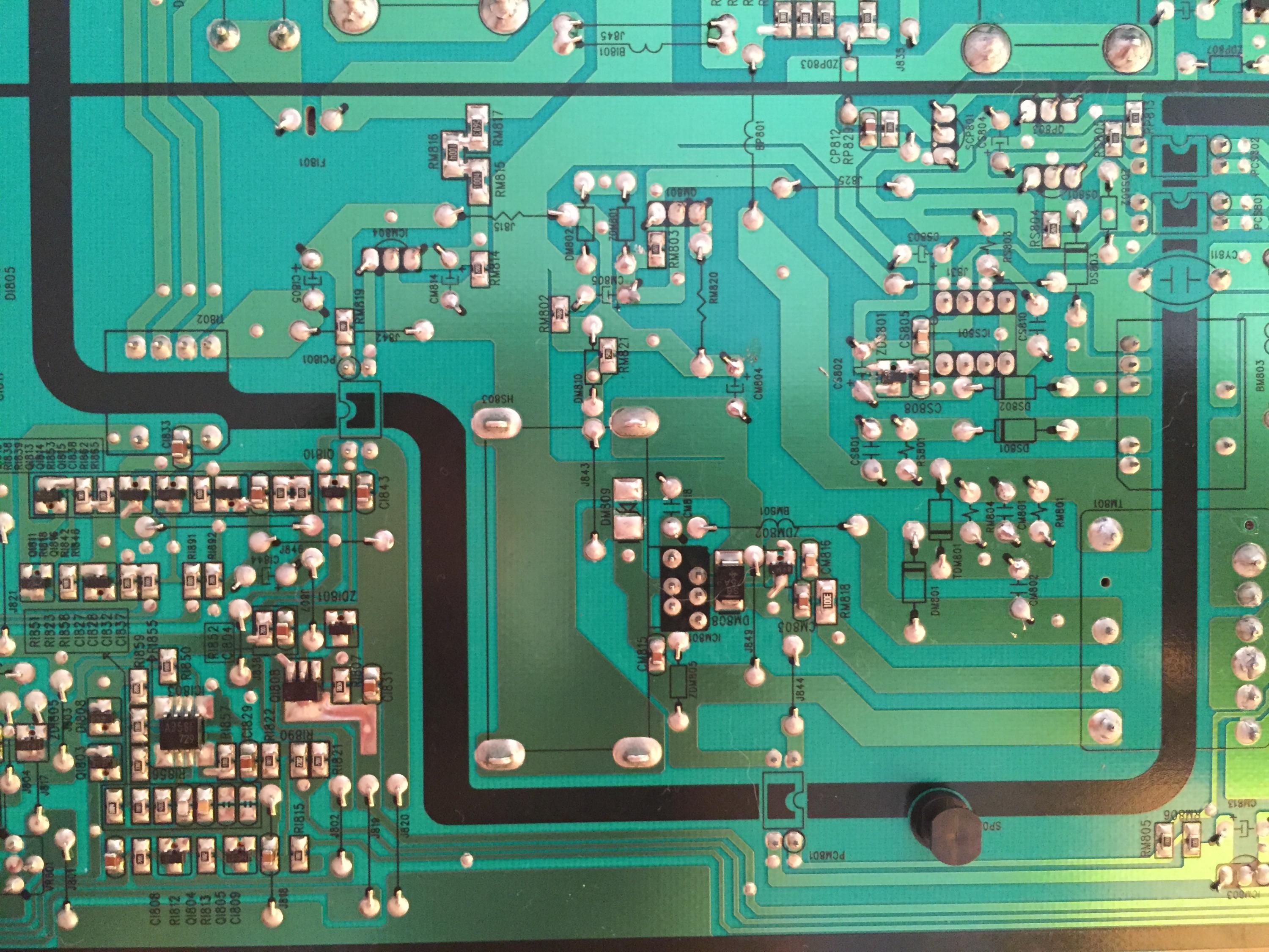

                      Power/inverter board detail:
                      Note that I have reflowed some of the solder connections that looked suspicious to me. Reflowing at 480c was quite slow making me think that solder on board is silver bearing.
                      Looking forward to your continued support and feedback
                        Which version? A, B, C, or D?
                        http://www.shopjimmy.com/catalogsear.../?q=BN44-00167

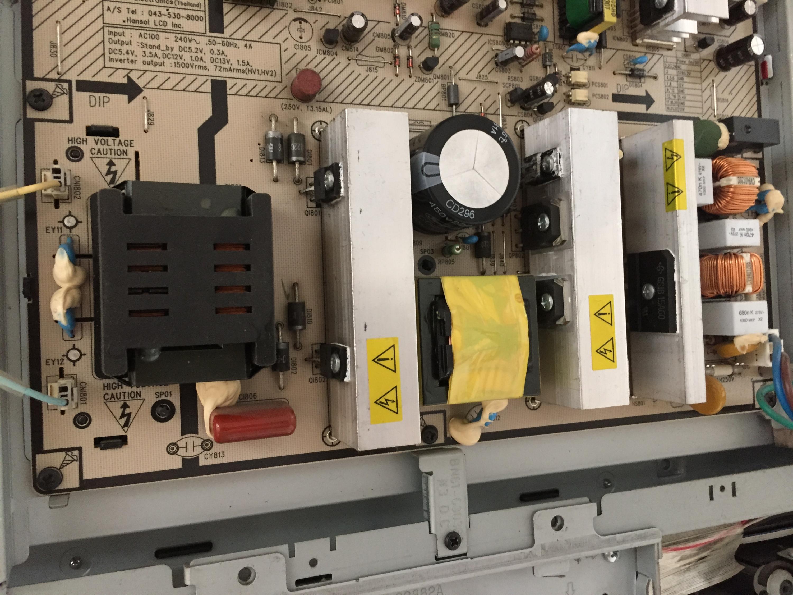

                            Noticed on the schematic that shows the inverter feed that there is a 16 pin DIP shown below the two switching transistors connected to the 385vdc coil feed. I do not have this cup on my board do assuming it was part of the rev1.1.
                            All voltages check out so now will confirm if the transistors are switching. I don't see how they could be since there is only one other winding that connects to the BL's.
                            Thanks again for the help thus far!

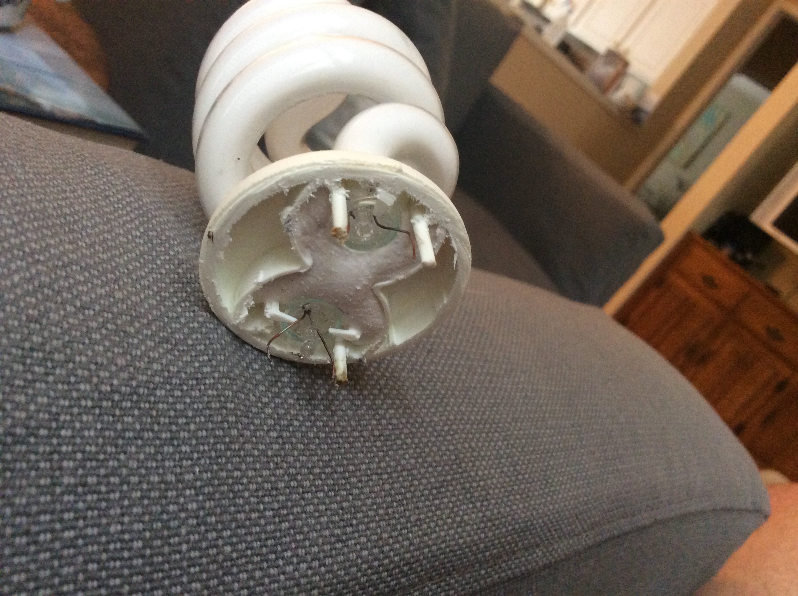

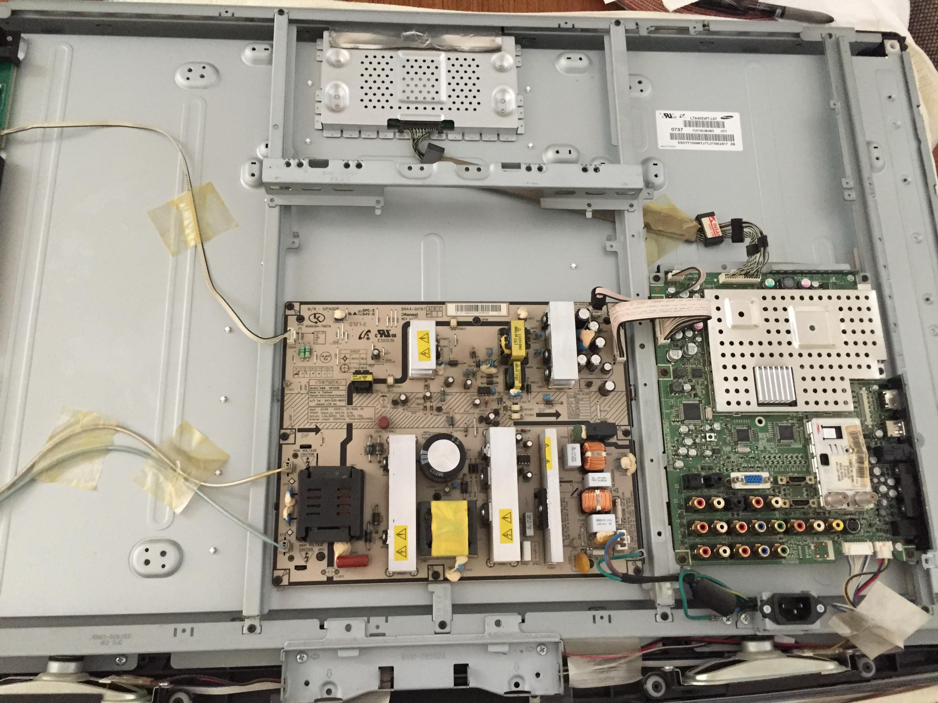

                              TESTING HIGH VOLTAGE CONNECTING A LOW WATTAGE CCFL TEST BULB
                              This method is described and introduced by Budm and offers a handy way to test the BL drive from the power supply board.
                              My test lamp has two leads on each end of the helix shaped lamp. I am looking for clarification as to the proper connection the two pairs of lead for the BL test. The test lamp Budm used seems to only one lead coming from each end of the heliax test lamp.
                              Thanks picture attached.
                                I just twisted those two wires that come out from the lamp's end together, that is why it looks like one wire.
                                So which revision of the board you have? If it is not A or B then the diagram may not match what you have on the board.
                                You may not be able to use this lamp for testing, the power supply/inverter board high Voltage output is fed into the Balancer board.
                                There is a small connector from the Balancer board to the Power supply/Inverter board, you need to take the DCV readings on the 12V pin and the LD pin.
                                We know we have high Voltage because the backlights did flash on for seconds, but the circuit may have gone into protection shutdown.
                                    just looked at picture 2 the A version box on the pcb board printing is ticked so should be the A version he has if the op cant find the details.
                                      OK, I see the board number on the barcode sticker now.
