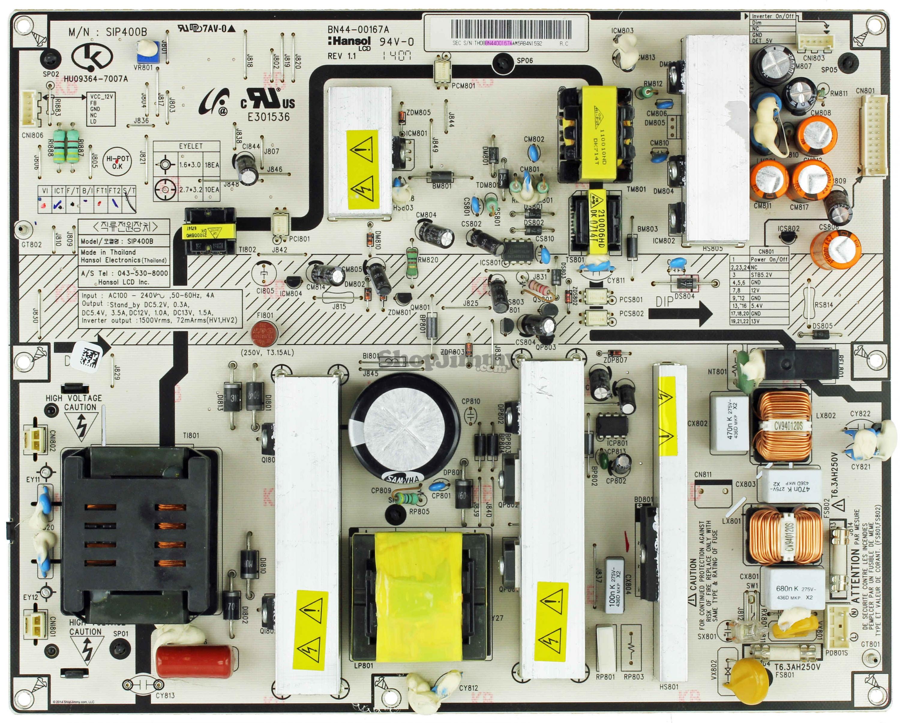

      The new problem I reported was today requesting additional assistance was due to a troubleshooting 101 oversight on my part. When I attempted to measure the pulse rate with my DVM at the GATE OF ONE OF THE MOSFETS Q1801, the set powered off. What actuall happened was SOMEHOW THIS TRIPPED THE AC breaker in the house, unknown to me at the time so it appeared the set now had no STDBY power. I discovered the set had no AC FEED and reset the breaker. So still no backlight but back to normal elsewhere with SDTBY and sound.
      IF THE TWO CCFL HELICAL LIGHTS WORK ONE EACH OF THE TWO HV leads to the inverter board, then the issue must be in the inverter board. I've examined it closely but four nothing obvious. I will need to disconnect the inverter board from the power board to connect the two test lamps but this also leaves no FB signal from thr inverter board to power board. Without this FB, will the power board generate the HV bias to light the test lamps??

        Please see post 16, I need the DCV reading of that small connector on the balancer board: the LD pin and the 12V pin to see if there is an error signal or not.

            Well, I am still waiting for the DCV reading on the connector CNI806 on that power supply/inverter board.
            12V pin and the LD pin.

                Re: Samsung LNT4053H BL ISSUR
                12v pin 12.02
                LD 10.21, at the moment LCDS flash on, drops to 1.3v

                  Originally posted by jkb242
                  12v pin 12.02
                  So the LD drops down to 1.3V? That means the LD (Lamp Detection) circuit has detected unbalance condition due to one or more of the lamp is bad, or bad balancer transformer (not very likely).
                  For normal operation, LD should be around 10~11VDC.
                  You can watch this video: same setup as your TV.

                      You should test those Voltages as shown in the Video. The LD should never drop unless it is triggered by the fault.

                              As provided in the video from Norcal715, the test points for each transformer for pin 2 showed consistent readings of 0.09 to 0.13, except the one associated with the weak or bad lamp. It showed 0.52. I had seen this originally but did not consider it as a fault indication, as ALL of these readings were an order of magnitude lower than Norcal715 showed. Among the readings in my set however, most of them being closer to 0.09, the 0.5 reading was close to 10 times (20db) higher. This had to be the one transformer of the defective lamp. I removed the transformer and replaced it with a jumper across the two outside pins on the solder pad, restarted the set without fault detection.
                              As Norcal715 showed in the video, with a solid color background, that's the only time the missing lamp is noticeable exactly as indicated in the video. Certainly no reason to create more electronic waste to which this one was headed when I was offered it for free. Thanks to all guys and gals, this is a maverlous forum!!
