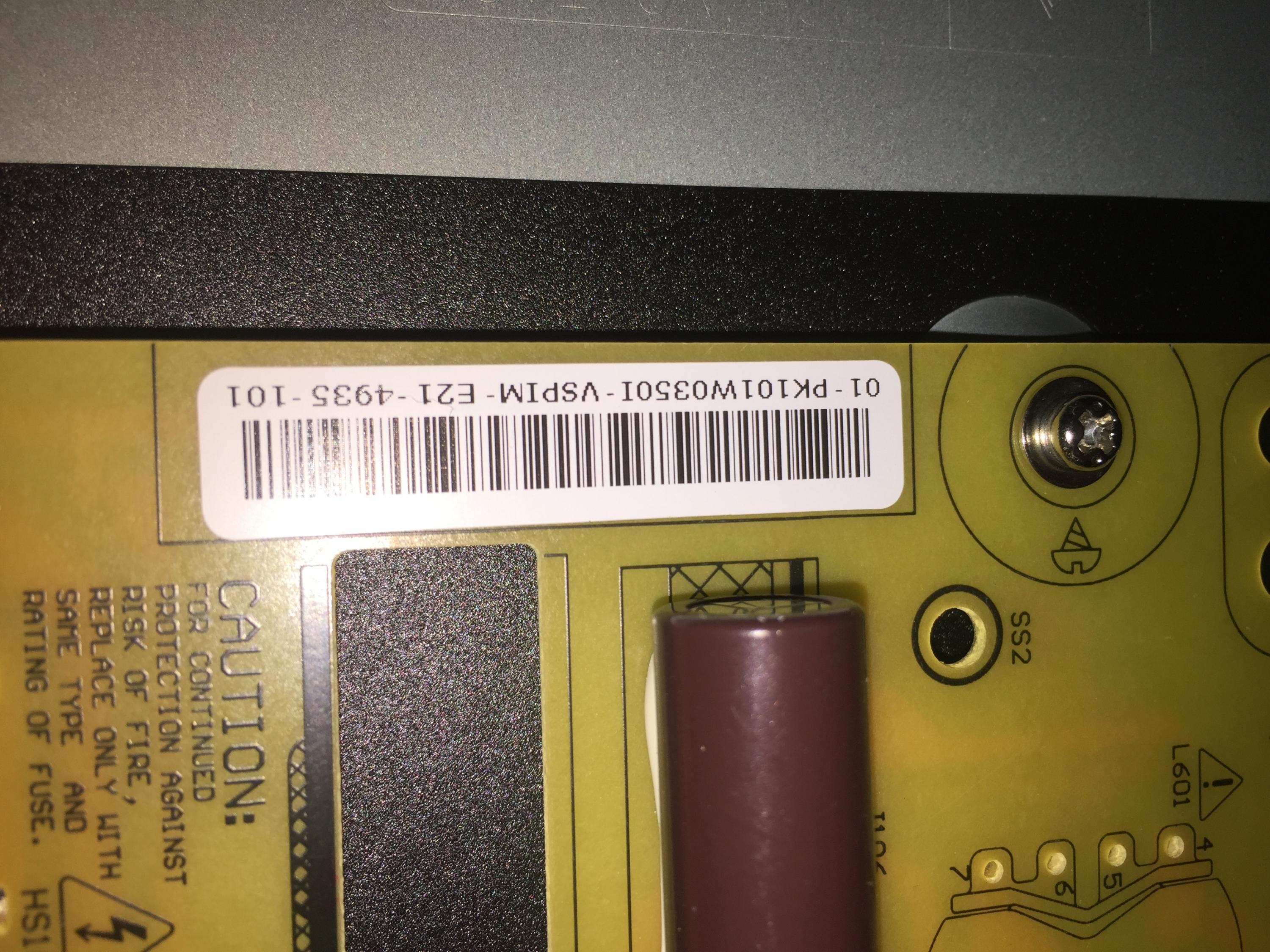

    We purchased this TV back in November 2014. I didn't really have a need for it at the time but it was a really good deal so it sat around in the box till last month. So I get the TV set up and it's running great. Then all of a sudden it takes like two minutes to turn on. I didn't think anything of it. Then it's taking 20 minutes. Unplugged the TV, plugged it back it and it seemed to power on. Then doesn't turn on at all. Went and did other stuff and a few hours later it just turns on all by itself. Freaked me out a bit because someone was talking and I was home alone. Anyways, what I figured out is that it turns on right away in the morning and works just fine but if I turn it off at any point in time it will take hours to turn back on. Lately I haven't been able to turn it on at all.
    I called tech support and they said it was our of warranty even though I just got it set up. I guess I understand their point too. So I figured it's probably bad caps. I pulled the TV apart and took out the power board. I can usually fix pretty much anything but I am a little stumped with this one cause everything looks good. I found a used but tested power board on ebay for cheap and ordered it. Figured I would use the shotgun method. Got it installed earlier today and the TV still does nothing. Does anyone have a suggestion?

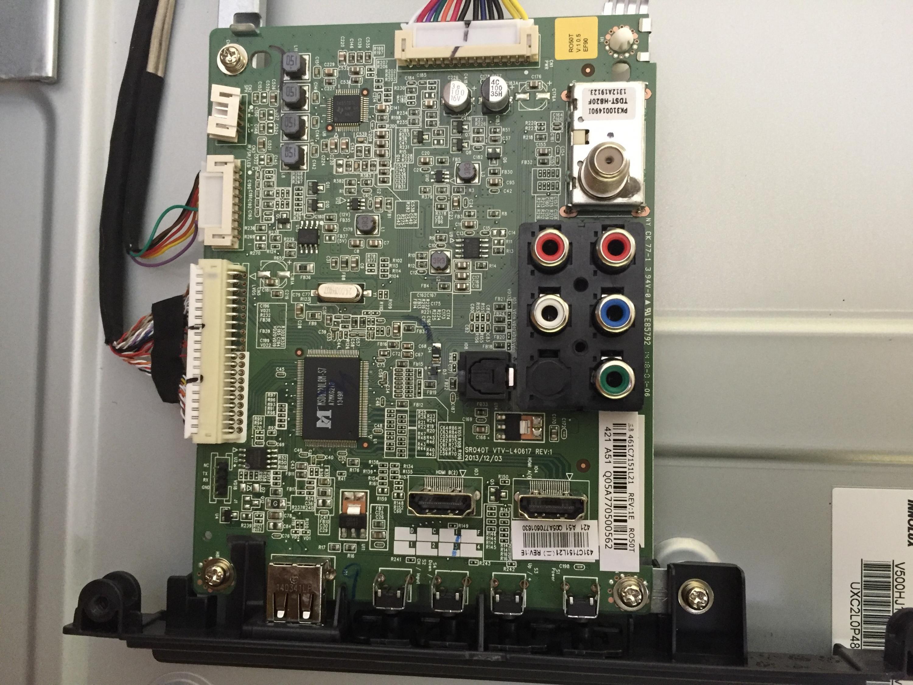

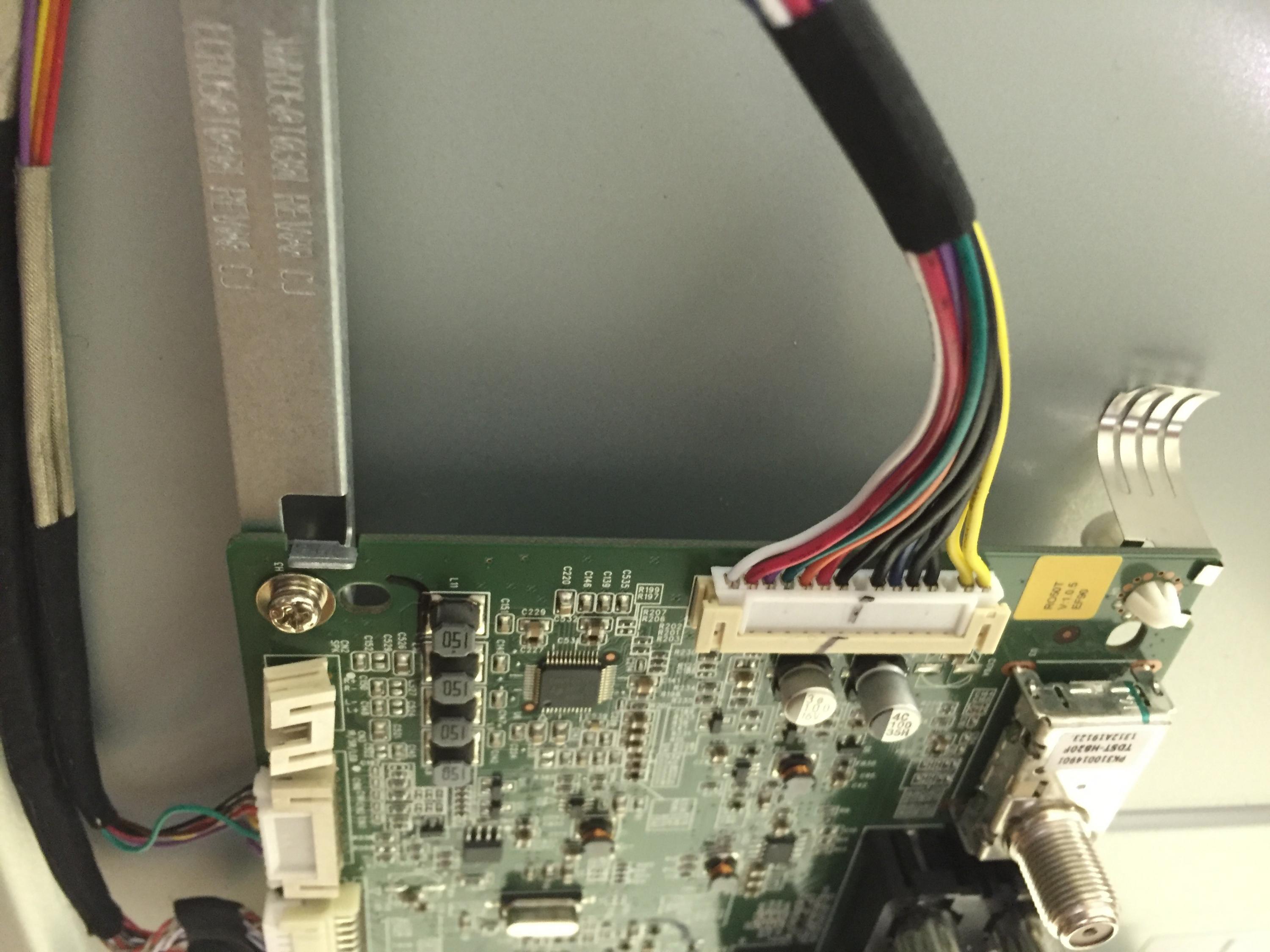

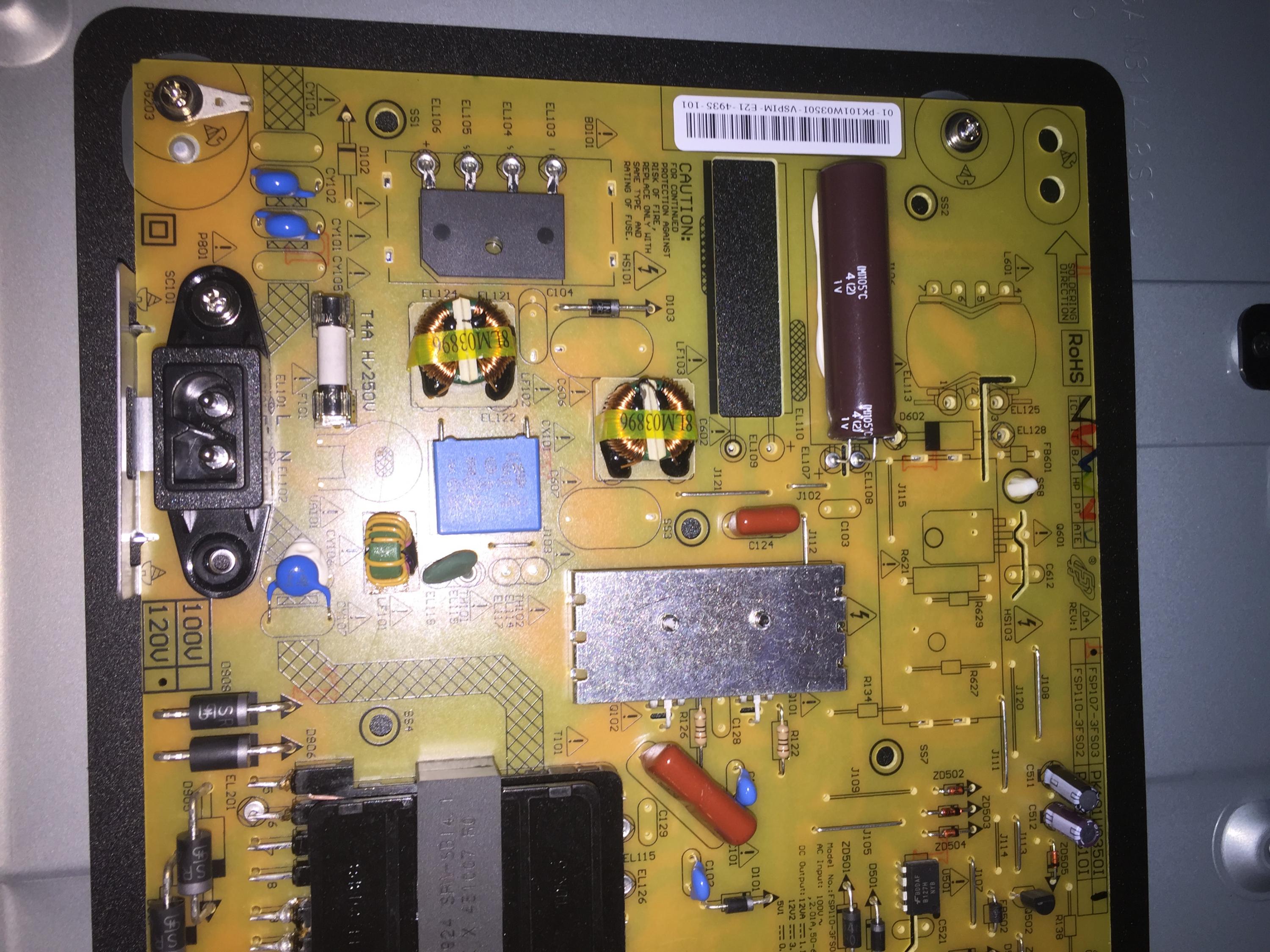

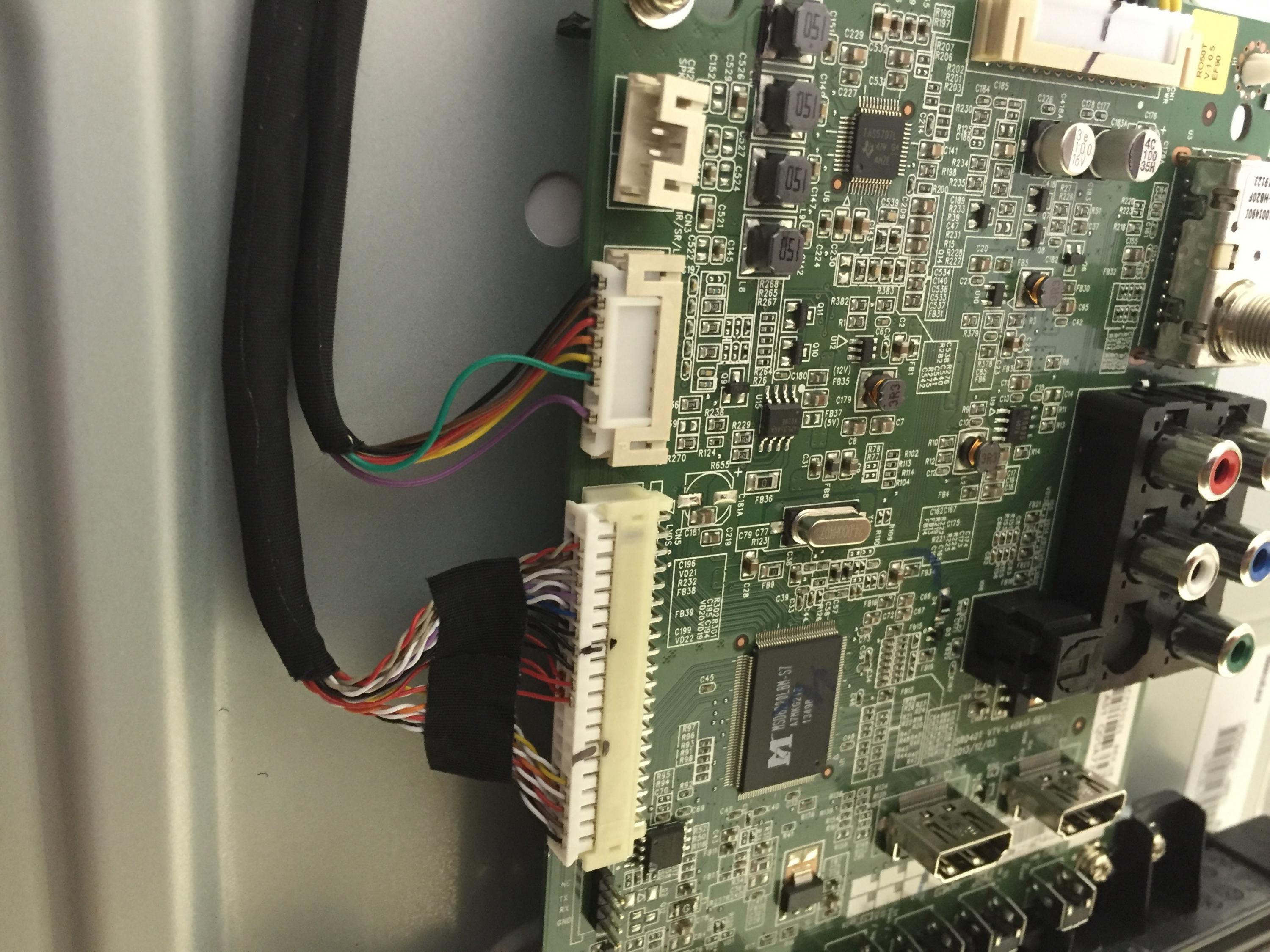

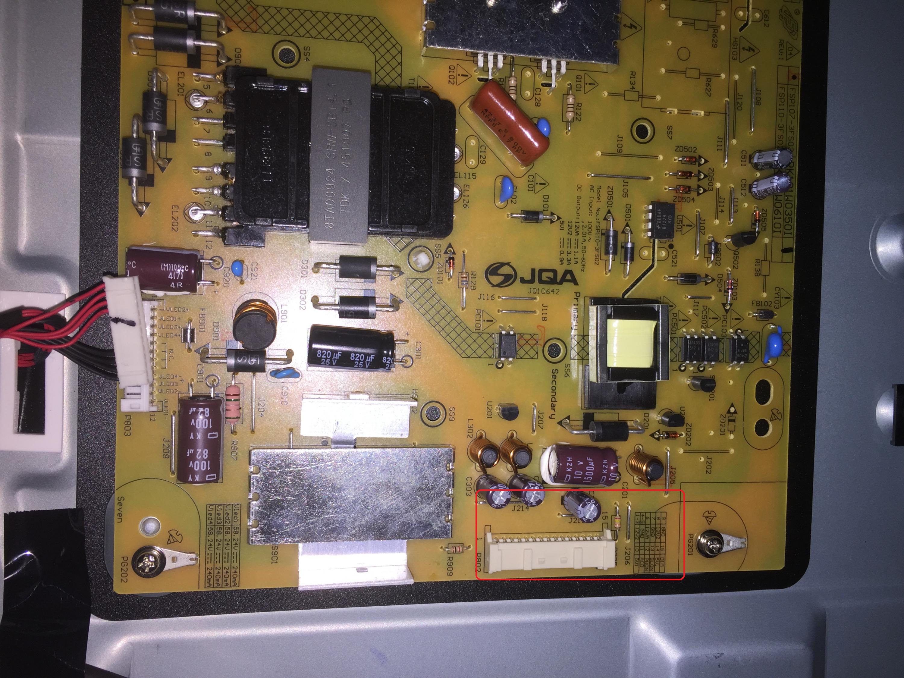

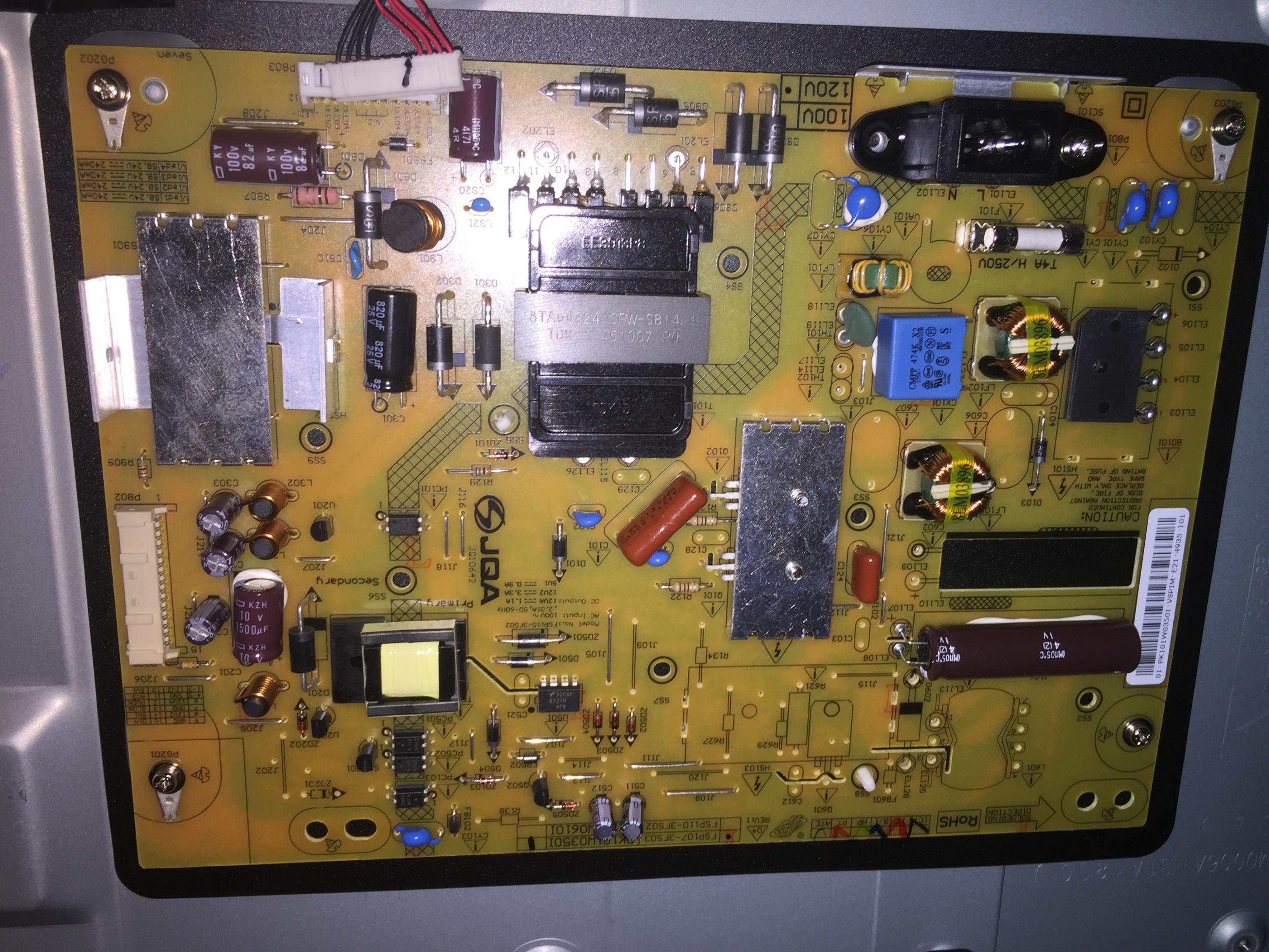

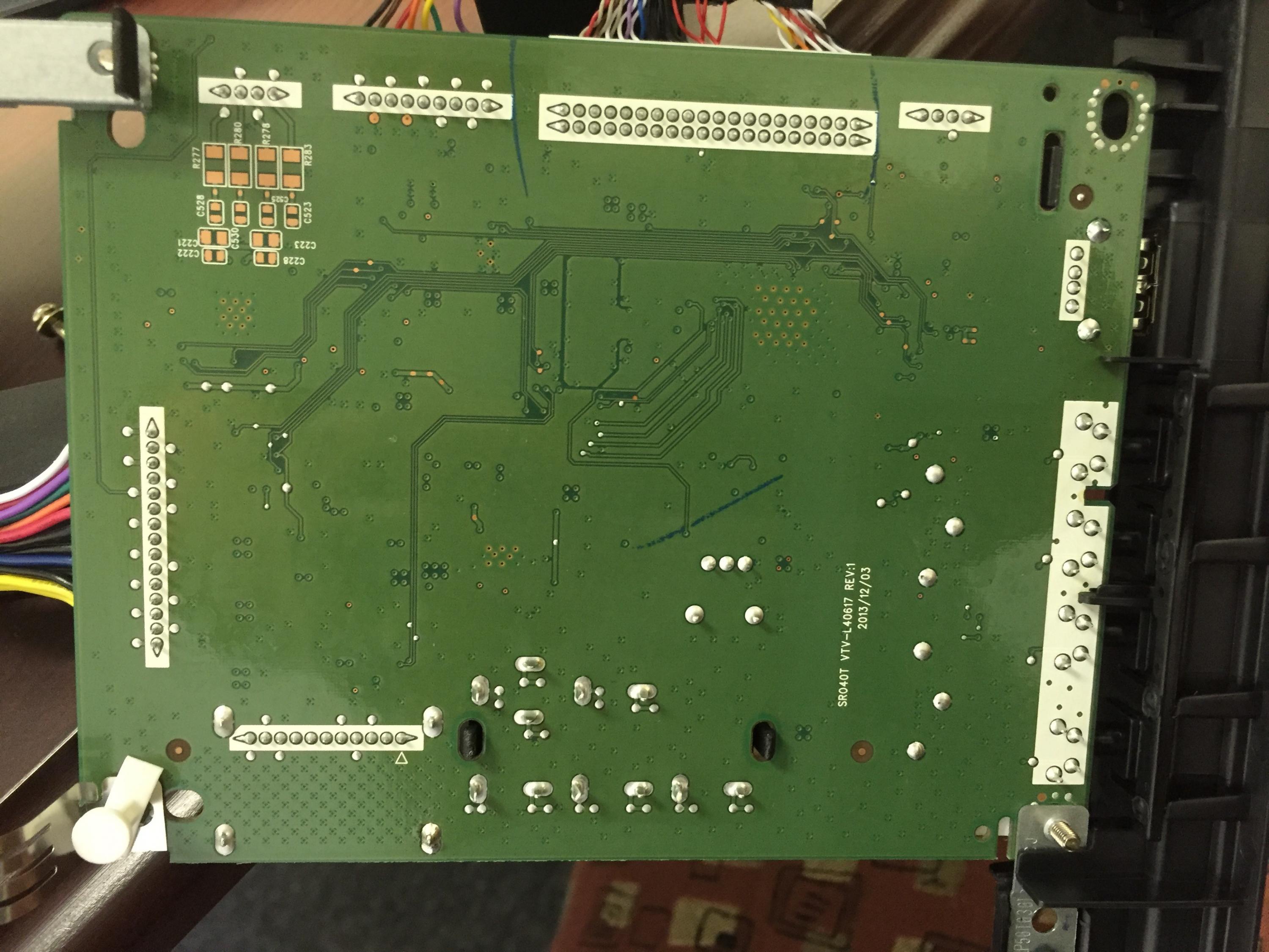

          • Escalus
            • Aug 2016
            • 12
            Re: Toshiba 50L1400U Takes forever to turn on and now not at all.
            Pics of the board.
              If you can give the voltages at connector P802 with the mainboard disconnected.
              Pin 1 to Pin 15
                • 31196
                replace c511 and c512 if you want to try a quick fix.
                it may sort the problem.

                          • Escalus
                            • Aug 2016
                            • 12
                            Originally posted by Diah
                            its not PWB issue, its clutch at eeprom of Main board. it keep search and trick it, till the pits firmware go ahead to switch second step of Hz to let PWB turn on power, would be nice if you placed here the MB photos from both side.
                            now some will post here whom was silent since his first post ..lol
                            Are these the pictures you are looking for? If not, please let me know and I'll take some different shots.
                            Thank you.
                                      On your post #14, the first picture on the bottom left. IC U2 looks like it has a piece missing on the corner at pin 1. Can you verify that it isn't damaged?
                                      Reseat CN3 to see if the STBY LED comes on.
                                      • Escalus
                                        • Aug 2016
                                        • 12
                                        I just looked at the unit and the corner of U2 is chipped for sure.
