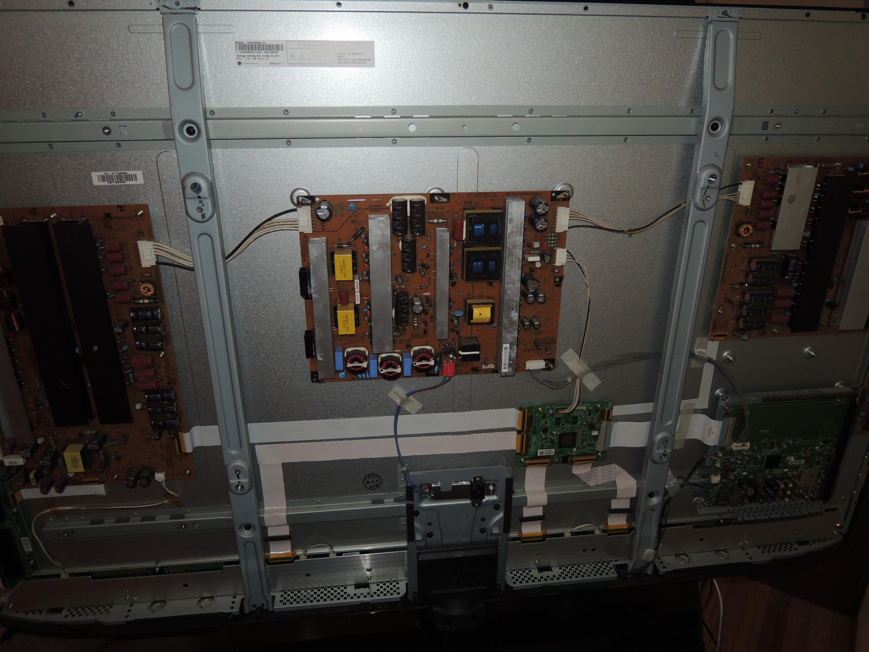

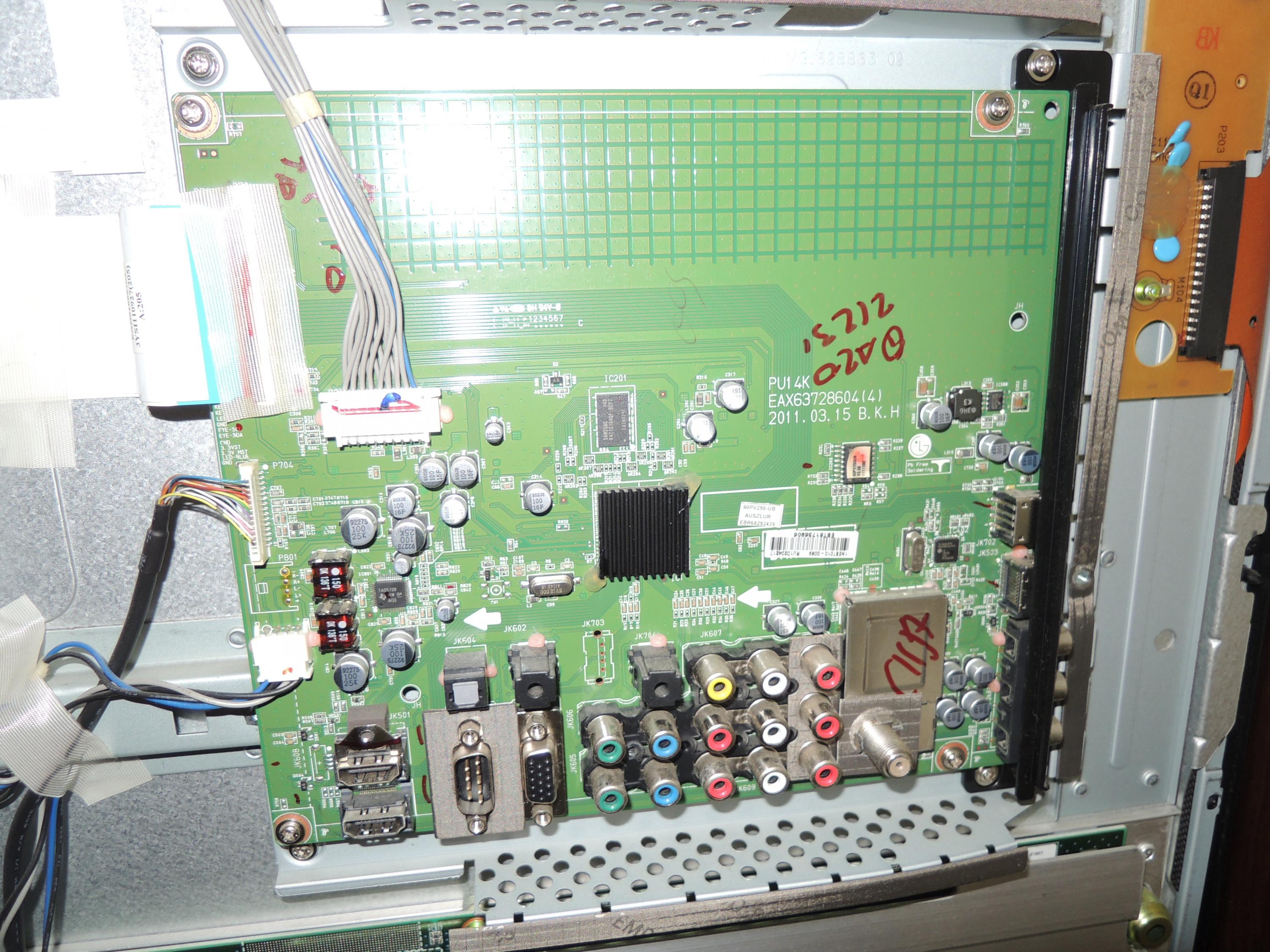

    I'm having an issue where my LG 60PV250 will randomly shut off into standby mode.
    This problem started out infrequently and became worse and worse over a few days. At this point I can barely get a picture for a a second or two before I hear the relay click, the screen shut off, and the red LED standby light come on.
    As a layman, I assume its the power board. I don't see any bulged capacitors, but that's about as far my troubleshooting skills go in terms of televisions.. Hopefully I can solve this during power off since these large voltages/amperages scare me a bit.
    Thanks guys

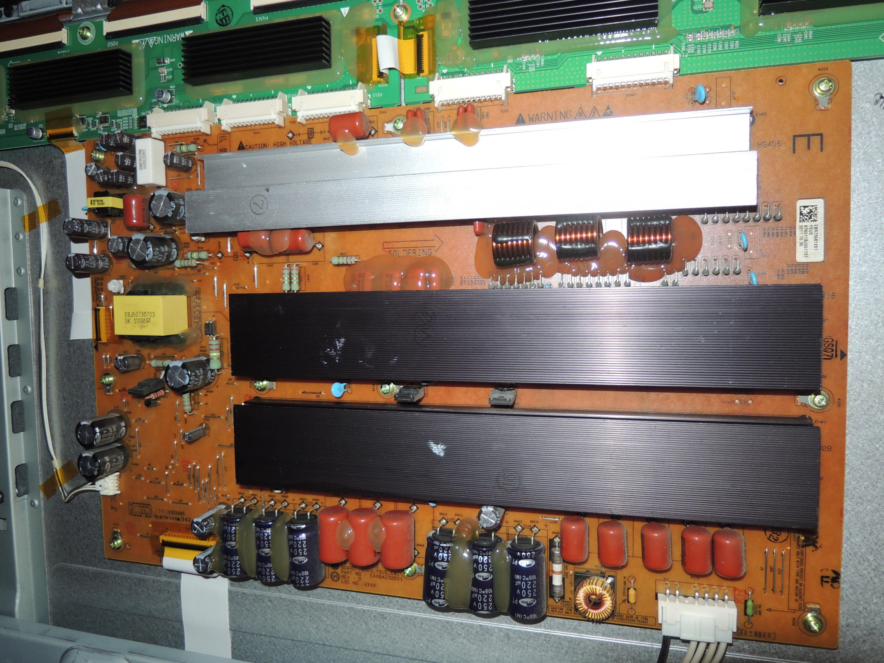

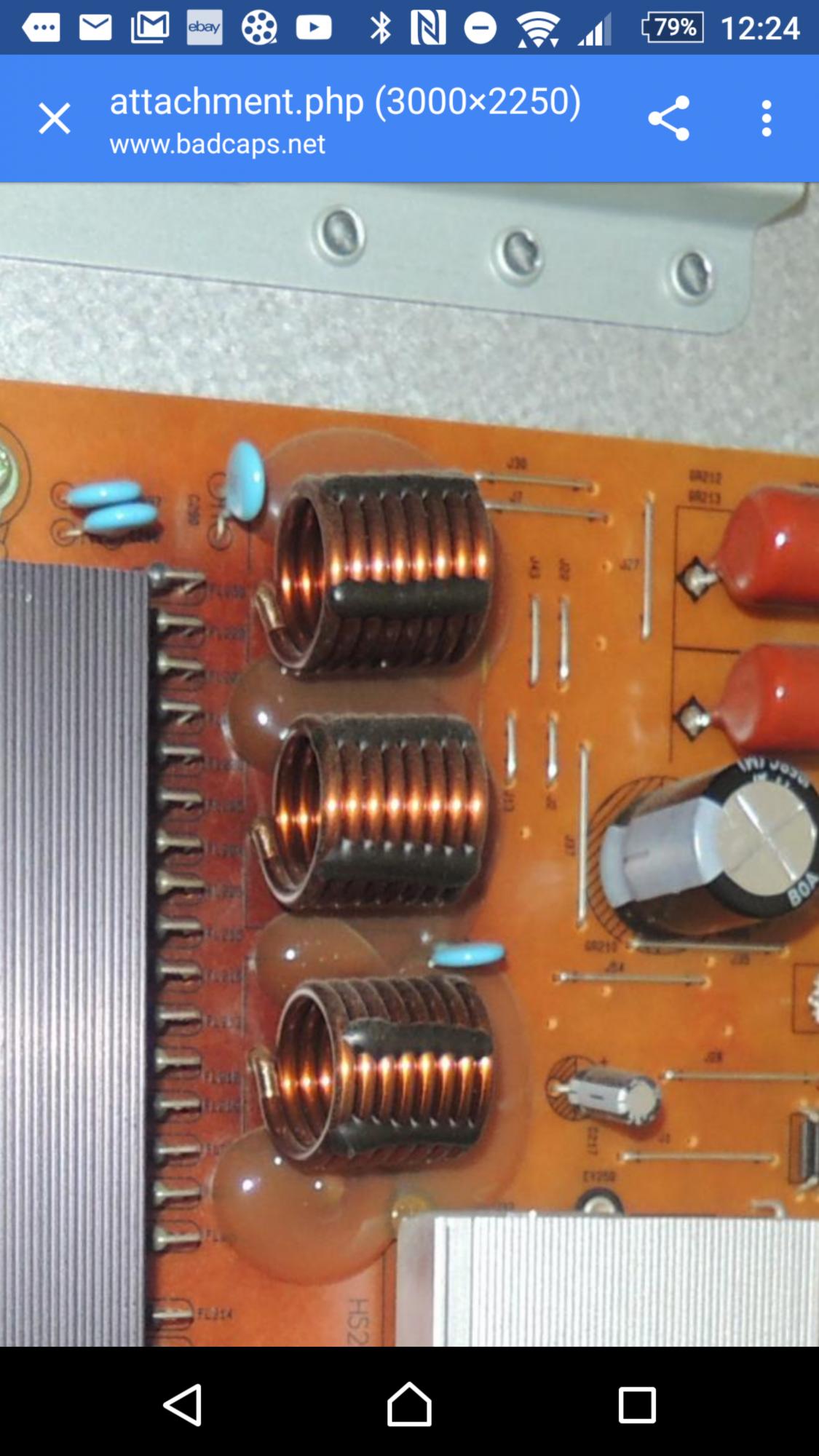

    Unplug the z-sus try to turn on the tv, it turns on and stays on you have a faulty z-sus.
    If so, remove the z-sus and inspect the solder of the coils located here:

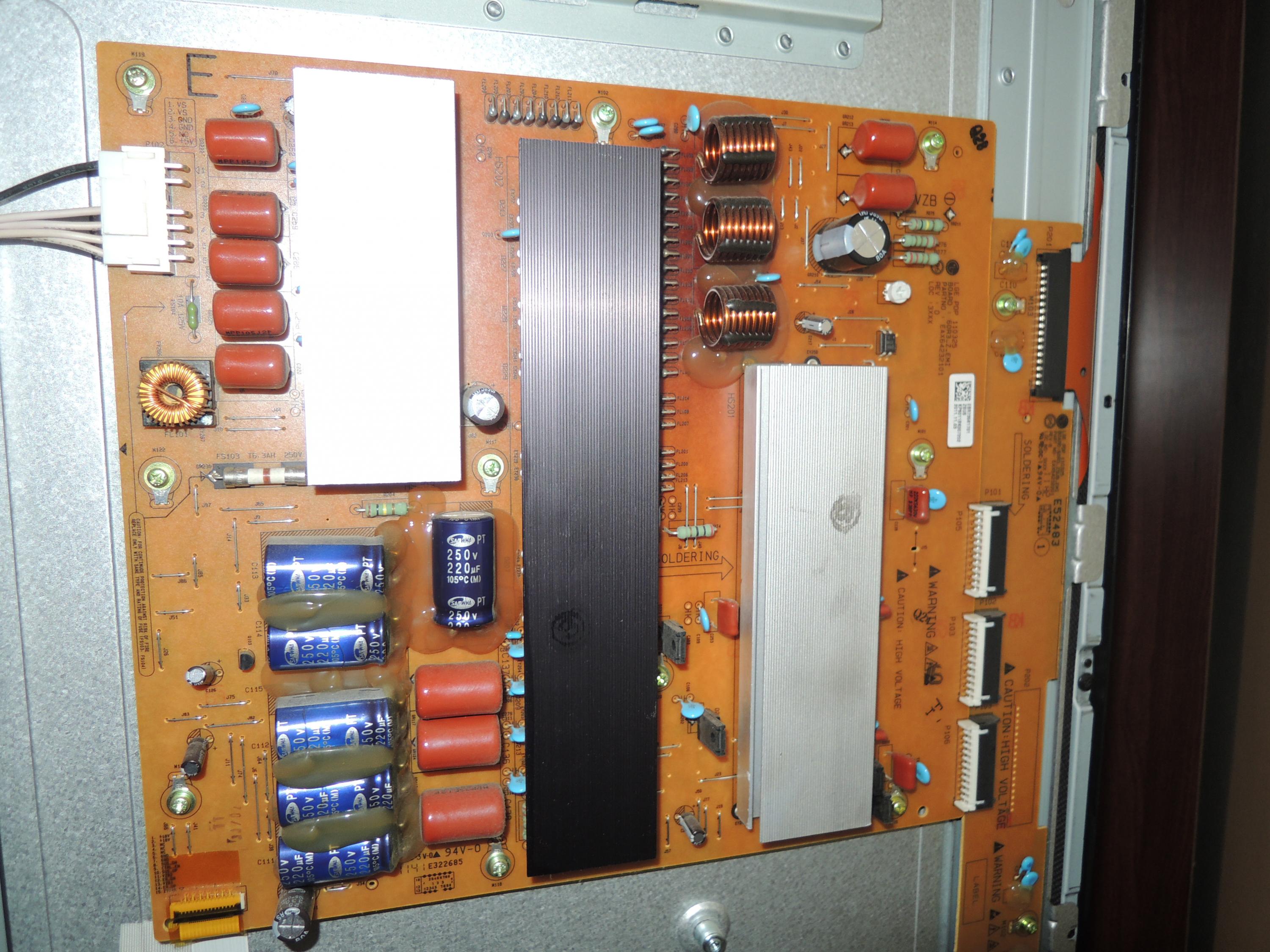

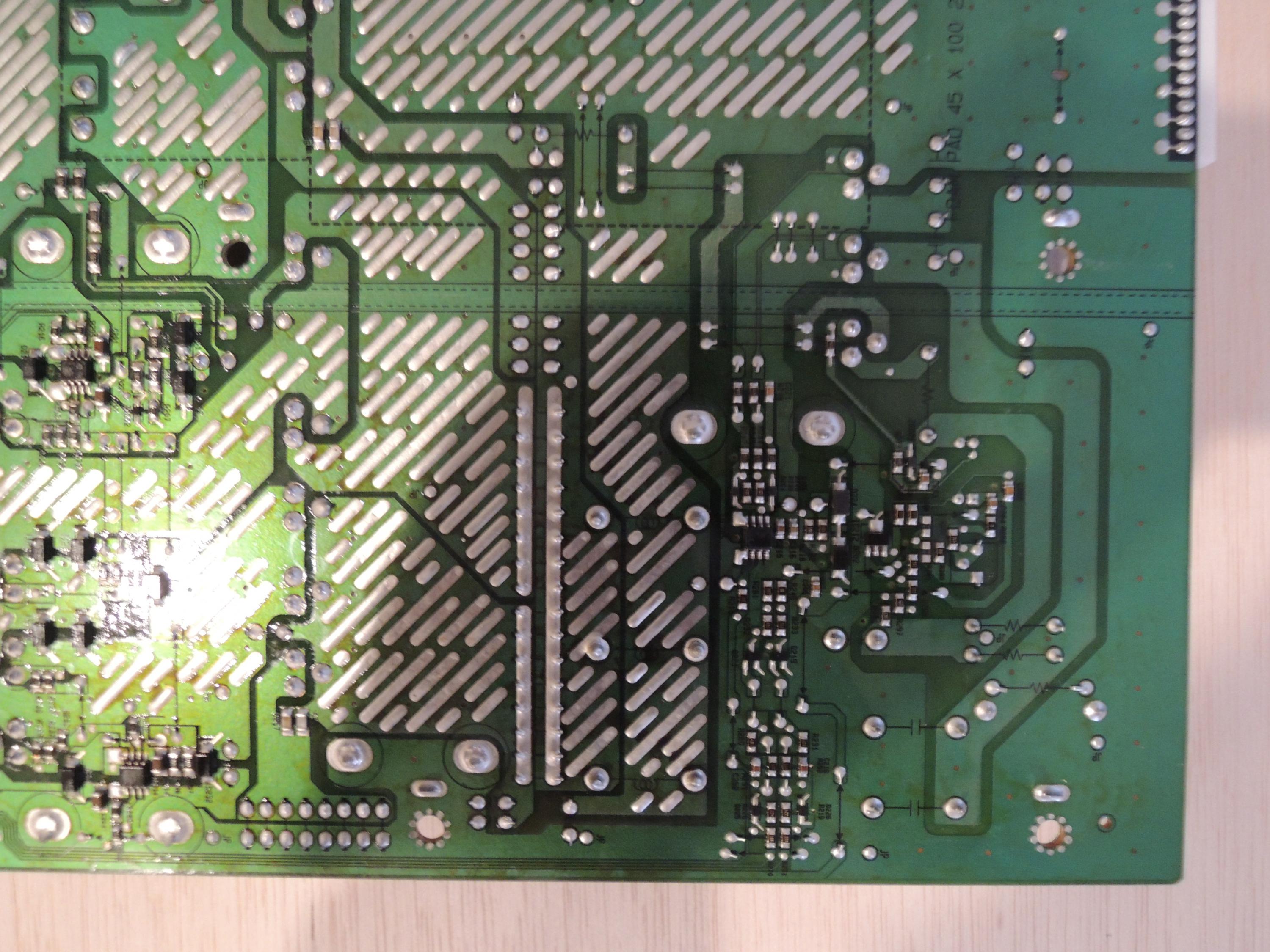

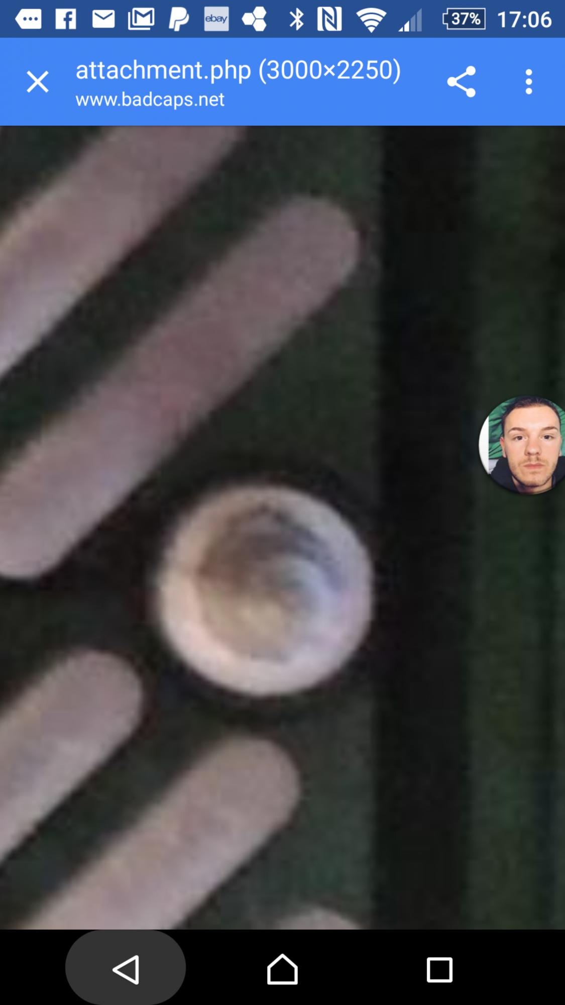

      Re: LG 60PV250 - Erratic shut off
      Unit seems to remain powered when unplugging z-sus. It did turn off once, but I believe it was on an unused input and triggered the "no signal auto off."
      Attached is a picture of the solder joints on those coils. They look fine to me, should I try reflowing?
        Yes
        this one doesn't look fine.
        Is the fuse still good on the z-sus?

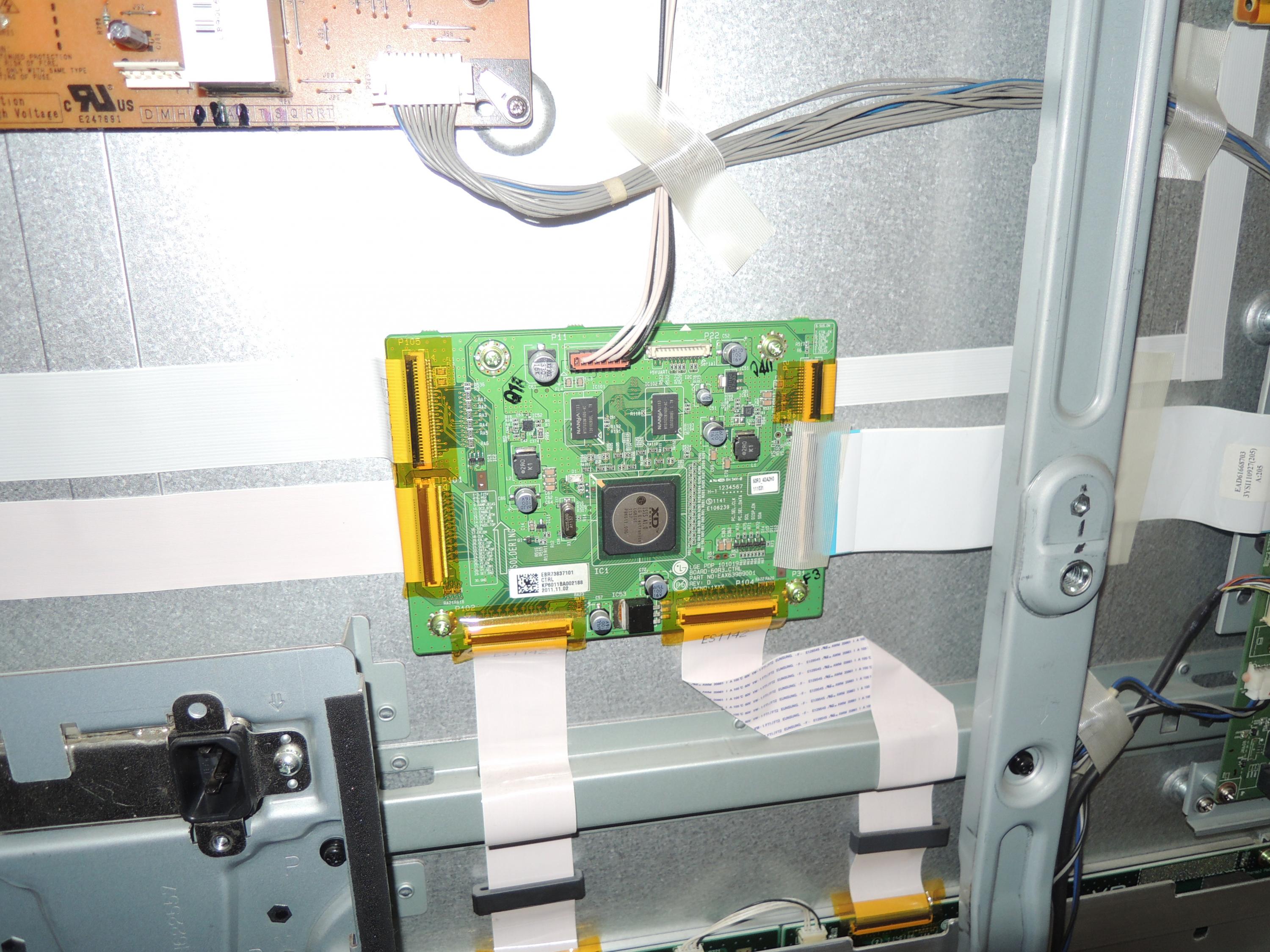

          Also if your logic board (the small board pretty much dead center with the 6 flat cables going into it) has a "EXT_AUTO_GEN" (or something similar marked on it) you can put the TV into a diagnositcs mode where it will display test patterns without the mainboard plugged in - this can be extremely useful for isolating if the mainboard is faulty. This generally involves putting a jumper over pins, or between holes on the board. I cant see it marked on your board unfortunately but perhaps it could be marked on the back. It looks like it should be the two holes to the right and slightly below the main chip, but without markings its hard to know if it is the auto generator or something else.

            I reflowed the solder on each of the 6 coil pins, and the fuse was still good. I plugged it back in and tried turning it on... there's a buzzing and the screen stops priming. Audio, no video. Could I have botched the solder job? Also, I saw that two pins are soldered together on the P103 connector to the Z sub buffer board on the right (pic attached). Normal?

              I would just board swap, but there's literally 0 if these on the internet.
              Also, there is a pic of the logic board in the op. Unfortunately I don't see any markings similar to EXT_AUTO_GEN.
                    I think you bridge the two holes next to R51 & R52 using a piece of wire or paper clip.

                            Post #10 from Dick Barton, I would agree with him for the test pattern.
                            Bridge those two points and unplug the LVDS cable(blue connector) then plug the TV in.
                            If you get test patterns and the TV stays on, you've got main board problems.

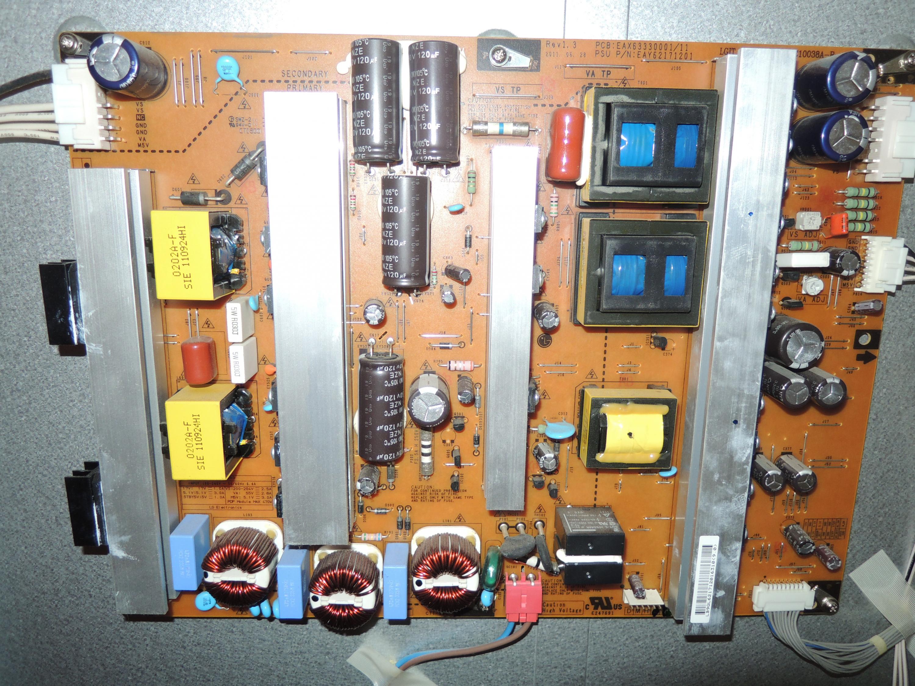

                                Sometimes I can get a test pattern for up to 20 minutes, sometimes it's only for a few seconds. It's very random, but always shuts off eventually..
                                Power boards on eBay aren't too expensive; would this be my best bet?
                                Thanks guys
                                    Power supply replacement resolved the issue. Thanks for all the help and info

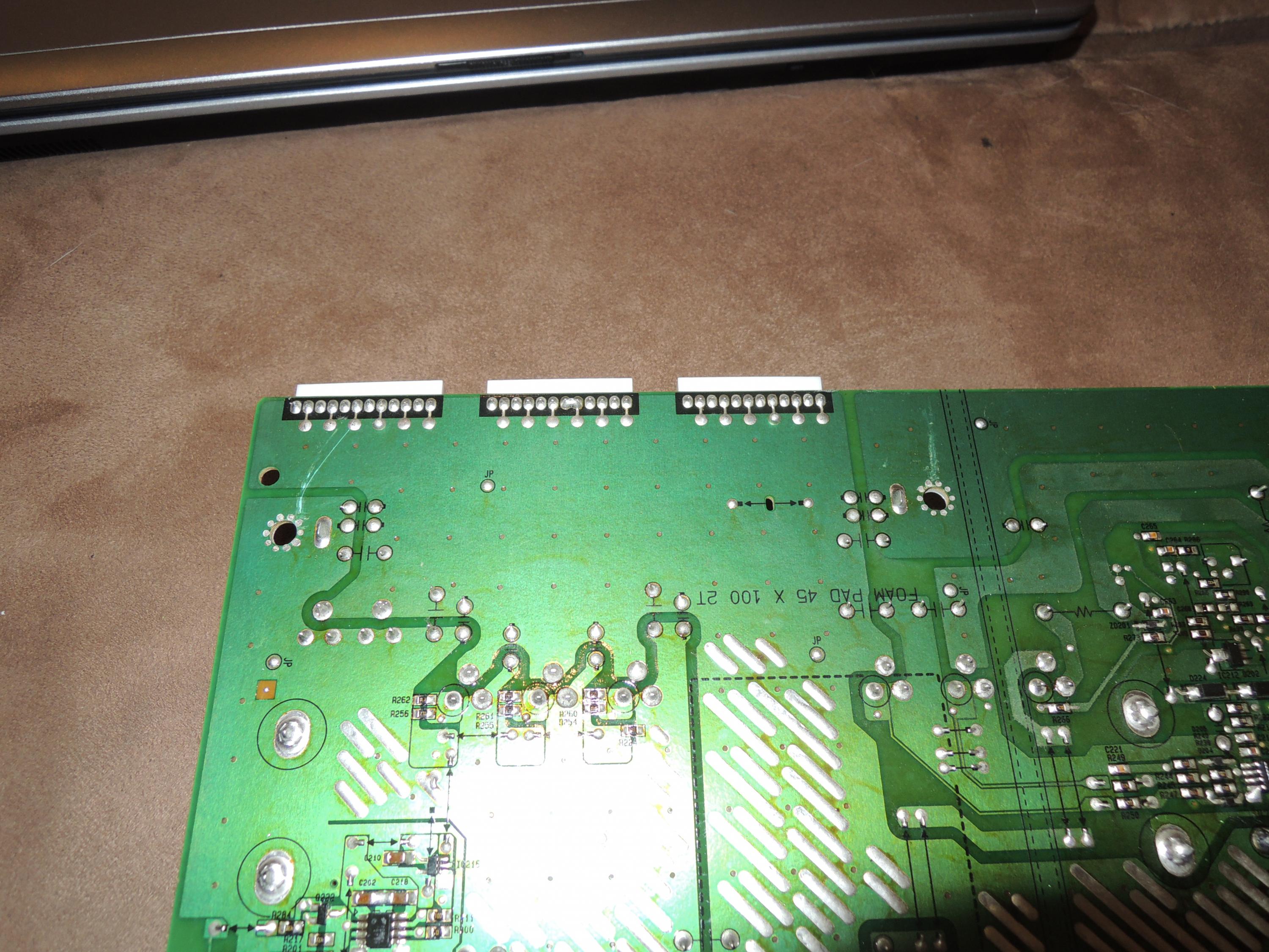

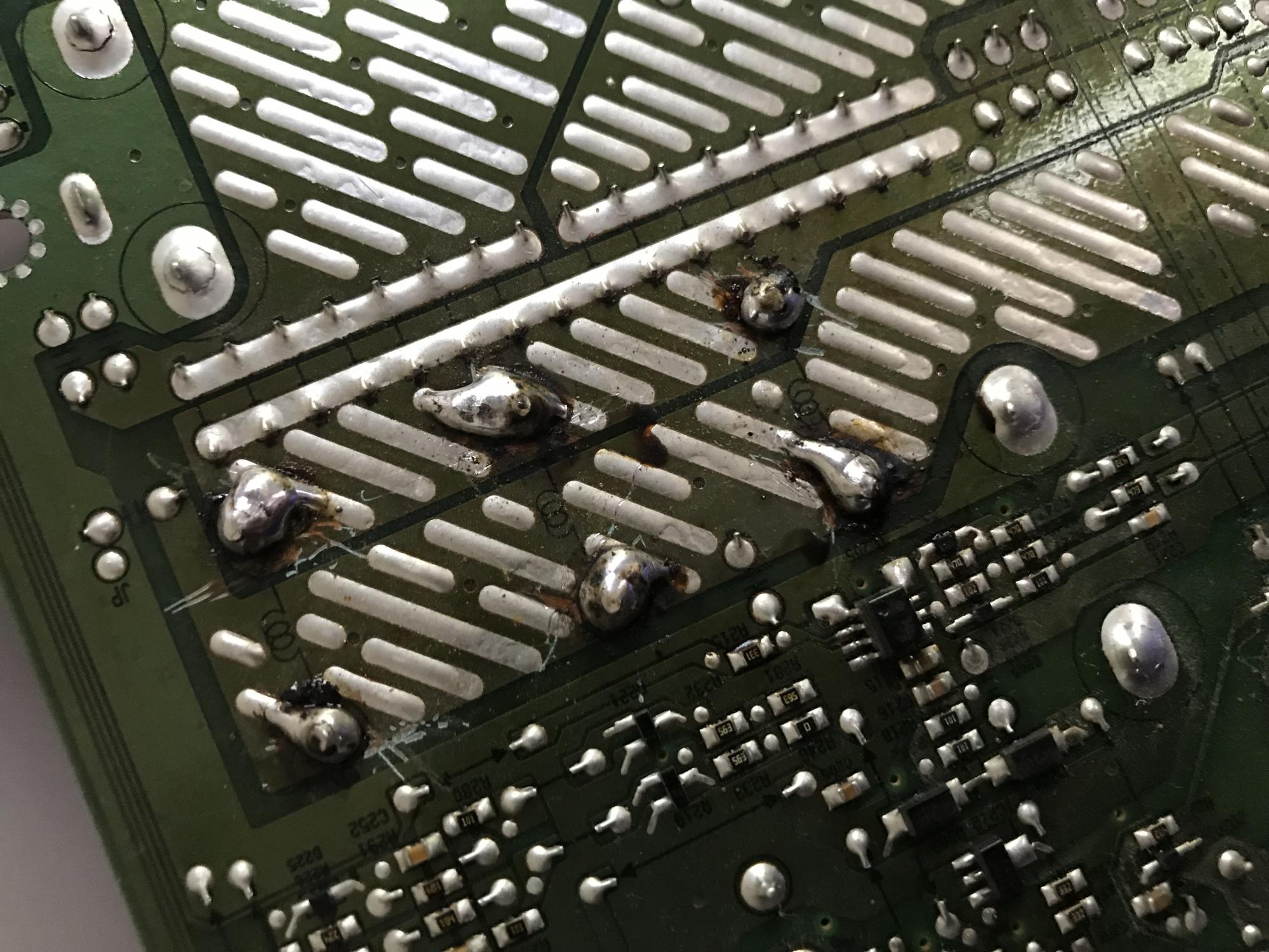

                                      Not sure if I should make a new thread but I'm having the same issue with the same tv. I went ahead and replaced the main board with a used “tested good” main board off of eBay but it's still turning off after about 15 minutes. Any thoughts?
                                      • seismicpulse
                                        • Aug 2018
                                        • 4
                                        This is the back of my zsus at the coils. Apparently the previous owner did some “soldering.”
