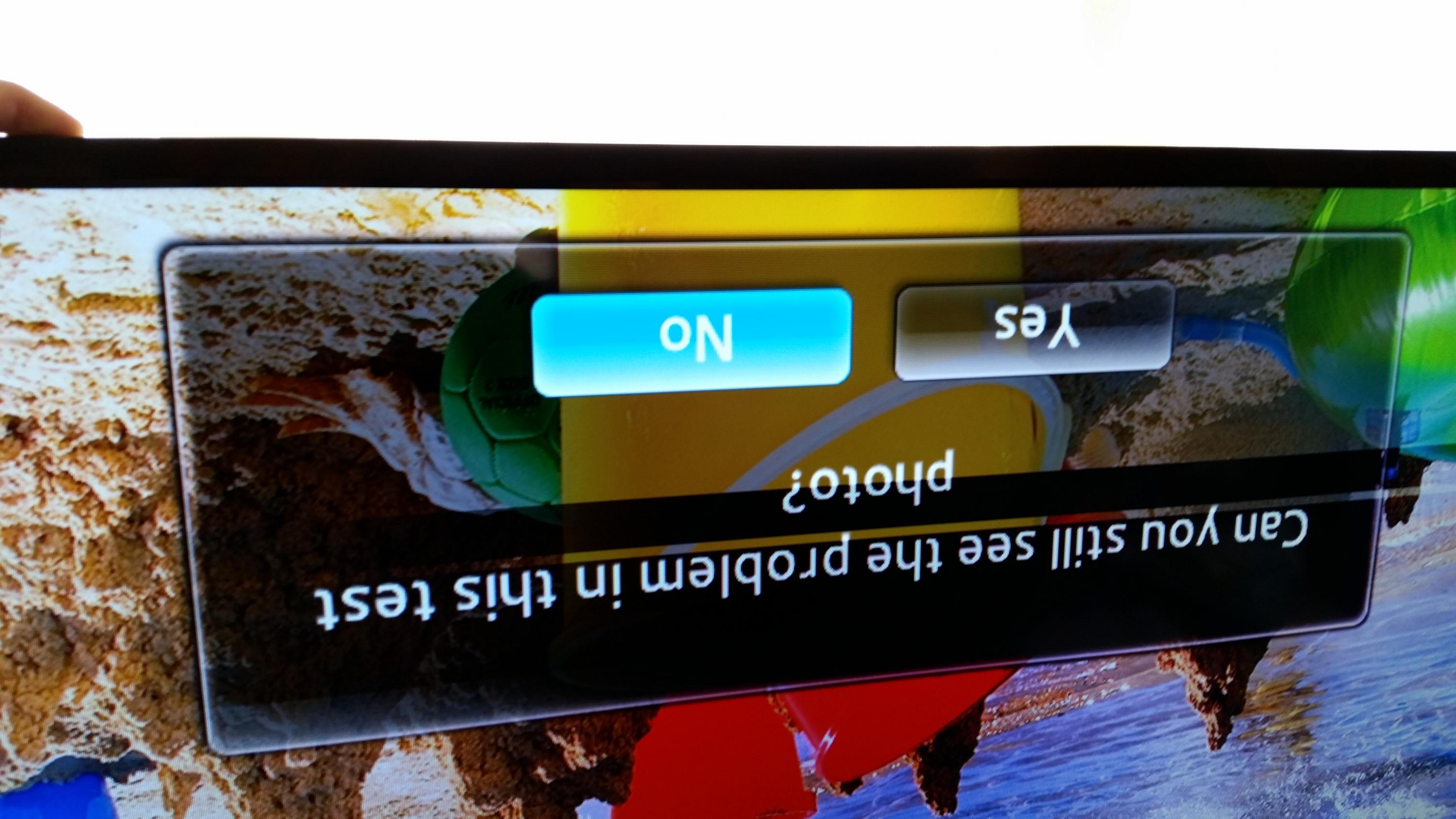

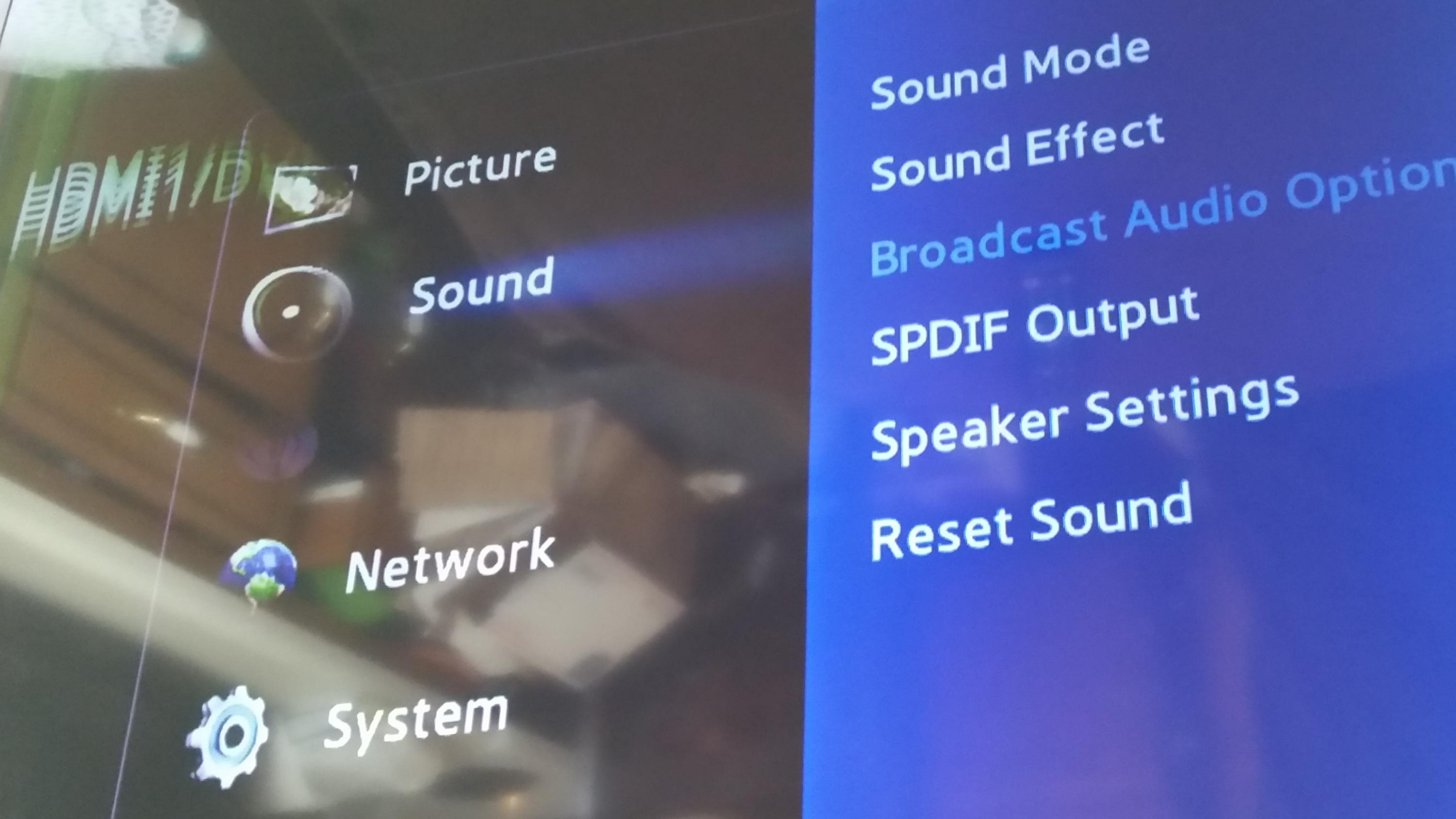

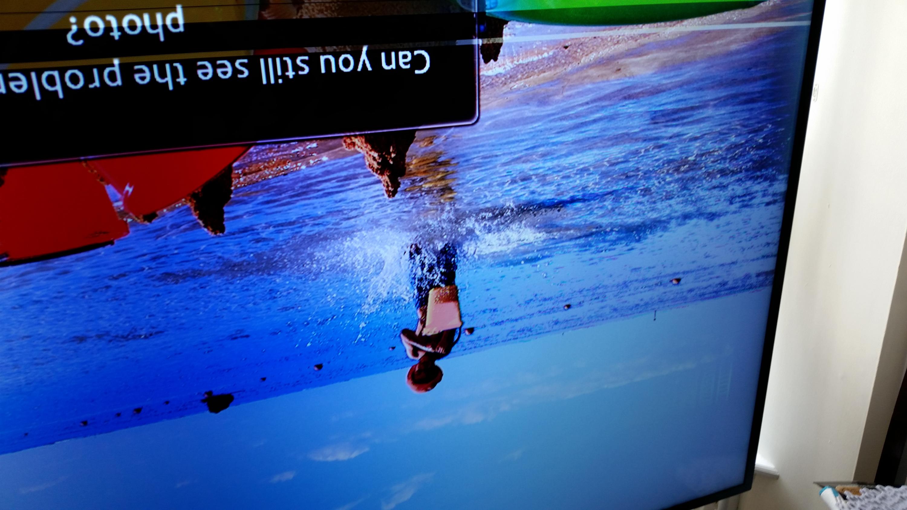

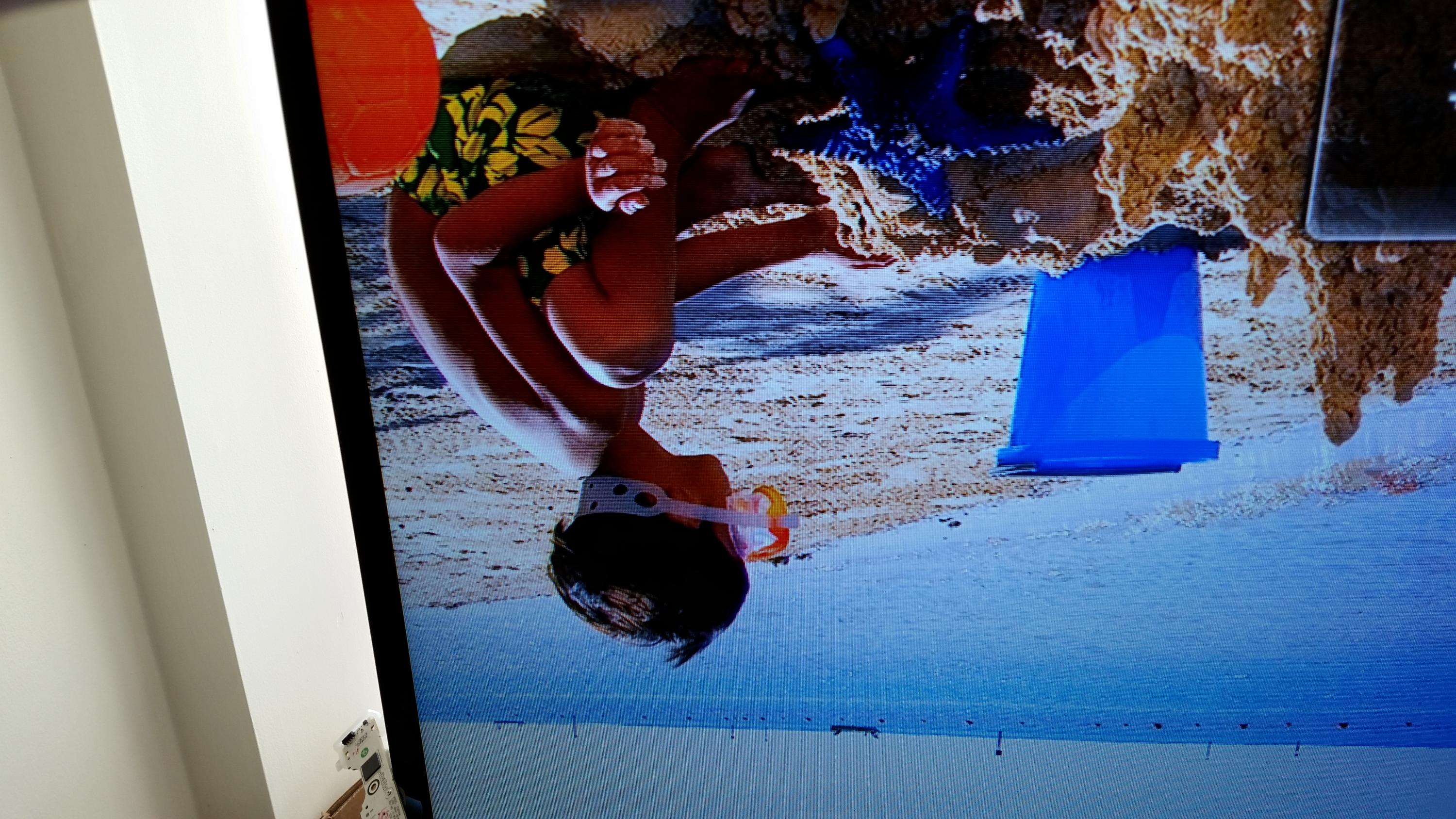

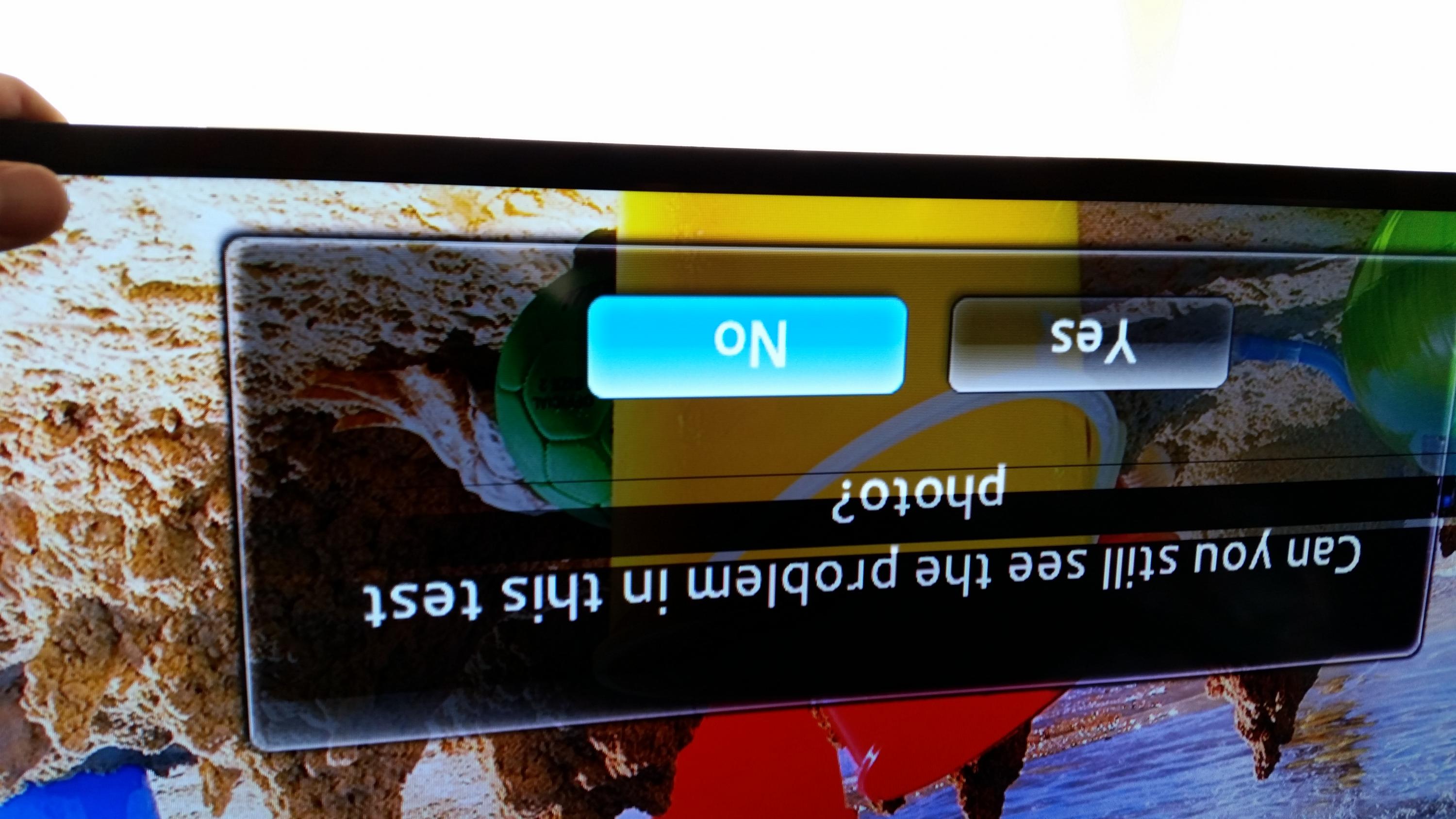

    So let me fill you in on what I have done so far, and where I am at. I have a basic understanding a TV repair. Checking voltages and what not. Majority of my skillset is in just replacement of boards, not physically soldering on new ICs or anything.
    I have a UN55ES6500FXZA that is giving me weird picture issues. After seeing enough issues I think I have it narrowed down to a bad T-CON,LVDS, or "bad panel".
    I first ordered a used T-CON for my TV. The used T-CON was pulled from a UN55ES6580FXZA with a cracked screen. The part numbers matched and it was BN95-00579B. It also came with the ribbon cables that connect from T-CON to panel, so I replaced those too just to make sure. The ribbon cables made no difference to the picture just FYI.
    So I did have partial success. The right 3rd side of my screen cleared up completely but I am still have some weird issues on the 2/3rds starting from the left. Here are pictures with the replacement T-CON installed. Do you suspect a bad T-con still and should get a new OEM one from Samsung?
    To verify it was actually the T-con that solved the 1/3rd picture clearup, I put the old T-con back in and problem comes back to the cleared up portion.
    I am also having double/triple imaging as well as the TV holding the video signal when things are switched, almost like image retention on a plasma or something.
    All of these issues extend into the basic menu/service menu and the picture test built into the TV.
    Thanks for any assistance.

    i had this same issue with the 50 inch model, turned out to be a bad screen, try and remove one ribbon from the T=con to the screen, turn the tv on and see what happens, the side that is removed should stay black, then try the same thing with the other side,

      Someone only in the last few days on the forum had an similar problem who said they had removed the problem following one of the guides on Youtube
      https://www.youtube.com/watch?v=j7vl7-vZEL8

        I will try both the youtube video suggestion and removing the ribbon cable on each side of the t-con. can you point me to the other thread that the guy fixed it? just want to see what specifically was successful for them. thanks.
