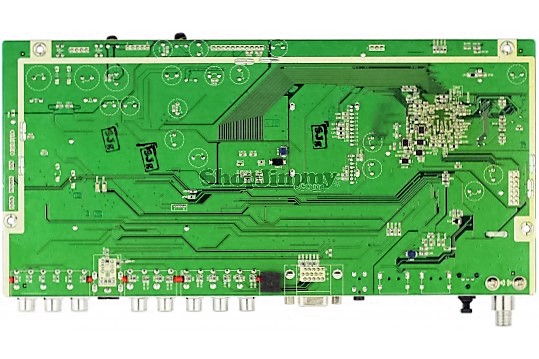

      Re: Insignia ns-lcd32
      try these if this doesn't work ill try again tomorrow.
      • CapLeaker
        Leaking Member
        • Dec 2014
        • 8325
        Those are far from hi resolution and those aren't your boards. If you can't see it on your screen, I can't see either on mine. We need to be able to see and read details.

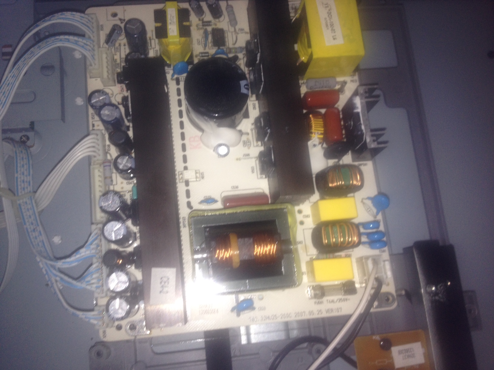

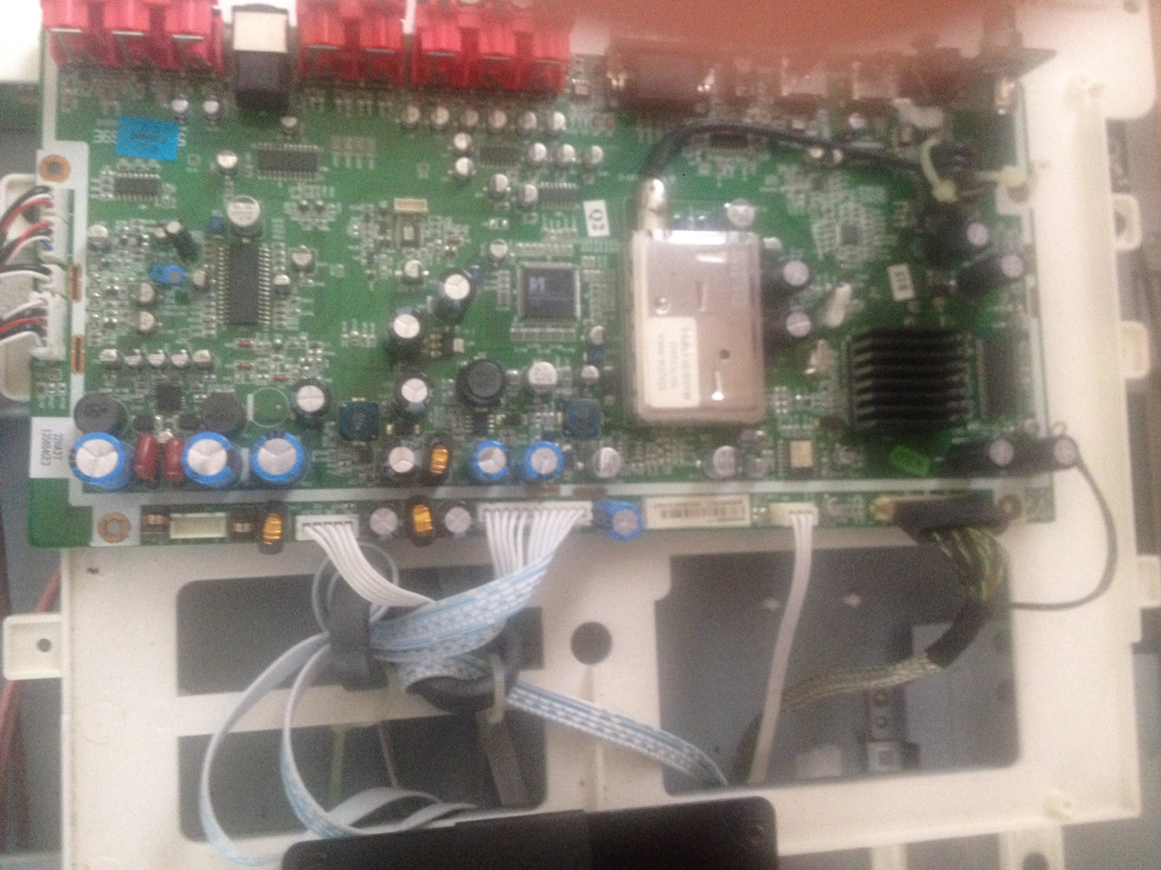

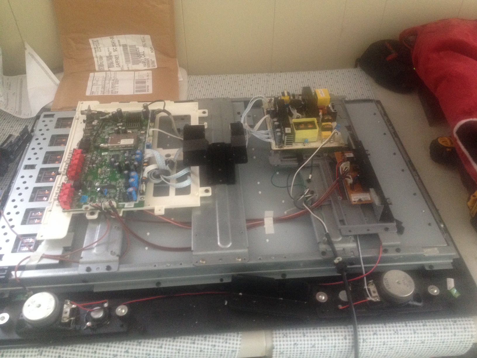

          Here are some pictures. thanks for any help!!!
          • CapLeaker
            Leaking Member
            • Dec 2014
            • 8325
            Looks like your main board is sending PSon, but the PSU isn't turning on.
                Here is a service manual for it.
                Disconnect everything from the PSU and force it on by jumping STBY voltage to PSon with a 1k resistor. Plug it in and check all the output rails.
                • CapLeaker
                  Leaking Member
                  • Dec 2014
                  • 8325
                  Be careful in the primary section on the power supply. When the PSU is working correctly you got around 400V DC on the main filter cap.
