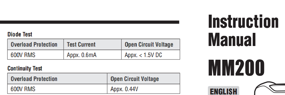

    Don't know if this is ok to post here. What type of multimeter are you using to test igbt and mosfet? I am using a klein mm200 but I do not think it is able to do what I need. It only has an average .6 mv for testing in diode mode.

    The Klein MM200 manual says diode test mode outputs a test current of 0.6mA and approximately 1.5V DC or less (probably depending on the battery condition).
    If you are looking for a shorted igbt or mosfet, a reading of 0.00 or close to 0.00 tells you it is shorted.
    What is your Klein not doing? Or put another way, what problems are you having? Be specific.

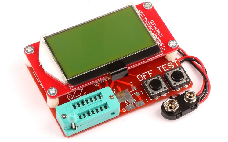

      For transistors, inducers, caps, mosfetshttps://www.amazon.com/gp/aw/d/B00NKY3M1W/ref=mp_s_a_1_1?ie=UTF8&qid=1469493576&sr=8-1&pi=SL75_QL70&keywords=transistor+tester
      Dont laugh. It works great.

        Isn't that tool is only good if the components are removed from the pcb? How would you use this tool to test ibgts and mosfets when they are on the pcb in circuit?
        Any multimeter, even the cheapest one that you get free at Harbor Freight, can test for a simple short.
          I want one tester that will do resistors, capacitors and igbt. I can not test if the mosfet or igbt will open and close. I could perform direct short tests but nothing else. I just bought a radio shack 2200087 it worked great on the igbt and mosfet but it only has a uf rating of 60. The Klein atleast went to 250 uf.
            According to the manual, the 2200087 has
            DIODE MODE
            Open Circuit Voltage ................. < 2.8Vdc
            Test Current ........................ 1 mA Typical
            So it is almost double the open circuit voltage and almost double the test current compared to the Klein.

              True. This is a good tool to test your replacement parts before replacing and confirming parts with issues. It is good for testing unknown parts too.... just another tool in the tool box. I have 3 other multimeters (one is the free harbor freight) and 2 oscilloscopes.
