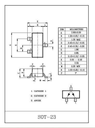

      So in my case, mosfets looks alright, checked resistors, looks fine, checked surface mounted diodes, one looks doggy.
      Can i replace the diodes with any similar diode, for example not surface mounted?

        Are these two surface mounted diodes: DX803, DX804 so important?
        Is this the reason why power supply clicks on and off?

              Diodes: KDS181 , according to schematics

                Is it showing shorted across it diodes will almost neevr fail open ?

                  Yes the diodes are important and are part of the repair kit.

                    First one:
                    open in one direction, swap probes and some digits appears on the multimeter for a second and then no readings
                    Second one:
                    open in one direction, swap probes and 1.096

                      Sorry, KDS184

                        Is your meter set to diode check or ohms?
                        Each diode should show something like 0.2 to 0.7 on the meter when set to diode mode and OL when leads reversed. If the diodes are the same type then the readings should match each other.
                          Readings doesn't mach,so I thing at least one must be faulty.

                              KDS181 is a double diode package which you can check with your meter set to diode mode.
