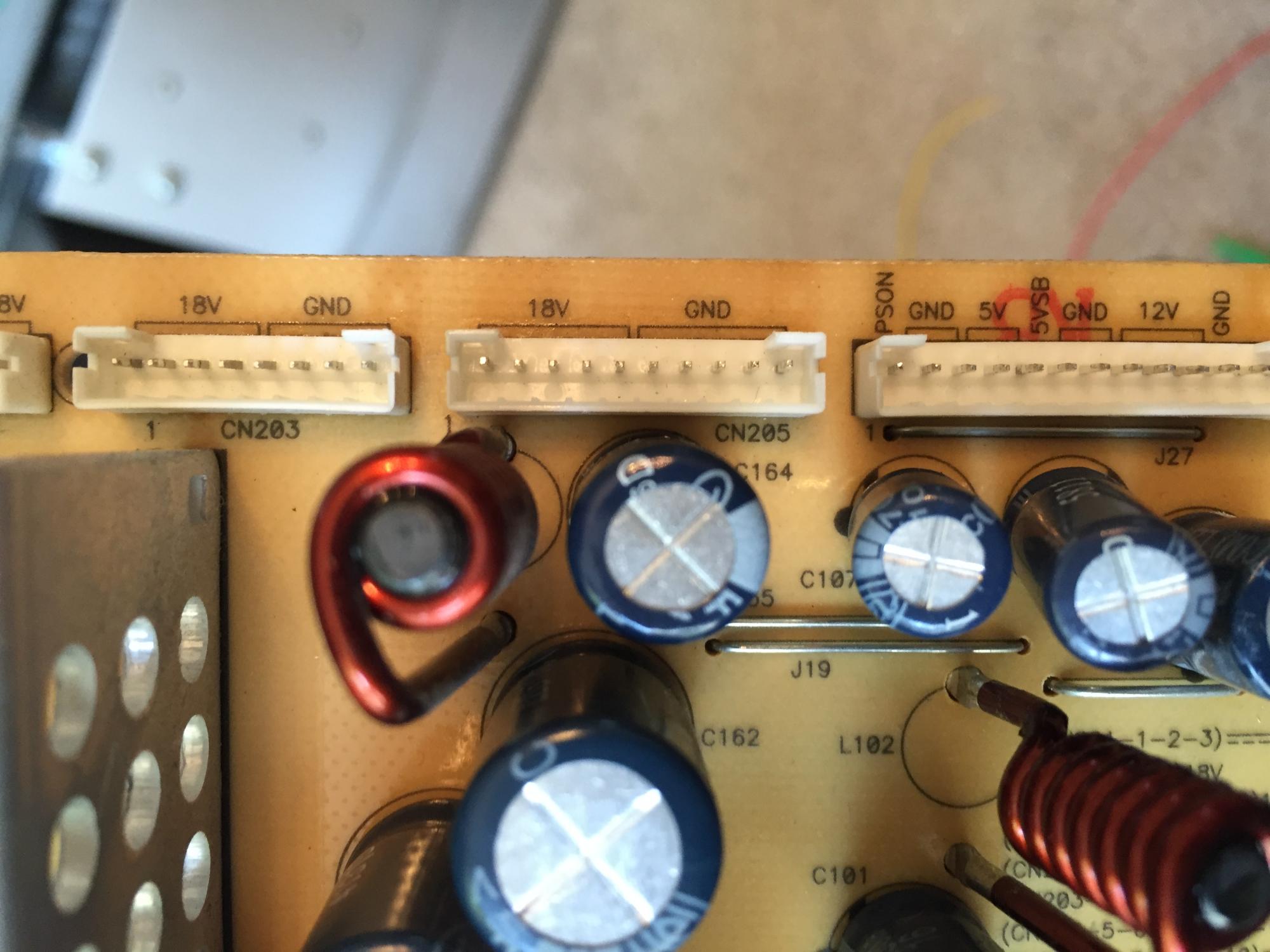

    My brother asked me to take a look at this tv/monitor.
    I measured the voltages on the psu, for the pins labeled 12v, I get 11.18v.
    The ones labeled 18v, I get 16.8v.
    Pson measures 0.47v.
    He had a problem with it described in the forum with this set, the cold solder joints on the 2 rectangular capacitors. So, I resoldered them and that didn't help. So I replaced them but it didn't help.
    The replacement are 0.22uf 400v.
    The old ones are 0.22uf 630v. I couldn't see the rating till I took them off and I had already ordered the replacements.
    Could that be the problem?

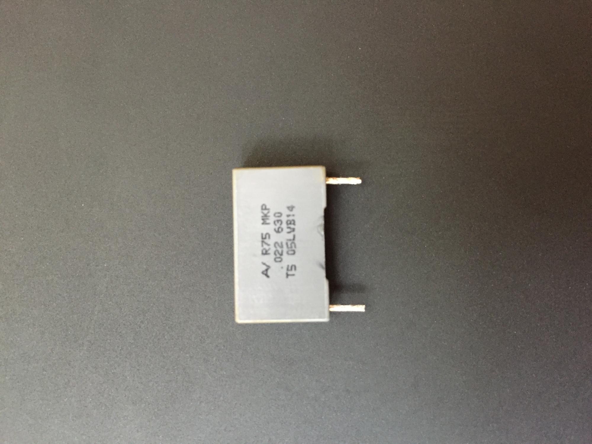

        Here is a picture of the old cap. There are 2.

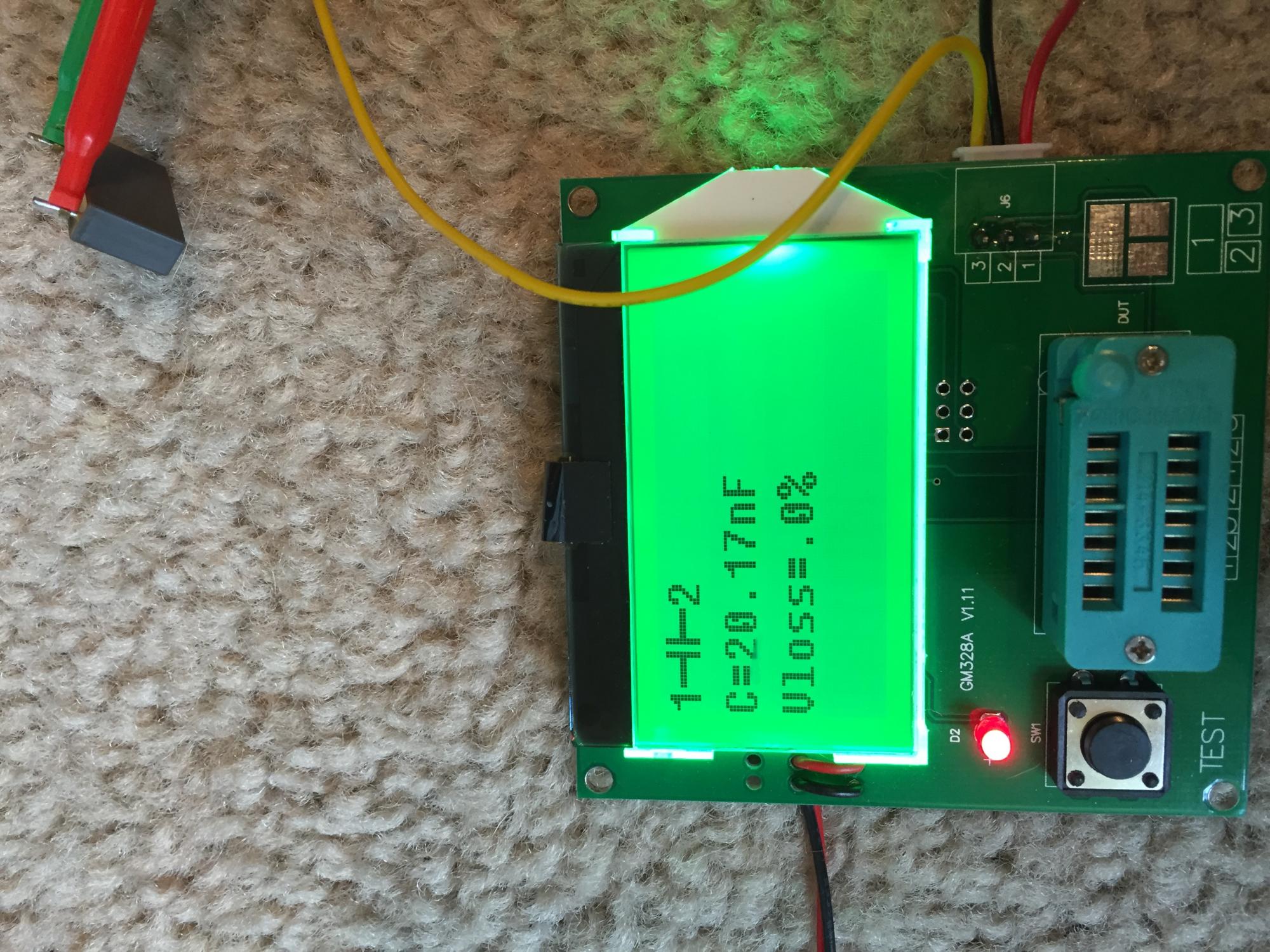

          And here is what comes up when I measure them.
          Doesn't the measurement indicate they are ok?
          I can put the old ones back in.

                Measurement says 20.17 nanofarad? , thats 0.02uf
                1uf is 1000nf.
                Just looking at those measurements AND the other thread i would say the capacitor is bad.

                  Sorry. As the picture of the cap show, it's 0.022.
                  I ordered 0.22uf because that is what the person in the other thread said he used but looking at the one I took off it says .002 630.
                  So I've got completely wron ones.
                  So the reading on the meter matches the picture.

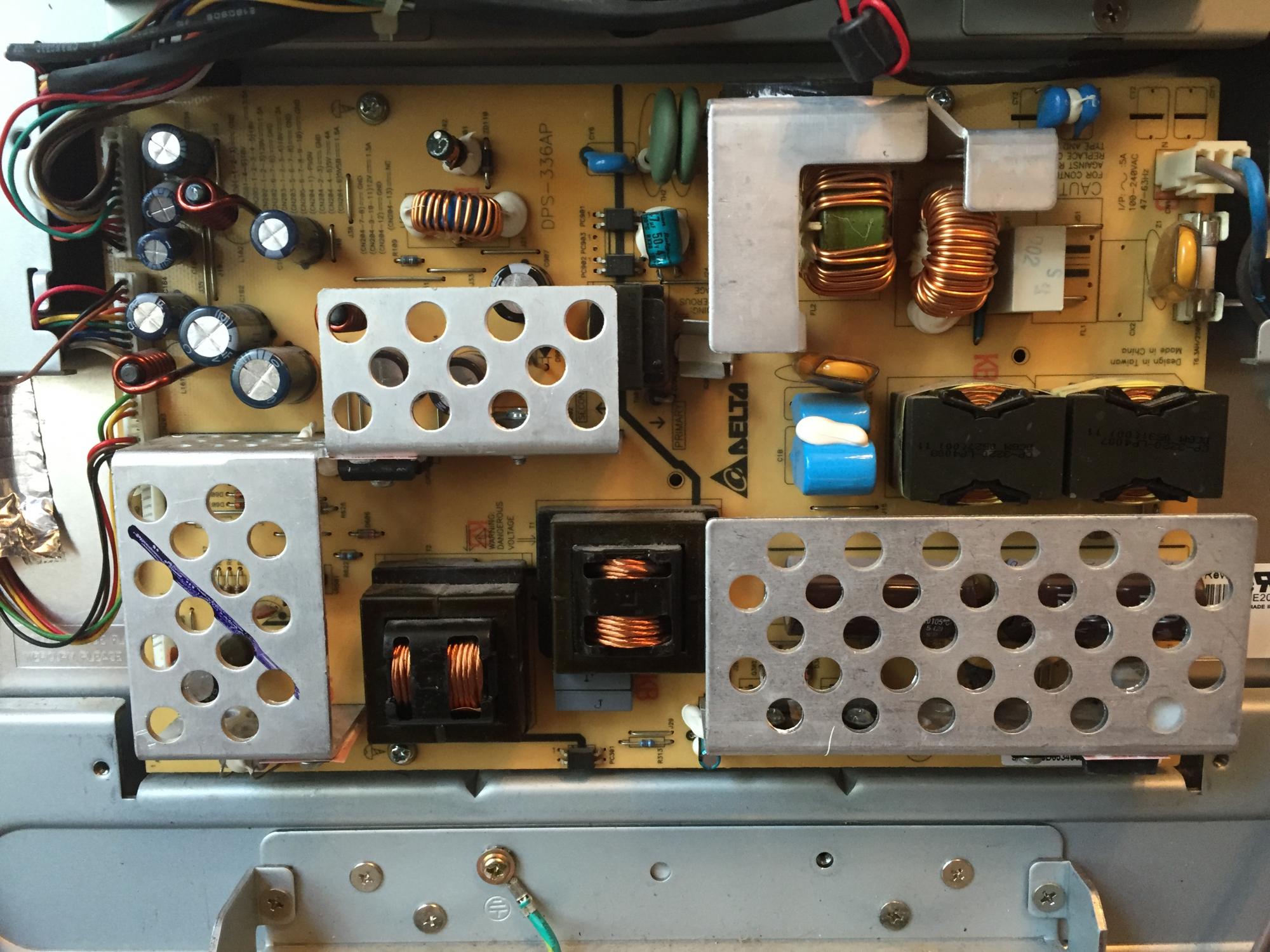

                              Looking at the picture of the power supply there are quite a few capacitors under heatsinks which the Forum often says tend to dry up. I would suggest that they need checking.
                              • Malachi
                                • Dec 2015
                                • 1077
                                • Usa
                                Re: Westinghouse LVM-37w1 won't turn on.
                                They look ok visually and measuring in circuit. If I have to remove the heatsinks to take them out of circuit or replace them, that would involve a lot of other components to remove.
                                I can get a confirmed wiring board for $27 including shipping. Not worth taking it apart and ordering all the caps on the board.
