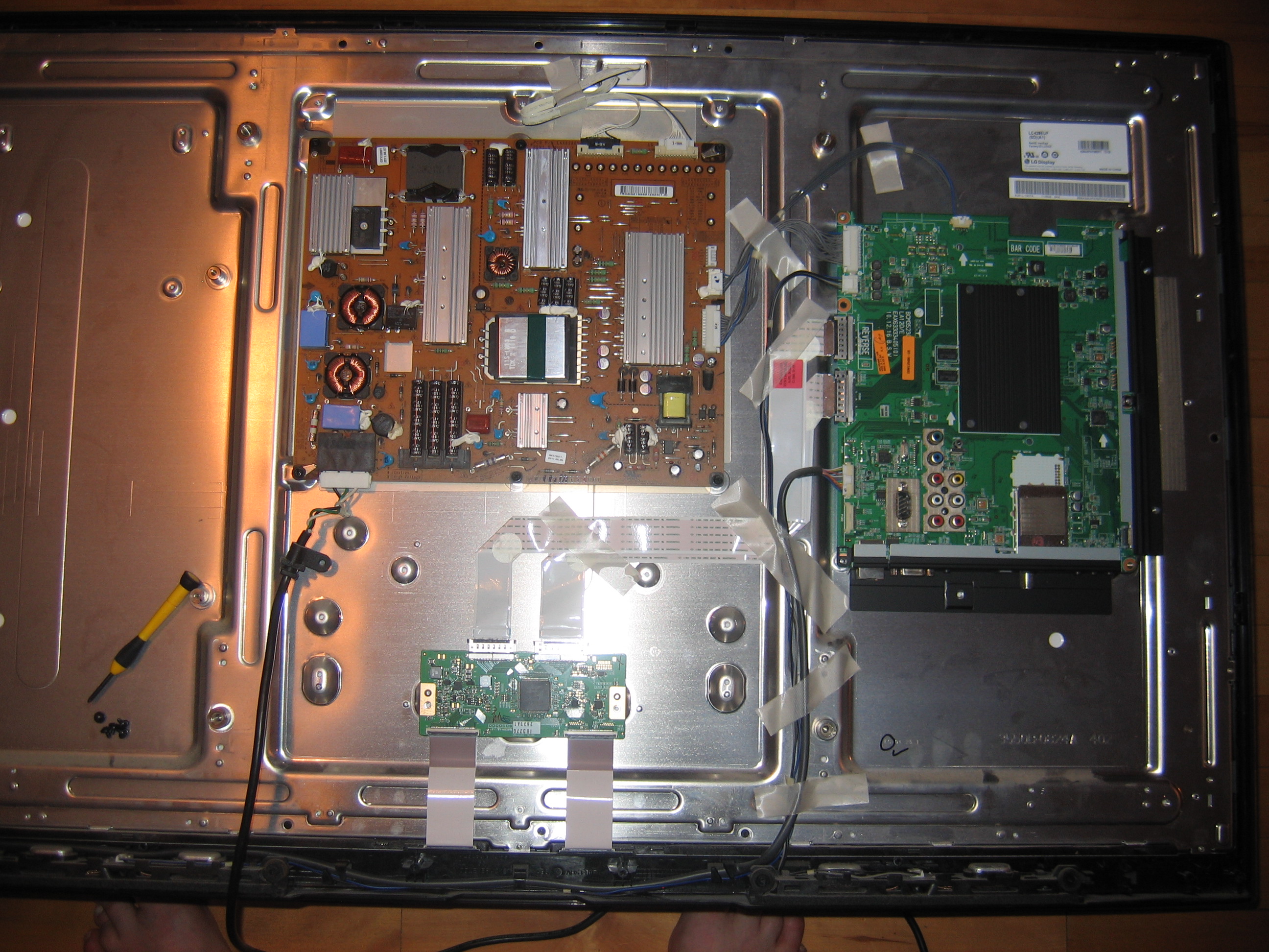

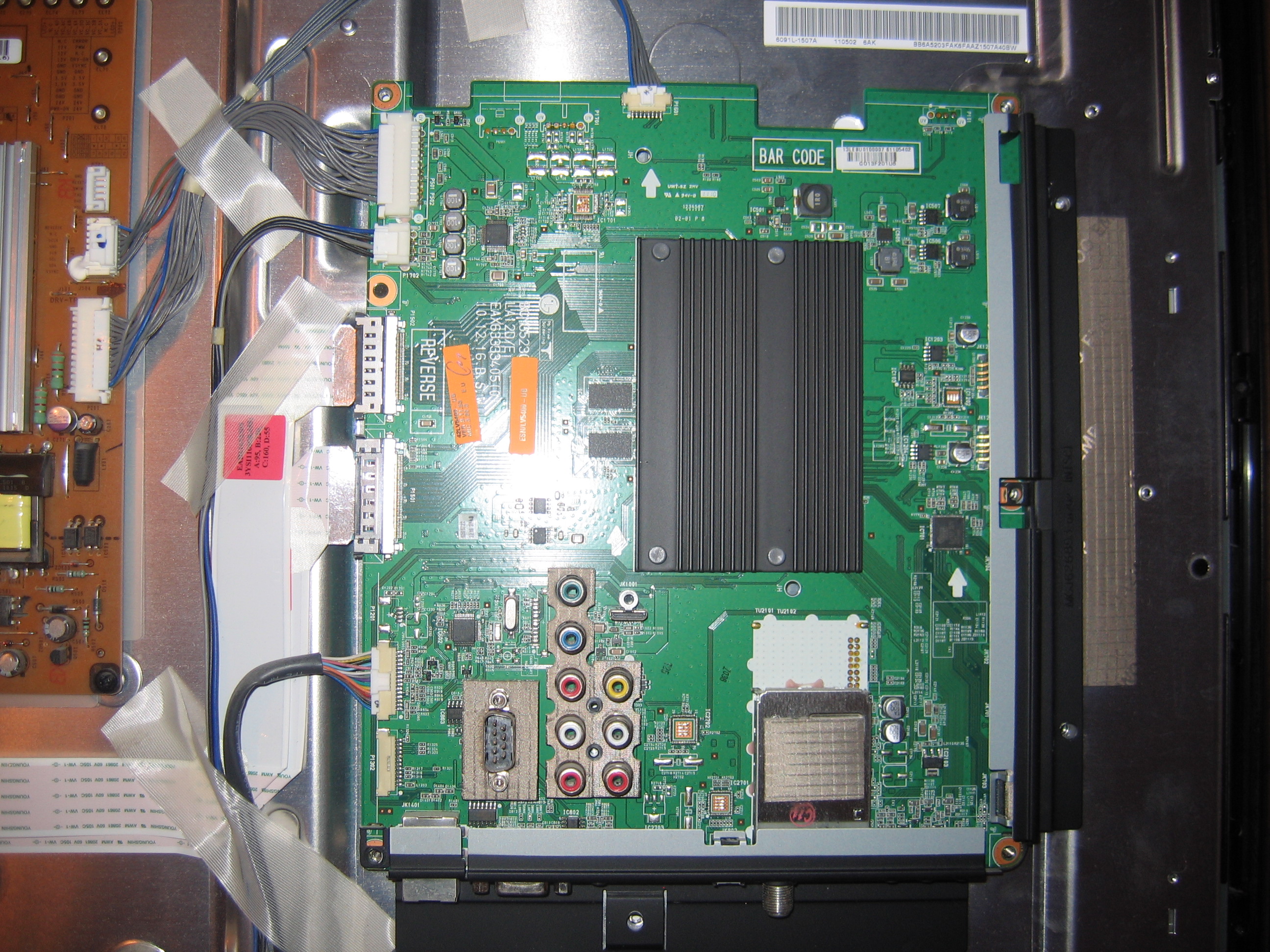

    Good evening,
    I have LG 42LV5400-UB that suddenly stopped working.

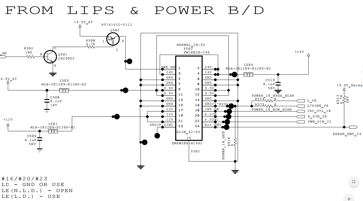

    It successfully powers on with the touch panel or remote (power LED is white) but there is no video nor sound.
    When it powers on I hear a click of relay but no backlight seen from the rear panel in the dark.

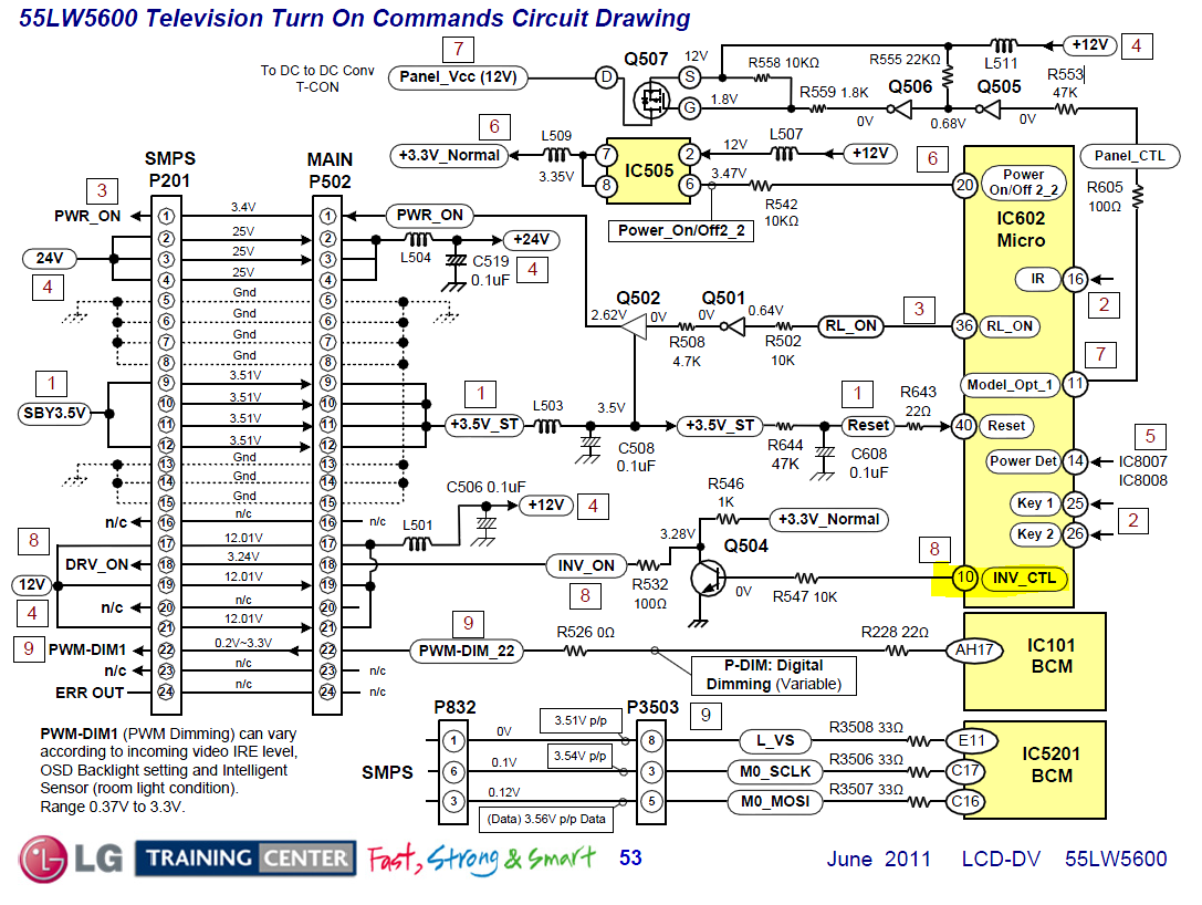

    Measured voltage on the connector P501/502 between the main board and PSU, all seems good.
    PWR_ON is 3.3V
    All other voltages 3.5V, 12V, 24V are OK as indicated on the attached picture.
    INV_ON (Pin 18) is 0.6V
    If I understand properly the latter corresponds to High for this model. (see the attached picture)
    Right? So it is Ok.
    Voltage on two big capacitors in the top part of PSU is 79V.

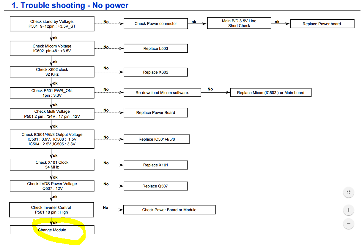

    I followed the service manual troubleshooting process (except frequencies measurement) until "Change module".
    Does it mean the LED panel is dead or still something else?
    Mainboard: EAX63333405
    Power board: EAX62865401

    'INV_ON (Pin 18) is 0.6V' It should be >2~2.5V for on, <1V = OFF.
    How about the ERROR signal?

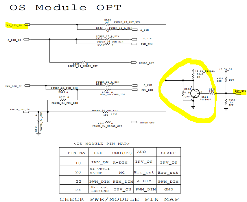

      Also INV_CTL on the base of Q504 is 3.3V
        Re: LG 42LV5400 powers on, no video, no sound
        Originally posted by Coder45
        Thank you for the prompt response.
        Err OUT (Pin 24) is 0 V.
        That is why the Invr is in low state, that transistor should be turned off by the processor for the Collector Voltage to go high to turn on the backligts circuit.
        Right now that pin 18 invr is not changing states when the power swithc is toggled on and off, right? As shown on the flow chart, pin 18 must go high when TV is turned on.
          When TV is powered off, the pin 18 shows 0.3V, when powered on it goes lower to 0.06V (sorry, I missed a zero in the first message).
          If I send +3V via resistor on the pin 18, I see backlight working.
          The signal INV_CTL is managed by the pin 10 of the processor IC602. No idea why it is keeping it high.
          I attached the TV manual if it may help.

              Strangely, the service manual says that if INV_CTL is not On, then there may be an issue with the power board or "module" (LED panel?).
              Can a defective LED panel cause this?

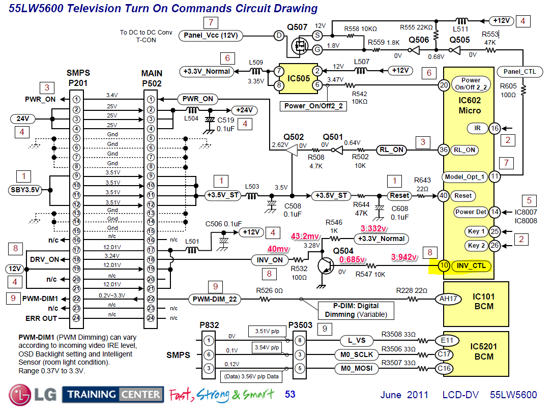

                            Update.
                            Tried to send INV_ON on the pin 18 while the connector P501 is attached to main board. The backlight is there but still no picture.
                            What else could I try to identify the faulty component?
                            I am wondering in which conditions IC602 does not enable INV_ON and keeps INV_CTL high.
                            May it be a defective LCD that is detected by the processor?
                            According to the attached picture and my measurements, the startup sequence is followed pretty well until the step 8 (INV_CTL).
                            It looks like the mainboard replacement is quite hard to find.
                            Called LG and local repair centers, no one is selling mainboards.

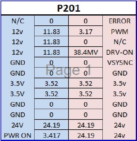

                                  Here are the measurements from P201 on the power supply. It looks allot like the original posters readings. I don't think the power is getting to the main board to turn the power supply on. I think it could possibly be ic602 or q504 on the main board or somewhere along the way. The hunt is on.

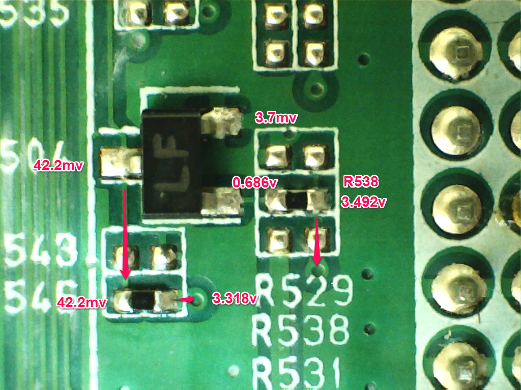

                                      Using the startup document posted on the post above, I have been using it to check voltages. I am not getting any voltage on the INV_ON / DRV_ON connection. I'm sure voltage on this line is needed to tell the power supply to turn the set on. I am posting an image of the document with the voltage readings i am getting. Its looking to me like it might be R546, R532, R547, and or Q504. Let me know what you think.
                                      • drkthundr
                                        • Feb 2016
                                        • 45

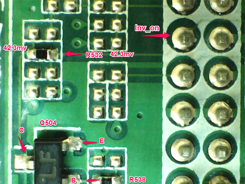

                                        Here are more measurements of the area. Measurements are in the pictures. What do you think?
