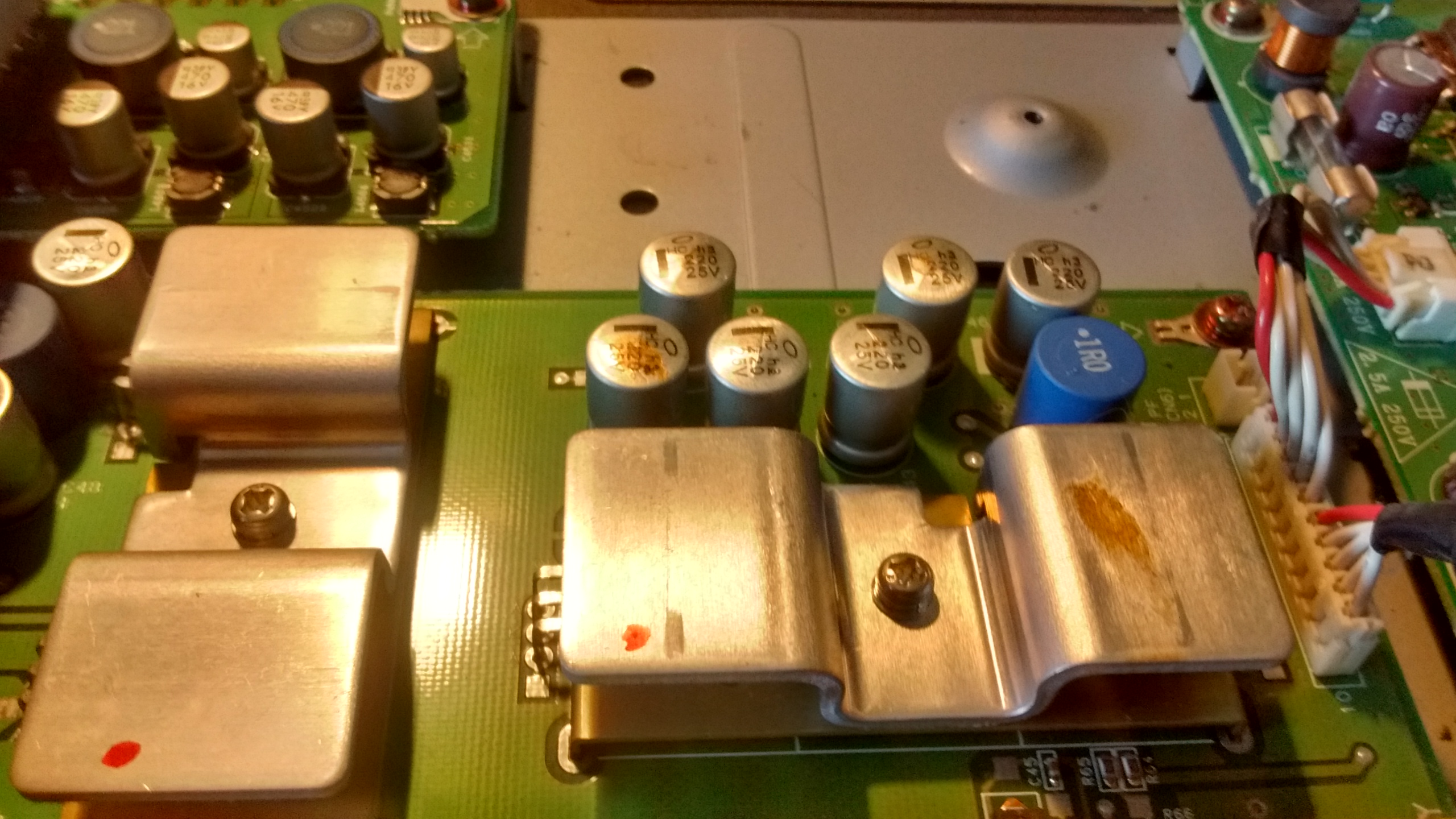

    Issue: Sharp LC-30HV4U takes a few tries before it comes on.
    Solution: Six 220uF 25V out of nine caps on the power board were blown. Replaced all nine with 220uF 25V caps.
    Man, this TV is a beauty. This was one of the first flat screen TVs. Here's a link with more info: http://www.cnet.com/products/sharp-lc-30hv4u/#!
    The inputs aren't on the TV. They are in a VCR sized boxed that you plug into the TV. Beautiful picture. I shudder to think how much this thing was brand new.
    Pics below show the back cover off and a closeup of the affected area.

    Good work. Looks like a decent tv.
    Are you gonna keep it for yourself? If not , i would also replace the other small caps on the second picture. ( Caps on the left next to the heatsink ).
    Just to be sure!

      Bloody hell fan cooled Lcd lol seen it all now ! Nice set also do as More says and replace the other caps like that help it last longer

        Update: Was working for a few days but the issue has returned. I'm looking into the power board now. I will post a new thread once I'm ready with testing info and pics.
