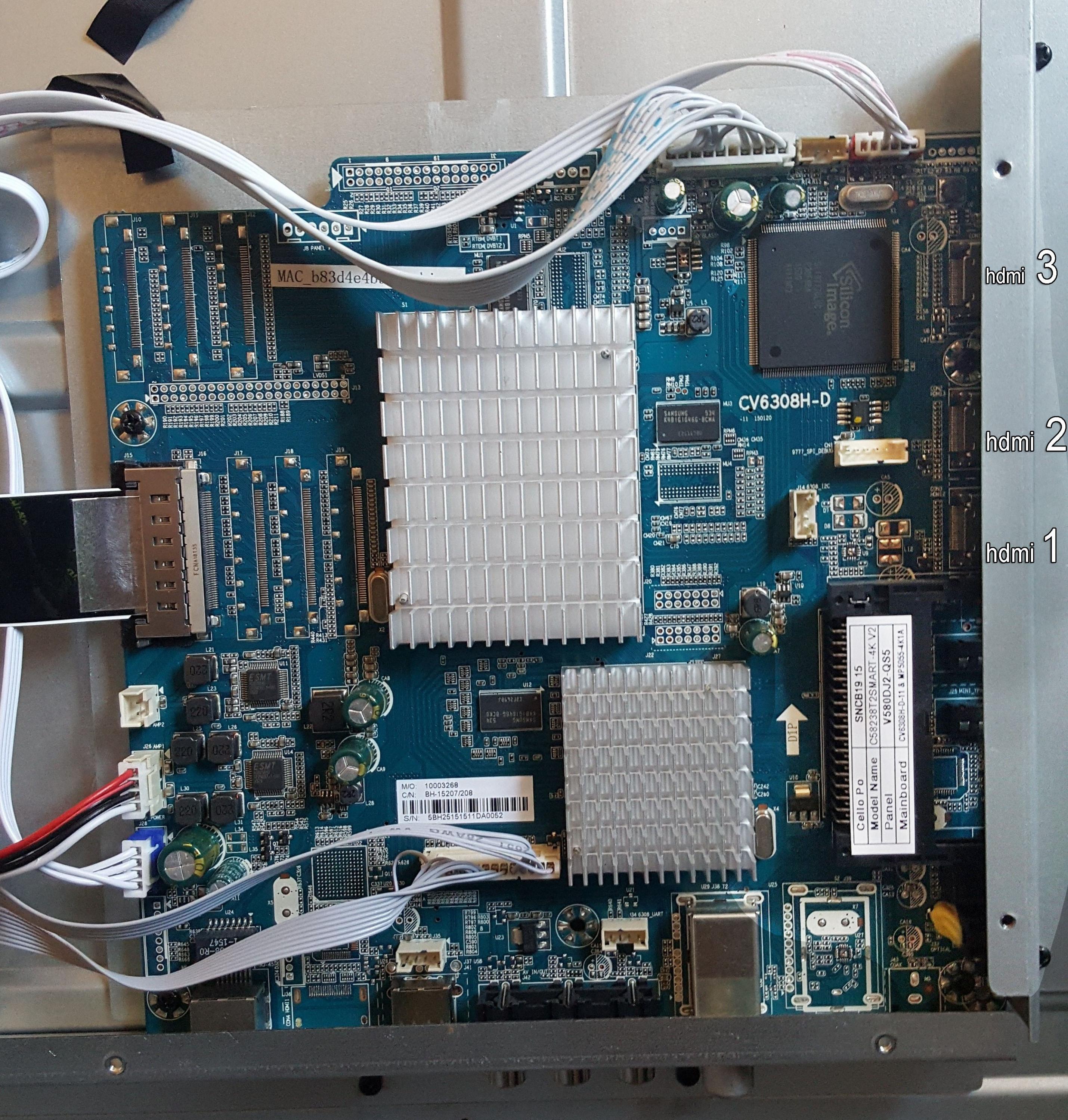

          Well I finally got round to opening up. Enclosed mainboard picture. Any help where to check would be gratefully appreciated? tia.

            Re: HDMI connection. no signal unless TV rebooted!
            from yours Photo the top right side include image IC all had Oxide. you need to clean all HDMI pin all 3 and the area round with alcohol 95% or above.

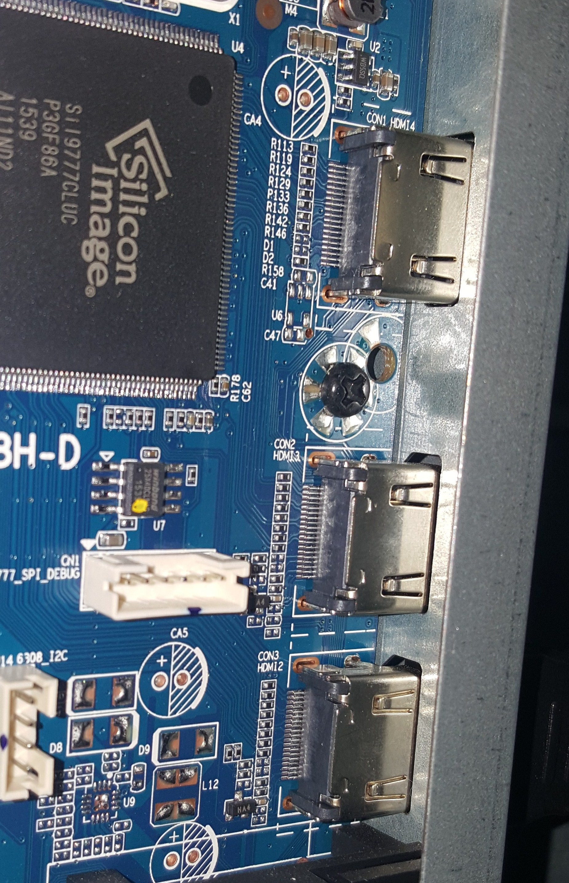

              Thanks, here is a better picture. I think maybe it was poor quality. I cleaned anyway but still same problem.. Which is the ic I should be looking at?
                you have U4 which get switching signal from main processor IC ( under the big heat sink) you wrote it switched HDMI signal if the TV reboot. then consider on Firmware first, and second reflow / resolder U4 , check the three caps at yours first photo any if the + of it go to U4 replace it.
