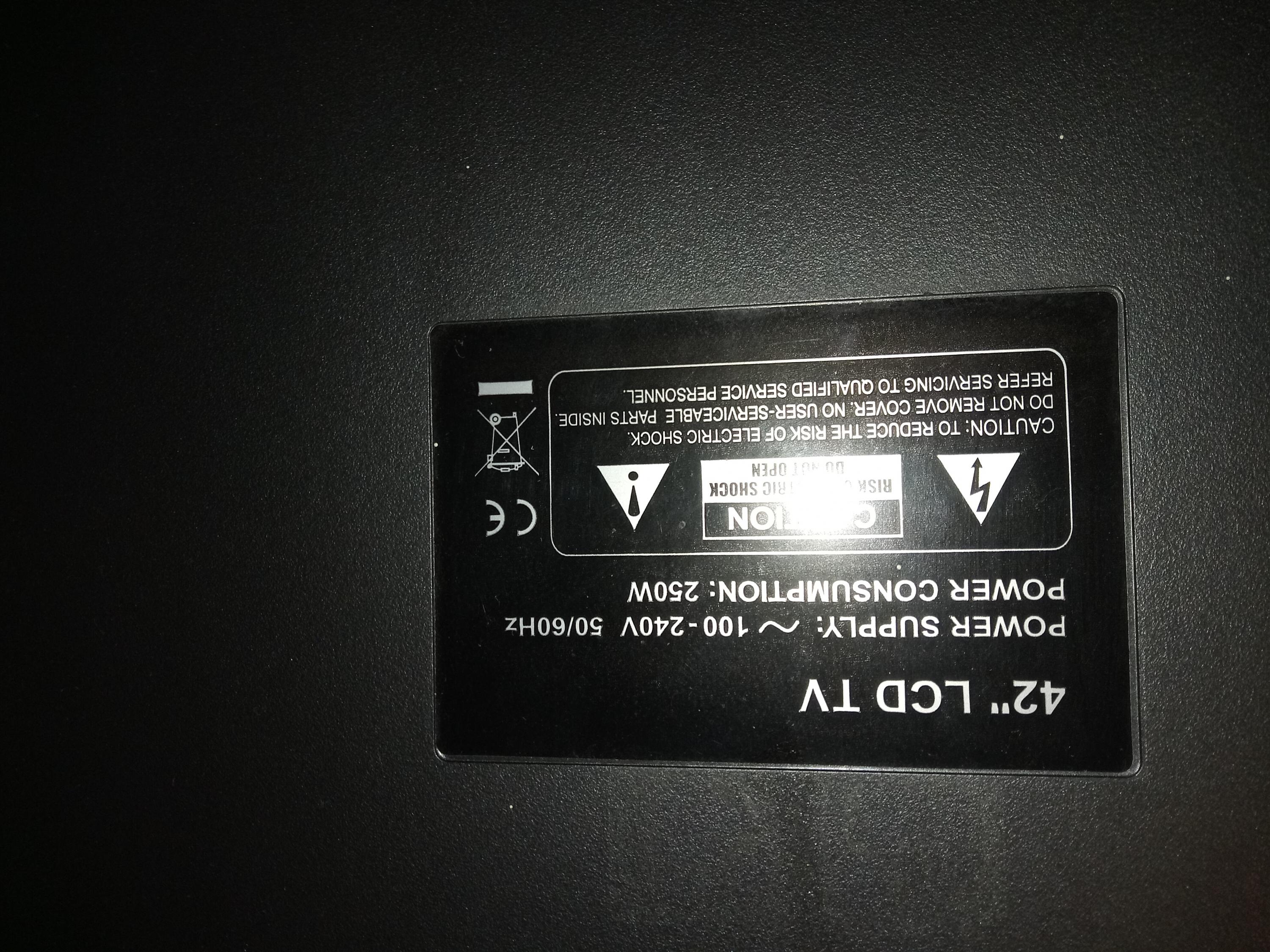

    theres no precise model number on the rear cover boards labelled as below

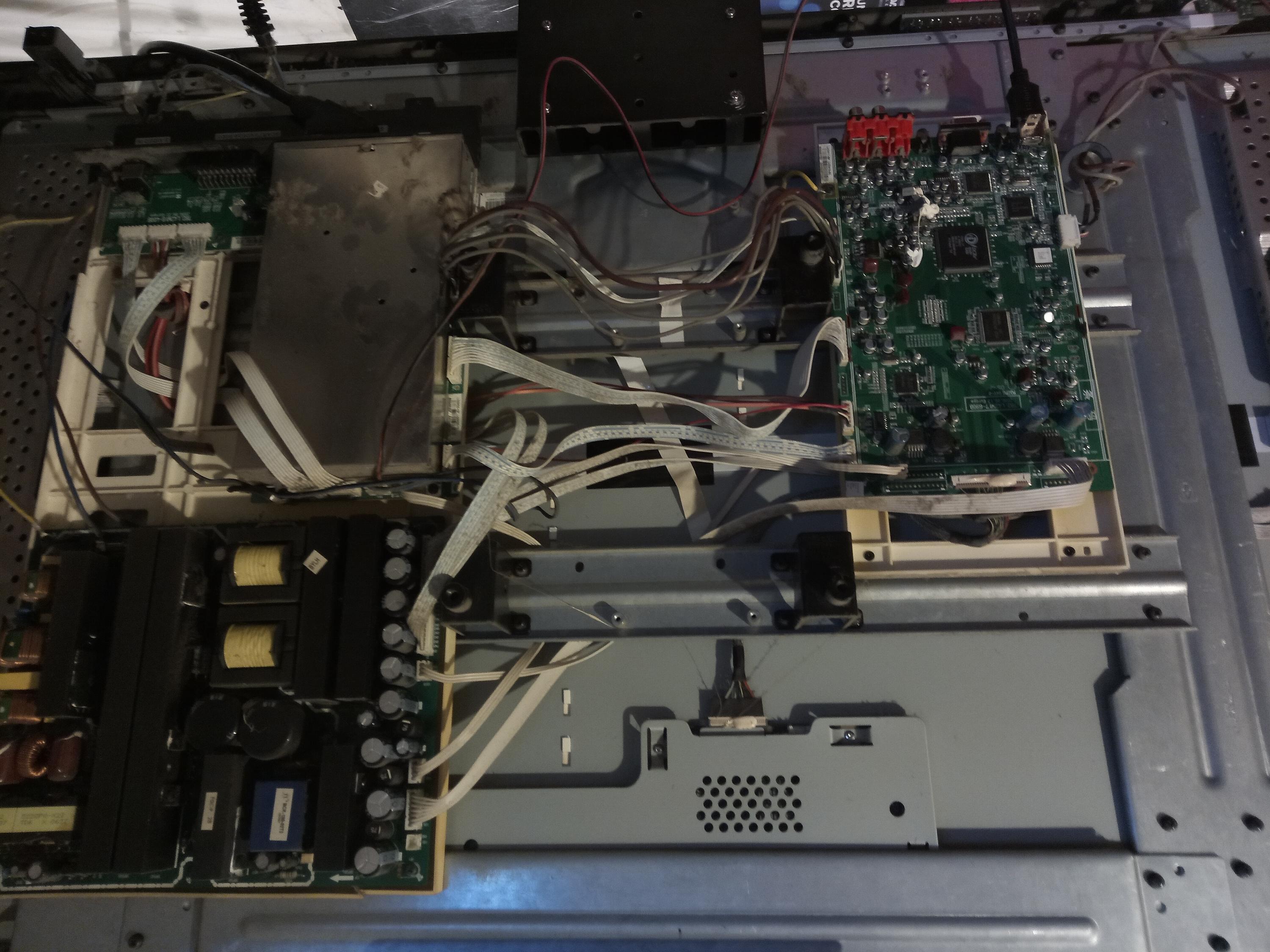

    Hi just been given this lcd tv,
    ive not come across this make before
    there is no o/p from hdmi .its fine with scart .
    good pic for its age

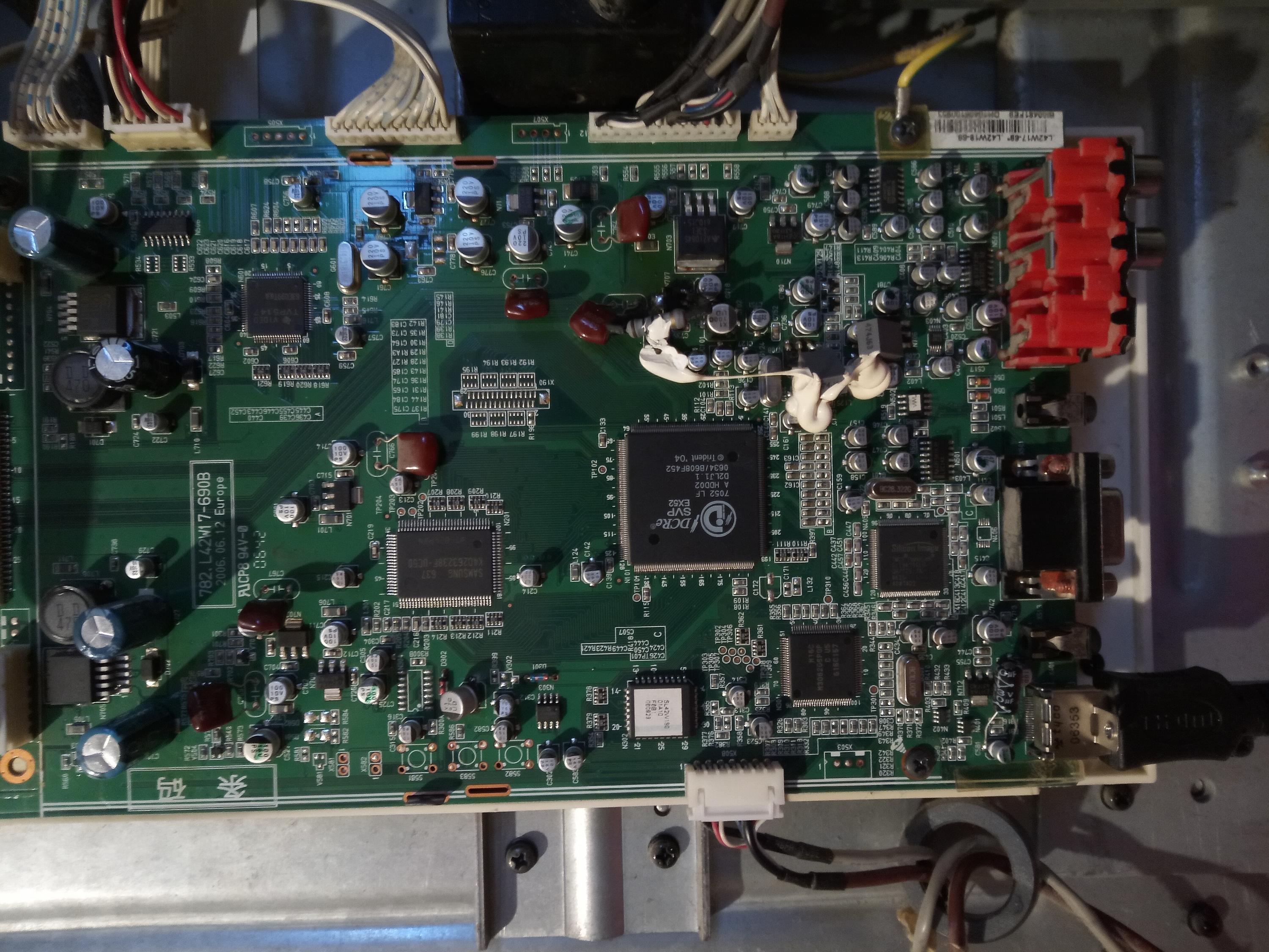

    the main board is 782 L42W17-690B
    cant find much info on google

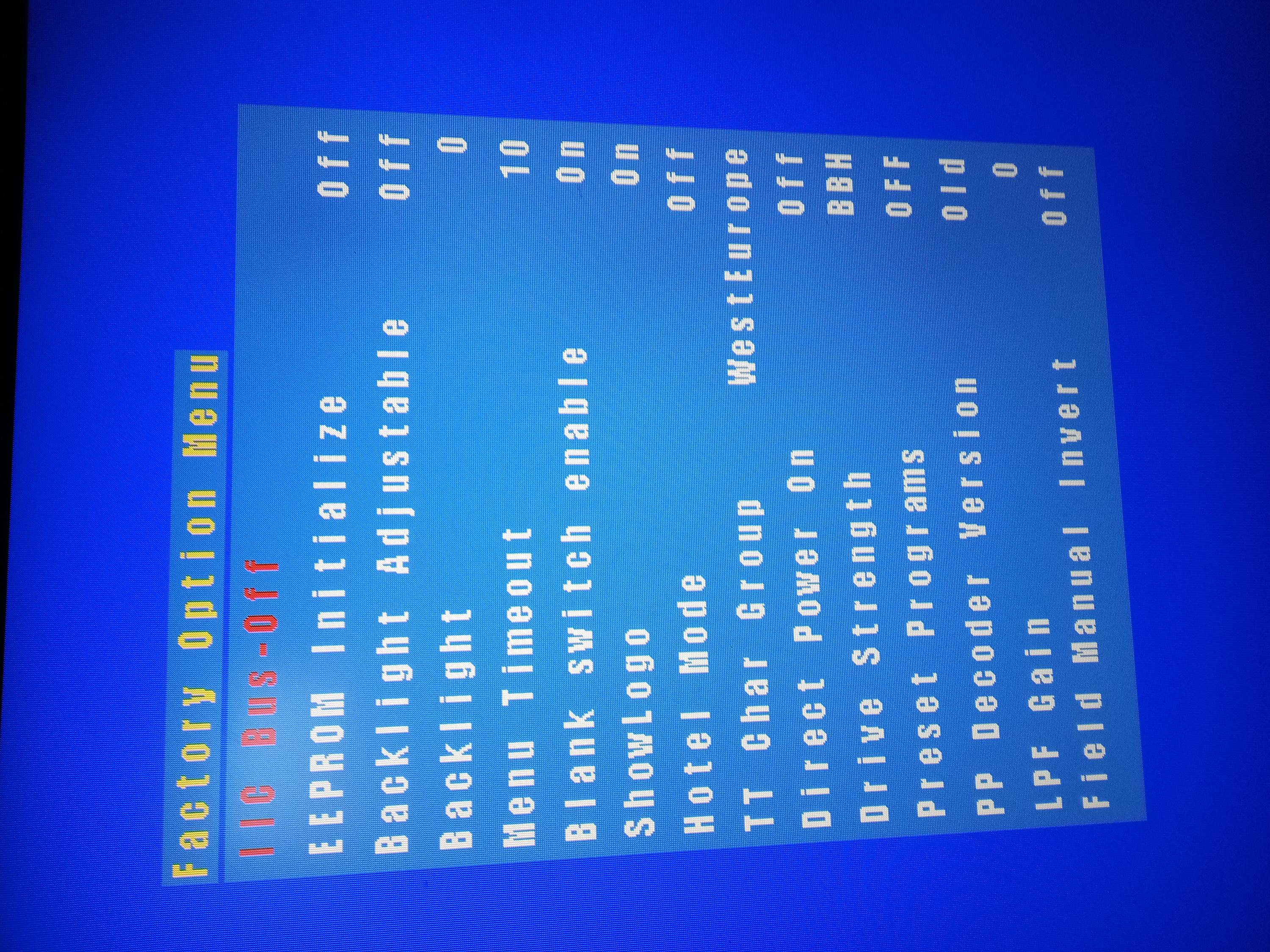

    to enter service menu .bring up a/v menu ,then 2580
    but cant move to next page ,for options
    (i was hoping ther may be an option to switch on/off hdmi/dvi)
    the reason for this , is when hdmi is selected it says: no dvi signal
    not: no hdmi signal
    i checked esr values of caps on main board and found a few suspect
    (and replaced them )
    but fault persists
    i will post some pics as soon as i can get help to turn it over as its very heavy
    to move

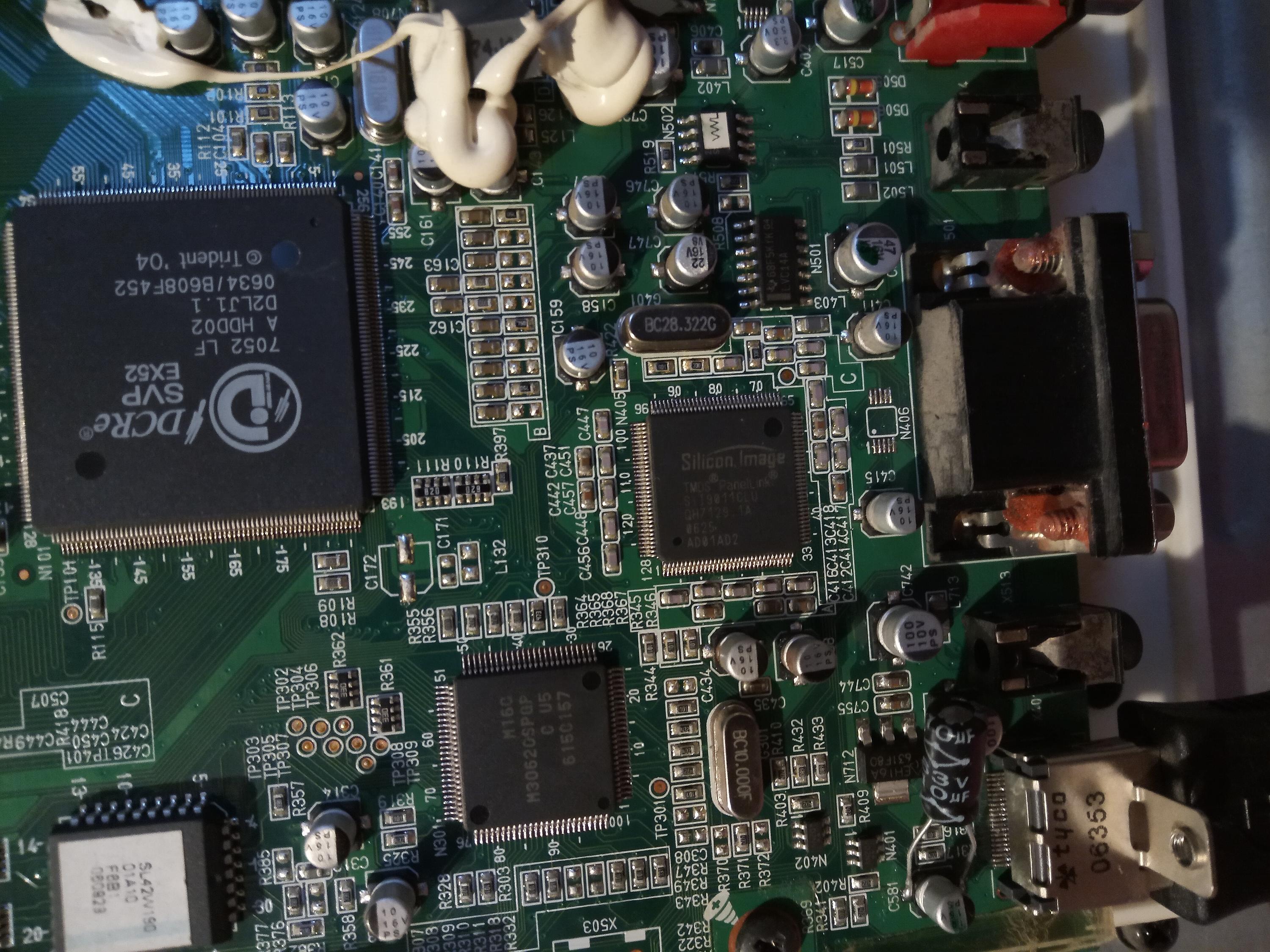

    heres some pics
      Re: hanwa 42 lcd tv no hdmi signal output
      HDMI SWitch iC

        does anyone have cct for main board?
        the switching ic is ref number:NA05 OR N405
        cant make out the number on the ic ,it looks like :ST 19011 CLU
        but searching for this gives no results.
        (one of the caps above hdmi socket
        on esr was borderline
        so i tacked a cap across it just to test)
          looks like it could be SIL 9011CLU
            its a HARWA not hanwa ,must be getting old!
            heres a cct using same main board as my 42 "
            still think its possible to change setting from DVI to HDMI
            if i could only move to next page in s menu

                    this cct is nearer to actual cct .certain electrolytics vary but page 44 has cct of hdmi switch ic N405
                      Re: harwa 42 lcd tv no hdmi signal output
                      progress ,of sorts!
                      the supply 3.3v to ic n405 was down to 3.0v
                      and the reg was slightly warmer than normal
                      after removing components l403
                      i found a 40 ohm resistance to deck on pins 49 ,53.57 61 this proved ic n405 was faulty
                      removed with s/station now s/c gone problem is,
                      its obsolete but im ordering one from china
                      and keeping fingers crossed that it is a good one
                      its interesting that the tv works fine without this ic (on scart of course)i will update when it arrives .i will keep a look out for a board but they are like rocking horse droppings!
