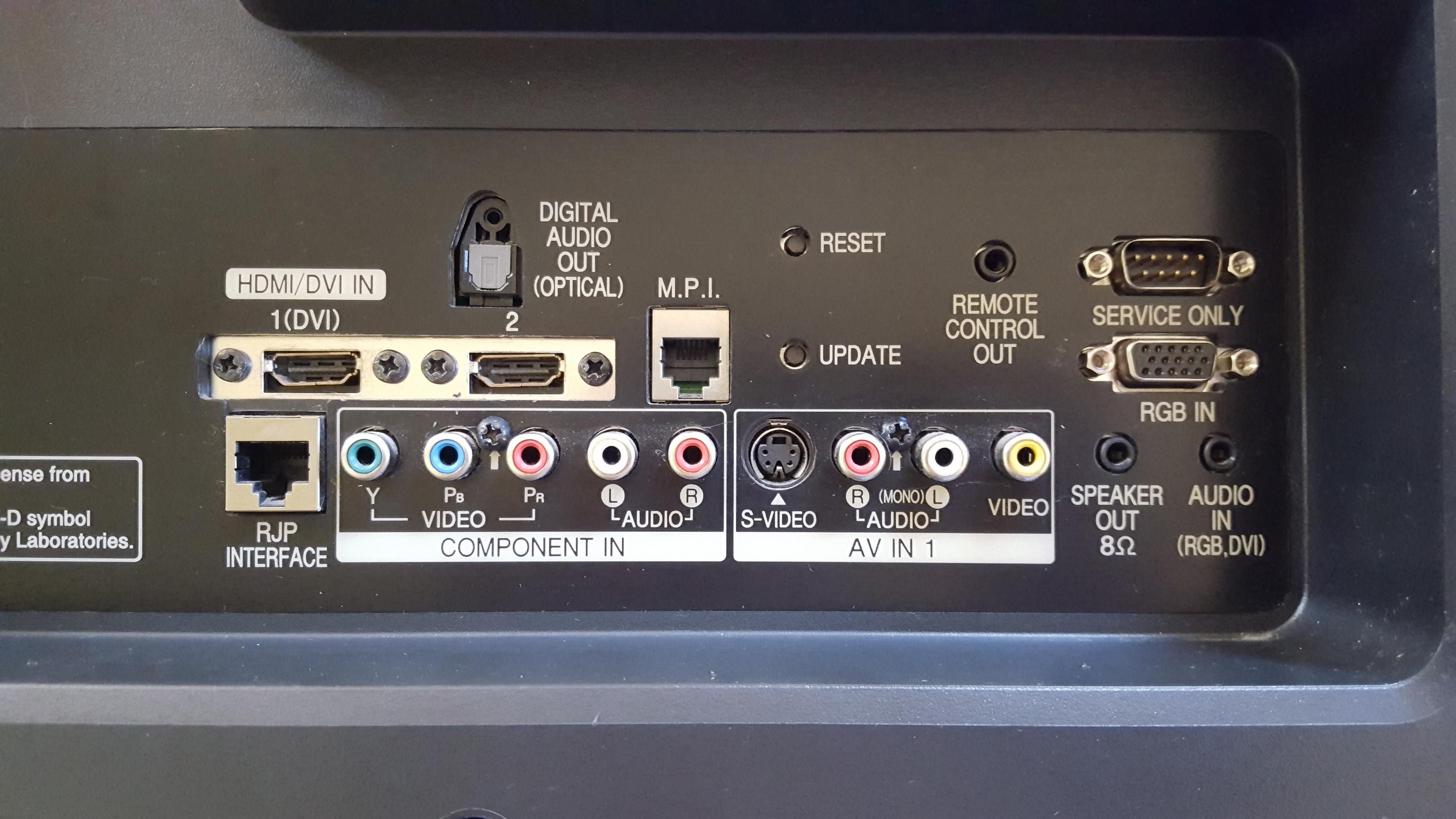

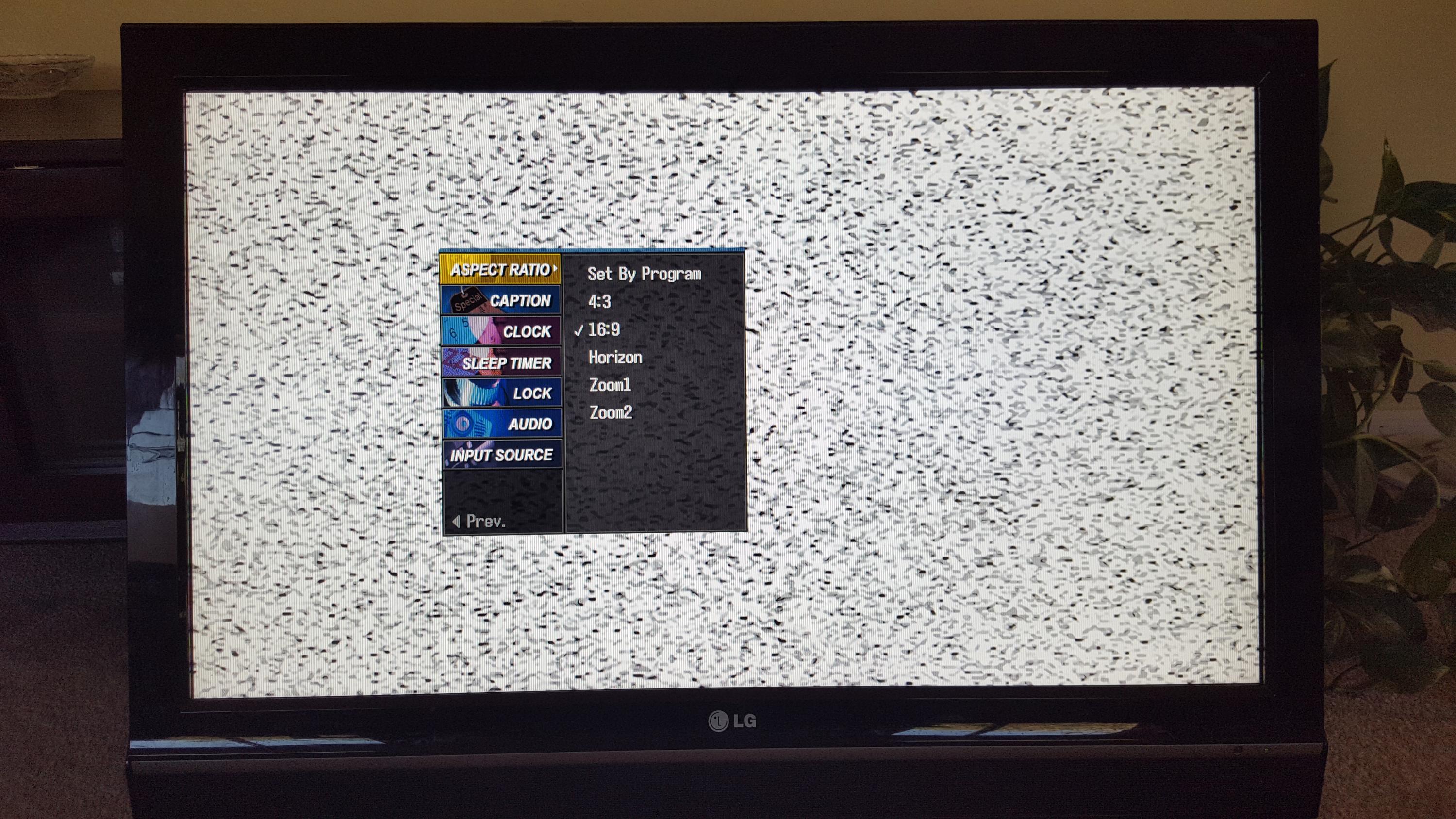

    I have picked up and fixed LG 37LC5DC-UA. While it works fine, I don't have access to re-scan channels or change picture settings. I do have the remote.
    I have tried various online recommendations, but none worked. Press and hold menu then 1105, press and hold menu or OK on both TV and remote. press the reset button on the back of the TV, while the TV is on, while off, and white turning on. None helped.
    Any other thoughts on what else I can do?

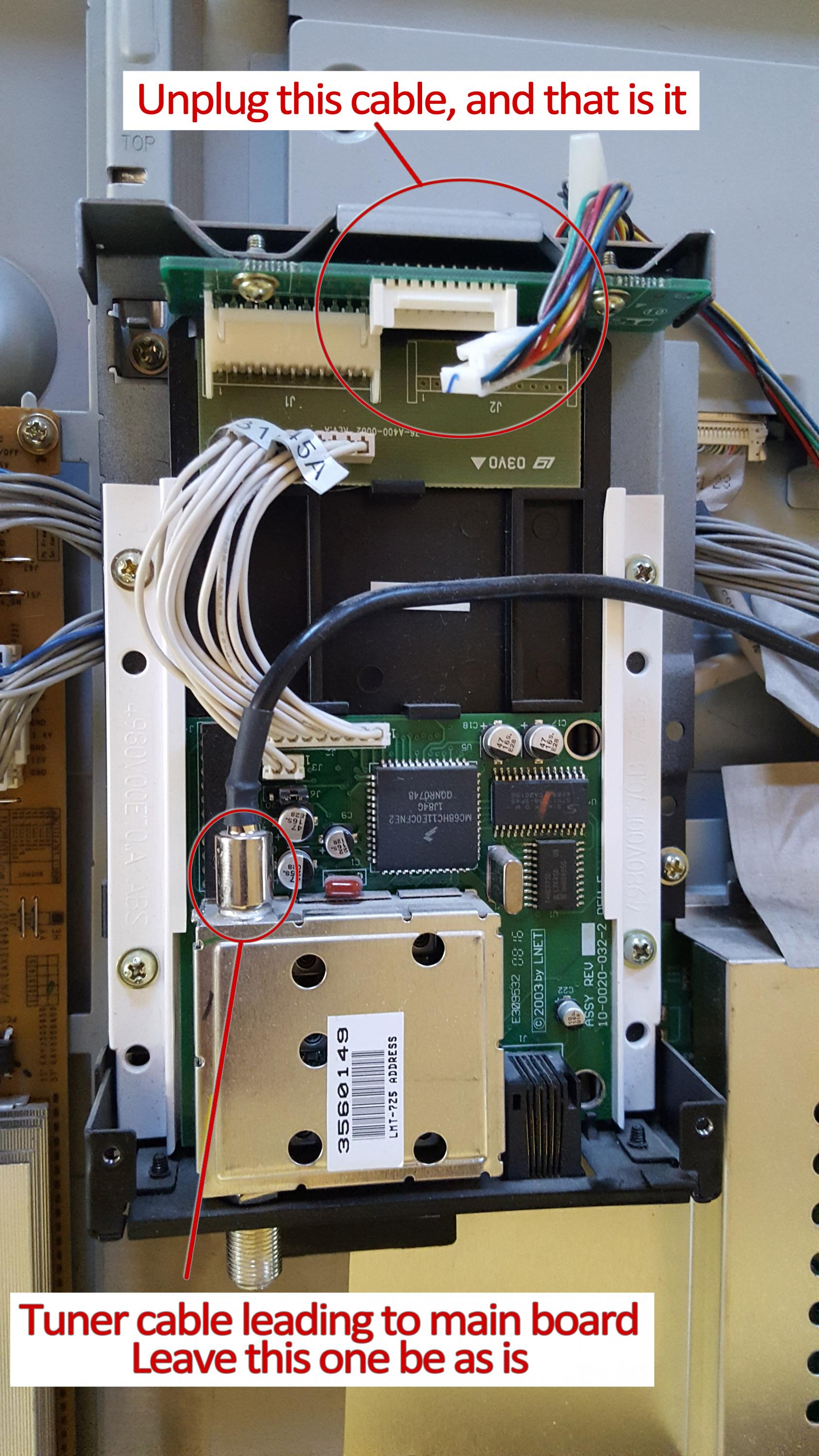

      I have tried that already, and many other combinations of buttons and numbers.
      However, I have figured it out. I have taken the TV apart again. The tuner is separated from the main board. There is a coax cable and set of other cables connected between the main board and the tuner board. I have disconnected the set of cables from the tuner board, and the TV stopped behaving as Hotel TV. See attached picture

        Re: Can't get out of hotel room mode with LG 37LC5DC-UA
        Its probably be uase its set to switch the Tv to hotel mode if thats connected-hotel mode device only.
