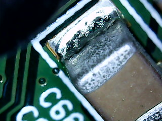

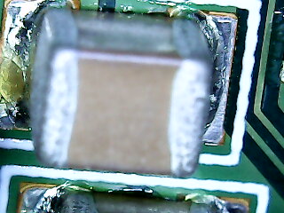

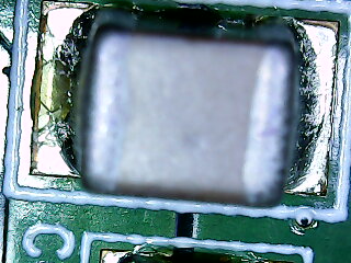

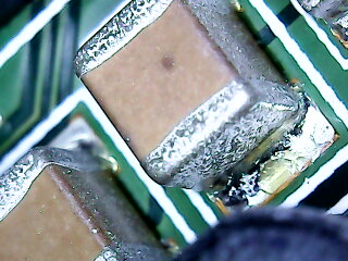

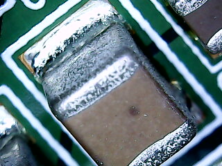

      Dear Diah:
      last night, I thought about oven bake. Why we hate it ? Maybe we have very bad experience with oven bake. We just throw whole PCB inside the household oven bake it until plastic parts all melted. Manufacture do use OVEN, why can't we?
      I would like to have a good fan-assisted oven, and cover all the plastic parts with aluminium foil and try it again. because I have some LG mortarboards have bad solder joints everywhere.
      How It's Made: Circuit Boards
      https://www.youtube.com/watch?v=3ExnSF7eVVQ
      At 2:00 they use convection oven ( a fan-assisted oven).
      If they can do it once in convection oven , why did it twice with another molten solder bath!
