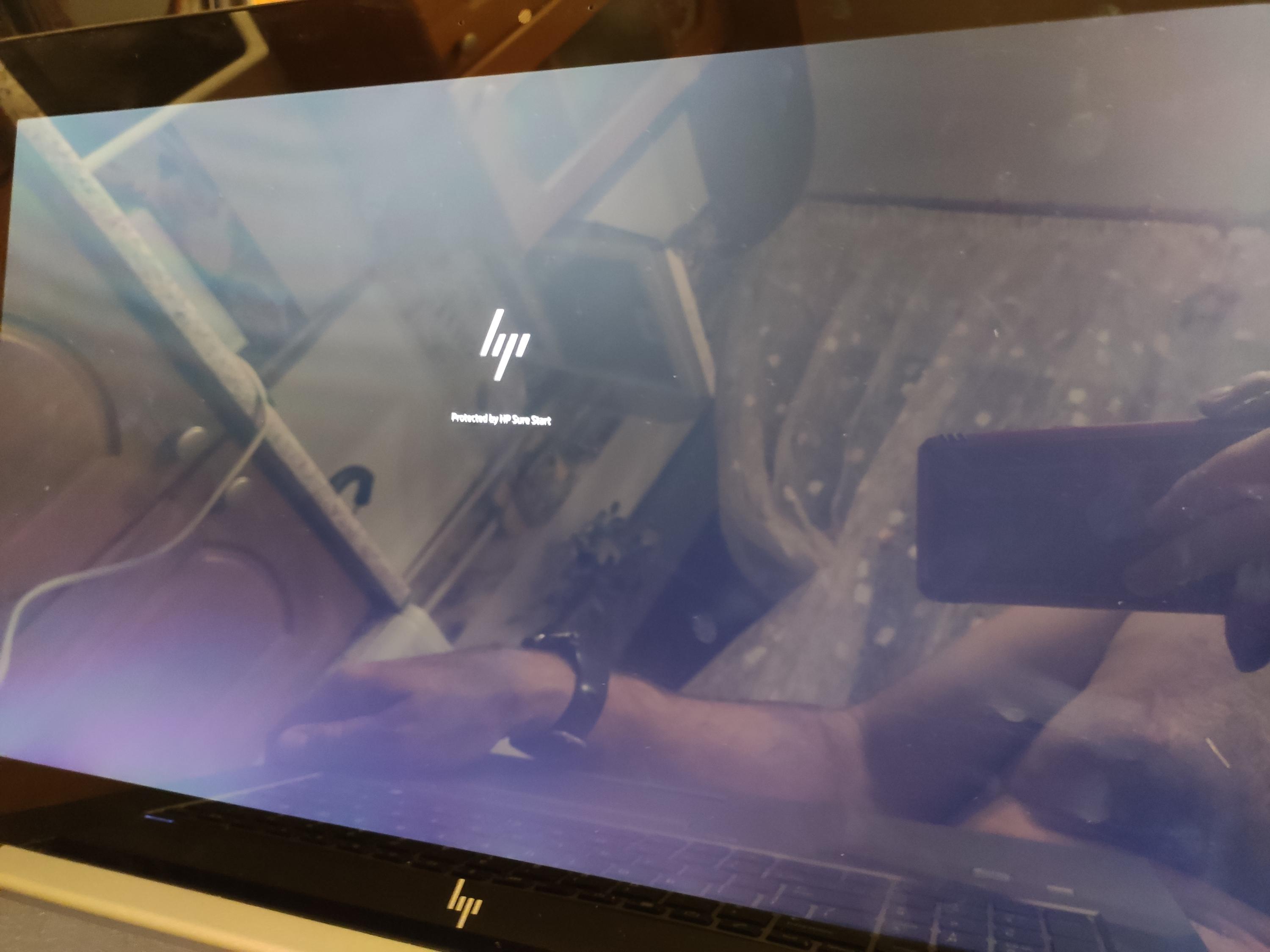

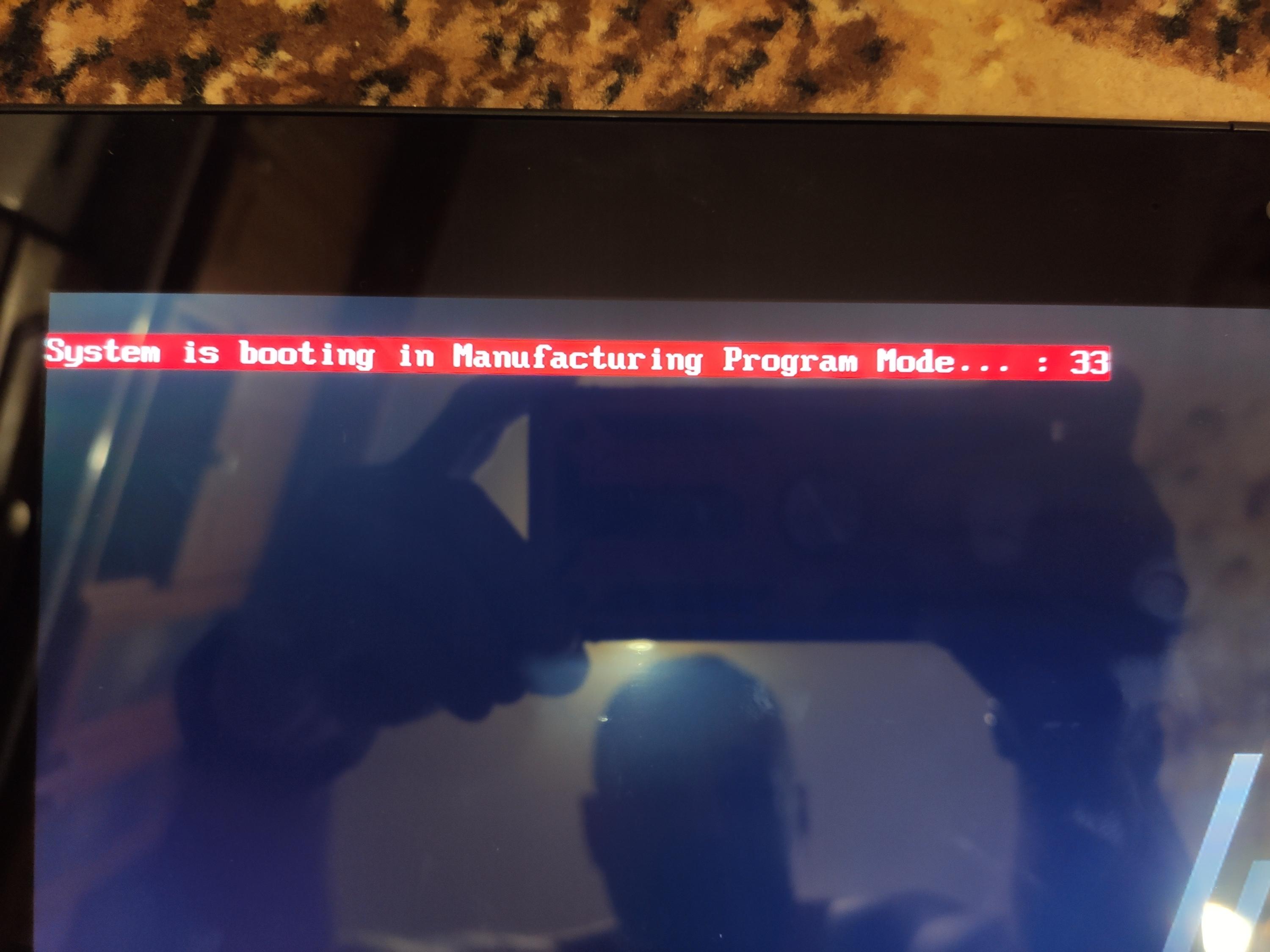

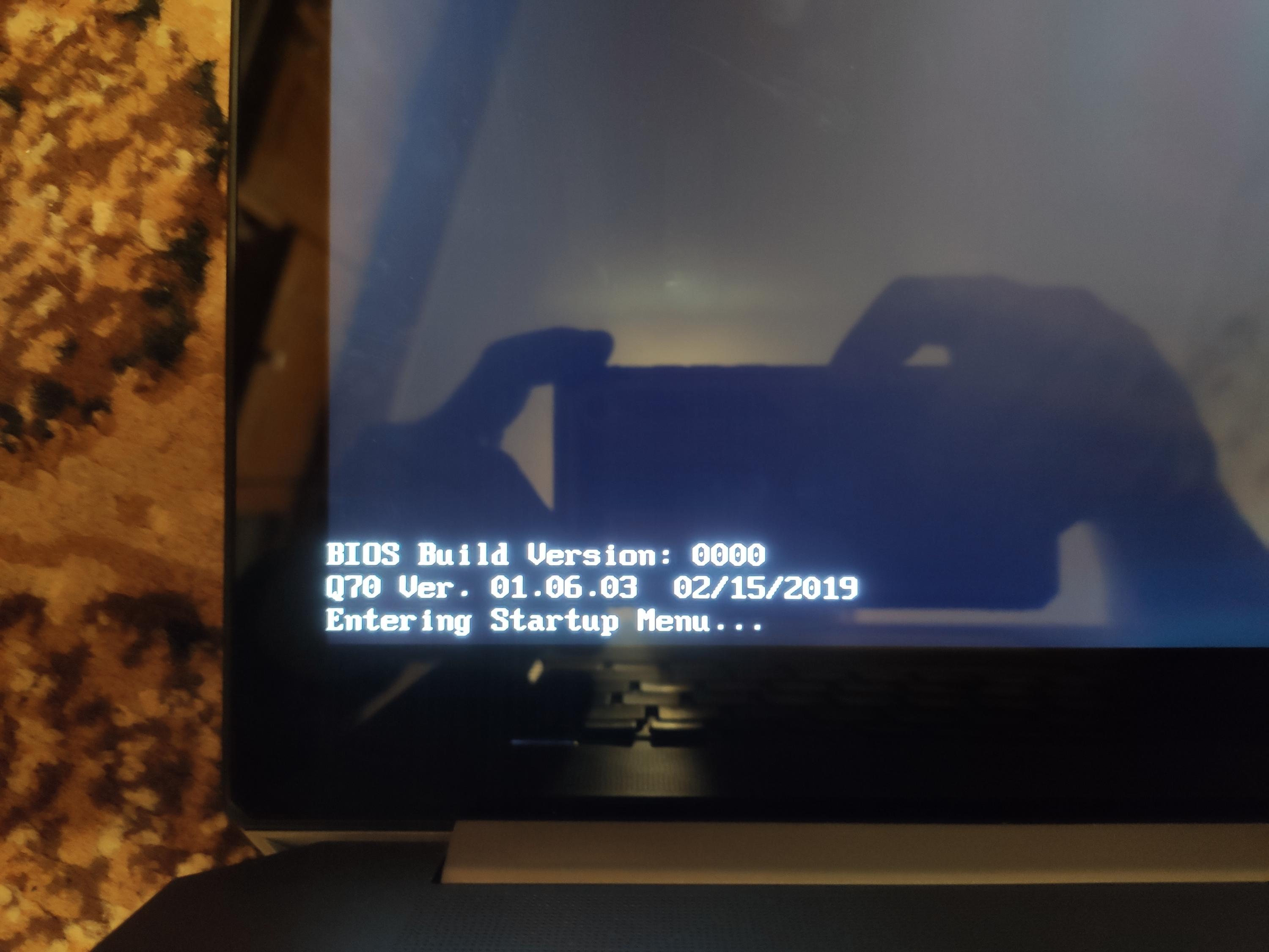

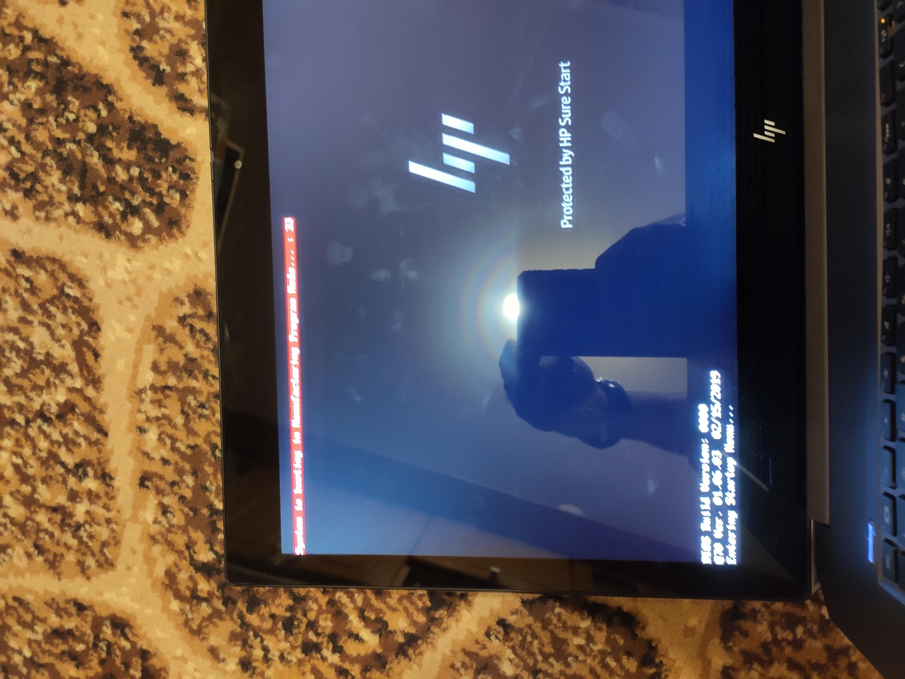

    Hi. I have buy laptop from ebay. Issue in boot logo freeze, not entering to diagnosetic menu or other menus - esc, F2, F3 F10 F12 . Try combination keys win+b - no success. Try flashing bios and EC - no success too. Only freeze logo, whrite entering menu in down side lcd but not entering, then if press enother key ( F3 , white legacy op rom boot and not entering, then if press any F 1-12, only whrite optional menu but not entering.
    What is problem - I don't know. Caps lock and num lock flashing 4-5 times and reboot, then flashing power button many times, need 5 sec press for hard reset...

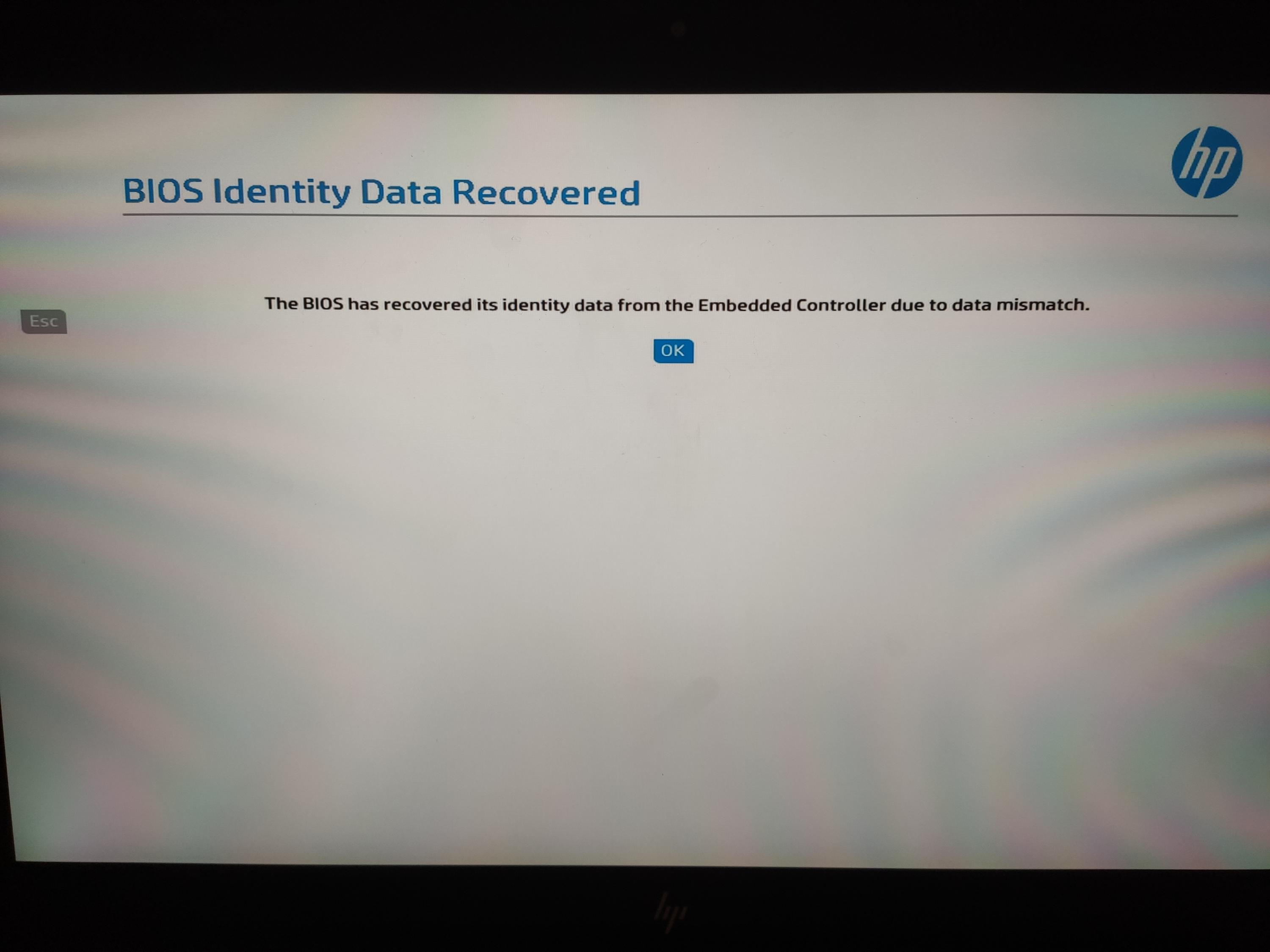

          laptop stay Freeze on hp logo, no boot in any menu Bios and not Pass POST and booting in OS
          maximum what i can do - its try recovery combinations key, but only one window i can see - Embedded controller due data mismatch. Not entering in Setup Bios menu, diagnostic... just stay on HP logo
