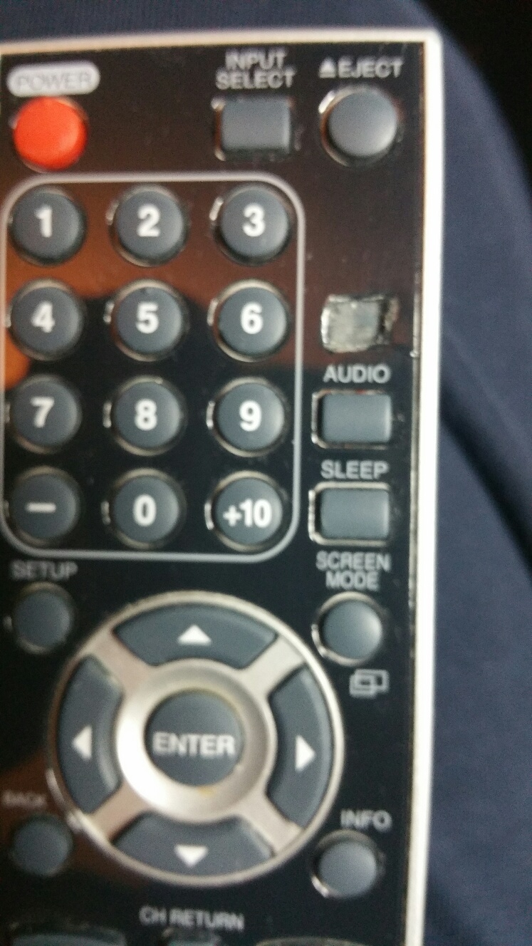

            • cliff_hootarski
              • Jul 2006
              • 411
              Re: Sylvania LD320SSX Flashing Color Test Pattern
              Here is an Emerson remote showing where to cut the plastic to access the hidden menu.
              Cut out above the "Audio" button.

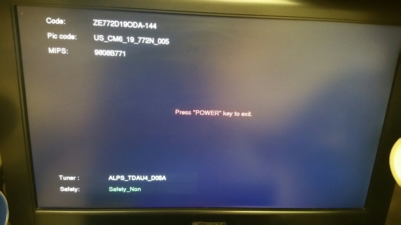

                • cliff_hootarski
                  • Jul 2006
                  • 411
                  Here is a picture of the screen when the "secret button" is pushed when the TV is "On".
                  Where to go from there is anybody's guess.
                  I did press the "Left Arrow" button and it started to display full mono color screens.
                  Thought it was stuck in this mode but I pressed some key or series of keys and the TV came back to the regular screen.
                  Kinda afraid to press any other keys and mess up a working TV. (Wife's TV in the kitchen).
