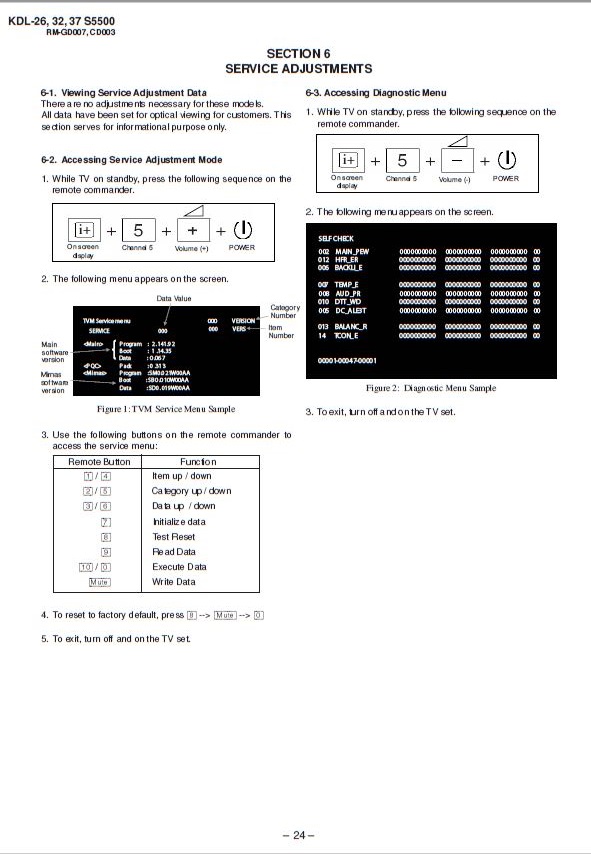

    Issue with this TV is when BBC channel is selected TV will switch off and back on about 12seconds later. It only happens on BBC channels. I believe it to be a corrupted firmware issue but tried doing a factory reset many times to reset firmware. Been informed that when successful RESET should appear briefly at bottom left of screen. For some reason this does not happen and TV annoyingly refuses to be restored to factory settings. Any body able to help????

    Maybe this will help.

      Really appreciate your help. I was trying pressing the up arrow and then pressing the manual power button on side. Which despite many attempts didnt activate factory settings as it should.
      Now tried putting it into service mode as the instructions you forwarded to me. Again afraid no joy. What im finding is after pressing the i+ button when i press 5 as per instruction the TV switches on. Must of tried it a dozen or more times but still refuses to get into service mode. Had it gone into service mode I could have then pressed 8 then Mute then 0 to enable factory settings that way.
      Have you ever had a Sony KDL that refuses to go into service menu?

          The TV should be On then do the folowing sequence on remote i + 5 + volume up + power
