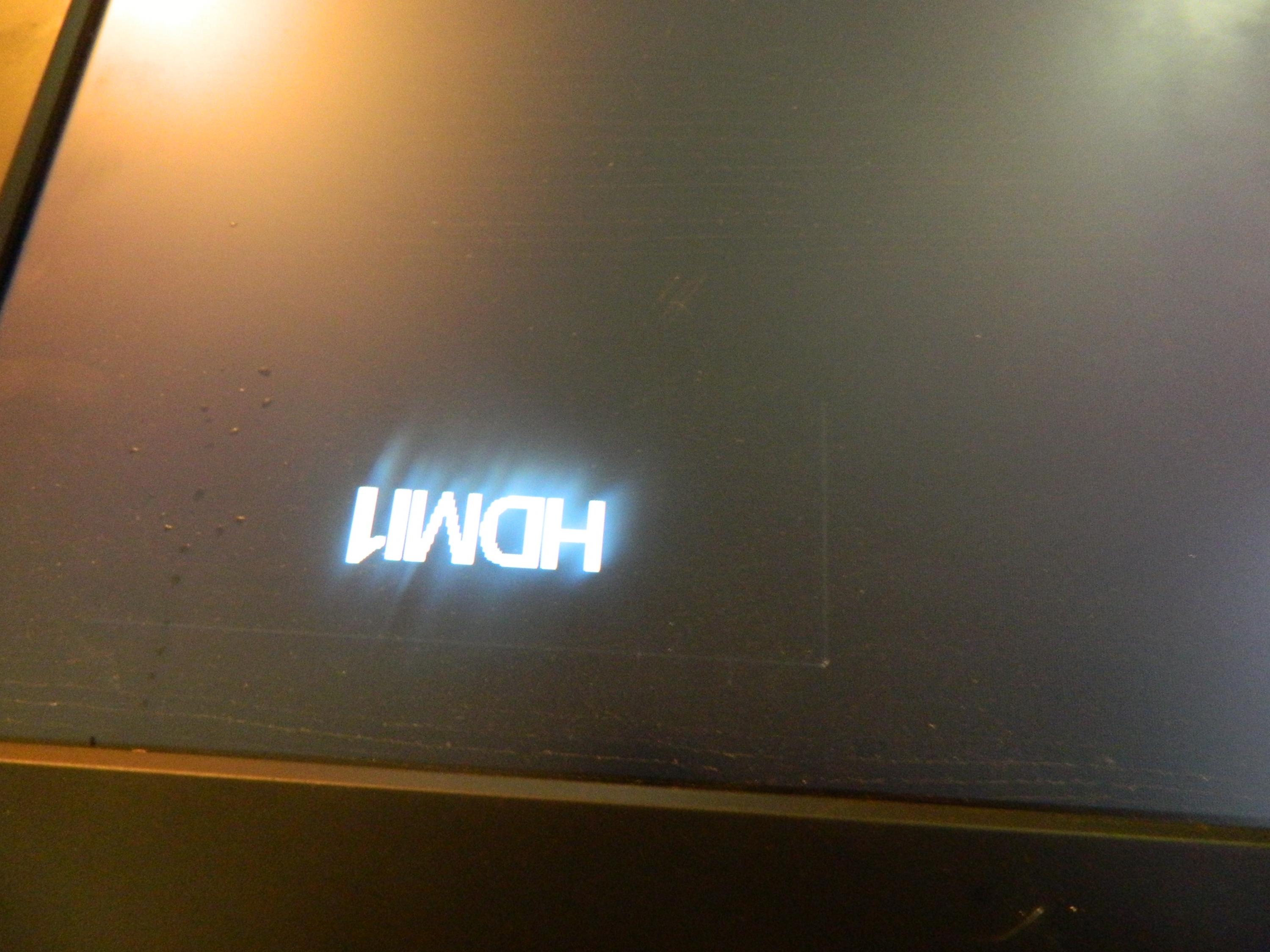

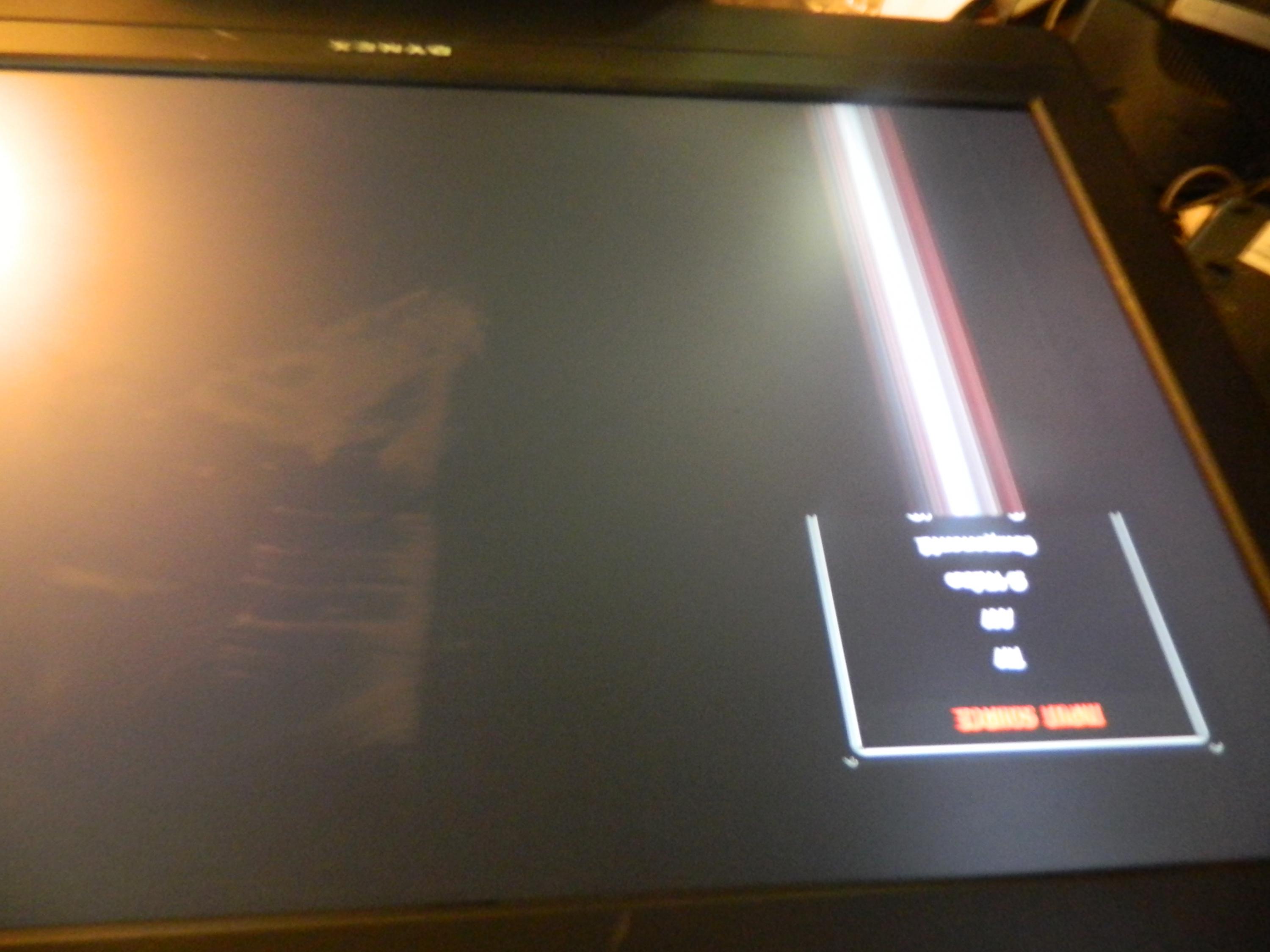

    Question. Im a little lost. I didnt pull the back. But im thinking main. Tv turns on, but only the top 1/3rd of the screen is working from left to right. Bottom half black. Image is ghosting with what is there.
    Hooked via hdmi to my pc and winblows 7 see its there. But no sound coming through tv speakers via hdmi. Also tv seems stuck on no input signal. Tv doesnt seem to respond to any buttons unless power on!
    Im thinking main is dead. Everything else ok. BAD VGA solder perhaps!
    I would think bad panel if up/down, but left to right seems to be main?
    Its in a really good shape 32" and main is only 25. So your thoughts?

    You can see in these images the ghosting!
    I highly doubt t con

        Re: Dynex 6HV0206910
        Panel failure Imo, what screen is it ? Seen Cmo and Samsung fail in the same way.
          Really? Damn that sucks...I was just hoping it might have been the t-con and I was looking in the wrong direction!
          But I wonder why I was getting no sound through it? Because I had you tube on pc and cranked it up. Was not getting a peep out of it.
