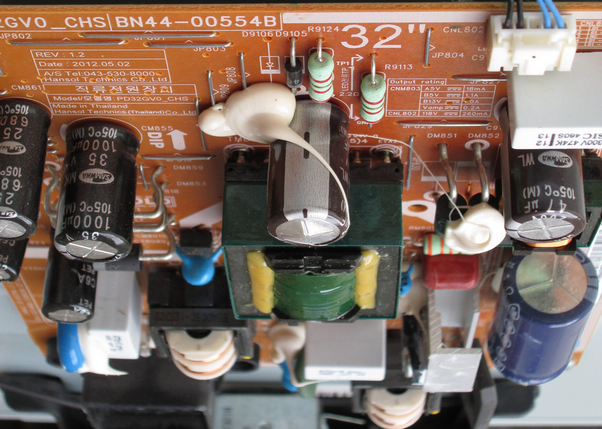

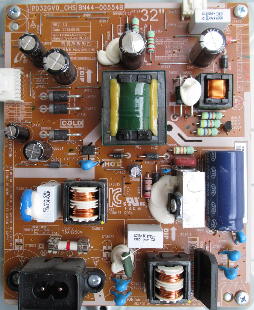

    Thought the Bad Cap Plague was over until saw a bulging cap on a Samsung LED TV Model UN32EH4003 power supply (PD32GVO_CHS BN44-00554B)
    Since there is a "Good" same size cap (except is 200V instead of 160V) next to the bad one am thinking Samsung used too low Voltage. (Attaching Photos)
    Have never seen this brand.
    Appreciate comments concerning reliability.

    Ken,
    I've seen two bulged caps in that same model set (same cap two different sets). I replaced them with
    47 mf 160 v and they are still going.
    Take a look at my previous posts on that issue.
    https://www.badcaps.net/forum/showthread.php?t=40665
    Mike

      Re: Samsung LED TV Model UN32EH4003 Bad Cap?
      The Samwha WL series is defective as well as WB replace all WL and Wb.
            Ken,
            I used Digi-key part number 493-13260-1
            It is a Nichicon general purpose cap.
            I did not look up the specs on the cap or the defective one in the set and try to match them.
            All I can tell you is that both sets are still working with that cap installed.
            Mike
