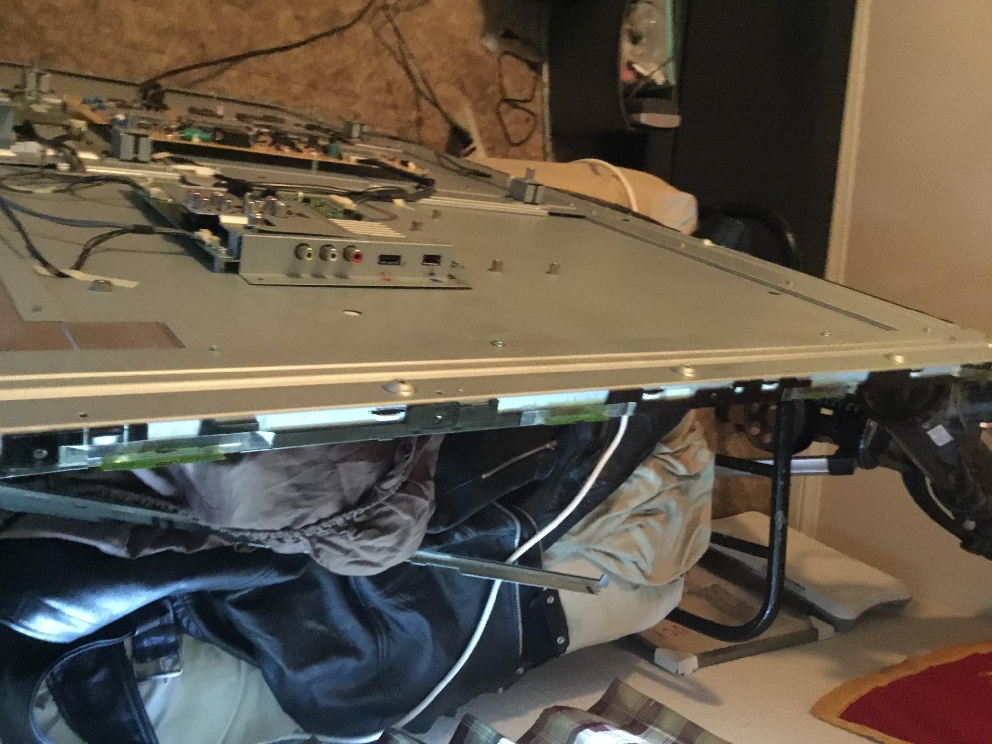

    Ok so I followed the thread on the sharp save by pulling side driver on the 70 and but my 60 does not have side driver board. As u can see there is no board on the side it's just the tabs with ic. Any ideas ?

    Ok no guts no glory. Just pulled the tabs off the lcd on the side that was bad and bam we are back in business

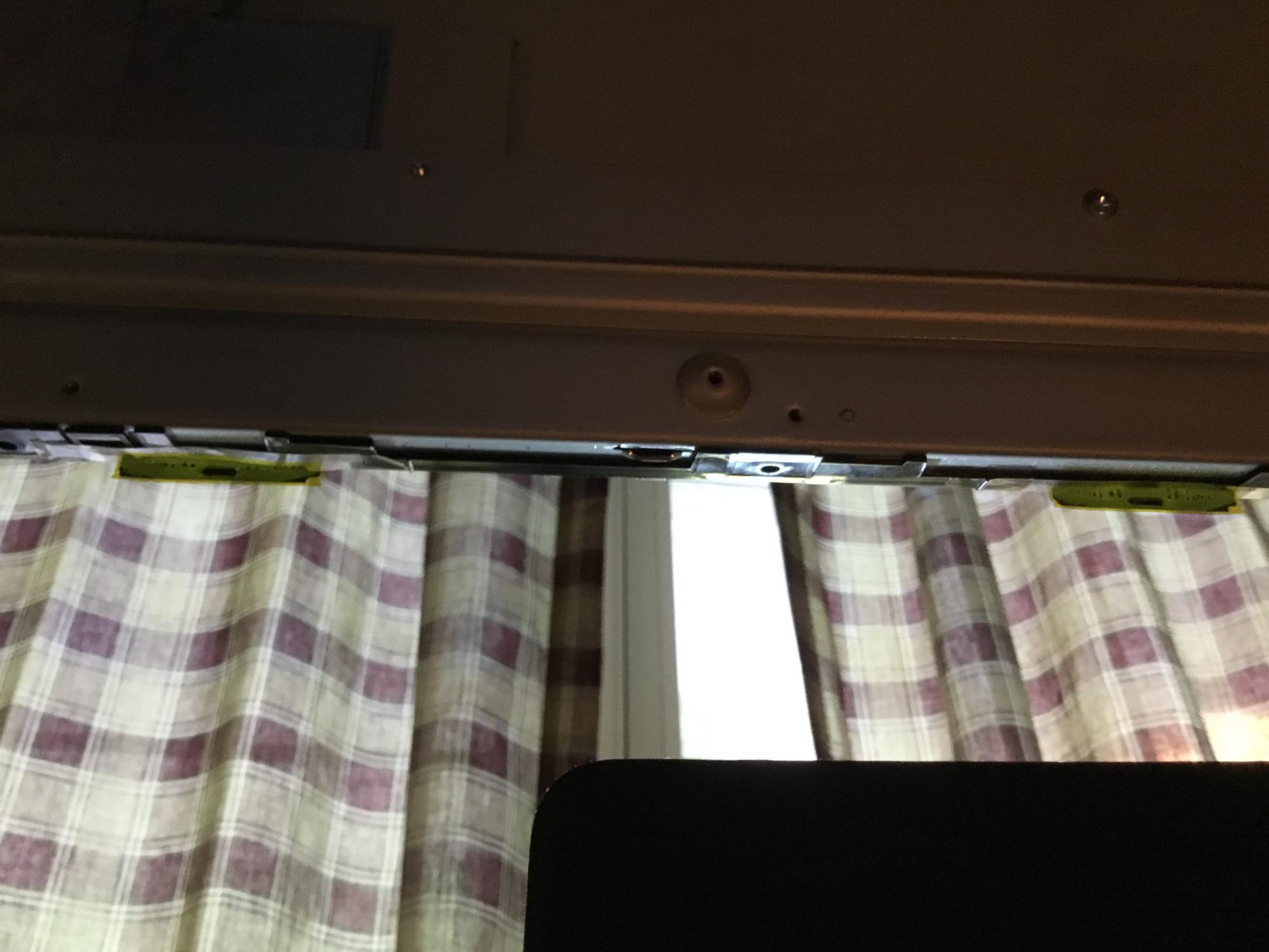

              my Drivers were bad on the left side of lcd screen. I disconnected the left side of t con and got the tv back on just like they showed on the 70 " thread. Started tearing it apart but after I tore apart I learned there was not a panel like the 70" only the driver tabs. If u will look when u take the bezel u will see them taped down. There is 2 driver panels on each side on the bottom (for left and right on lcd)
              There is tabs with drivers on the top,bottom and sides. I think the plug u disconnected on the 70" is actually is a printed circuit board in the lcd on the 60" if u look at the picture I posted that is on the left side of panel.

                I wished I would of took more pictures. I can help as I best I can I tore the tv down farther then I needed to because I was looking for a plug so only thing that need to done is bezel needs to be taken off after u figure which side is bad

                  For clarification in the previous pic it looks like what I would call the "tabs" are still there so did you instead remove the driver ic from each of those three tabs ?

                    First, make sure you have isolated that it is the drivers on that side . Once u do that u pull off the whole tab from the led panel not just the ic.
