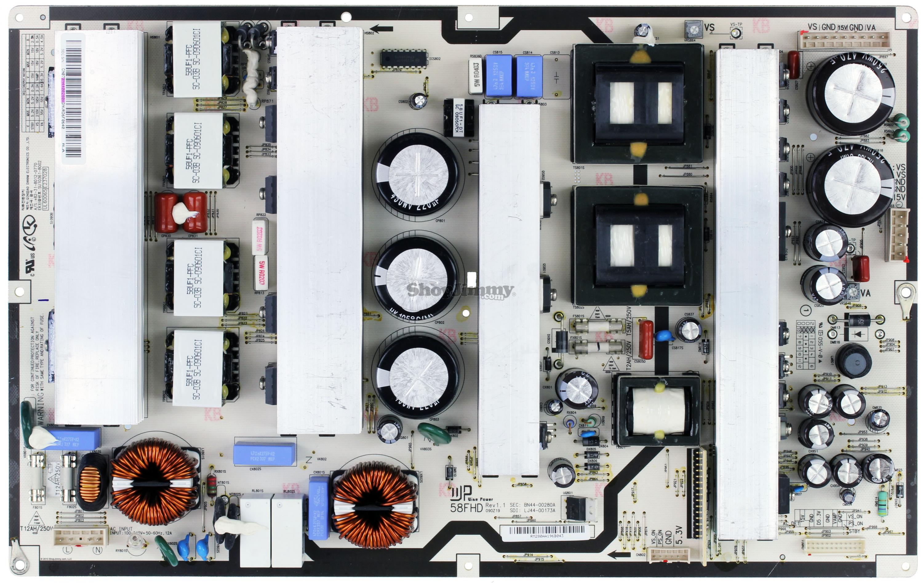

    Hello
    I have a BN44-0280a power supply that is giving 0 on all DC outputs (Vs/Ve/STDY/+5/+15).
    Would anyone have a schematic for power supply?
    Or even a couple test points I could narrow down?
    Info on board:
    Had a blown FS801S QS801 and QS802 were bad and replaced.
    Still nothing on outputs.
    thanks
    MT

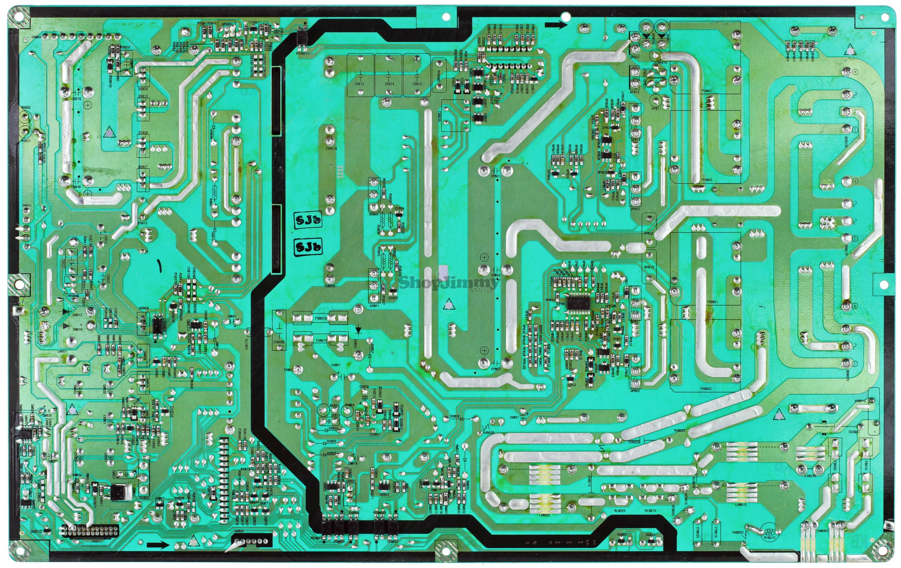

            Re: PN58B550T2F - No power - BN44-0280a
            https://www.badcaps.net/forum/showth...ht=BN44-00280A
            To force on the power supply (board is not connected to the main board)
            PS-ON = GND
            VS-ON = HIGH using 1K resistor between VS-ON pin and the STBY POWER SUPPLY PIN.
            Pictures provided by shopjimmy.
