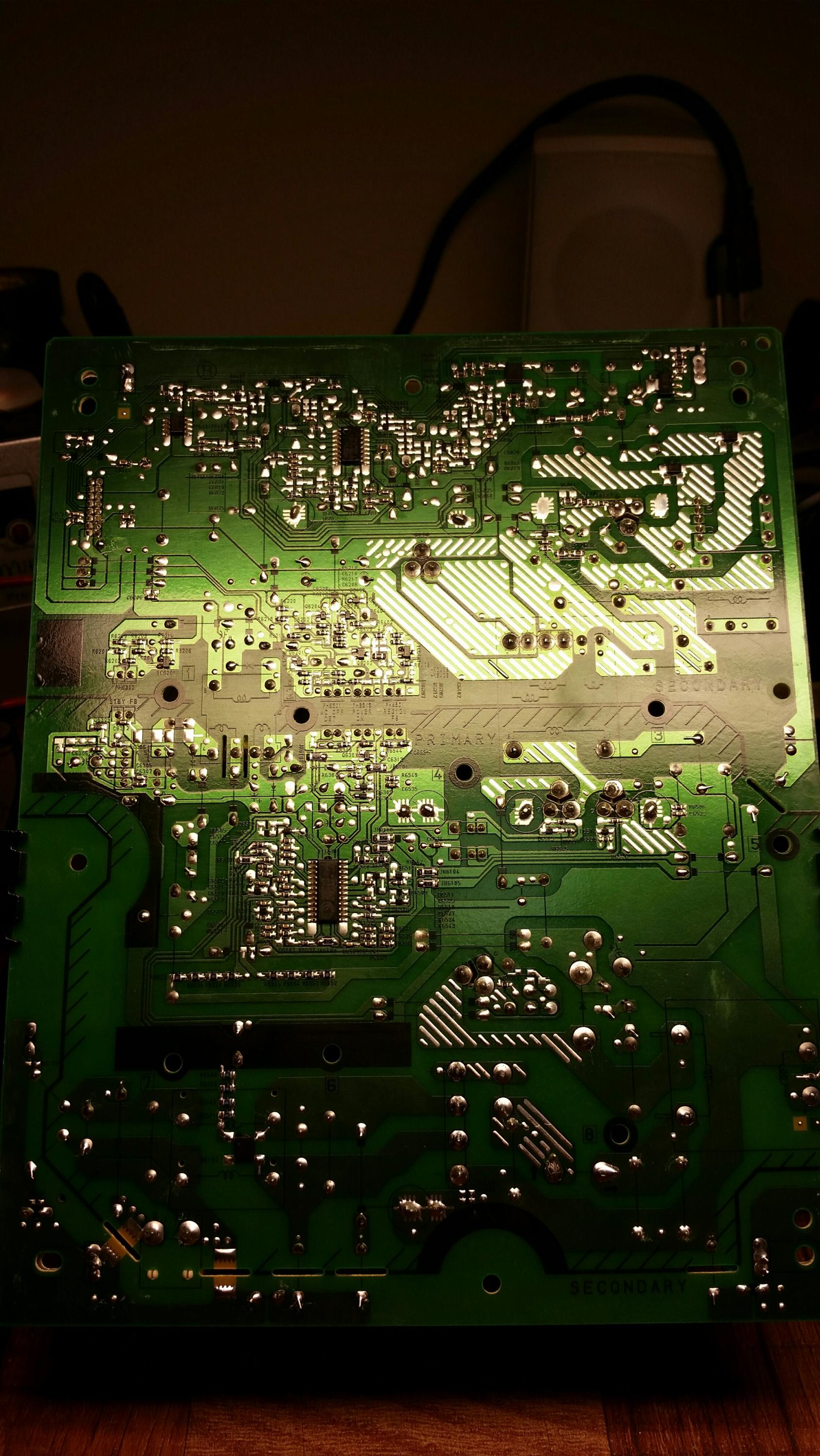

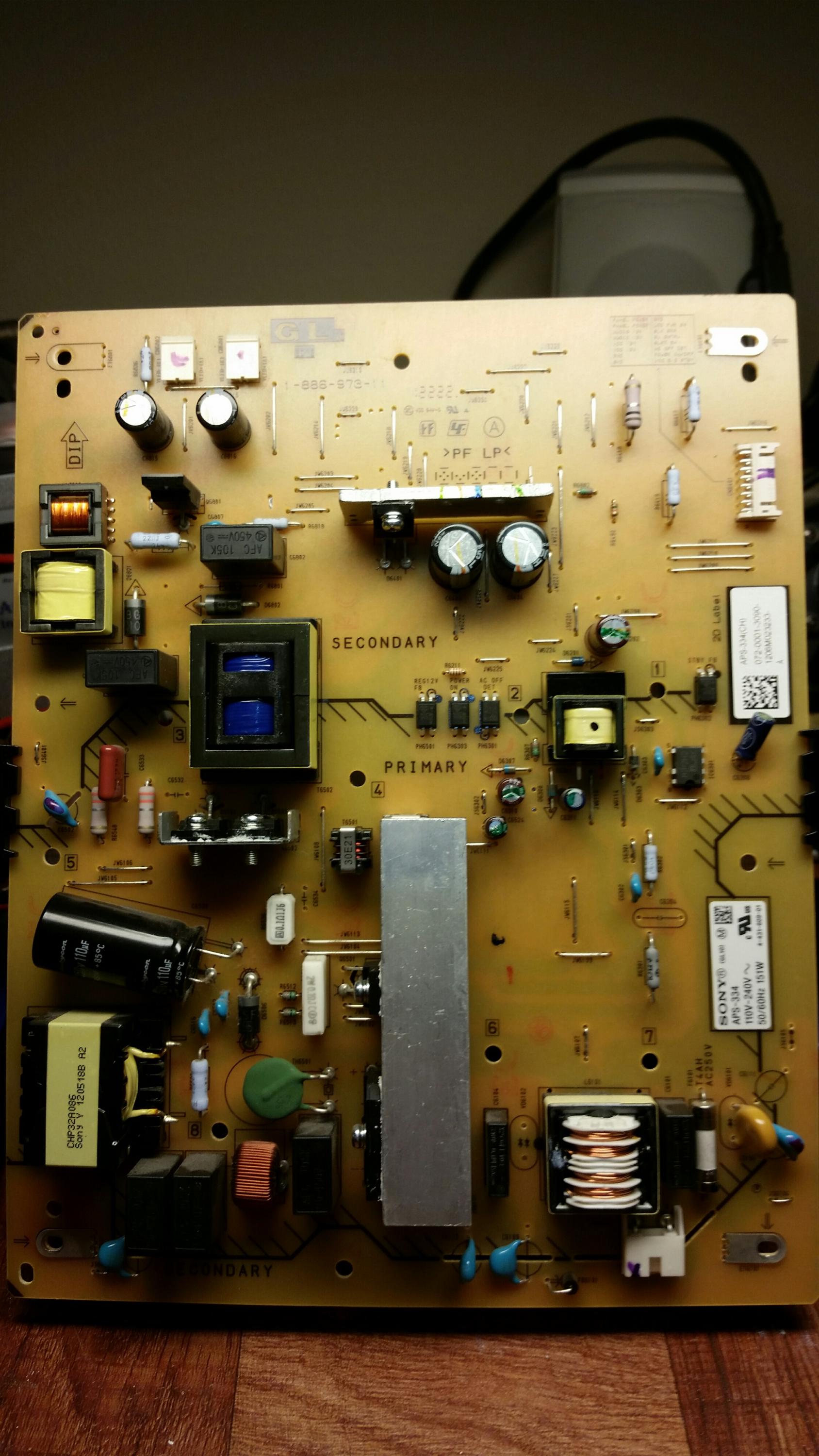

Sont KDL42EX440 power supply
  • ljintexas
    LJinTexas
    • Jan 2015
    • 669
    I have 165 volts DC leg to leg on main cap..165 volts on center leg of one of the two transistors that are paired up, nothing on the other one beside it...measuring against negative side of main filter cap. No voltage anywhere to ground..I do not have any other dc voltage anywhere on the board.
    Set was totally dead..no standby LED. Any help is most appreciated.

    Re: Sont KDL42EX440 power supply
    Check CN6401 and see if you really don't have 3.3V STBY. Check the resistance between the 3.3V pin and the GND pin, trace it back and make sure nothing is shorted in the secondary (rectifier diode, or bad capacitor) there.
    If you haven't luck in the secondary, check the primary STBY voltage part of the PSU where IC6301 (MIP2H2) is. Your reference GND for measuring DC in the primary circuit is the negative post of the big main filter capacitor.

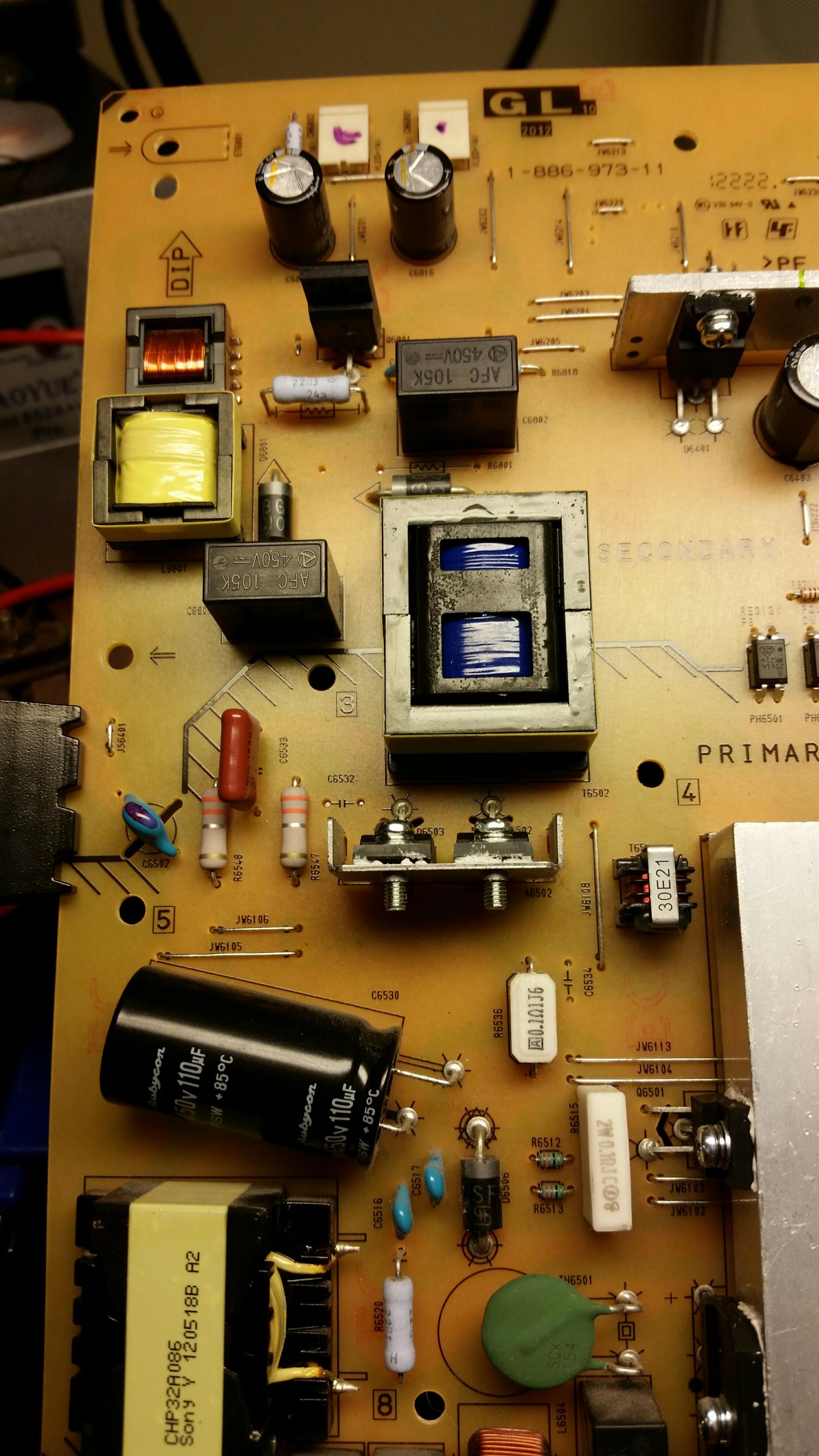

      I actually DO have 3.3 volts standby on the pin indicated. However, I do not have VCC 12V.
            Replaced one Schottkey Diode that tested bad out of circuit. I still have my 3.3 volts standby. Reinstalled board. No PS-ON/OFF voltage coming back from main. No standby LED.
              You got a bad main board. PSon, DIM, BLon all comes from the main board. That tells the PSU and the backlights to turn on.
              To force the PSU on without the main board, jump 3.3V through a 1k resistor from 3.3V to PSon and from another 1k resistor from 3.3V to BLon. plug it in and all the voltage rails should be up and the backlights should be on.

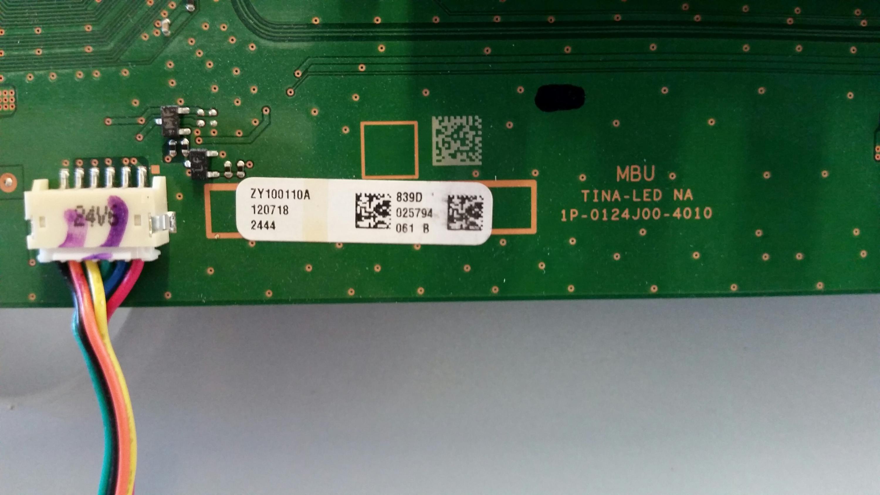

                ZY100110A is on the sticker on the main board.
                • ljintexas
                  LJinTexas
                  • Jan 2015
                  • 669
                  Here are the two labels on the board.
