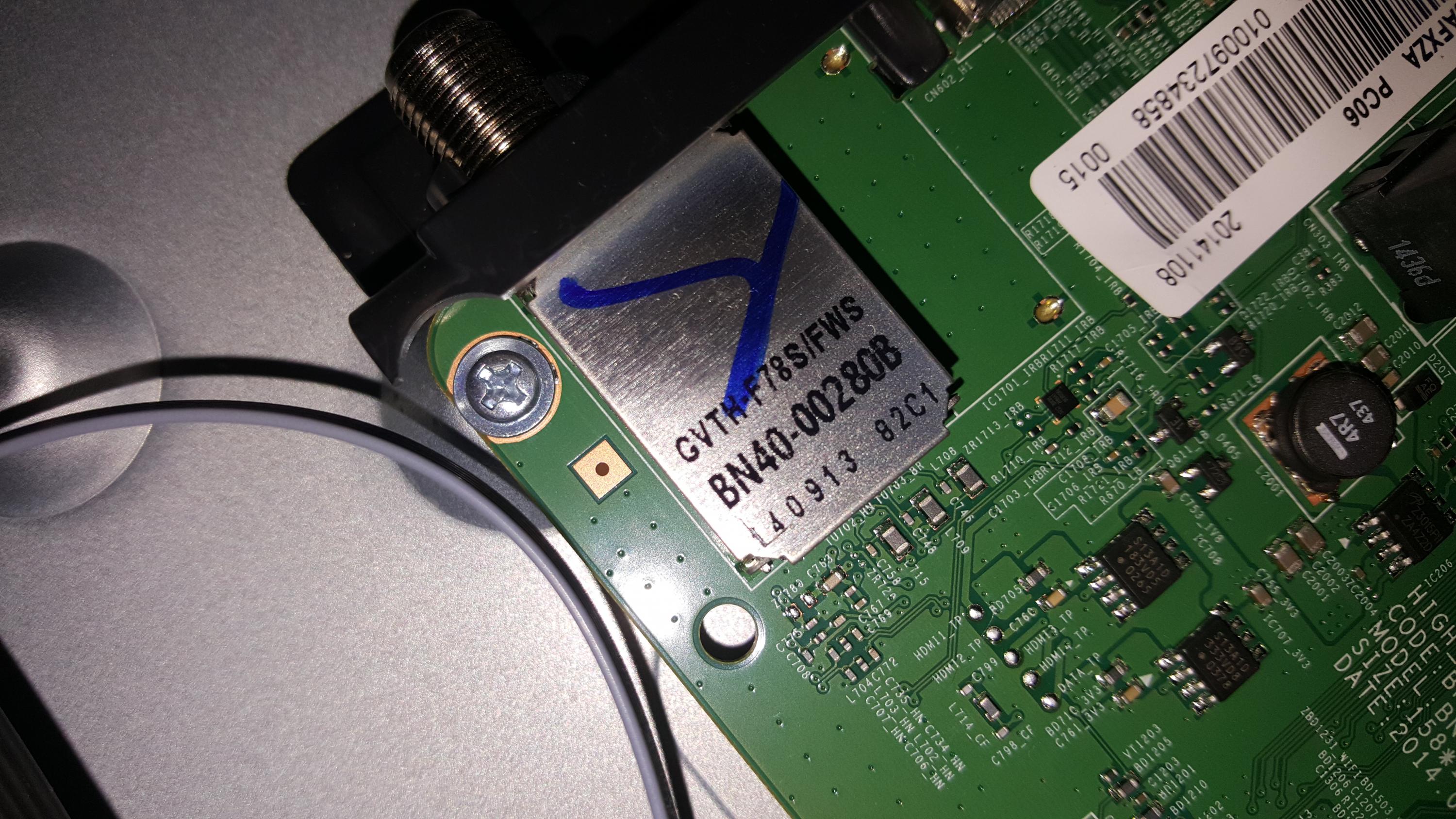

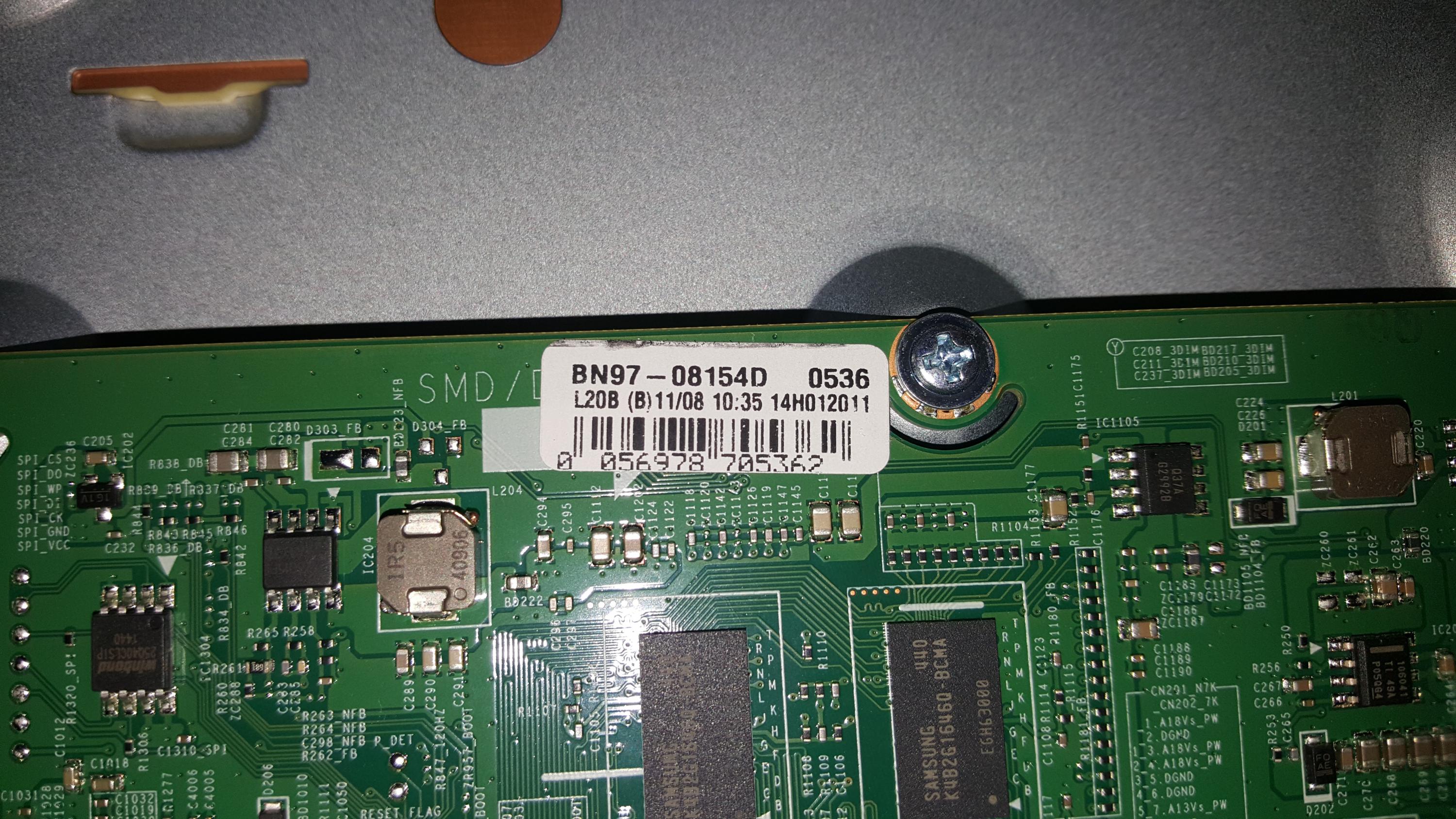

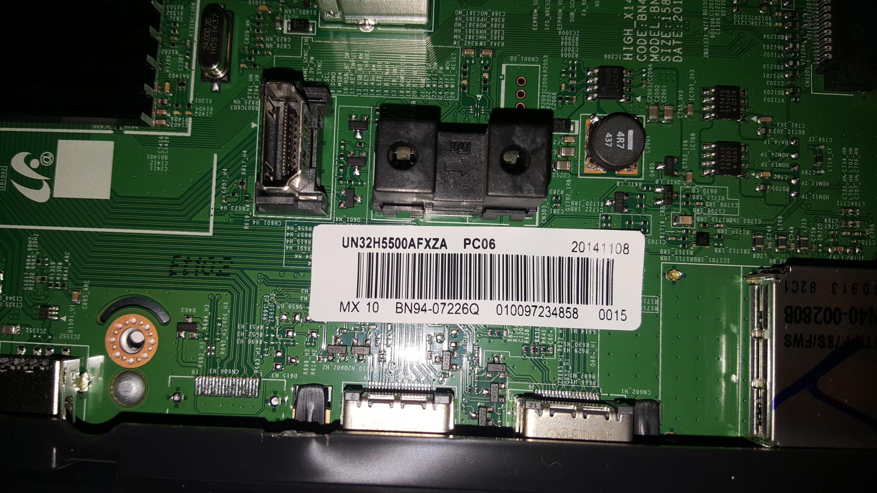

    pictures of the boards and part numbers from them mayhelp us too as we may of seen this fault before.

          And yes, this forum looks promising, since I got three replies in the time it took me to get one short reply on another "fix it" forum, the same one that told me "it's definitely the power supply"...yeah...then I ask again and the one guy says "main board for sure". So it's definitely nice to have a few opinions from a recommended forum Thank you all for your responses, and here are pictures of all the serial numbers on the Main Board. Wasn't sure which one you wanted, so I just took a picture of each sticker and the one on the cable plug in.
          Thank you again! (hopefully the numbers in the pictures are readable)
