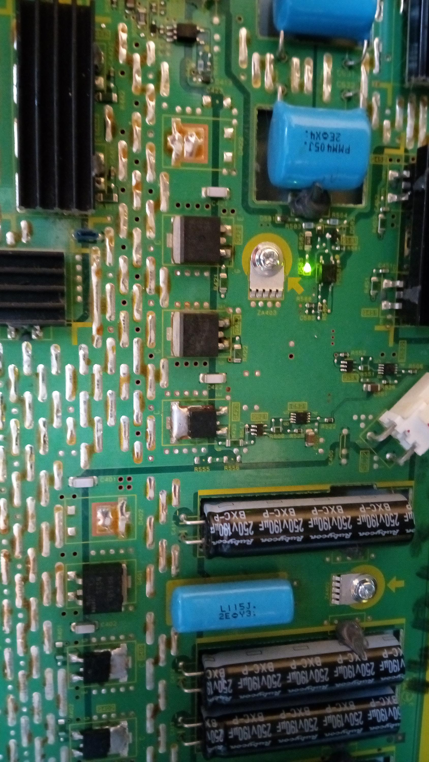

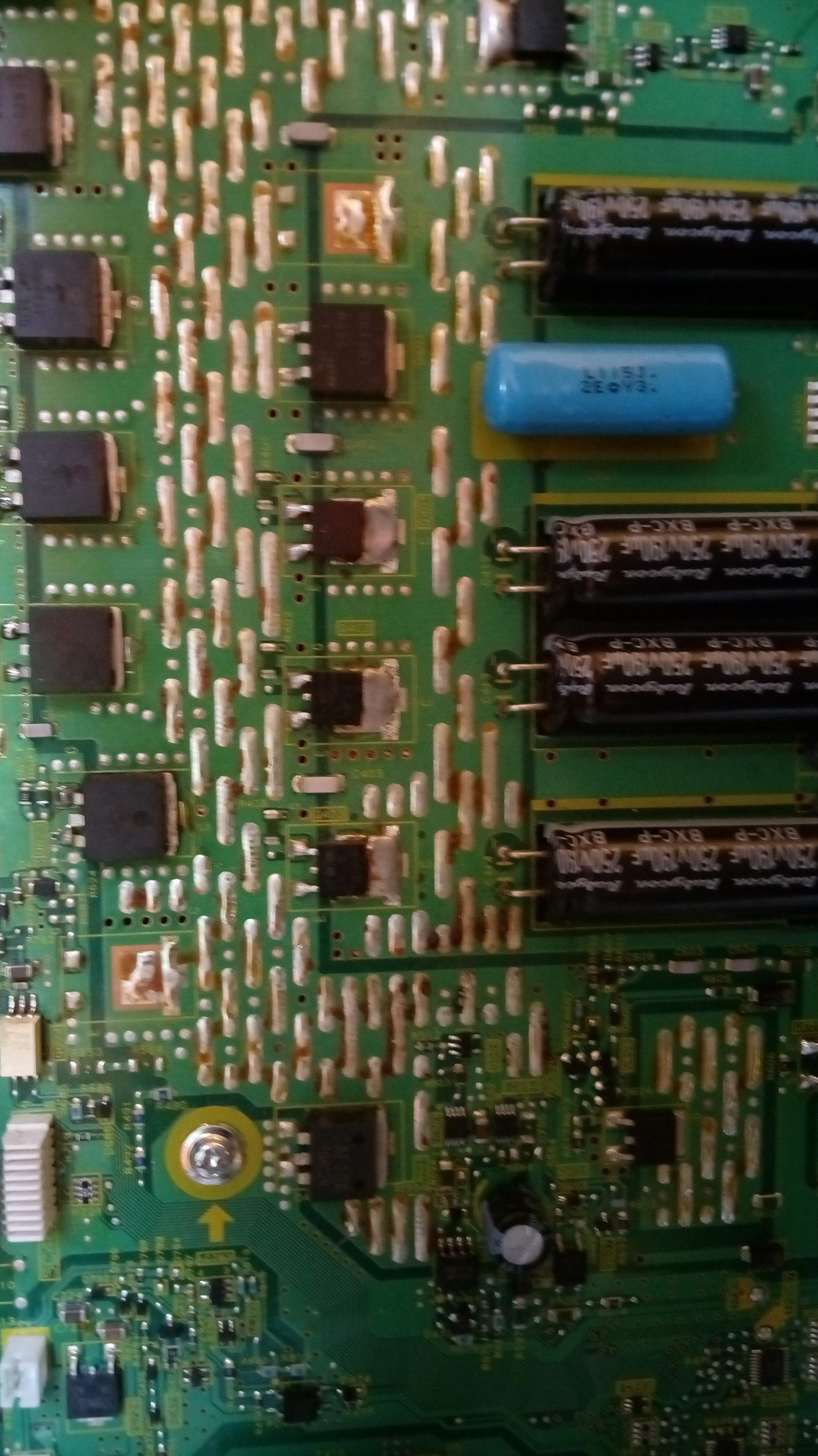

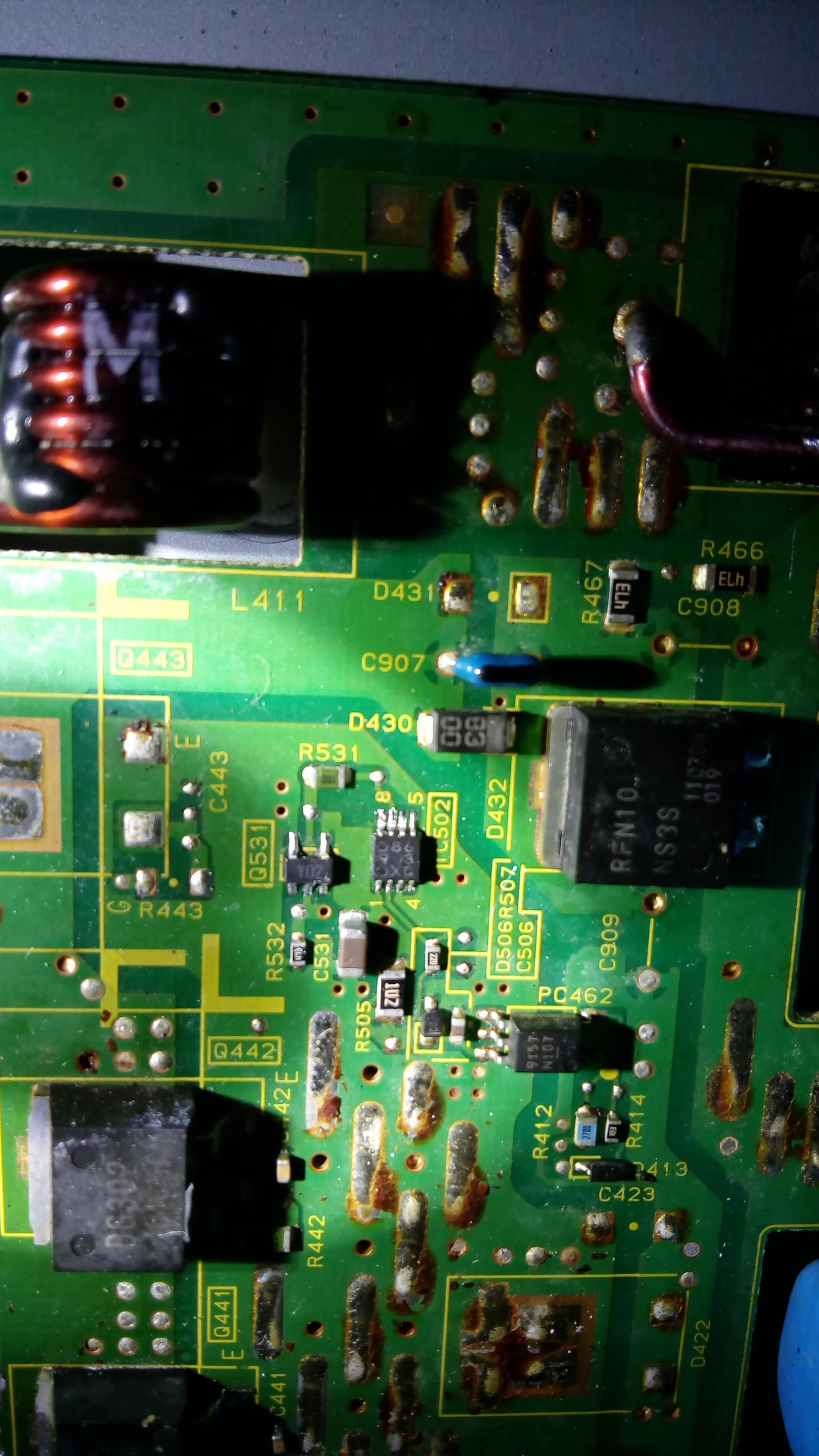

    haha...ok...please see attached...sorry about the bad light in the photos but you should be able to see the component numbers. The Y02 chips are also located at Q521, Q762 and Q501.

      I see it, not an original part you see it's hand soldered is this the part you fitted?

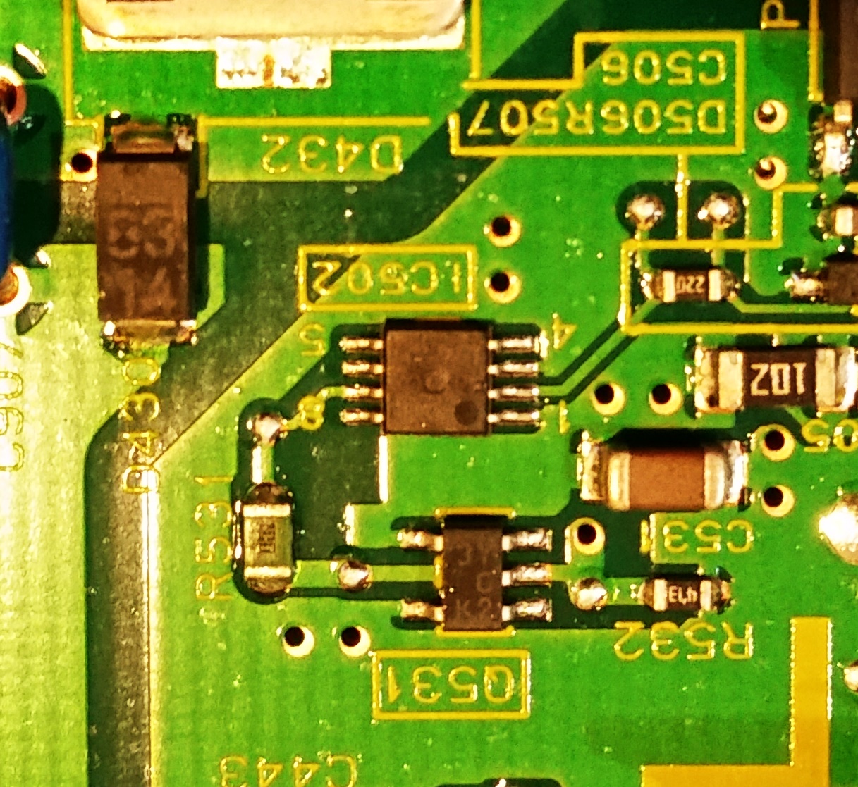

      Ready for mine?
      left to right top to bottom.
      3Y
      0
      K2
      This is original and there's a total of 5 of these fitted at Q501,521,531,551,762. Those are on the SC board so find and compare each to each other including what you just put up for 531.

        I'm glad we have a sense of humour, is this how you got the board? Someone elses repair? Pictures of the others or are they identical?

          The fresh solder is from me, I robbed one off another dead board (TNPA5351) to get this one going but I'd like to replace it with a new part. I have 4 TNPA5335 boards (AG and BG) at the moment that came from 7 blink TVs that did not show any signs of repair, one was a working board that came from a smashed ST30 that had been repaired but all use the Y02 transistors in the locations mentioned.
          I have done a few TNPA5349 and TNPA5330 that use the 3Y transistor but all the TNPA5335 boards I can recall use the Y02. I was going to ask if these were interchangable as I have some 3Y transistors spare and this would be much easier for me.

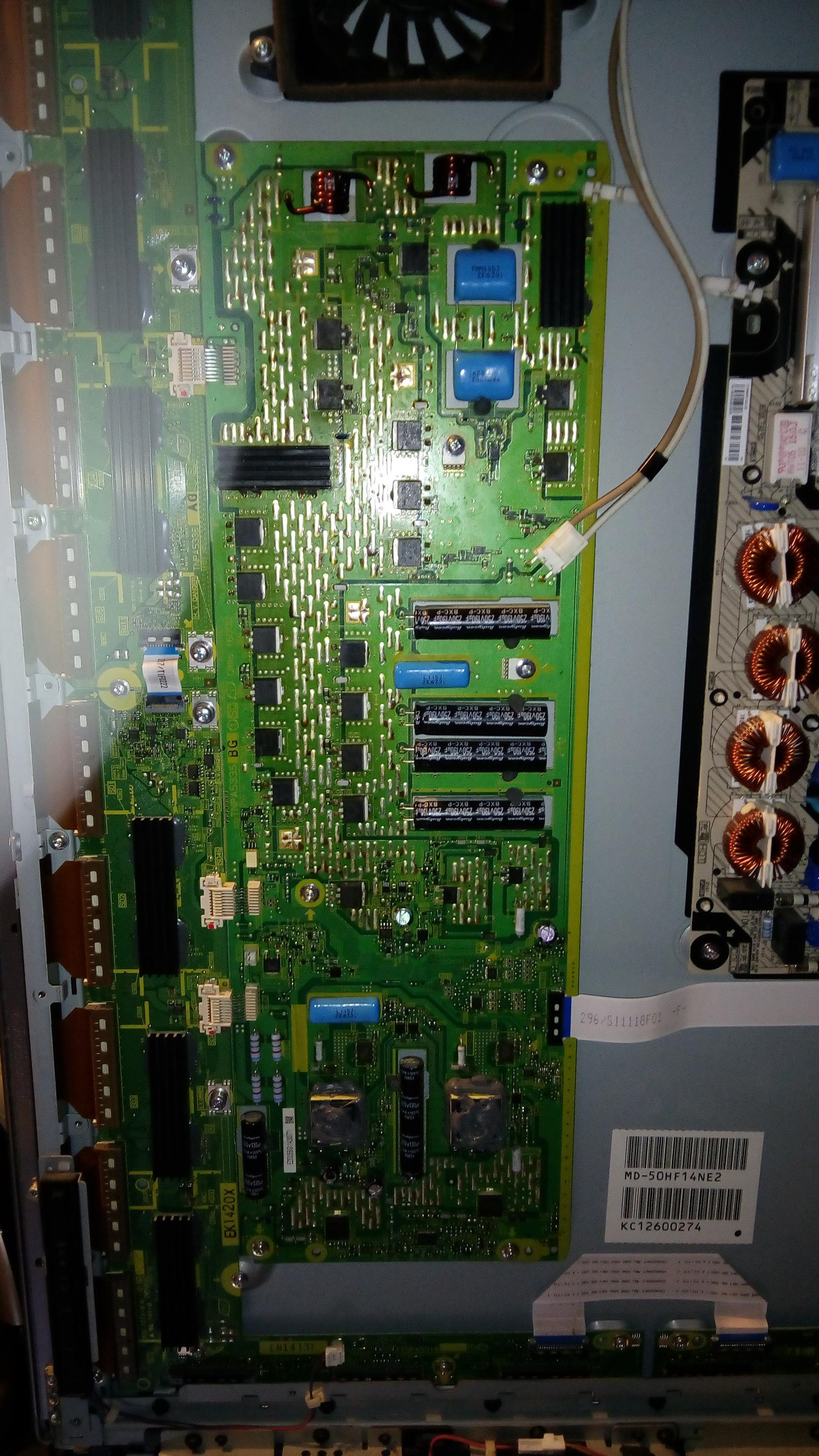

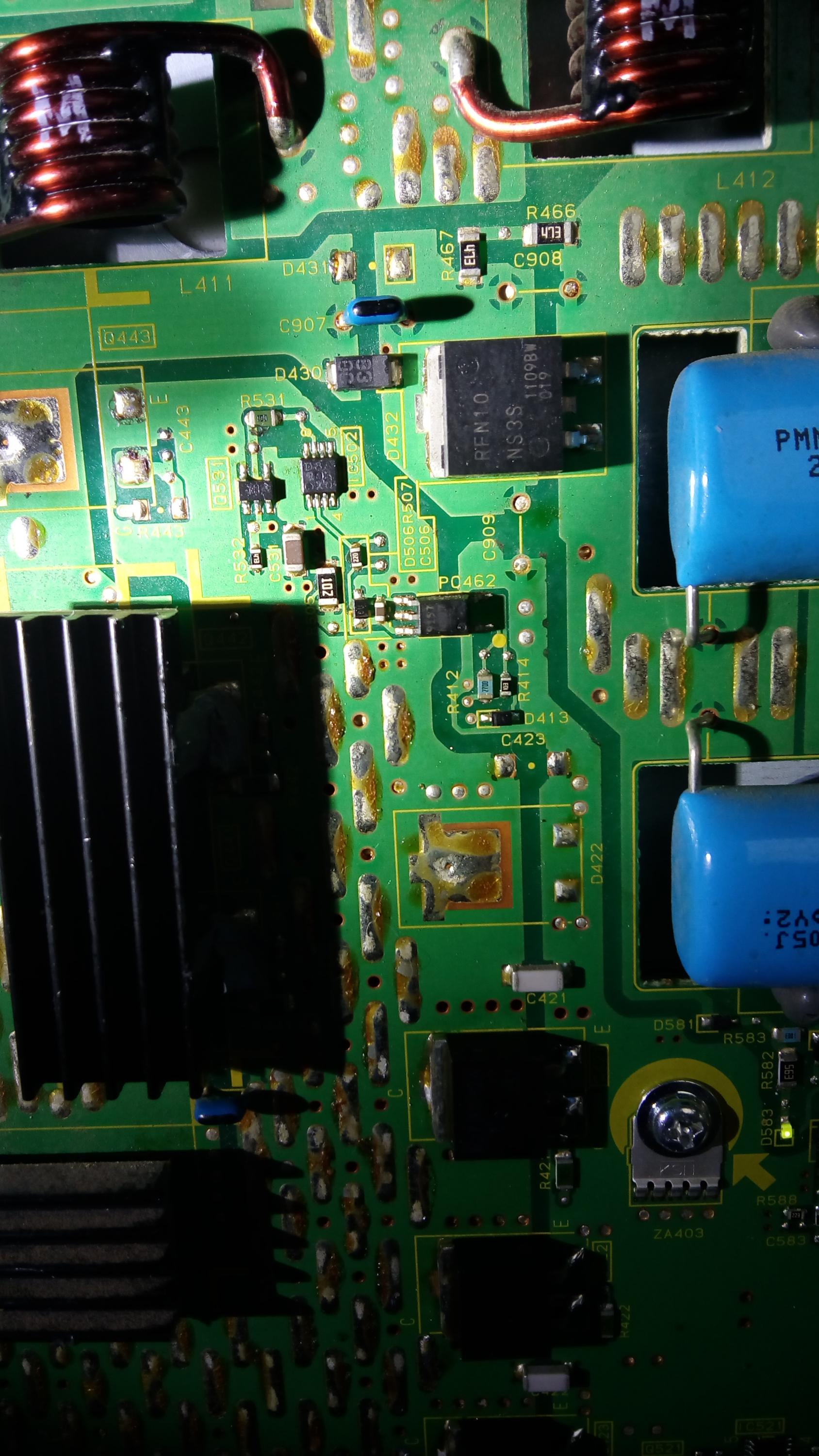

            Here's another board (currently powered up as you can see from the green LED) running in a TX-P50VT30. The picture isn't great but if you zoom in you can see the Y02 printed on Q531.

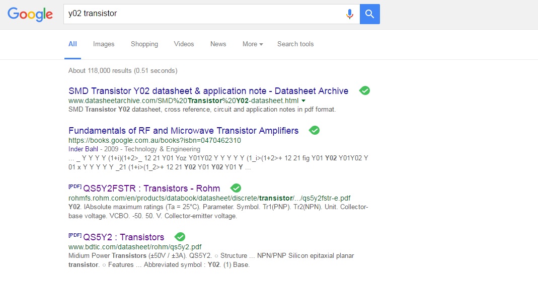

              Ok, you just forced me to try something. Use the force(google)
              Y02 search I snagged a 5 pin ROHM device 3A 50V NPN/PNP -3A -50V
              QS5Y2
              So I'll give you half an apology as we're probably both correct.
              Bit of a revelation , I've never seen these and we have AG and BG revisions, all the manuals I have the OEM and real part numbers match up.
              But You did say you identified these as AD8211YRJZ Chip screen printing:Y02 AD SOT23-5",
              that's definitely wrong.
              So we are both learning here. If you have the 3Y CPH5524 use them and remove any Y02 that you ordered identifying as AD8211YRJZ Chip

                    Thanks for your help, I googled 'Y02 transistor' originally and about the 7th hit returns the AD8211 part number which I then found on aliexpress which looked identical so assumed it was the correct part...clearly a mistake! Since you can confirm that the 3Y transistors are also correct I'll just use them from now on but it would still be handy to locate replacements for the Y02, I might order some of the QS5Y2 and try one in a spare board. Cheers

                          You'll be safe with that QS5Y2, ROHM is a common part supplier on these boards and the spec sheet confirms it's(post #66) similar just lower current 3A instead of 6 on the PNP but clearly 6amp is not needed.
                          Thanks for your resilience, If we both did not force the topic I don't think we would have stumbled on this.
                          I did not believe you but the original Y02 on a running board, slam dunk. I was thinking chinese copy but that last shot 100% OEM fitted part.
                          You just gave yourself a curve ball, now you just have to get it working

                                        Yep, whoever did this repair used a lot of solder to fill in the void, see photos attached....the date hand-written on the board looks like 2013 so it seems to have held up ok? I'm not sure whether to swap these out for orginal parts or leave it be? It's certainly running OK...
                                        FYI this board also uses the Y02 transistors...
