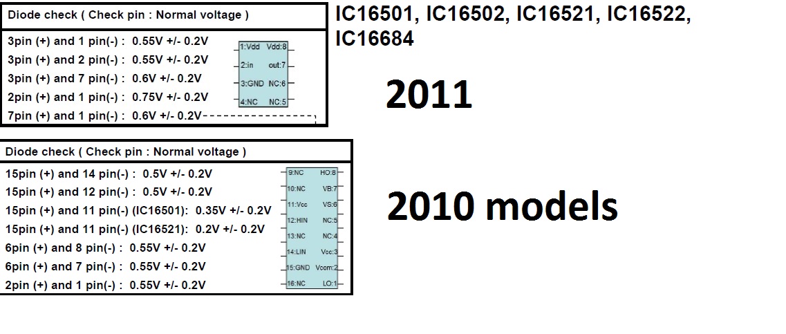

                Well lets say I checked every bit of the SC Board
                Checked all IGBT´s FET`s and Diodes.
                Checked control signal drive circuit (Drive IC´s and Power IC`s and components in circuit like Resistors, Transistors and Capacitors)
                Also checked power circuit and everything looked good.
                Well there was no more option left for me since I dont own an scope but I had a bad feeling while soldering the tiny IC502 and Q531 cause my "Weller" soldering iron broke some weeks ago and I never replaced it and was left for this job with one of these cheap warehouse soldering irons.
                Measurement was OK but you never know.
                So I used some Flux (to compress the low temperature of soldering iron) and repeated the soldering of Q531 and IC502.
                To make a long story short, TV is running for 12h+ now!
                I added some Loctite to the screws (ground problem) and also some small heat-sinks to the 8 switching components to prevent overheating (again?).
                TNPA5335 with extra heatsinks
                Summary:
                • Never use shitty tools if you want to do the job right!
                • Anything wrong with Q531 and IC502 can cause 6 blinks SOS
                Big THX to tw2005, love your attitude
                Topic can be closed now

                    Looks like it was my turn to get one of these. This was a repair board i.e. one I received.
                    Usual suspects, 6 IGBTs blown and been having dramas with fake 30F131 from UTSOURCE blowing up but I keep trying just in case I get lucky.
                    So I fitted these suspect parts and they blew up, no surprise, 7 blinks. Rip them out stick the RJP30H2 in and then in place of the 30F131 I'm using FGD4536 which will be the way I go now as I've had enough of bad parts from two different suppliers. Toshiba ceased 30F131 production in 2015.
                    Power it up and 6 blinks, nothing blew up but after reseating and checking things it's SOS 6.
                    So one thing I noticed which is unusual was the green LED that lights up was dead as and even when things are shorted generally you'll see it briefly even if dim.
                    So I assume this could be a blown LED which I've had before once and will cause SOS 6, no it's ok.
                    So no voltage is flowing in that part of the cct and looking at it Q451,452 , they're fine , IC522 is fine, working back further IC502 following the pin out checks pins 7 - 1 shorted, Q531 also shorted across 2 legs but i went with the driver and Q531 was ok.
                    used a recycled driver from my last 6 blinker where the opto was bad so that confirms that the driver in that one was not the 6 blink.
                    Like ChaosEx, it caused 6 blink but it was the unlit LED that pointed me down this path to IC502.
