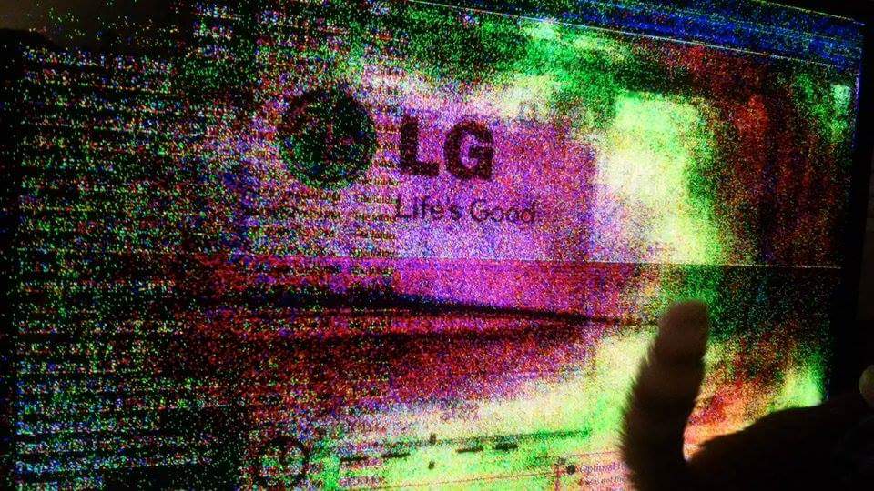

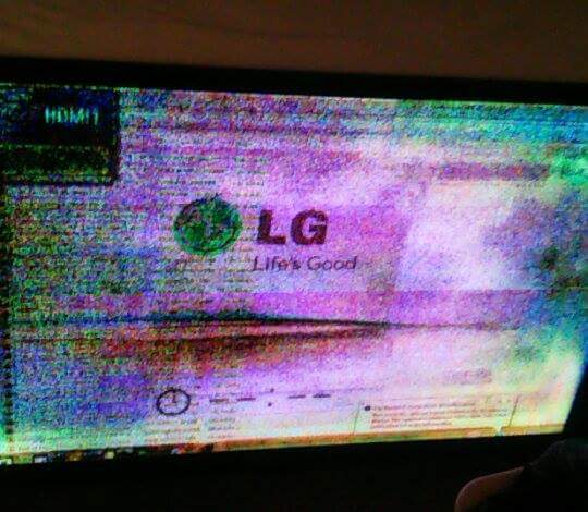

          Re: LG 50PN6500 Rainbow pixels
          Here is a couple pics of the screen...
          • xboxlivemikey
            • Jun 2016
            • 11
            don't mind the cat
            • ReeceyBurger123
              Never Give Up !
              • May 2014
              • 7325
              • Britain
              Zsus for sure, possibly erc coils have broken solder joints. Re,ove the Zsus and inspect for broken solder joints.

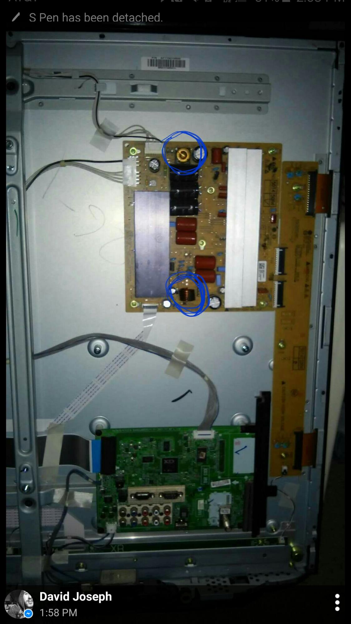

                  • xboxlivemikey
                    • Jun 2016
                    • 11
                    Ive circled two components... are these the erc coils?
                    • ReeceyBurger123
                      Never Give Up !
                      • May 2014
                      • 7325
                      • Britain
                      Yes mate

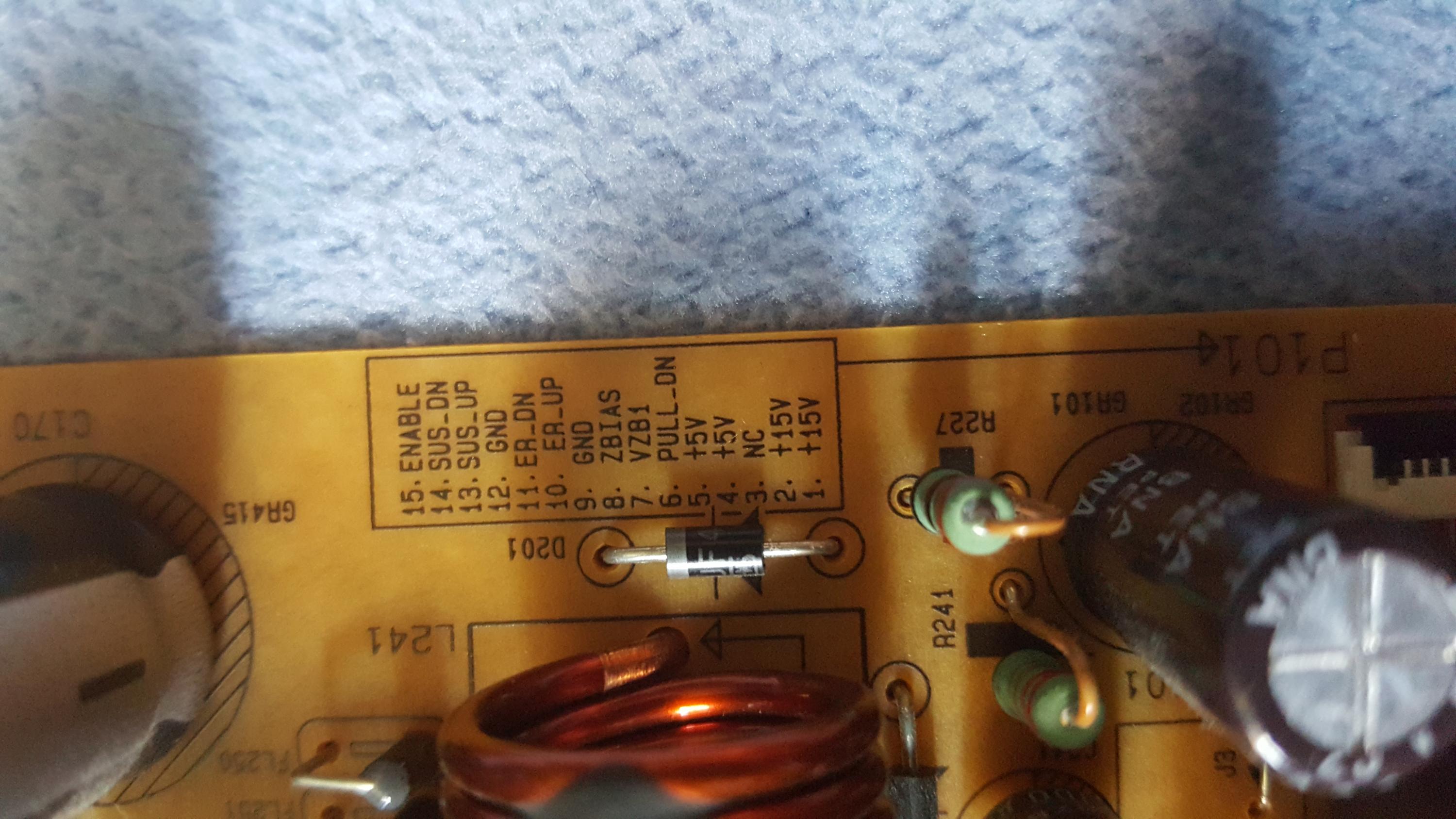

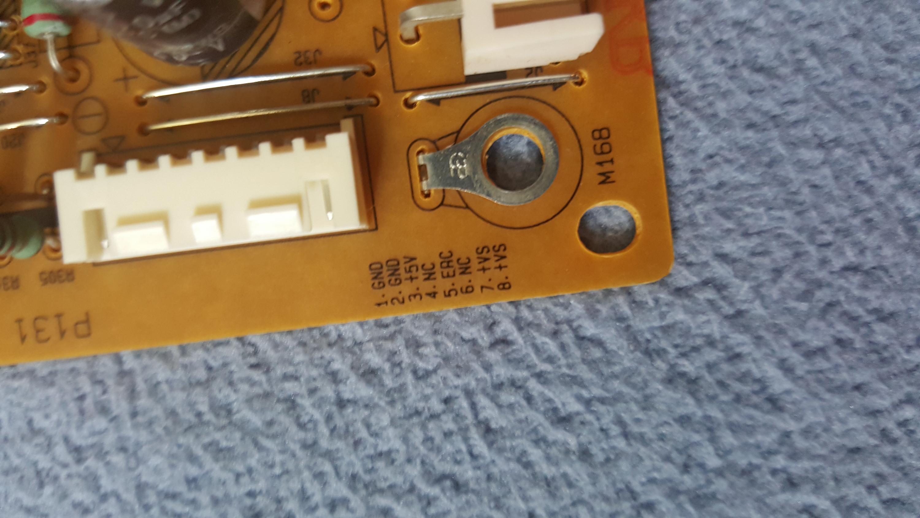

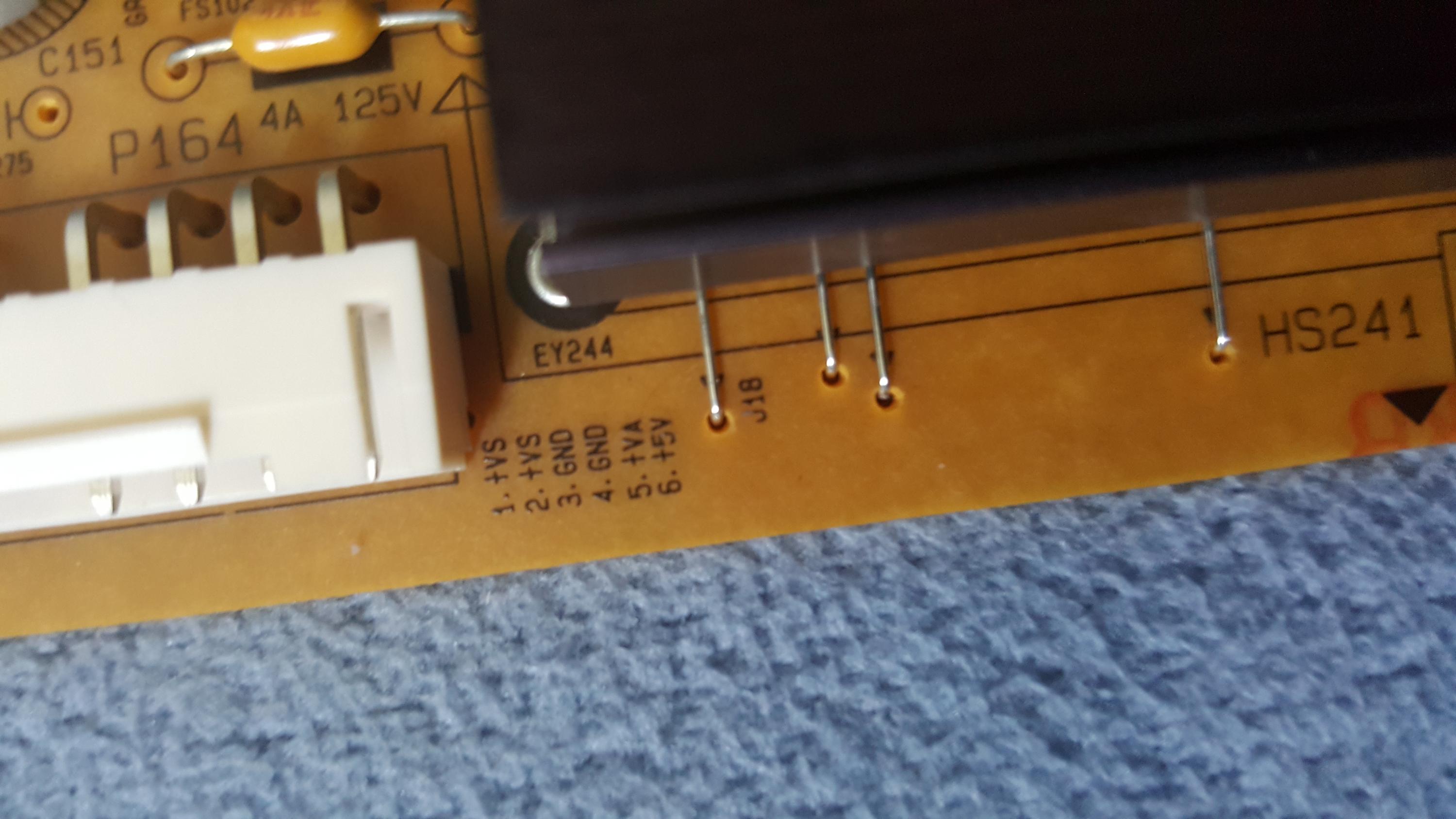

                            Ok what voltage do you get on the Ve test point on the Zsus ?
                            • xboxlivemikey
                              • Jun 2016
                              • 11
                              Ok, Im not the best with these terms but the Ve test point? I can't find one cause I'm not sure what it is.... but I did take pictures of the pin outs, if these are the test points then great but I'm not sure where to test the voltage. Thanks in advance
