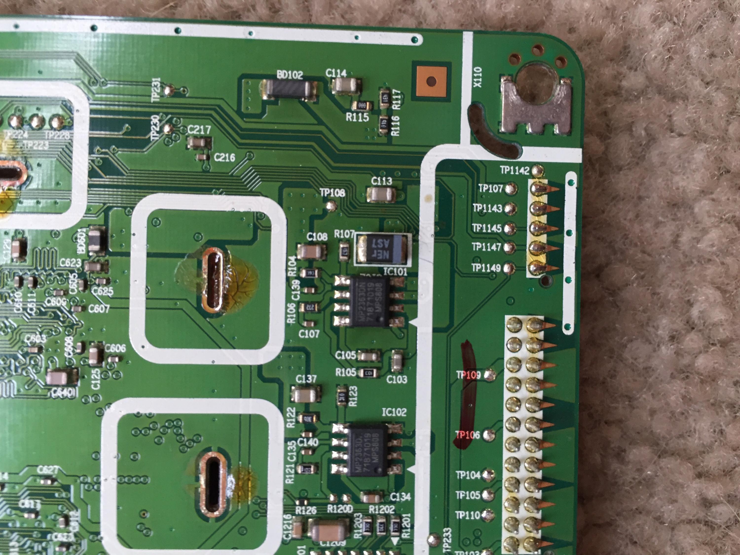

    I just picked up this tv. Seems to have the powere issue that others hav posted about.
    I'm going to replace C102, which is a 10v 47uf tantalum capacitor.
    When I measure the one that is on the board, it measures 128uf.
    Why such a big difference? Is my board somehow different?
    The board number is BN94-1880A.
    On the bottom of the board there capacitor isn't labeled C102 but it's in the position that it shows in the pictures of other posts.
    Re: Samsung PN50A510
    It measures that as its on the Pcb, there is other buck capacitance for that rail connected to that cap so thats why it reads that.

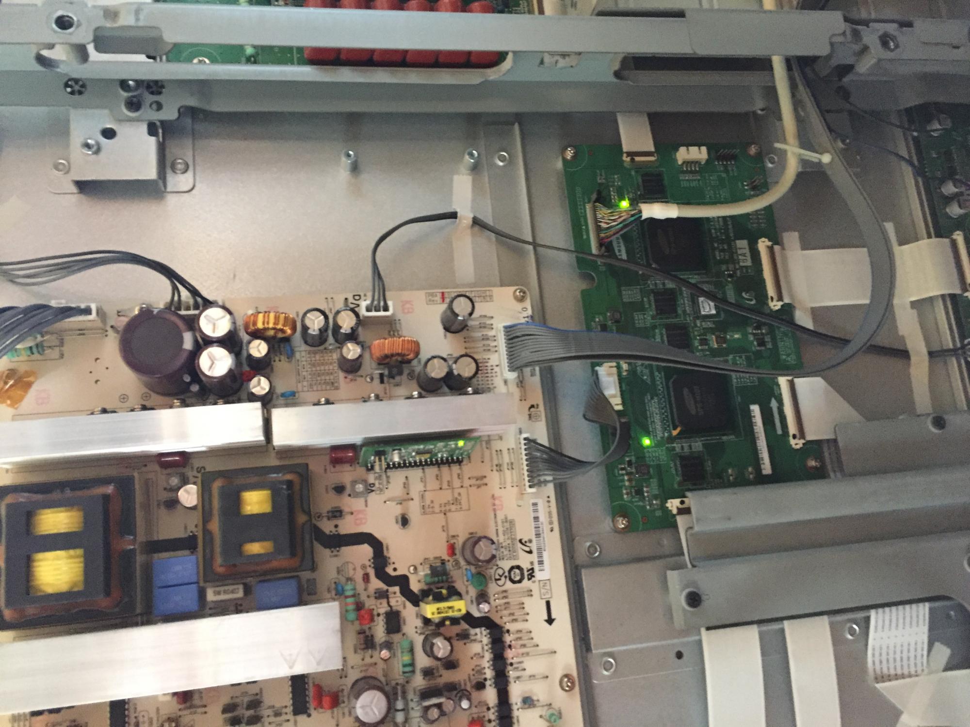

                    The cap arrived I put it in.
                    The tv doesn't turn on. The relay clicks, the front power led flashes and there are lights on the logic board that flash.
                    The new cap has different markings than the old one. It has a + on one end.
                    The old one didn't as seen in the picture. It has a gray line on one side. Was I correct in assuming that was the negative?

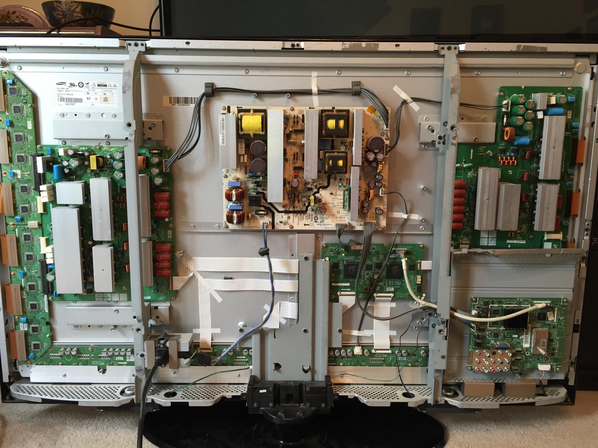

                      Back of the tv.
                        Err--So Whats this fuse you are now on about then?
                        --Thought you were on about a cap...
                        Did you not do proper fault-finding and run test-patterns on the set?
                        Tis obvious from pics--the PSU is flashing out a fault-code.....
                        TELEFIX
                          I'm sorry. I meant to say cap. Not sure why I said fuse.
                          The psu isn't flashing. The logic board below it is.
                          I did a search for the model number using the search function. The problem with the set matched what other users in the thread were experiencing. So this was the first thing I tried. The cap was cheap and I wanted to try my hand at replacing components like this.
                          It was my first attempt.

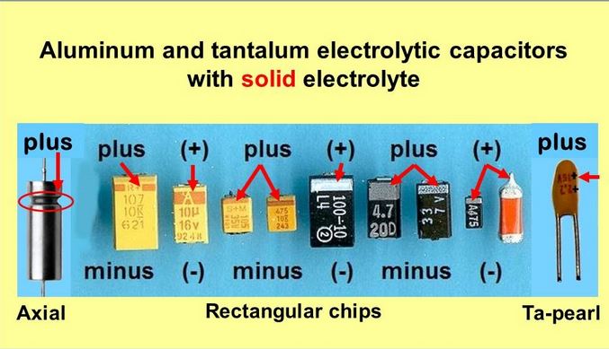

                                Originally posted by Malachi View Post
                                The cap arrived I put it in. The new cap has different markings than the old one. It has a + on one end.
                                Here's a guide for future reference.
                                  Then I put it in backwards. So I guess I better turn it around before proceeding.
                                  Could that have ruined it? I purchased three so I can replace I if it did.
                                    Reversed the cap and the tv seems to work now. Is it normal for the logic board LEDs to blink continuously?
