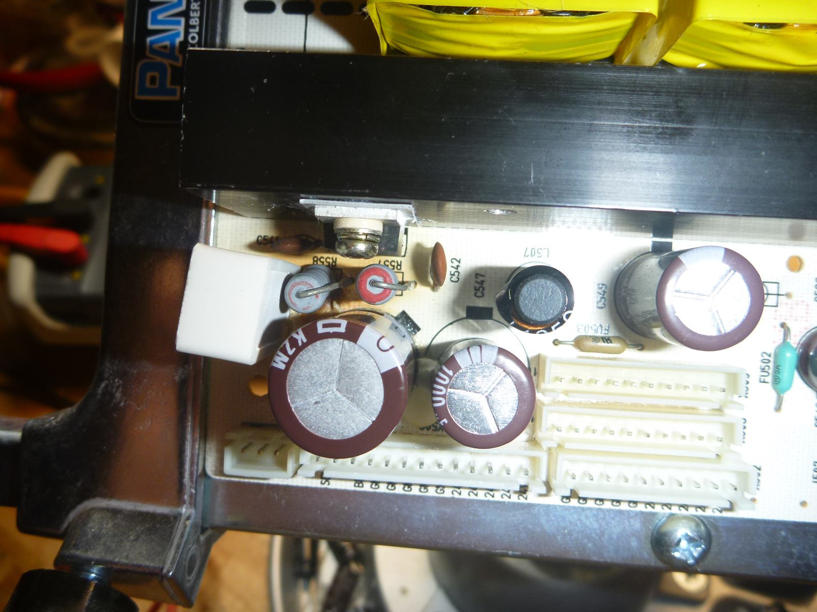

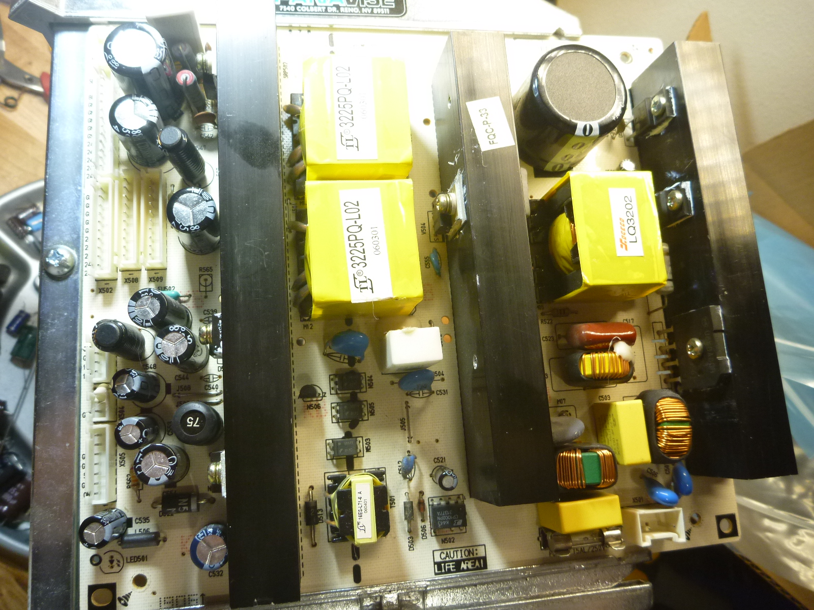

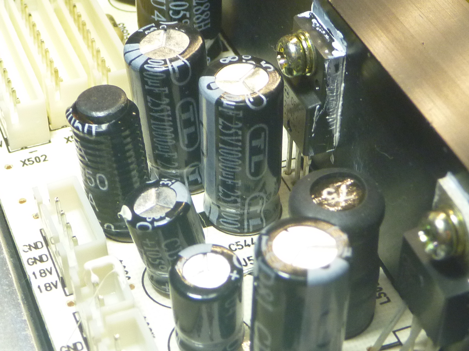

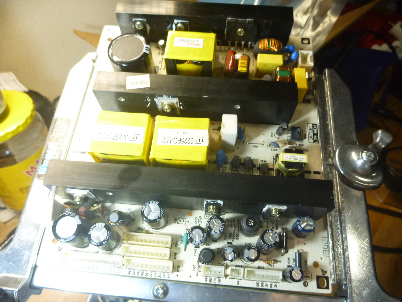

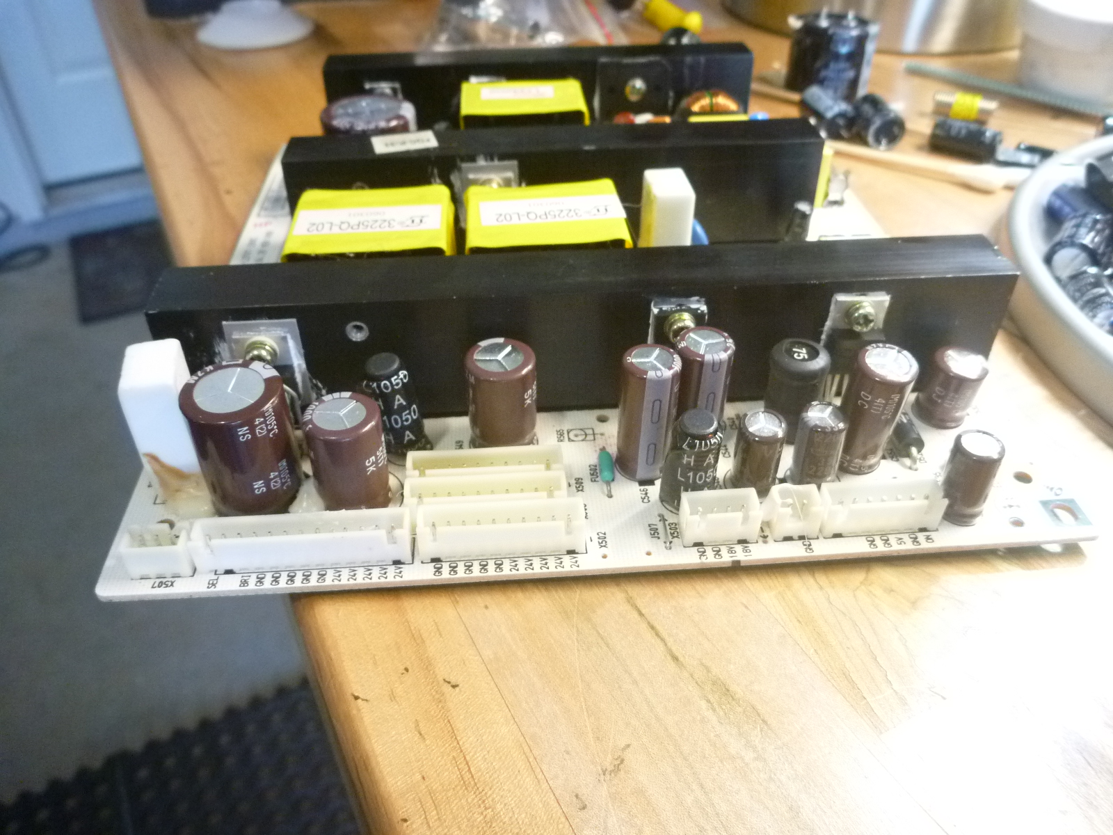

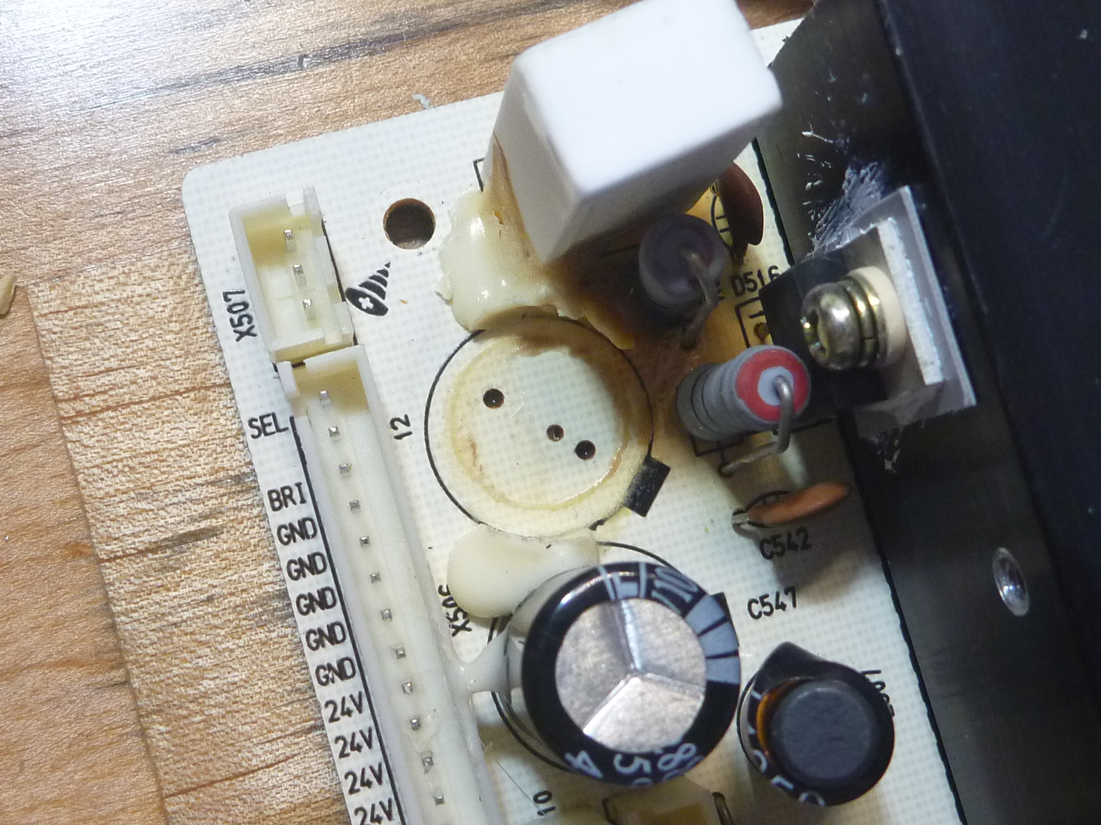

This is my neighbors TV that was under a blanket in their garage. The main power supply fuse is good, I have never heard of TL capacitors so I switched them all out for UCC KZN/KZM series. The 2200uf 35v cap had a failed bottom bung and I multimeter handling failure made me think that the 470 ohm 5W fusible resistor had also failed open. When I fired it back up, I was showing good 5v standby voltage. I pressed the power button and heard a distinct POP. I figured the fusible resistor was gone again but it tested out at 450 ohms. I also noted scorch marks around one resistor (R558) that I believe is marked 70 ohms. It metered as 10 ohms ( still in circuit). Checked all the SMD fuses on the inverter board, they are good. Any opinions? Thanks!

So what DC voltages do you have at the connecor now?Willing to help but I'm no expert.Comment
