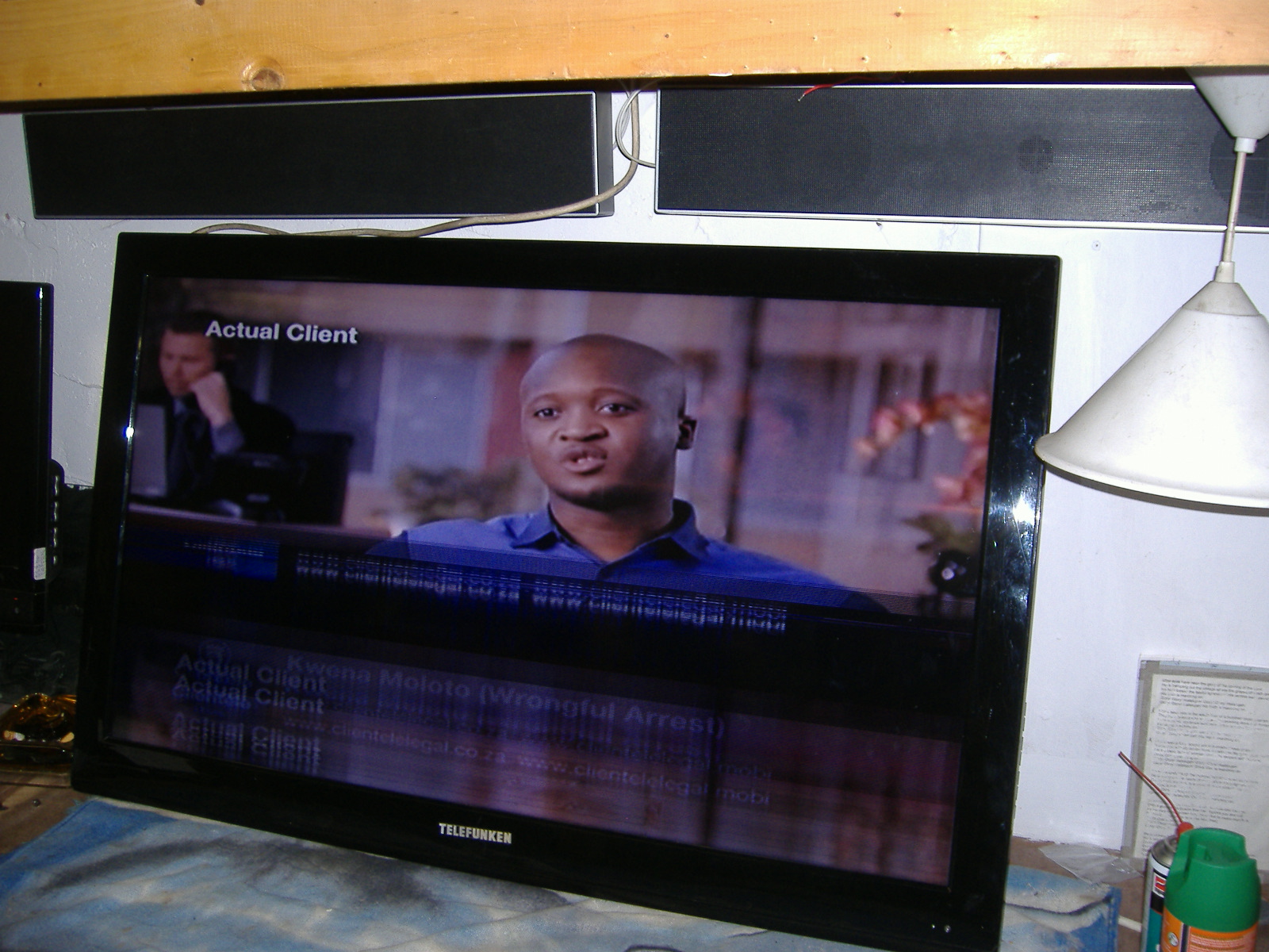

    Hi Guys,
    Thanks for info in "sony tcon training manual". According to the examples they have, i guess a faulty gate tab bond failure is causing the bounce/ double image in the picture, and gate driver failure causing the failure in the bottom half of the picture. guessing the panel is done, and the set is out. Thanks Budm for the link.
    edit: had originally tried other second hand tcon which produced same result, and wasnt sure if had two tcons with same fault, so scouting through other posts found the link. Thanks again. Mike.
