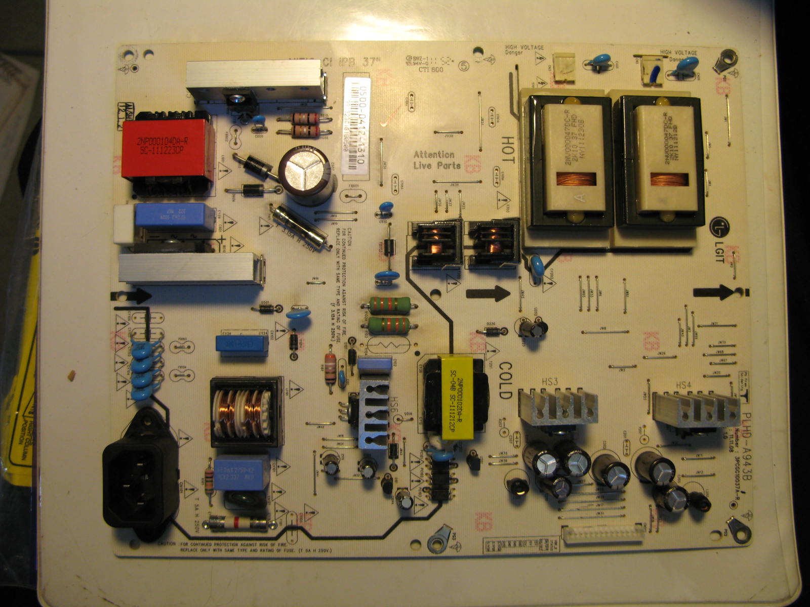

    The current project is this Vizio unit. No picture, sound or logo light.
    I found the 3.15A fuse was blown. It's the diagonal one at the upper left.
    I replaced it, and it turned into a flashbulb when I plugged the set in.
    The diodes at to the left of the capacitor seem OK, as does the bridge rectifier. The capacitor to the left of the fuse reads 92 uF while in circuit. It's labeled 68 uF.
    I've got a question on the value of those two resistors left of the fuse near the heat sink. All the color band guides I see don't allow a black band to be at the end. It looks like the bands are red, black silver, gold, black. The middle band appears to be metallic, and not gray. Two metallic colors don't make sense either. My meter isn't extremely sensitive, so I show 0.4 Ohms on them. when I touch the probes together, I get 0.2 ohms. Does that sound right.
    Does anyone have any hints on what to look at next?

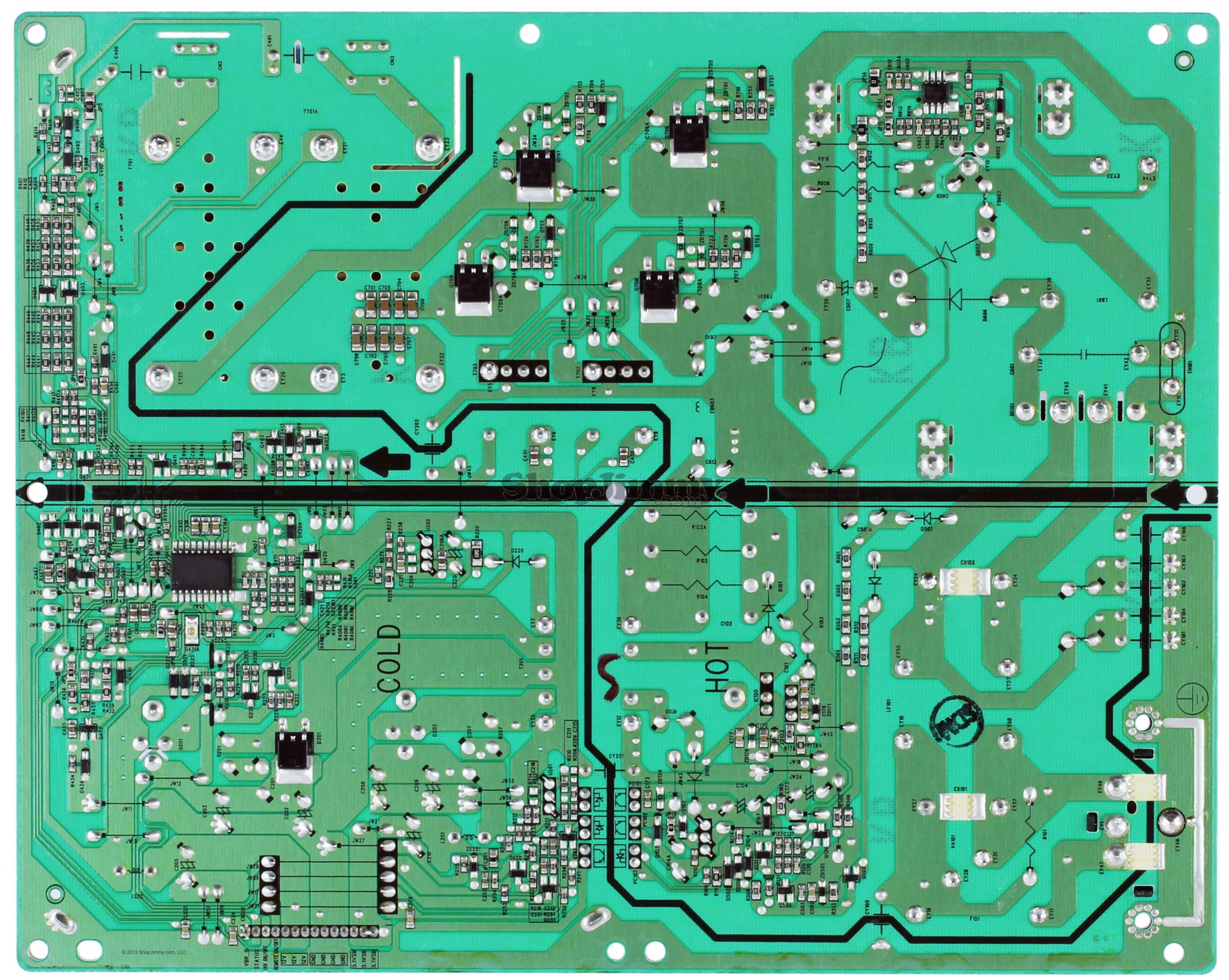

    That fuse is from the output of the PFC Voltage booster circuit, the shorts is more likely due to shorted SMD Power MOSFETs (4 of them on the bottom half of the board in the pictures) which drive the Inverter transformers. You need to find out if they are shorted out or not.

      Thank you for the suggestion. I checked them, and don't get any short between any of the three leads. All four read pretty close to each other.

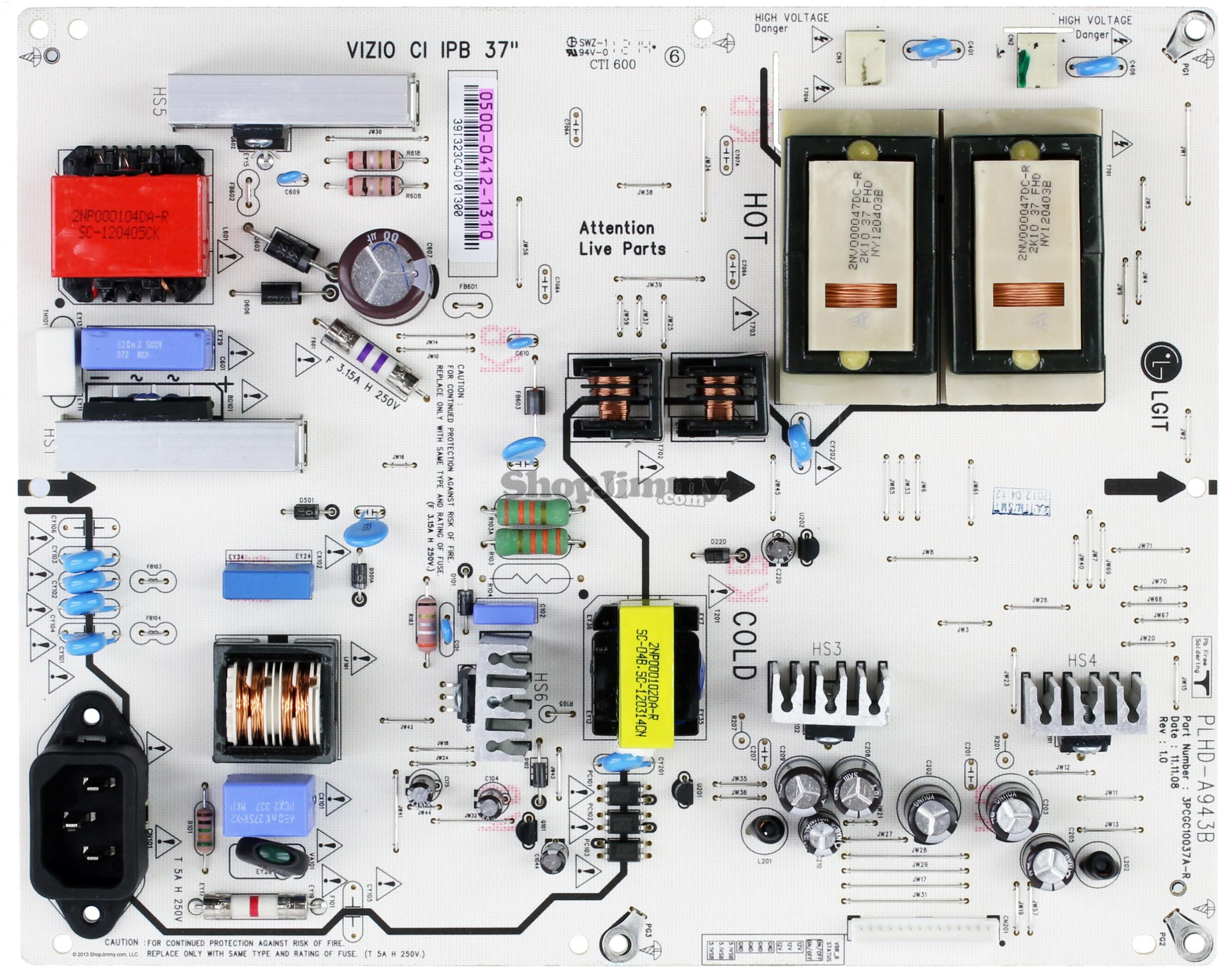

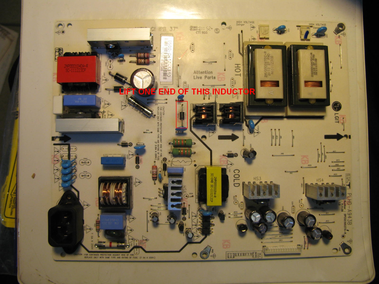

            Re: Vizio E371VL - Power Supply Problem
            You can lift one end of the inductor (the one I marked in the picture) for feeding the Voltage from the fuse to the STANDBY power supply section to see if the shorts after the fuse will go away.
              OK. It looks like that isolates the area where the problem is. With that inductor removed, I get 4.5 M Ohms from the end of that fuse to the negative side of the filter capacitor when I have the - lead on the fuse, and the + lead on the capacitor. It's an open circuit with the + on the fuse and - on the cap.
                  That means the shorted circuit is in the standby power supply section.
                  So now we are going to isolate the SMPS IC150 (6-PIN TO-220 IC on the heatsink) by lifting one end of the GND return resistor R183 (0.39 Ohm), then check to see if the shorts after the inductor still exist, right now the shorts after the inductor should be there before lifting the resistor.

                  Pictures provided by shopjimmy.
                      So, you are saying that when one leg of that resistor I asked you to lifti then you check the resistance between the inductor leg that you solder back in place, it still show <1 Ohms between the negative leg of the cap and the inductor? That is what we are trying to find out.
                      No it will not be the transformer, not even need to remove the transformer if you follow my instruction.
                      All the resistance reading right now is ref to the negative leg of the cap.
                      So the bottom line is what is the resistance you are getting between the negative leg of the filter cap and the the inductor (resistor back in place) when that ground return resistor R813 has one leg lifted off the board?

                        I get 100 Ohms from the inductor to the - side of the filter capacitor when R813 is out of the circuit.
                          You need to remove that IC next.
