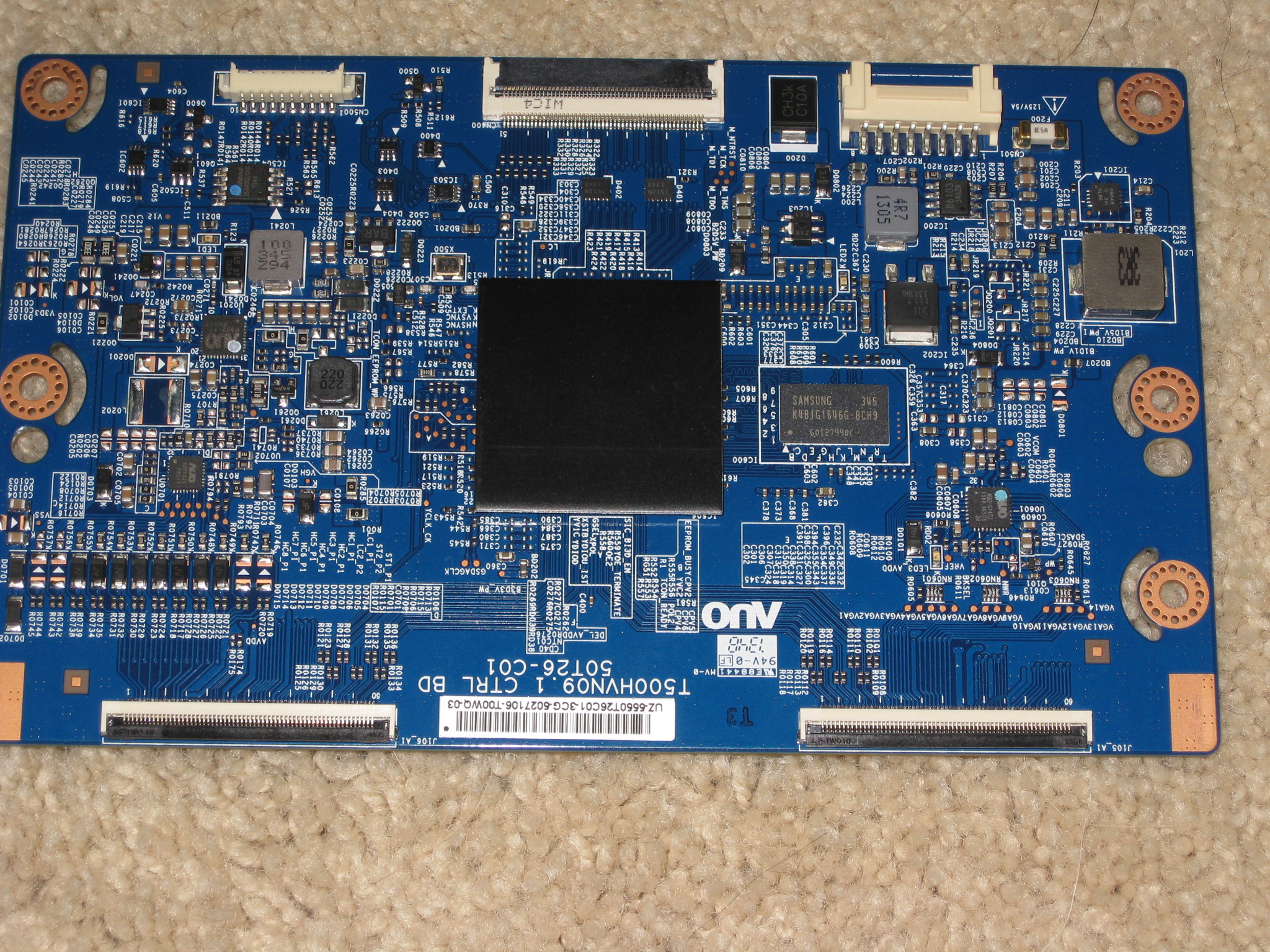

    Hello all,
    I recently joined this forum looking for help and expertise in something I really didn't want to deal with -- I was settling in to watch the NBA playoffs when my 50" Samsung LED HDTV's screen went dark. It had been working fine, was purchased in July 2014, and up until now I had no real complaints. My background is EE so here's what I found when I dug into it... Screen was very dark "bluish" color, backlights were lit, sound seemed OK although my cable box is HDMI to a Bose Home Theatre, then that out to TV so I don't know if TV sound was OK or not. "Clicker" sound on TV was fine, and I could tell I was moving within the menu system, so everything seemed OK just no picture.
    I read up on things and decided to try a TCON board (off Ebay) -- same problem. I then got a used Main board (also off Ebay) -- same problem.
    So I capitulated and started checking voltages -- a real drag without schematics! Everything looked OK except AVDD which was around 1.2V. With the ribbon cables to left and right panel disconnected from TCON, that value read 15V... OK something going on here. Left ribbon cable connected (right side of screen) AVDD = 1.2V, no picture. Left ribbon cable disconnected and right ribbon connected, AVDD = 15V and left side of screen works OK. So something is going on with the right side of screen. There looks like a few MLCC parts along the lower PCB "strip" connecting the right side of panel that are between AVDD and GND. A few diodes, other MLCC parts, resistors, etc. Nothing is shorted though, I read about 20K from a DMM with the panel disconnected between AVDD and GND on the strip itself. Also OPEN in one direction and DIODE in the other with DMM set to 2K/DIODE position (as far as I can tell both left and right panels read the same here). The tabs look OK too, at least as far as I could tell. The TCON board has an LED marked VREF which lights and stays lit when only the working side panel is connected (with OK video on that side). When reversed and the "bad" panel is connected, the LED lights momentarily then goes out. The picture also comes on briefly on the "bad" side then fades to dark as AVDD goes down -- which takes about 2 or 3 seconds from power on.
    So whatever is going on is not a dead short, but something that happens as time goes by, maybe a voltage breakdown or beginning of some kind of runaway which causes TCON to current limit. Of course it would be great if it was an MLCC or an SOT-23 "something" I saw on that PCB strip that has pin 3 tied to AVDD, but since I don't have much experience with panels can someone say this is a typical panel failure symptom? MLCC's usually short and this isn't, but maybe breaking down? Not sure what the SOT-23 is tied to AVDD but I could look at that too. I could also drive this section's AVDD externally through a diode and try and bring it up slowly and see what "lets go" or gets hot first! lol. With the finger test I could not tell anything on the PCB strip was getting warm. I'd love to save this TV if possible, so looking for a little advice and wisdom from anyone that might have "been there done that" before! I do have the capability of removing the 0402/0603/SOT-23 SMT parts along that "strip" PCB too just to get them out of the picture. I could also take a current probe and actually see the overload or scope anything else that anyone thinks would be worthwhile. This TV has an "AH01" revision after the main part number. I think that refers to the panel's manufacturer but I'm not 100% on that. Thanks in advance for any help, and if I left anything out or can provide more information please let me know. This was my first post so please bear with me! A picture of my TCON board is attached if that helps.

    checking ALL the components on that lower PCB strip for a short is your only option.
    If you are lucky,a small capacitor has shorted(seen that more then a few times!).
    If nothing is shorted or very low ohms then you can safely say that the tv got downgraded to a paper weight.

      Re: Samsung UN50H6350AFXZA 1/2 Panel Failure?
      Thank you martino. I will further check the components on the lower PCB strip, however I don't believe that anything tests shorted at the moment -- my DMM reads something like 20K in one direction and "diode" in the other (when AVDD is negative with respect to GND, which is not normally the case). It looks like there is a clamp diode on the PCB to prevent AVDD from going below GND, so a diode reading would be expected in that direction. Should I expect a low ohms reading from a defective panel alone? If yes, then I don't see that -- even when my DMM is in DIODE mode. That's where I'm getting confused. Thanks for the help!

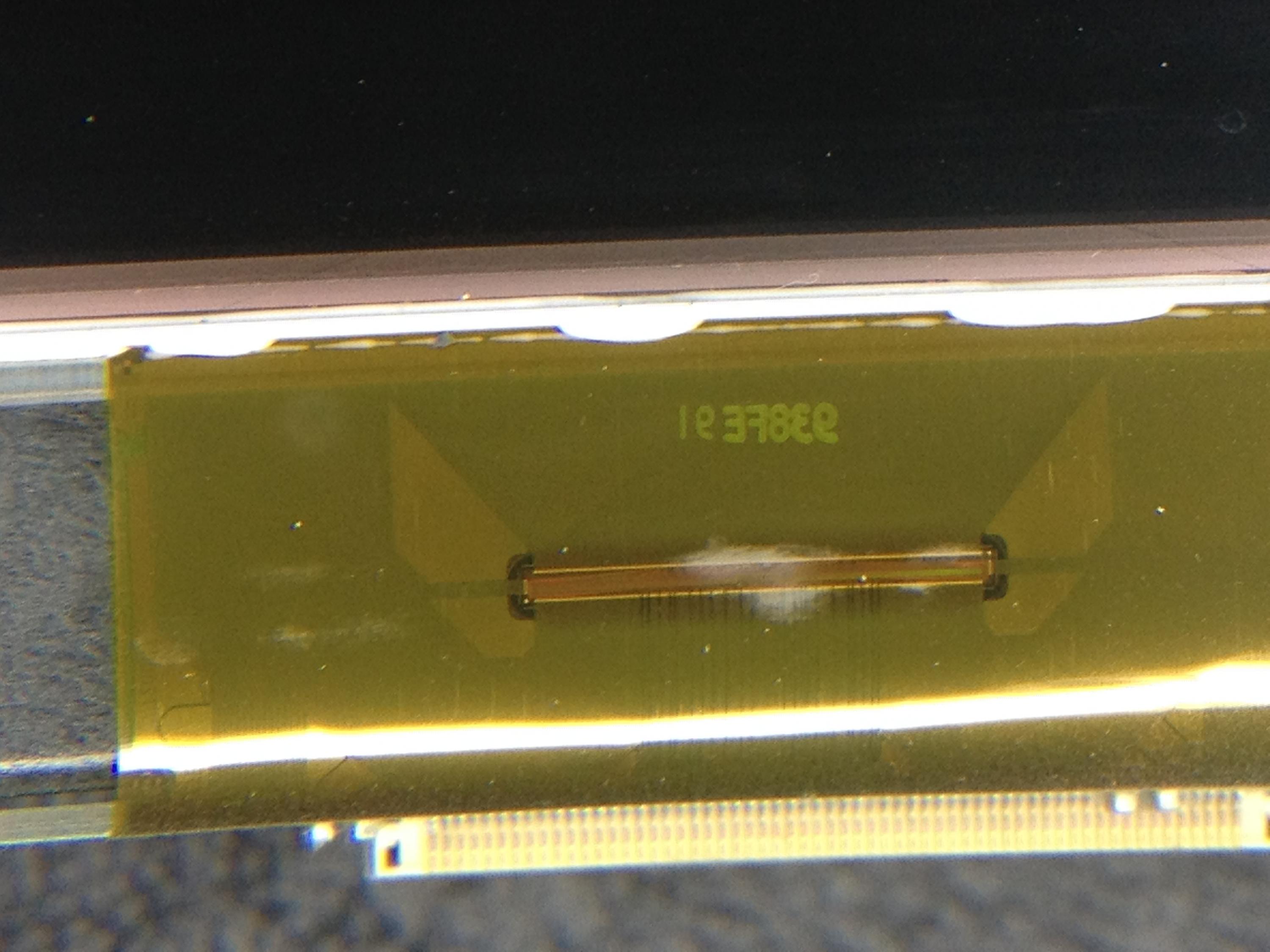

        There is a possibility that one of the chips (COF) on the ribbon going to the panel from the circuit strip has burnt out so may be worth doing a visual check.
          Hello all. Just wanted to post an update here about this broken TV. So I got into debugging it and as I mentioned before, the AVDD would come up for about 250mS then drop. I thought there might be something wrong with it, and had a spare TCON board so cut the trace to isolate it. Same problem. Then I noticed that ALL the power to the panel was getting shut off -- +15 (AVDD), +6.5, -6.5, and +3.3. I isolated all of those, SAME PROBLEM. OK, had to be one of the signal nets??? Well since I already had all the power nets cut on the TCON board, why not! Cut the first driver net, same problem. Second, third, fourth... got to #7 and bingo, power supplies came up and stayed up. So I began repairing the cut traces and eventually had all of the reconnected except #7 (I'm not sure what kind of drive this is, almost like a differential pair with one side tied to GND locally (on the TCON board) and some diode clamps or bias points to some negative voltage). Anyway eventually got a full screen picture which has maybe every 10 or 20 horizontal scan lines blank (from #7 missing). Seemed like the picture would be fine for about a second, then the missing lines would appear for a second, then OK for a second, etc. I eventually traced #7 from the TCON board down to the bottom leftmost 134pin connector (there are 4 groups on the left side). That was a direct line from the TCON board to the panel, nothing in between. I did notice that even with this net disconnected on the TCON board there still was a significant signal present at the panel connection, implying to me that something is shorted "out there". So that's that. I may try and see exactly what other net this seems to be shorted to, but for now the TV is yet another one on the scrap heap due to a panel failure -- after 22 months if intermittent use. Of course I could buy another panel for $600 but what's the point? lol.
