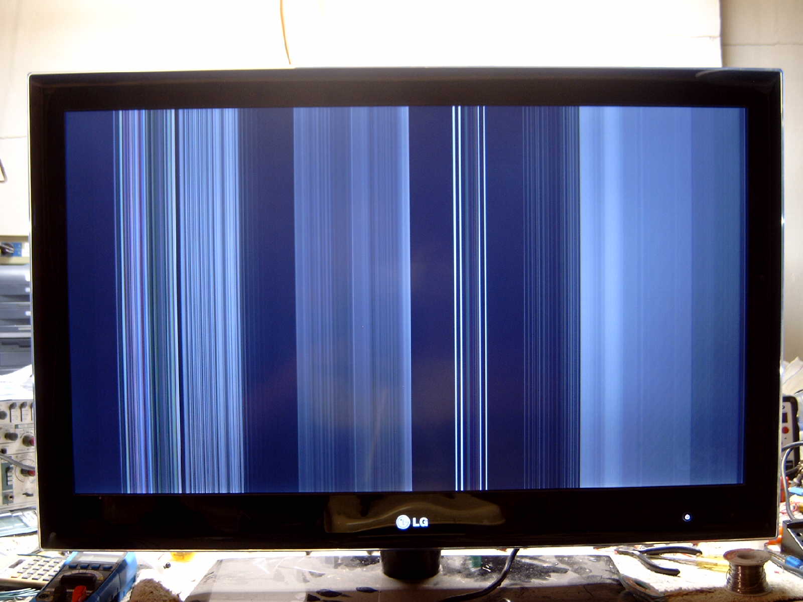

    I've got an LG 32LE5400 that originally had no video displayed.
    Selecting the menu option showed some change in the what was shown on the screen but nothing legible was visible.
    The full number is 32LE5400-UC.AUSWLNR and the panel is LC320EUH (SC) (A1).

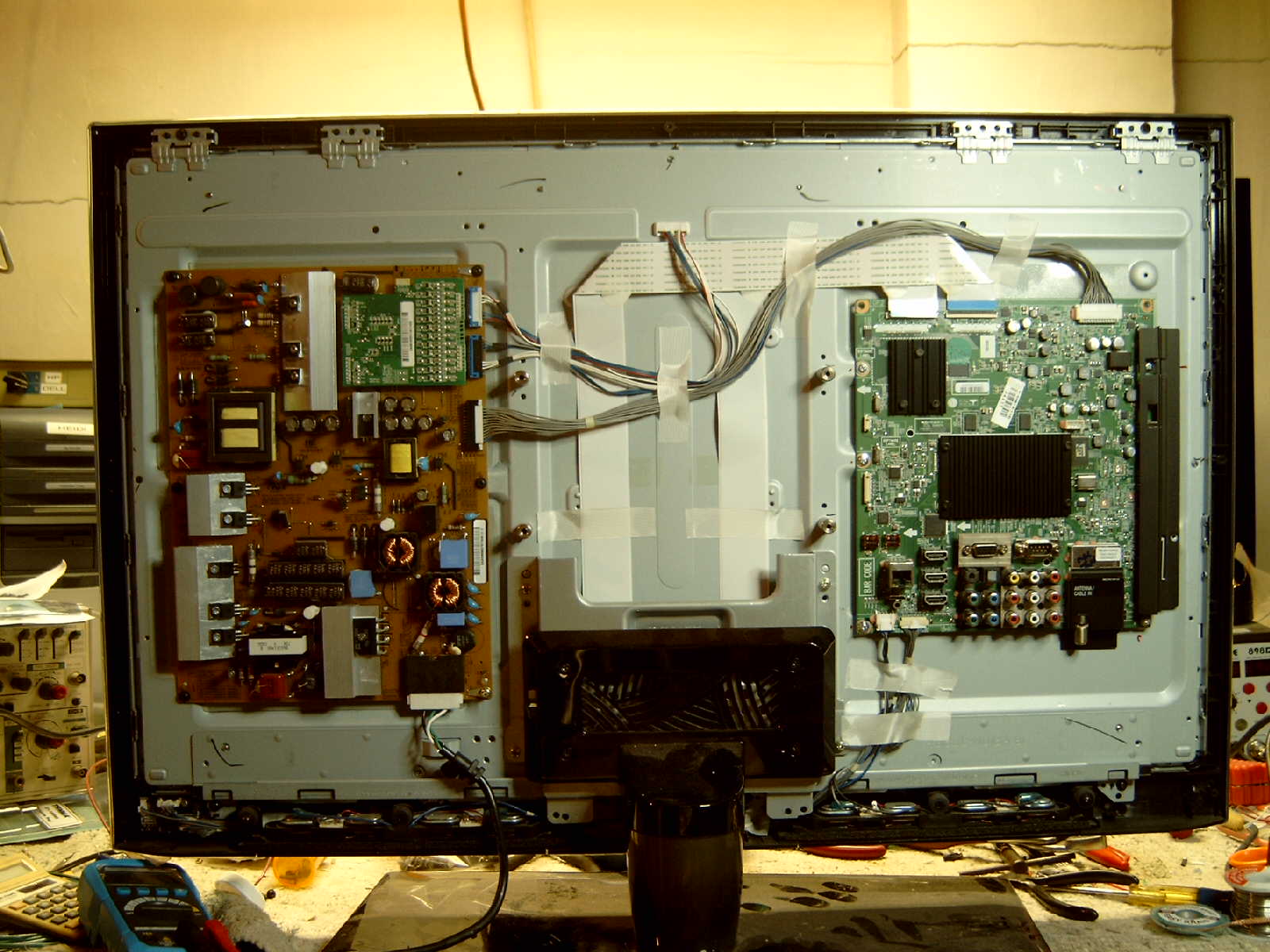

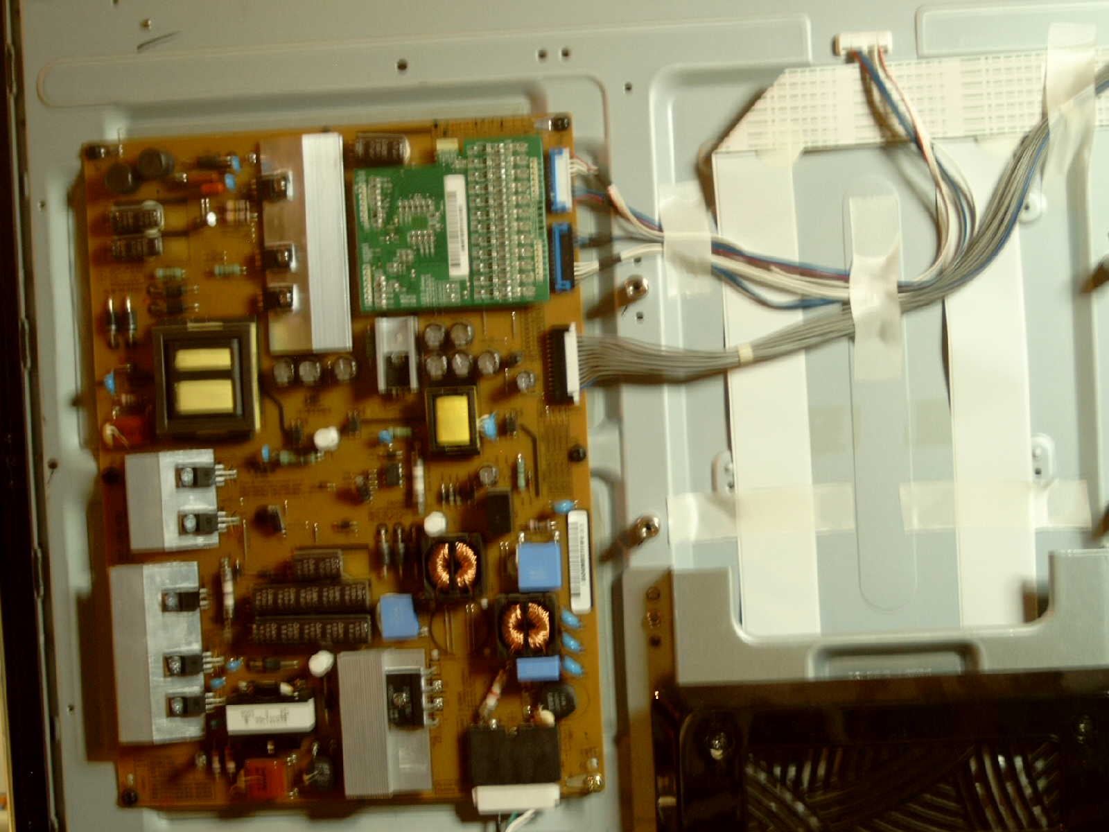

    I do not see any seperate tcon on this set - looks like the lvds cables go from the main board directly to the panel.

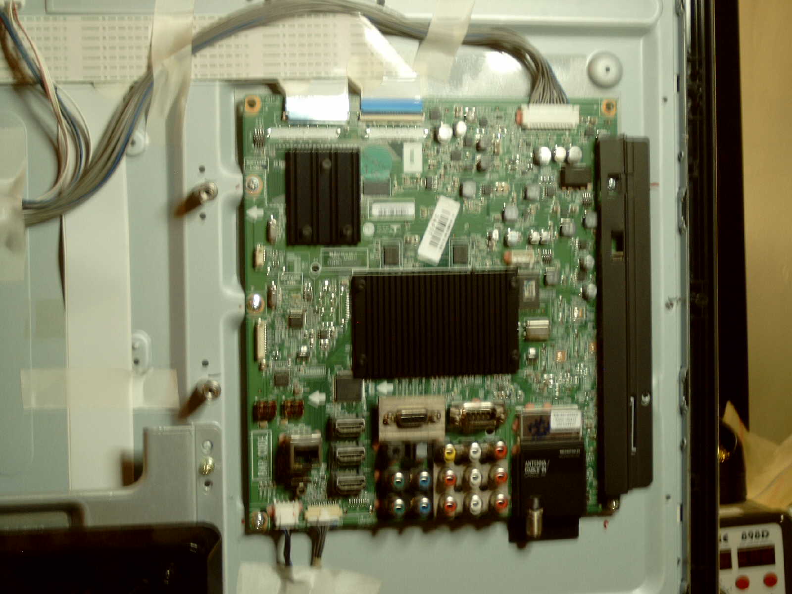

    There is a chip getting extremely hot on the main board - MAX17113ETL
    Chip is available from Digikey, but due to the package style I found it too difficult to replace.
    I finally found an exact replacement main board on Ebay. I ordered it and on installation still did not get any video.

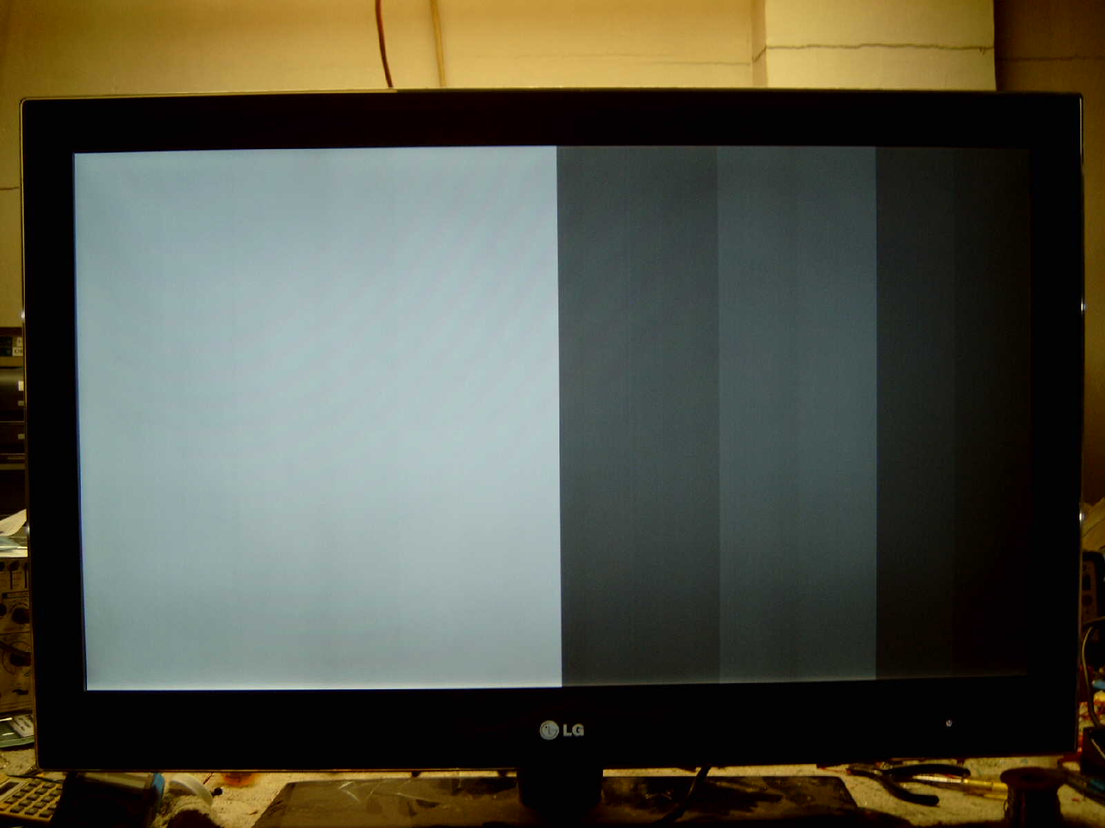

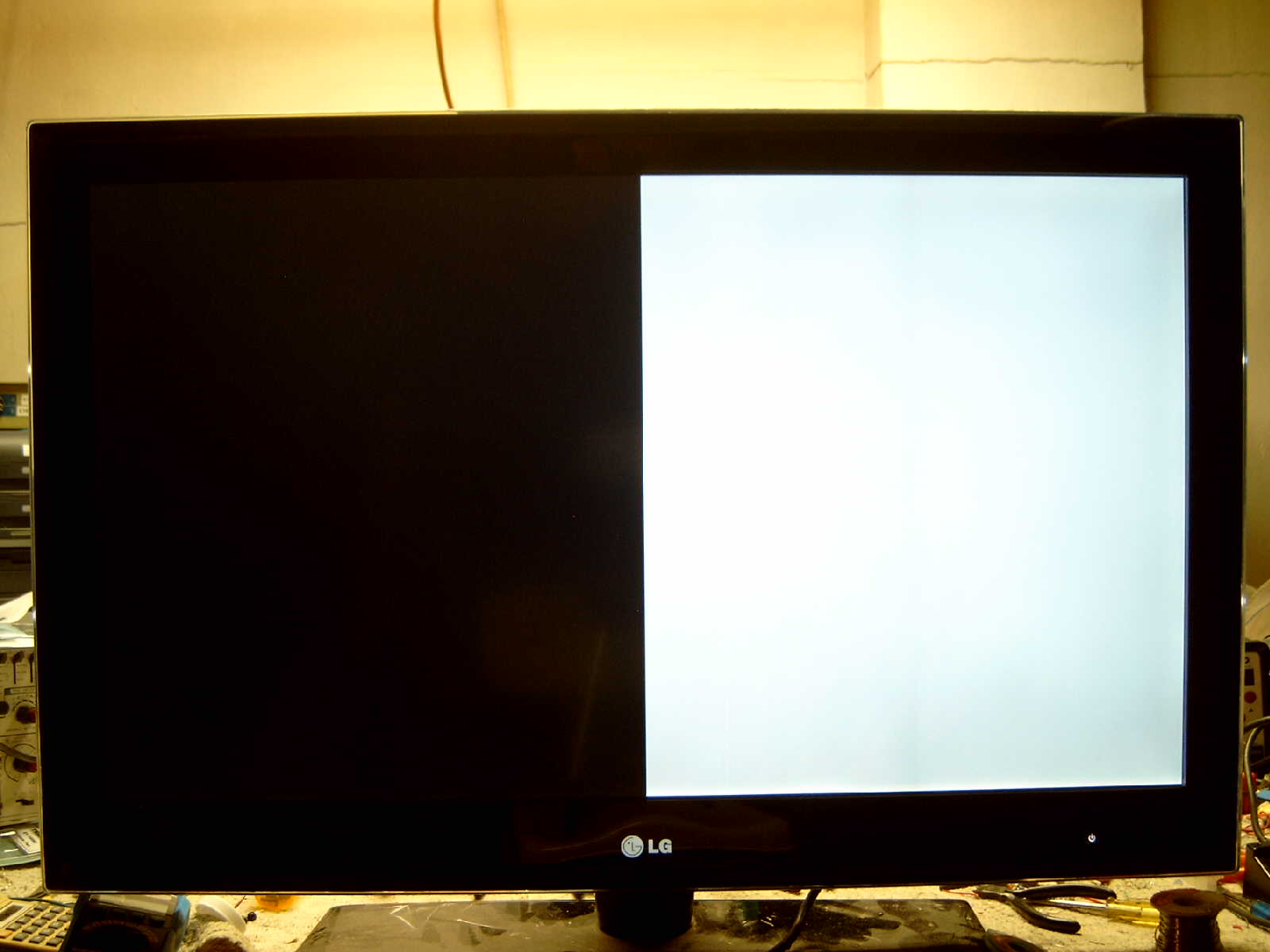

    I've included some photos showing the screen with the replacement main board installed, each of the two lvds cables being disconnected and shots of the rear of the set.
    The replacement main board doesn't seem to have any chips getting hot.
    So the question is - did I get another faulty main board or is the panel bad?
    Any input is appreciated.

      Try inputting a signal via any of the connectors eg. from the HDMI or USB and see if you get a clear half picture with only one of the connections from Tcon to Panel.

        I just tried the set with video and audio into the AV1 input. I have audio but no video. I just get random vertical lines that doesn't seem to change if the video changes.
        I think that there is no t-con board in this set.
        If I disconnect the lvds cables from the main board to the driver board that's connected to the panel I get no video - regardless of which side I disconnect.
        Mike

          Finally took the tv apart down to the panel. Both the chip on film ic's are extremely hot.
          I guess the panel or both chips are bad.

            I would say panel on this sorry. Its bloody hard to say though when the Tv isnt in front of you.
