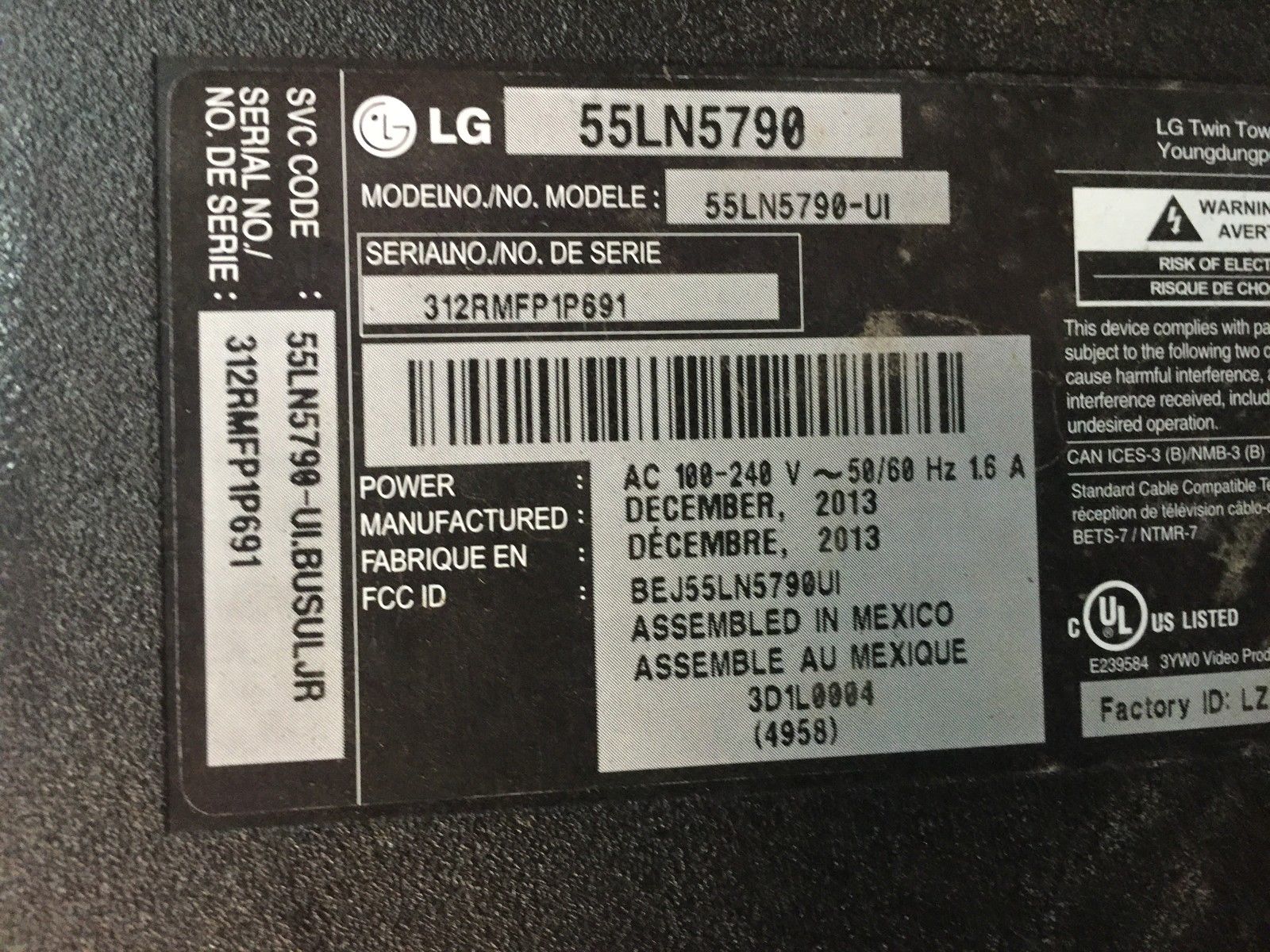

      Thought I would add to this thread. I just got a 55LN5790 in yesterday (salvage TV so it had already been trashed). It would flash briefly at startup then the LEDs shut down. Anyway, I opened it up to find a similar failure to what budm posted here. The diffuser was so badly damaged, that changing the LEDs wouldn't have even been an option.

              #46
              Re: LG 47LN5790 badly burnt out LEDs
              Here's the tag off the back. Same series. Manufactured 2 months after the one budm posted.
                  New Optics Panel in the 55". Assuming the 47" was as well.
