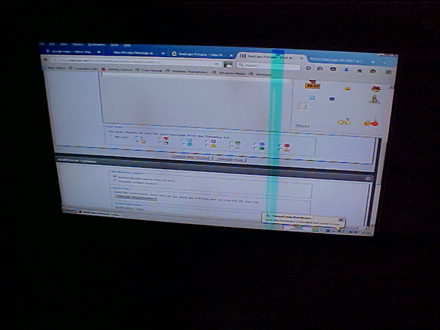

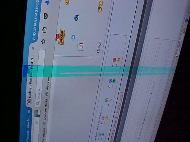

    while I am in the process of trying to sort my main tv Hitachi 32HXC01UB backlight problem,I am using a Samsung LE32R51BD that was salvaged from a recycle centre.It works ok except for a vertical blue band about 1.5" wide from top to bottom and its about 12 inches in from the right hand side of the LCD screen.Pictures attached to show fault.

    If you flex the top of the set, but carefully, does it change. It looks like a tab problem but hopefully I'm wrong. It would be worth your while doing a search on this site for Tab related problems and see what comes up.
      Re: Samsung 32" LCD TV LE32R51BD - Blue band on screen
      had that before but horizontal its like its bleeding it doesnt go right to the top so maybe not tab bonds
        I dont think its a tab bond issue but the Lcd glass its self. I have seen the foils in the glass become warped and the tft connections breakdown due to ages and heat etc and you get artefacts like this. Maybe try the tab bonds if not use the bacon method lol
          Tried flexing the top of the set and applied gentle pressure to screen in affected area,no change though.I assume the tab bonds become detached over time, I dont have a lot of experience with lcd screens so bear with me, although I have repaired several lcd computer monitors with faulty caps in the power supplies.Is there a cure short of replacing the LCD screen?

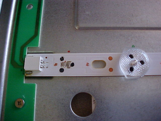

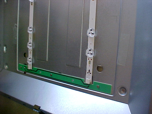

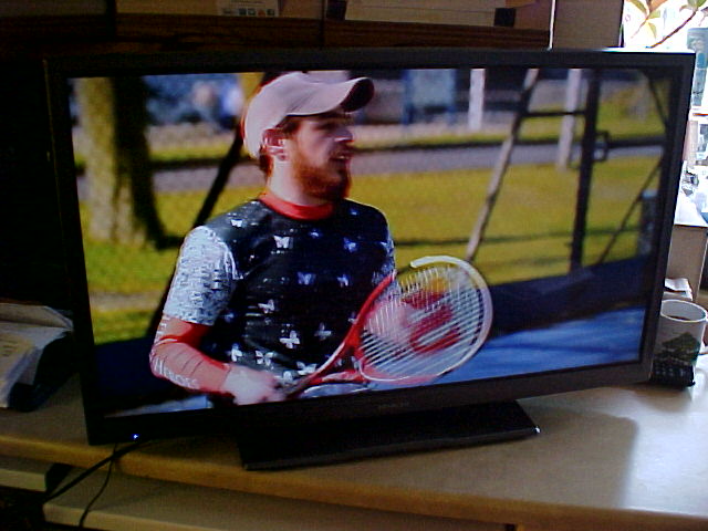

                                  I replaced the faulty backlight LED in the Hitachi 32HX****, ended up splicing a replacement with lens attached,getting the LCD surround on was a hairy,its now on soak test at the moment,5349 hours on the clock thats all down to me ! over two years.Are there any reliability mods I can do to the power supply board?LED backlight set to low,Dynamic contrast set to high..
