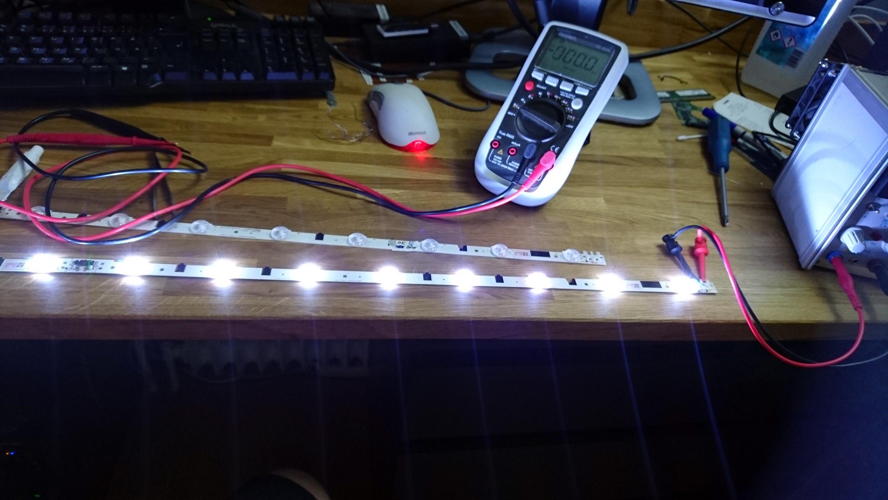

                  Well been some time since i was online here, and i have another suggestion that
                  i been modifying multiple sets to make them run cooler.
                  I been repairing some of these too about the same model but the sets i worked on
                  is called ue40fxxxx
                  R9119 R9219 if the value of these is 0.27 change it to
                  0.55-0.6 it makes them run cooler and they are likely never to fail again.
                  Then the voltage drops from around 180V over diode d9202c over the string with 52 leds down to 164 and you can then remove the glue on the pot and lower the voltage on d9102c to around 127V that use to be around 135V before modding it.
                  After this you are down at roughly 3.2V on the leds as samsung use to drive them at 3.46V is in my opinion to much.
                  I also apply a very small dab of heatsink compund to the backside of the strip where the led is mounted, i think it is a design flaw with to little heat dissipation.
                  Im pretty sure that they are zeners 12V and 24V in series on the bigger string and just one 24V on the little one.
                  So far i have not bought another new strip just replaced burnt zeners and the failed diodes take some time with hotair but it can be done.
                  Like the image i attached went from a dead strip to a working one.

                    Sorry for gravedigging a bit.
                    I've got one of this 40" samsung tv that I need to fix, is has 7 stripes with 13 LEDs on each, there are like 15 blown leds in total spread across 5 of the stripes
                    LEDs are not (much of) a problem to replace but what about the zeners? On some forum they are saying to just remove the blown ones and solder a wire instead, I guess it will still work but I'm curious, have someone finally found out what exactly are those and what can we replace them with?
