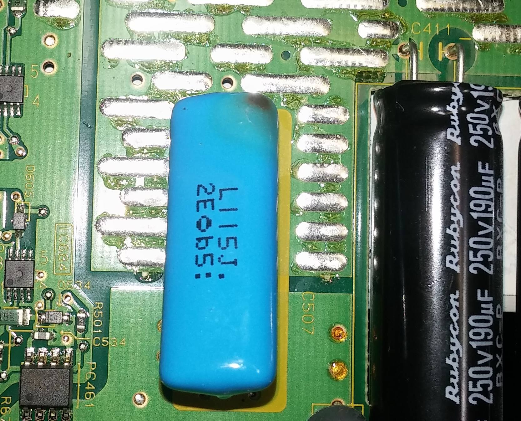

    Just finished soldering TNPA5330 kit for VSUS short.
    i.e. Q401-403, Q421-Q423, Q531, D401,D421,IC502.
    Measured the VSUS line, got 60 Ohms. Turns out that C507 is shorted to 60 Ohms. Removing C507 (blue colour) from the circuit VSUS resistance jumps to 260kohm.
    Either I accidently rested the soldering iron on the cap (see corner discolouration) or it was faulty.
    Anyway, I need a new one. Anyone know how to read the cap value/type/voltage or where to buy it?
    Pic of cap attached.
    -- edit --
    From the GT30 service manual it looks to be C16507 (C507 on actual VT30 board)
    C16507 F0C2E115A280 C 1.1 UF 250 V
    I'd still like more details on the cap if anyone knows anything.

    Not sure about the cap, maybe metalise polyester, 5% tolerance. You could order it from a Panasonic parts . Not cheap at $7 USD

        Re: Panasonic 42" PX-P42VT30 used kit, need help on C507
        If it's across Vsus it's just a bulk decoupling capacitor so 1uF or 1.5uF would work perfectly fine.

          That's 1 site i look at but i was thinking your local authorised.
          I overlooked you were not sure. The image you post show 115j as marking = 1100000pf = 1.1uf. J is 5% tolerance 250vdc would be right. Seems a standard value in thst location on the different boards.
          16 is a board identifier ss is also has 16 ss a prefix as there could be a c507 on the A-board or p-BOARD TOO..
          You would order using that large number you saw in the manual or try something in those specs. As tom has suggested value near 1.1uf should be fine but voltage can be 250vdc or higher
